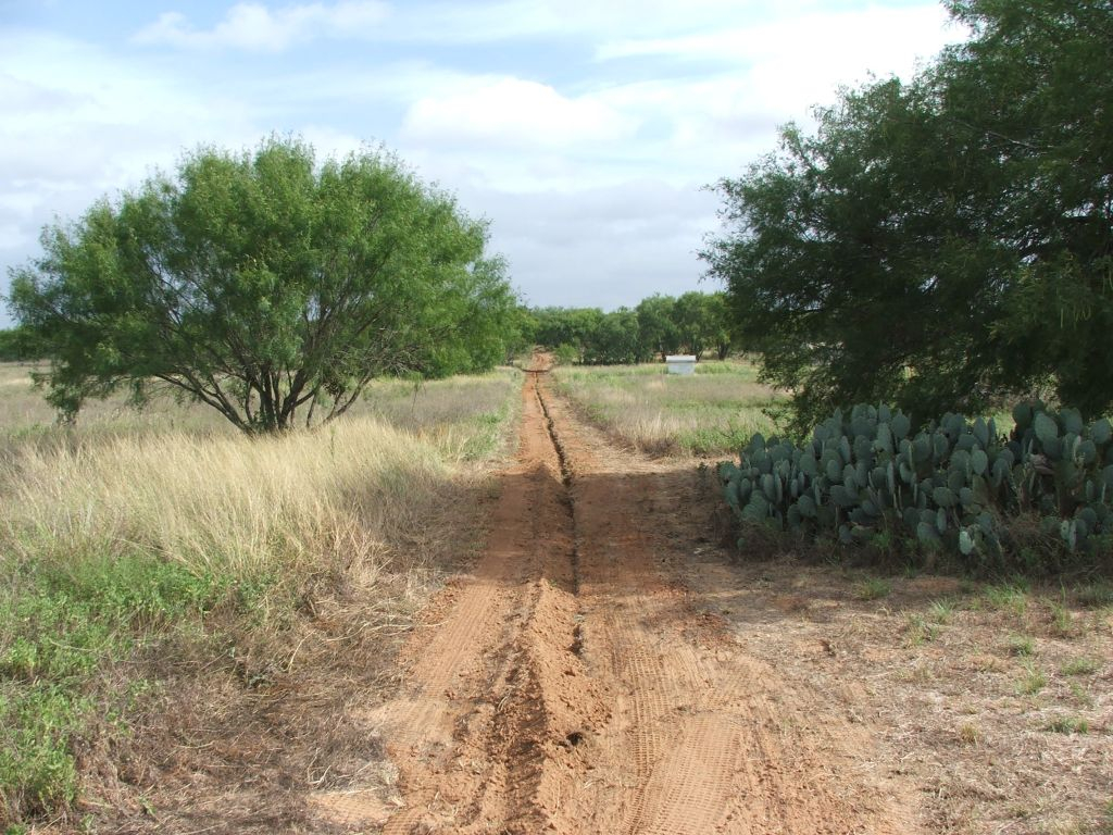

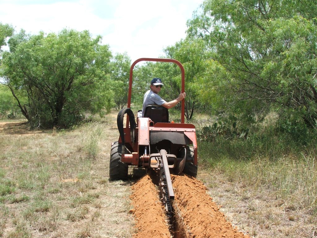

150 ft to provide AC power is your least costly route in my opinion.
If U don't wish to bury deep U can always run the AC inside of cheap PVC piping for protection.
Yes, I think that is the cheapest and probably the "best" for all situations and can have lights, heater.... etc.

You are correct ! This is really the only practical alternative, and since I can bury cable from an existing meter to the site, it is the way to go.
