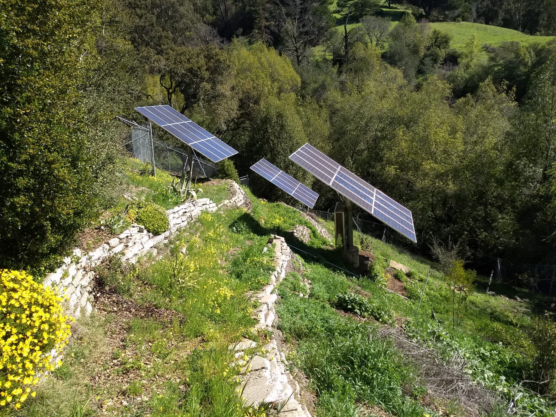

I have a 6kW 3 array hillside mount with panels now 15 years old.
Twice a year I adjust the angle and it's about a 5 minute job for all 3 arrays.
The mounts were expensive and required additional city inspection for the depth of hole and rebar...
My panels are 160W and now they would be double or more in the same footprint
My panels are 160W and now they would be double or more in the same footprintView attachment 1870533
What size are the 160w panels? I would bet money that you are virtually the same watt per square foot as modern panels. Density hasn't increased by a measurable amount. 320w panels are literally double the size of 160w panels.
I would need to measure and post as it was a long time ago…
