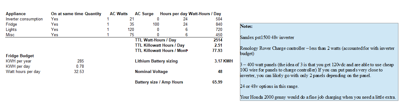

We have a off-grid camp and looking to update its solar power. Over the summer we'd love to keep a small 12v or 120v ac fridge there. Just 10 led lights, phone and tool charging. Maybe
100 amp hour battery since just fridge use is the heaviest load. 3 panels -- 1200 watts on the ground. No ac, no well pump. The only reason we're looking at a 12volt system is the high energy loss with many inverters. LiFePO4 batteries?
What is your thoughts?

I am a little unclear by what you mean by "high energy loss". Solar to 12VDC? 12VDC to 120VAC?
I would do the whole math around the particular model of fridge that you choose to get kWh of panels and storage and go from there.
For a fridge, I would take a long look at the AC/DC/Propane RV fridges to give you a backup in case you have a week of overcast midsummer. However, they are not high BTU fridges, and really expect to be cool and be loaded with cold food. 120VAC fridges run circles around them, but are not generally as efficient, though getting better. There are solar specific fridges, which are highly efficient and can take solar input directly, or on top of a battery bank.
I'd vote for LiFePo batteries.

energy loss with many inverters is high going from 12 or 48v dc to 120 ac. We bring potable from home and use creek or snow for everything else.

Chinese knockoff 12VDC fridges have flooded the market a few years ago. You no longer need to pay $1200 for a Dometic 12v fridge. They look more like coolers than actual small fridges. The ones I had my eye on are called ICECO, seem like their price has gone up since I looked a few years ago. They do use the better compressor, so maybe that is why they are so high. But a good sized one can be had for $250-$400 that will serve you well. I have a cheap one at my off grid camp and my 400W of panels and 200 Ah of Lead acid batteries will keep it cold without issue.
400 watts of panels and 200 Ah LiFeP04 batteries will be totally sufficient for your needs>

A fellow helping us say this.

A fellow helping us say this.View attachment 5416945
His comments look good to me; I like his comment of using 3 panels to get the voltage up, and if you can, try to ensure minimal shading. I'd be surprised if LED lighting turned out to be that many watts, but no biggie.
Renology makes reasonable gear in my experience. Perhaps not quite as bulletproof as Victron, but if the equipment goes out on you, it seems as if it wouldn't be a huge deal for you at the Camp. It isn't like being on a sailboat mid-Pacific.

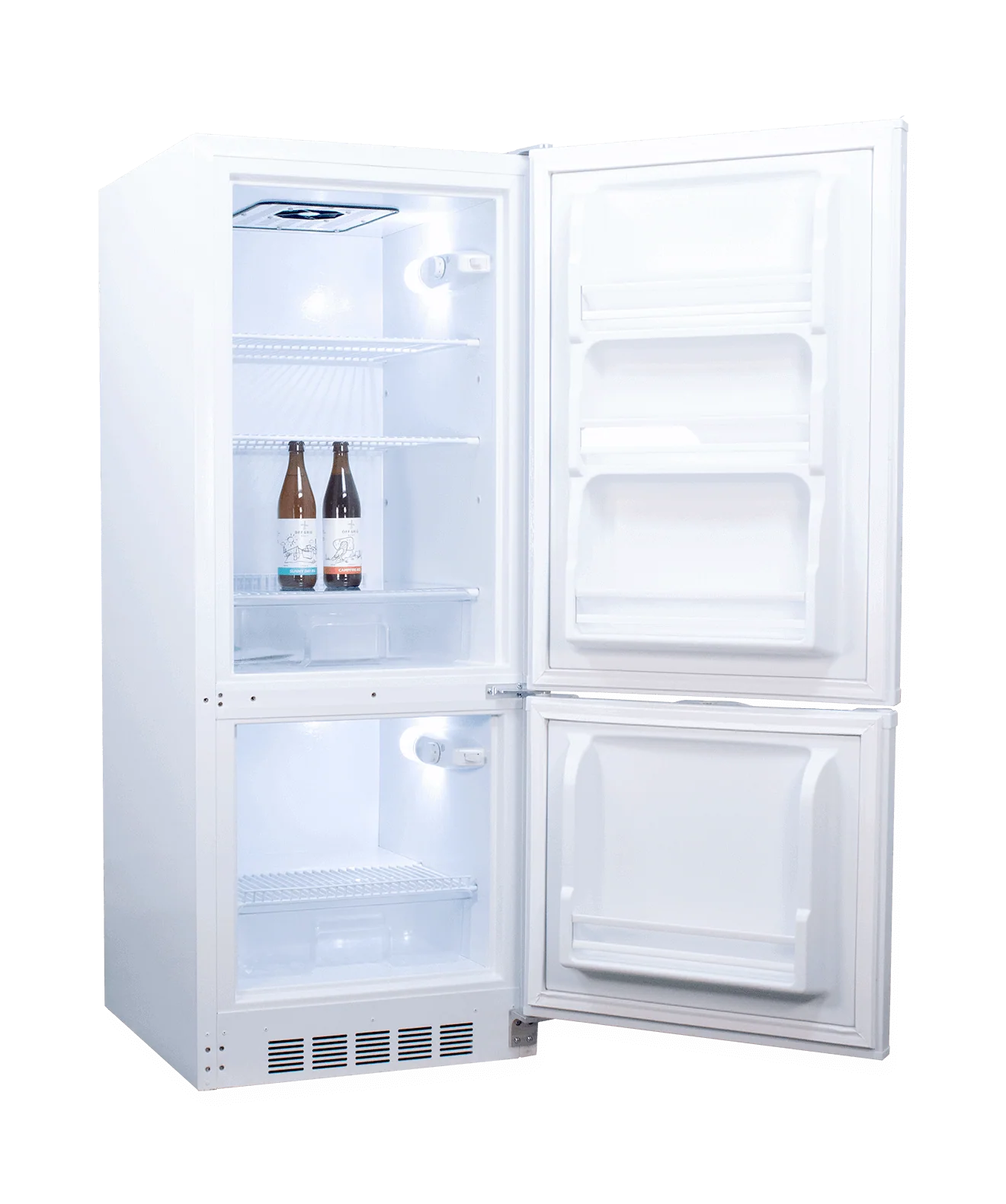

Here in a small fridge/freezer for $1600. What is your thoughts on a unit like this? Its draw seems reasonably low.
SunStar 10CU Solar/DC/AC Refrigerator (White)
Designed specifically for off-the-grid or grid connected use, the SunStar 10CU Solar/DC/AC refrigerator is an industry leader in this mid-size model category, and 100% Made in the USA. Featuring dual voltage options + dual independent compressors + dual thermostat cooling system (one for the freezer, one for the refrigerator compartment) this upright refrigerator can be used for many applications and built with energy efficiency in mind! Featuring an industry leading 4" thick polyurethane wall insulation, this SunStar refrigerator is built to last.

Amongst the offgrid community, Sunstar has a well deserved reputation from what I hear. The only thing that I have seen that was more energy efficient was a chest freezer that someone rewired a PLC to run at 40F as a refrigerator. We seriously considered getting a Sunstar here just for the energy efficiency at one point.
If you have the height, I would mount it up a little, otherwise the freezer is at an awkward height for most folks. (Cinder blocks?)
I think that the big advantage of electric over propane refrigerators is that the electric have much stronger cooling abilities, so they do better with the "Friday night loading" common for weekenders. I've used both, and they both keep food cool. It is just that the AC versions can cool food much faster. Rather like owning a VW bug; it will get you from A to B, but it is never really going to haul a horse trailer, or get you there quickly.
