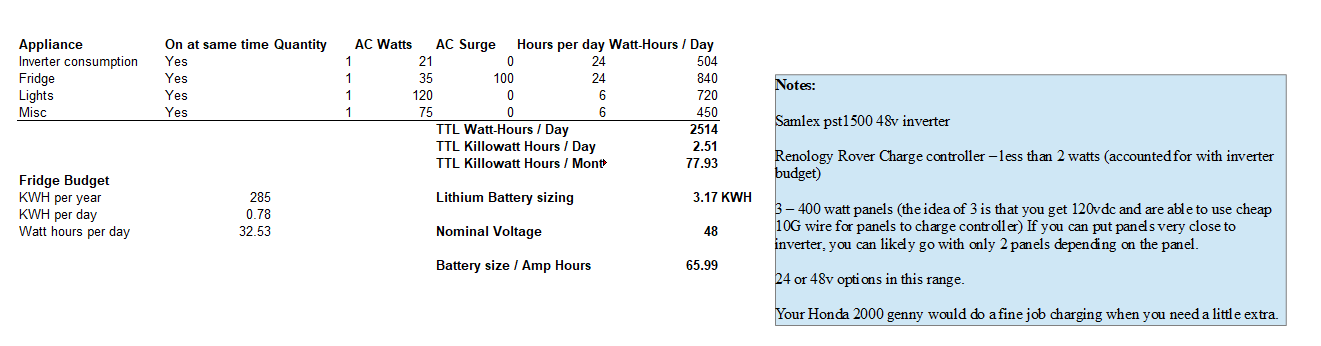

Not exactly. The 12v/propane fridges are power hogs. The 12v only ones don't use that much. However for the price difference of a 12v vs 120v fridge with inverter and more battery is about the same. But with 120v power you can run alot more stuff.
I suggest not trying to save a few watts by spending alot more on low voltage/propane appliances. A 100ah lithium battery shouldn't have much trouble running a small/medium sized 120v fridge especially since you have 1200w of solar.
A few months ago for our offgrid cabin i bought a $200 7.5cuft 120v fridge. It uses about 70w of power and runs about 50% of the time. Thats about 140ah. You will have solar input durring the day so using 140ah off a 100ah battery isnt to bad.

I would look hard at the numbers. I don't see 12V as saving much in efficiency. 120v fridges are cheap and sometimes free.

I suggest not trying to save a few watts by spending a lot more on low voltage/propane appliances. A 100ah lithium battery shouldn't have much trouble running a small/medium sized 120v fridge especially since you have 1200w of solar.....
Maybe you should game out both 12v and 120v options. Include total cost of generating energy and cost of appliances. If they're close, 120v offers more flexibility and future upgrades.

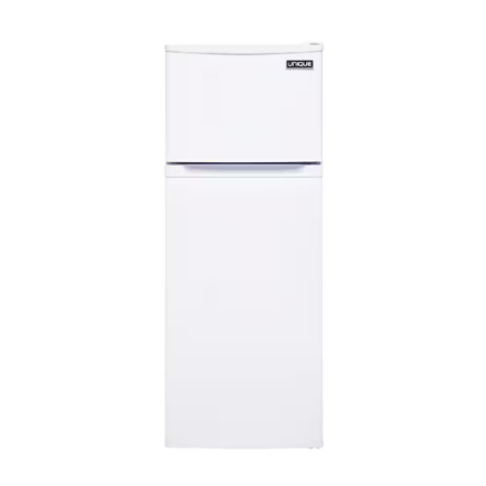

We will get a 120ac or 12v-40vdc fridge. Not propane and we have not mentioned them here.
Our goal is not be hauling Jackery or Bluetti battery's in and out.

Personally I'd overbuild the 120v AC setup a bit - get a few more kWh - and buy a normal AC-only fridge.
Buy once, cry once (we're not talked a ton extra here anyways); set it up once, be freer with the power budget in the future, and not be too worried about an expensive fridge crapping out because you can shop the normal fridges.
