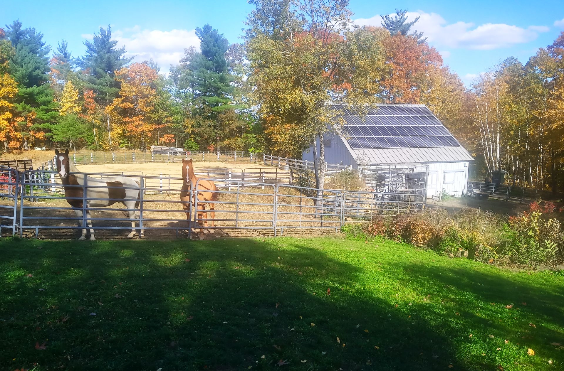

If I was younger, in a place with more sun than VT, I'd do it again, the same way.
Both valid points. Like you, I'm in northern New England and at this house we get almost no direct sun from mid Nov. thru mid Feb., the exact time of year our electric usage is the highest. Sun's just too low in the sky.
We're both in our mid 70s, not likely it'll pay for itself in our lifetimes.
6kW with 160W panels 2008 and SunnyBoy Inverter
