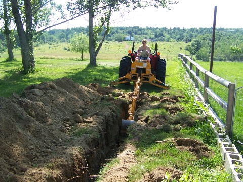

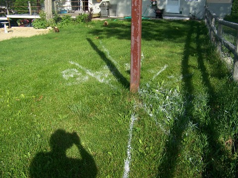

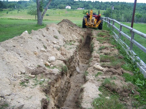

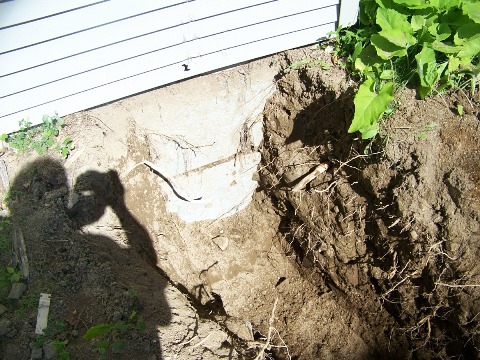

Here is the study that I did to find the optimal direction for the panels.
I painted lines in the lawn by the clothes line pole. 6:30am though 6:30 pm. Them I measured out 10' feet each way and put a pin. This allowed me to pull a string and have the proper long day orientation.
The trench starting at the house.
My wife first time operating the BH
The completed trench 70' Long 4.5' deep.
Phil

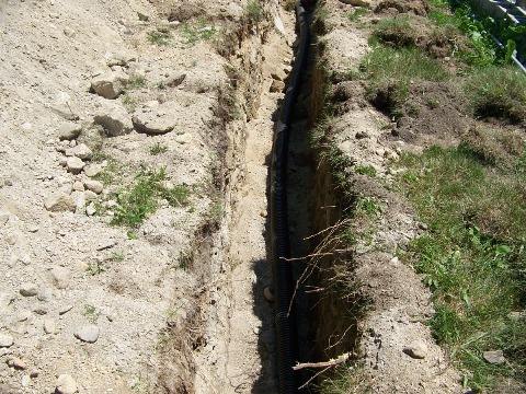

Back to more pictures.
The trench had about 60' of gravel and 10' of clay.
I used wood boiler pipe.
The first plan was to cut 2' thick foam and dado to lay in 2 1" type m copper pipes and then cap with 2' pink foam and back fill. I had a concern if ever a leak that I would have to dig it up.
The boiler pipe is 2 1" pex triple foil wrapped and in the corrugated non perfed pipe.
18" above that I put a 1/2" pvc pipe for the panel thermostat wire.
The last pic is the auger that I use to put the sonotube in for the panel structure. the holes are placed 12' on center using the orientation from the study.
I did originally plan on putting the panels on the roof but the angle was not optimal.
Phil

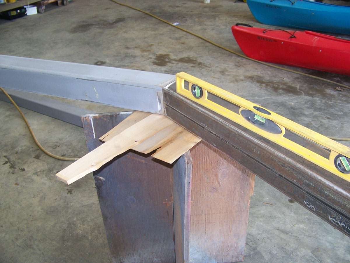

I will be using 3 panels 47-1/4" x 95-1/4"
2 footings 1 frame details to follow. The plan is a closed loop with glycol.
Here are some pictures of last weekends work.
The steel prep, I know everyone likes to see welds this was done with a Lincoln 125 .023 wire and stargon gas.
the assembly and paint crew.
Last but not least the frame cemented into the sonotubes.
The steel verticals are 4x4"x3/16" and the angle is 60deg.
the horizontals are 3x3"x3/16" sq tube.
Height to the bottom of the frame is 5' and we set this inplace
with the fel on the 1260:D
Bonus was the 1260 has reached 400hrs.:D :D
