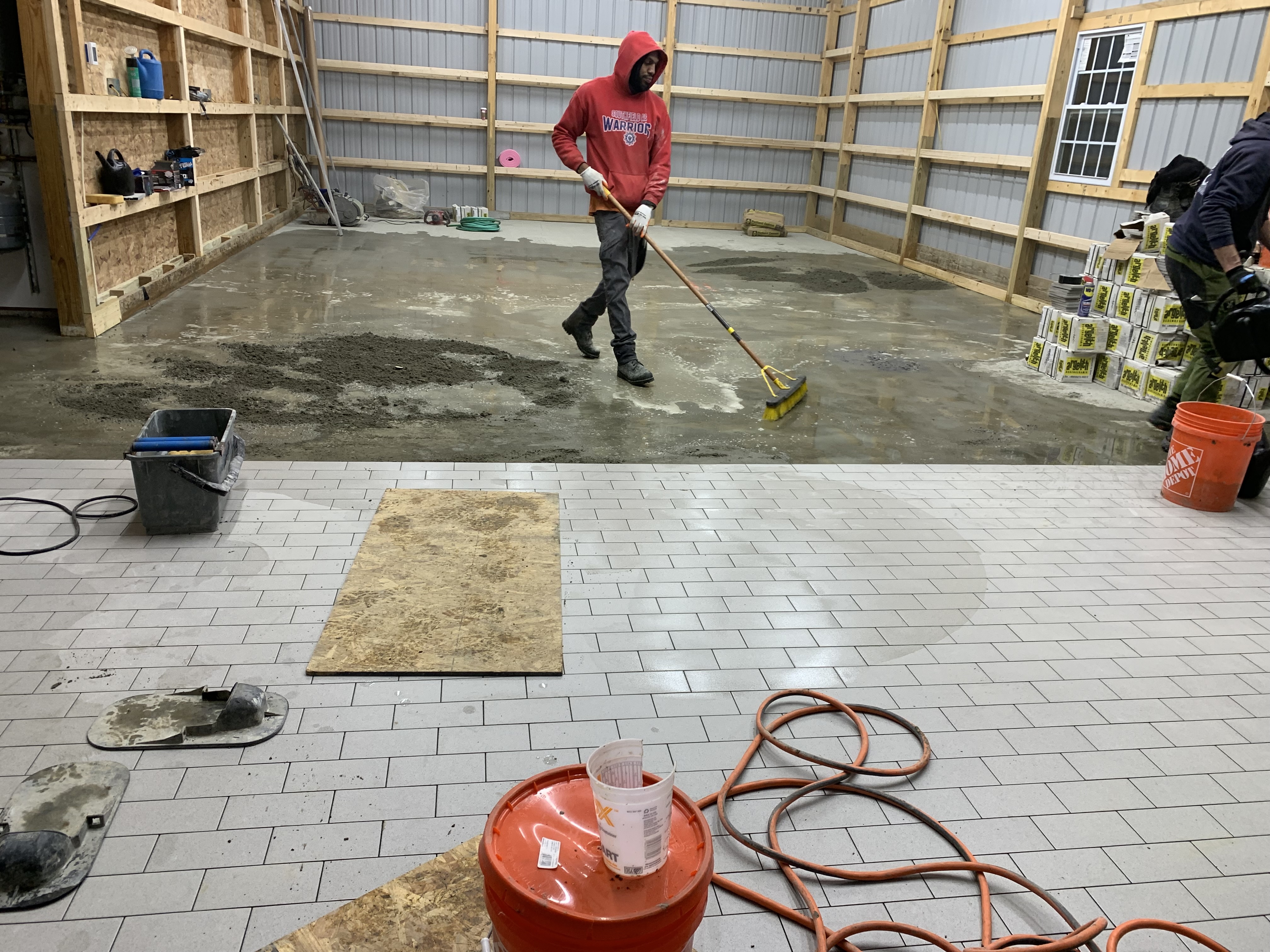

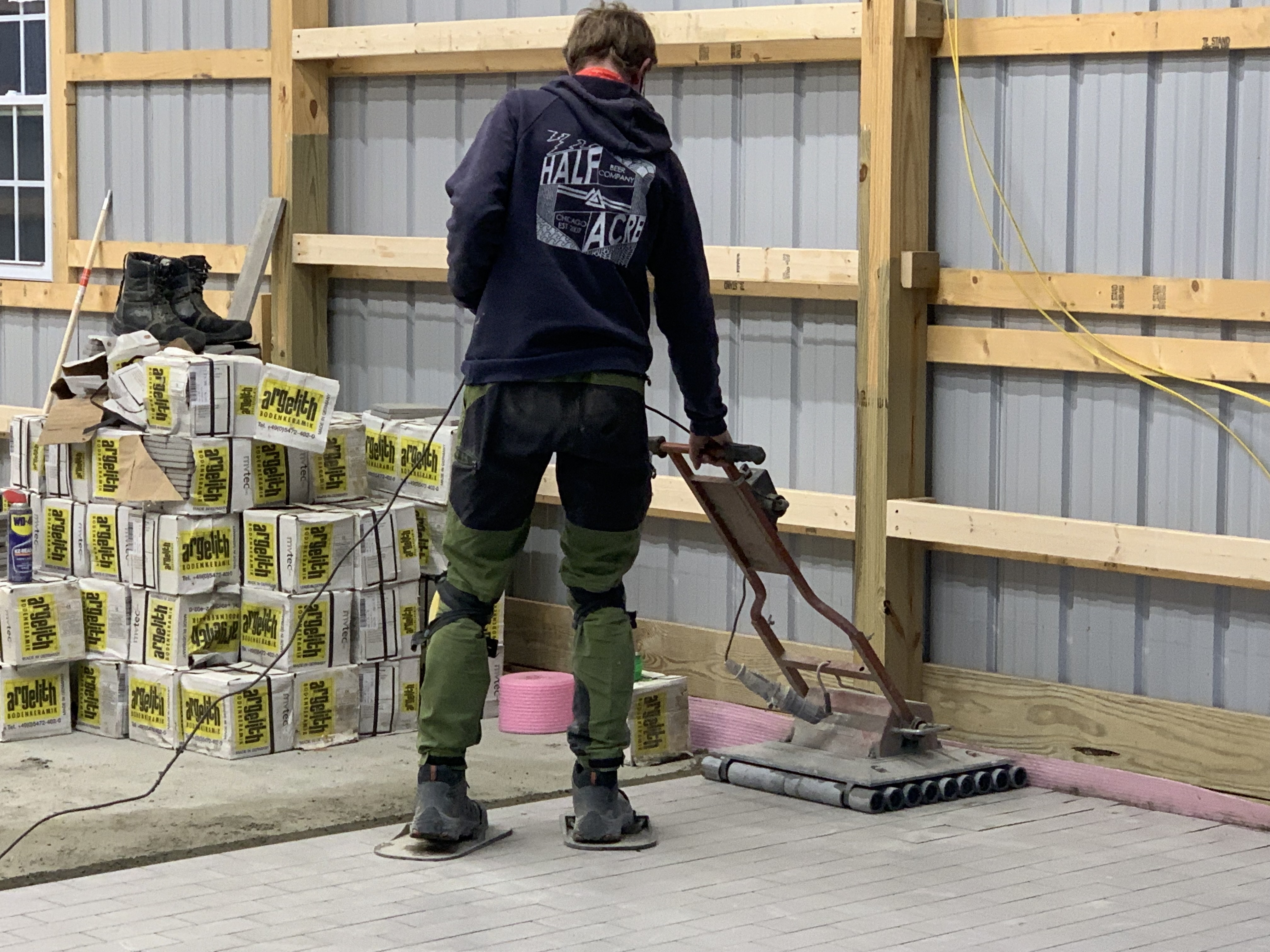

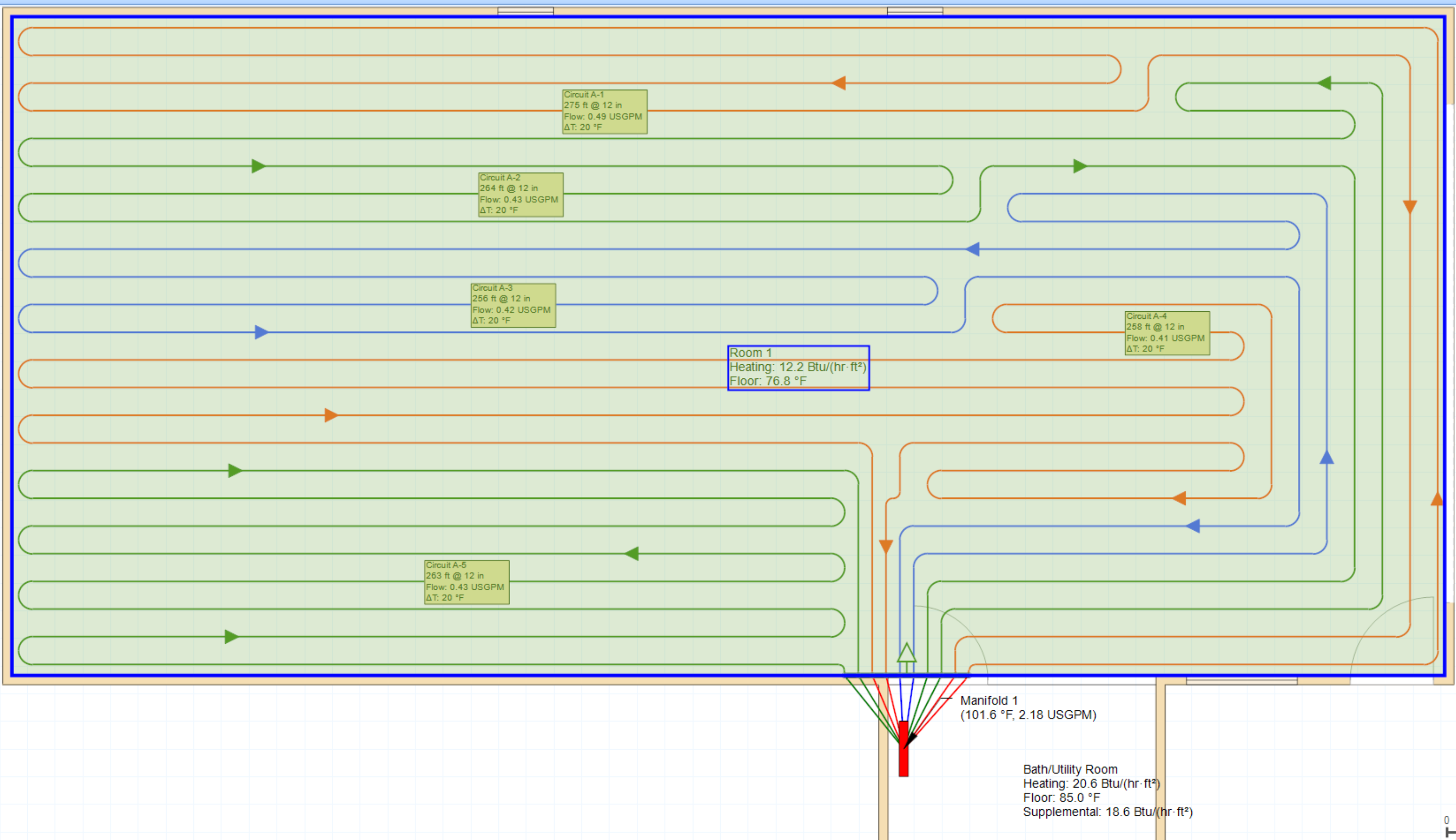

I got an estimate back from Creatherm. For 100 panels, it would cost me about $1700 for the foam panels, which includes shipping. This is for a three-car garage. Plus the PEX, manifold, piping, water heater, exhaust, and wiring. I am starting to hesitate on this.
   / Need Help Finding Suppliers for My New Garage - Radiant Heating
#35
Did some more thinking.
I am going to install foam under the concrete anyway. I will need to put down mesh as well. So all that is left is to install the PEX before the concrete gets poured. Whether I use it later or not is a separate issue. Now I need to decide if I go with something like Creatherm panels or just Foamular XPS 250 and attach the PEX to the mesh with zip ties. The Creatherm is about $500 more expensive but is easier to install the PEX.
