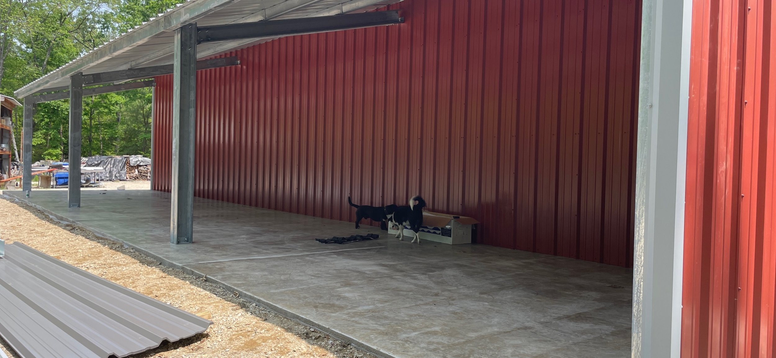

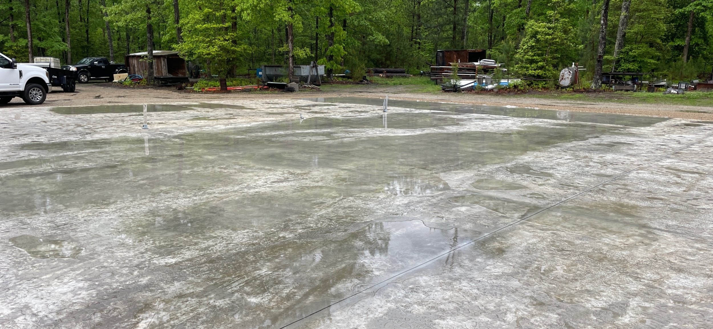

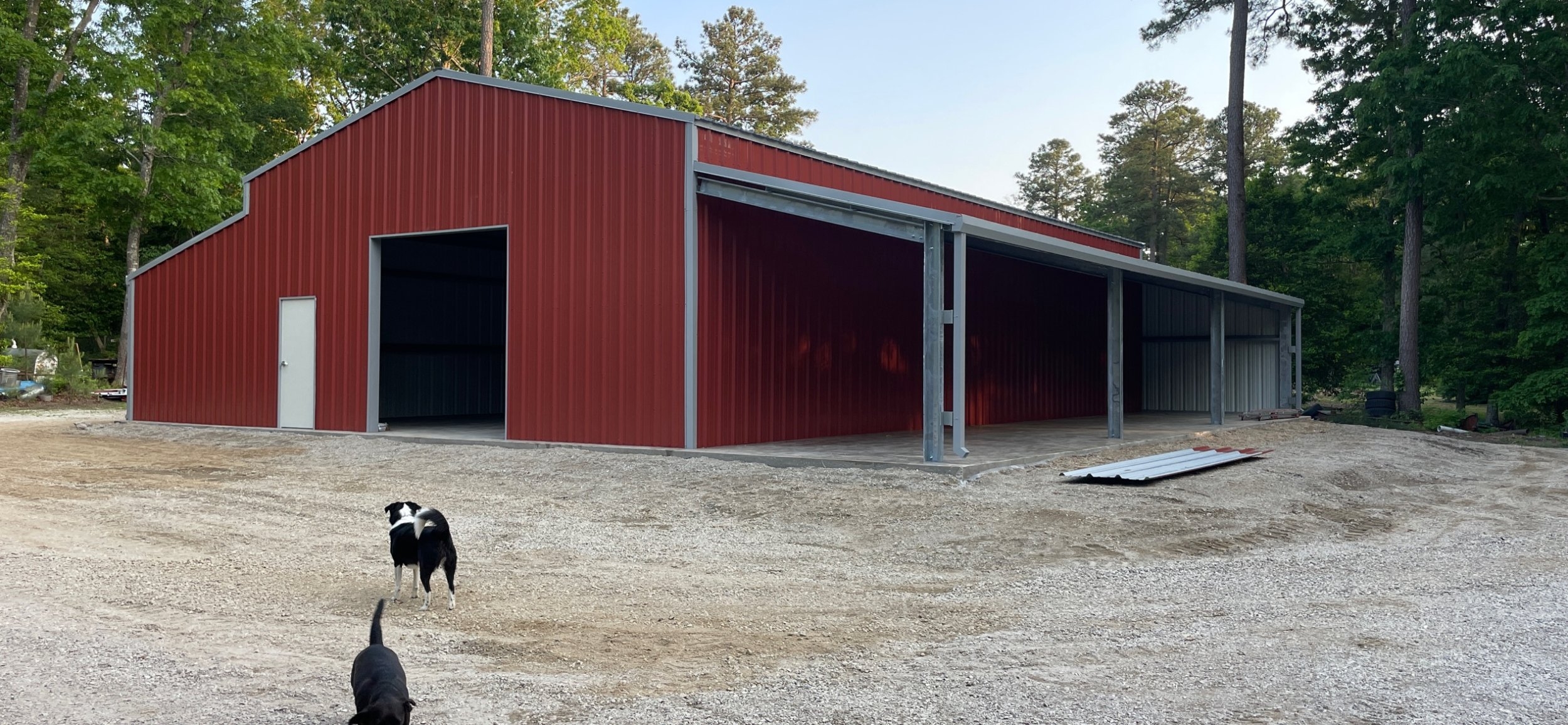

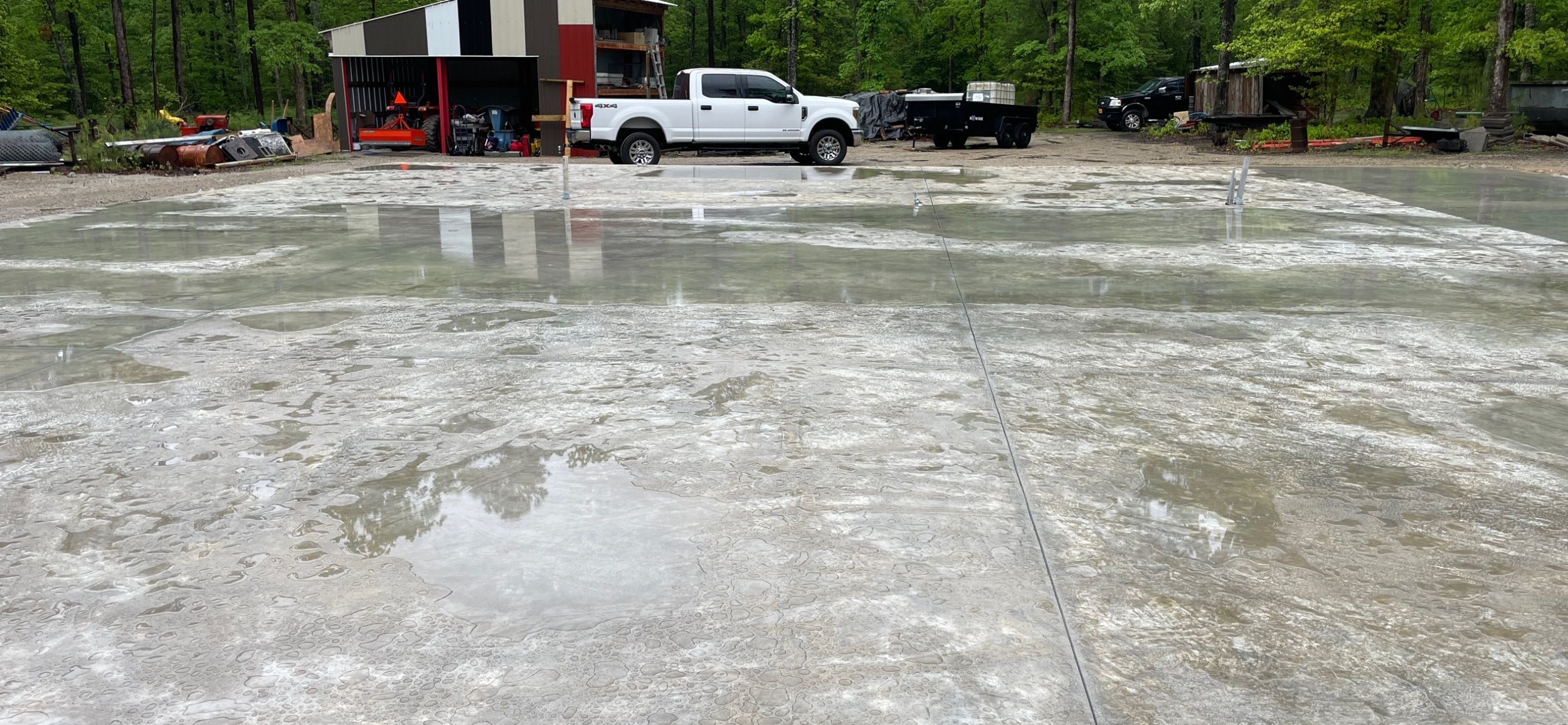

I just had a 60X60' metal building put up and Everything is wonderful accept the lousy concrete pour. Aside from having a bunch of cracks everywhere there is a low place in the center of the floor where water will hit the concrete out in my covered side shed and end up piling up on the wall and seeping under the metal and ponding in the center of the shop floor. I have tried to seal under the metal with every kind of sealer known to man with little or no help. Every time it rains I have to go out and squeegee the water off the concrete to keep it from flooding the floor. When it rains hard enough there will be a half inch of water standing right up on the wall.
I've thought about getting someone to come out and grind the edge down in hopes the water will run out into the gravel but am wondering what that will look like in the end. I was going to enclose the first 20' and turn it into a tool shed but that part of the concrete doesn't seem to pile up there it's the middle section that is low and is where the problem is at. I decided to enclose that part and turn it into a screened in area which I was going to do eventually anyway but I don't even know if I will be able to keep the water out even with that going up. This new wall is going to be wood framed with metal on the outside walls accept where the screened in part is. The problem seems to be I can't find anything that will stick to this concrete. It will seal for a week or two then start to peel away.
Also, on the back of the building there is 1' of concrete that extends out from the wall. That was kind of my fault because I misunderstood the building people when I got the dimensions of the concrete slab. They kept talking about a 6" lip around the outside perimeter and I took that as meaning concrete extending 6" out from the building wall. I still don't know what the 6" lip thing is they were talking about. The guys that put the building up pointed this out and we decided to shift the building 1' to the back and 1' to the right side and that took care of the problem on two sides but now water will hit the rear wall, run down and hit the concrete and come in under the metal and into the building. I put up white metal siding on the inside walls and it's already starting to rust the bottom edge of the metal. I've tried sealing it, cutting lines every couple feet, and it still gets in. Plus, all this he was to put aprons at the two big doors and at each entry door which he never did, and water will hit the concrete and come in under these door entrances too like it knows what it's doing.

Well, I already have gutters on the open side shed part. It's the rain that falls and hit's the concrete then in that one area. To fix the thing right I would have to take down the whole building tear out the floor and get someone that knows what they are doing and repour the whole floor. The inside of the main part of the building is 32X 40 and there is a low place tight in the center that takes up almost half of that area. The concrete in that middle section has a low spot about 8' wide and extends all the way to the center of the floor. It's like a creek feeding a pond.LOL
I could tell there was going to be a problem as soon as I pulled the polly off the top of the concrete when he came back a week later and cut the lines in the floor. That was the problem and reason for all the cracks that are now everywhere. The concrete had already relieved itself before he cut any lines. Once the concrete dried after uncovering it I could see all the low places because there was water standing. I asked him about it and he said that was normal and that was a second or two before I ran him off. At that point it wasn't much I could do. It wasn't worth getting a lawyer involved because he didn't have anything I could go after.

I don't have any pics of the back wall that can tell you anything, but these may give you an idea of what I'm working with. That middle section in pic #3 is where the water trails from.

Nice looking building. It looks like downspout extensions would help getting the water away from the slab. I don't know why it would have a bunch of cracks in it though.

one thing they did do right was pour concrete AFTER structures were built so the pad is 4" above finished grade. at least i dont get any water intrusion. but mine is pole barn structure. yours looks to be metal frame and truss, and those get built on pads
