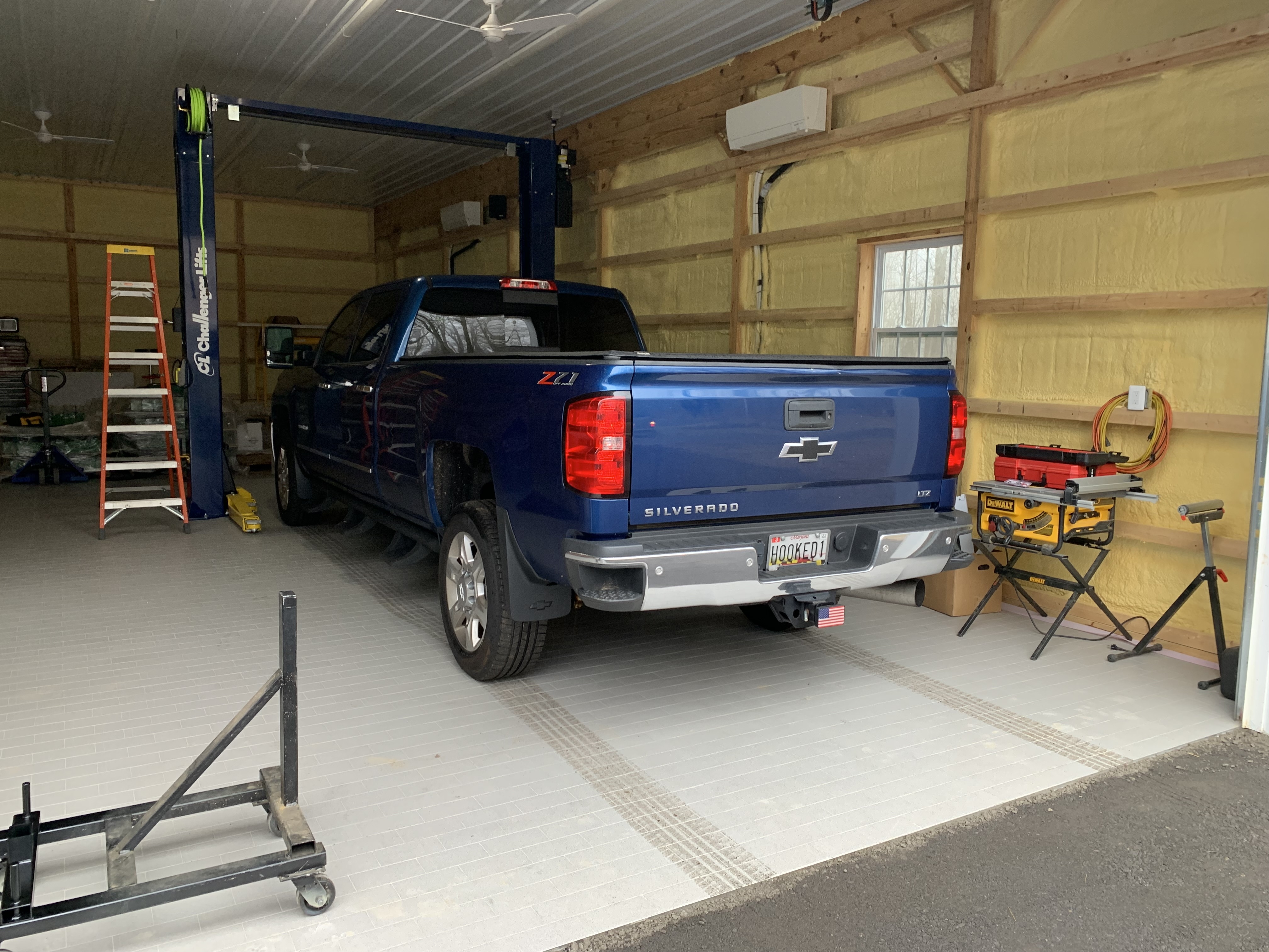

Wow, you put tile in your pole barn? Never seen that before.
Do you have a finished photo?
Yes, it's called 'clinker' tile, using in many auto dealers, auto shops, factories and breweries now.
