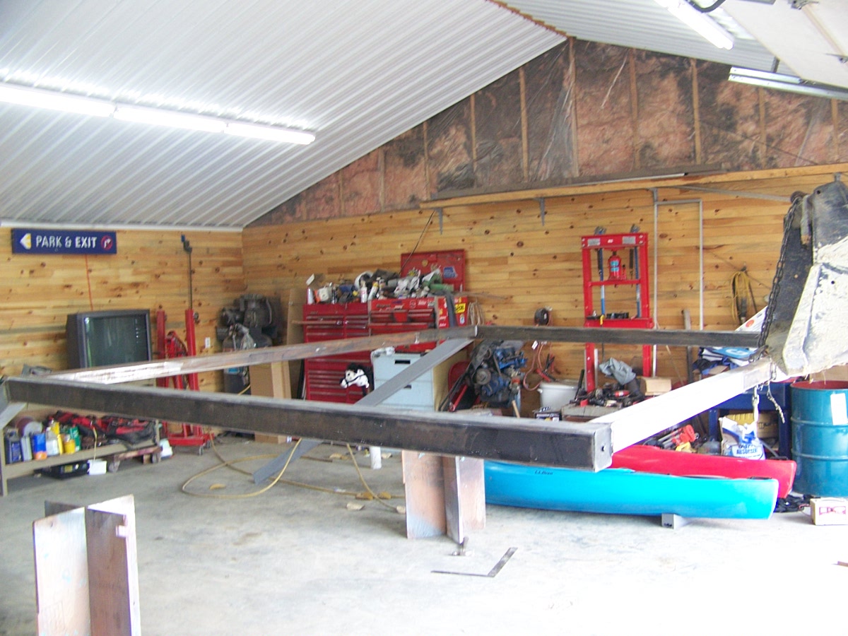

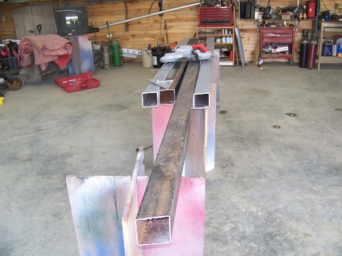

Nice looking frame:
one thing I was wondering was how much weight are you going to have up there in the solar collector, as with that 6- degree angle it may get wobbly in stiff wind? A center brace down to ground might be needed from center top 90 degrees to earth ref. similar to those incased in the cret/sono-tubes...
just wondering as by time you get back plumbing and front onto the frame it might be back heavy. (cant remember were you using the glass vacume tubes?

Each panel weighs approximately 125 lbs. I designed the frame and base structure with our sign base software. Wind load was more of a concern so I based it on 40lbs per sqft. The alternate plan would be to add another frame on the opposite side and turn it into a shed to store the tractor implements.:) We chose the flat panels.
