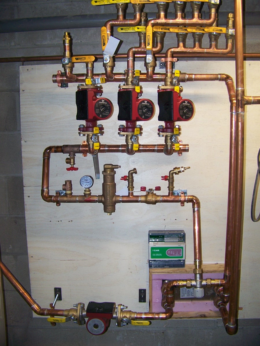

Here is the picture of the radiant side. The 3 upper circulator are for the 3 zones. The bottom one is the system circulator. It runs the water from the 2 tanks thru the heat exchanger.
Today the water temp hit 165degs

nice job on the copper control valve install. looks good.
