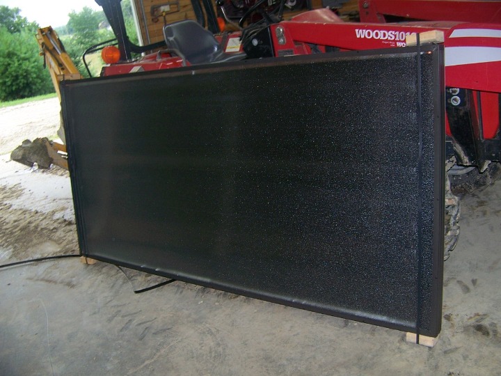

the vacuum tube ones we used worked great for 20 years - boiling water while it was in the 30's and raining outside. Could not have been happier.
Ken
/ Solar radiant Heat
#92
ksimolo,
I agree that the tubes do heat the water up hotter than flat panels. They both have an advantage and could compliment each other if used together. I would like to add a rack of tubes on the return of my flat panels. The flat panels would preheat in the early day and the team would deliver higher temps though out the mid and afternoon.
Today its in the high 40's ,fog, and thick clouds.
panel temp 65 bottom temp is 63, ground water 51 still a gain.
Phil

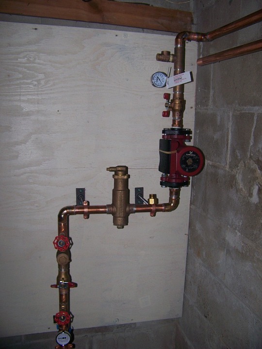

Good Evenin Phil,
I just read through your thread this morning ! What a great thread , with a bunch of valuable info ! My hats off to you on all that copper plumbing, absolutely beautiful work ! I have sweated a few pipes when the need arises but nothing like that. I will be real curious how this whole system works out through the course of the winter ! Thanks for all the info and associated pictures.
#94
Hi Scott,
Thank you! My main resource for most of the product comes from Radiantec in Lyndonville, Vermont. They have the manifold all soldered together in the proper order. How ever to install I had to cut it apart and assemble to fit my space. Thanks giving weekend we will be running the floor tube. I've been extremely busy at work other wise it would be done.
Phil
