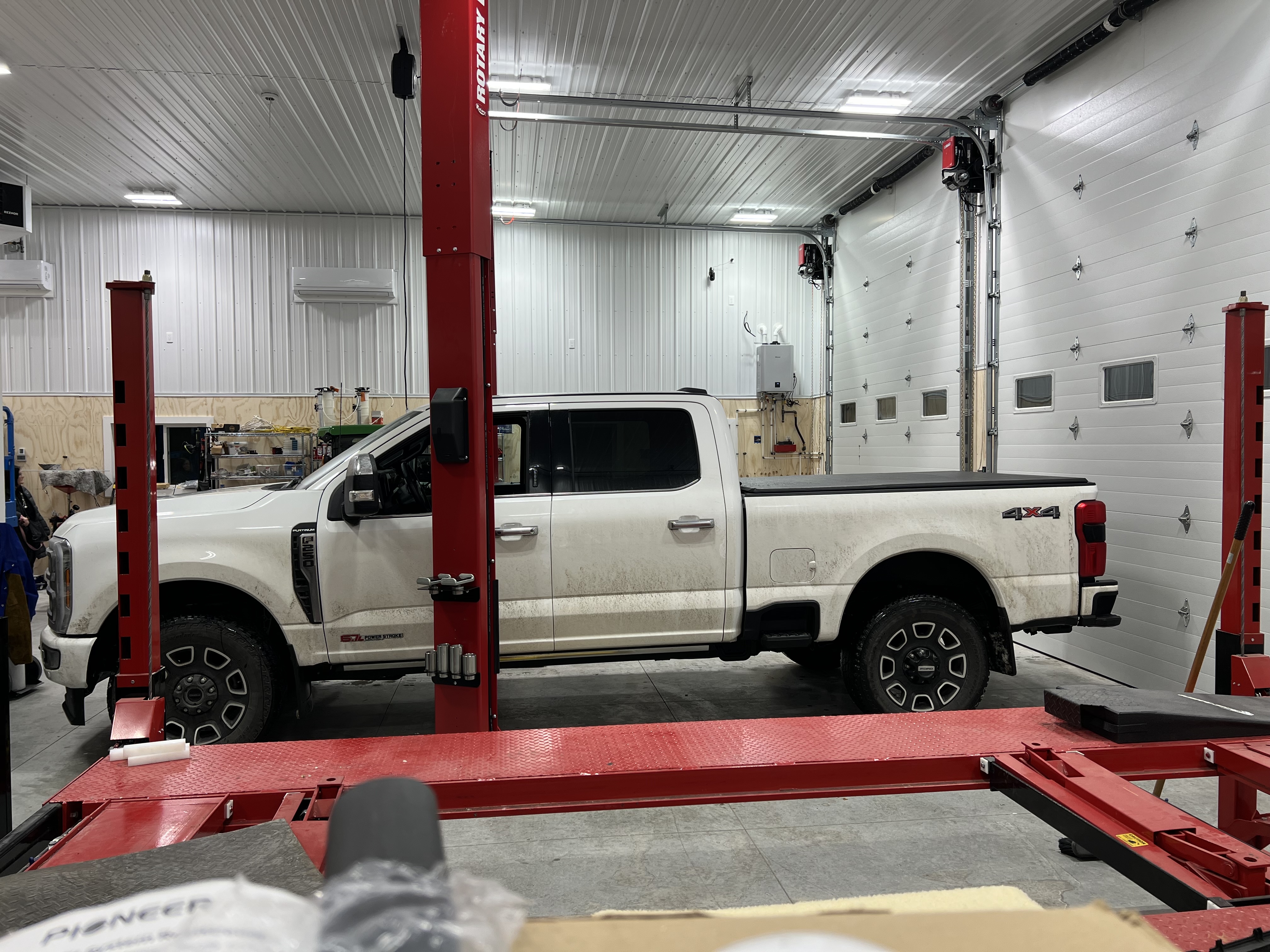

My shop is 30x53x14 post frame construction. The solution I went with was 3/4" OSB laid on it's side all around the base of the walls. Above that is white metal the same as you would use on the exterior and then on the ceiling. OSB at the base because it will stand up to inadvertent bumps etc. better than metal. The ceiling is also lined with the white metal. The beauty of the metal is the wall sections were cut to length so they went up fast. The ceiling pieces were rolled and cut to 30' lengths and also went up quickly. There are nailers every 4' from truss to truss so the ceiling metal could be ran across the span easily. Then I blew in fiberglass insulation 15"-18" deep in the ceiling. The walls are 5-1/2" kraft faced fiberglass bats. The electrical is ran in conduit around the perimeter. The lighting is high bay LED lighting. I have radiant floor heat and two 18,000 BTU mini splits for summer time air conditioning.
You have lot's of options obviously. My daughter just built a barndominium and dry walled everything but the great room ceiling, She chose tongue and groove car siding for it. She also went with radiant floor heat and put in duct work for and air handler/mini split setup.
/ Shop Interior Wall Panel choices #42
we outfitted a nice workshop in a hotel with plywood covered in white Fiberglass Reinforced Panels. You can mount anything you need anywhere into the plywood, and the FRP is easy to clean, rodent proof, and it reflects light well.
/ Shop Interior Wall Panel choices #44
That minisplit handles that?
There are three mini splits, 2 on one wall and one on the other. Until the temperature gets above 85° outside, one will handle the cooling load.

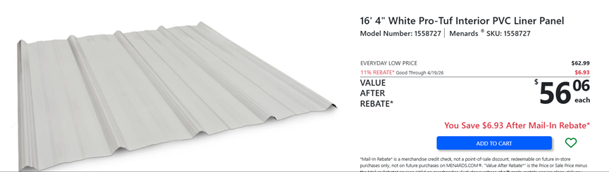

Has anyone used these PVC panels?? Would be easier to cut openings for electrical boxes, etc. Thoughts?
They wouldn't be very durable. Thin PVC like that cracks easily, especially in the cold. Be real easy to wack it with a board or whatever and put a hole in it. Also easy to melt a hole in it when throwing sparks at it with a grinder or torch, if that's something you do. It's not particularly difficult to cut holes for outlets in metal siding. Use a step drill and drill two opposite corners of the hole, then cut it out with snips.
/ Shop Interior Wall Panel choices #48
I’ve not used pvc roofing panels. I put flat pvc boards in my pool pump room. Cleaning the filter dumps a bunch of water and I wanted a wall covering that would tolerate getting soaked in salt water. I wouldn’t use them in a shop. One is straight up cost. It was way more expensive than metal siding or OSB. It’s not very durable either. It’s comparable to drywall in strength. Thin pvc like that doesn’t cut very well either. They make dedicated saw blades for it but the easiest tool is a grinder. A cutoff wheel cuts it quickly and doesn’t chip it.

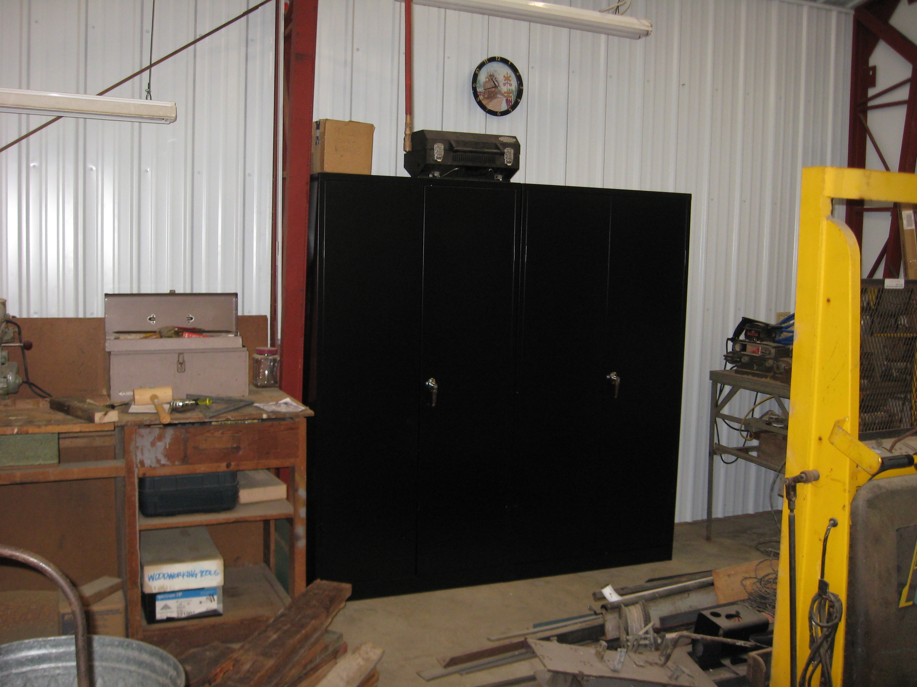

I went with cheap steel storage cabinets from Office Depot. I like the clean look of having everything put away. Excuse the rest of the mess in the photo, that's what happens when you finish out a building after you already moved into it...
/ Shop Interior Wall Panel choices #54

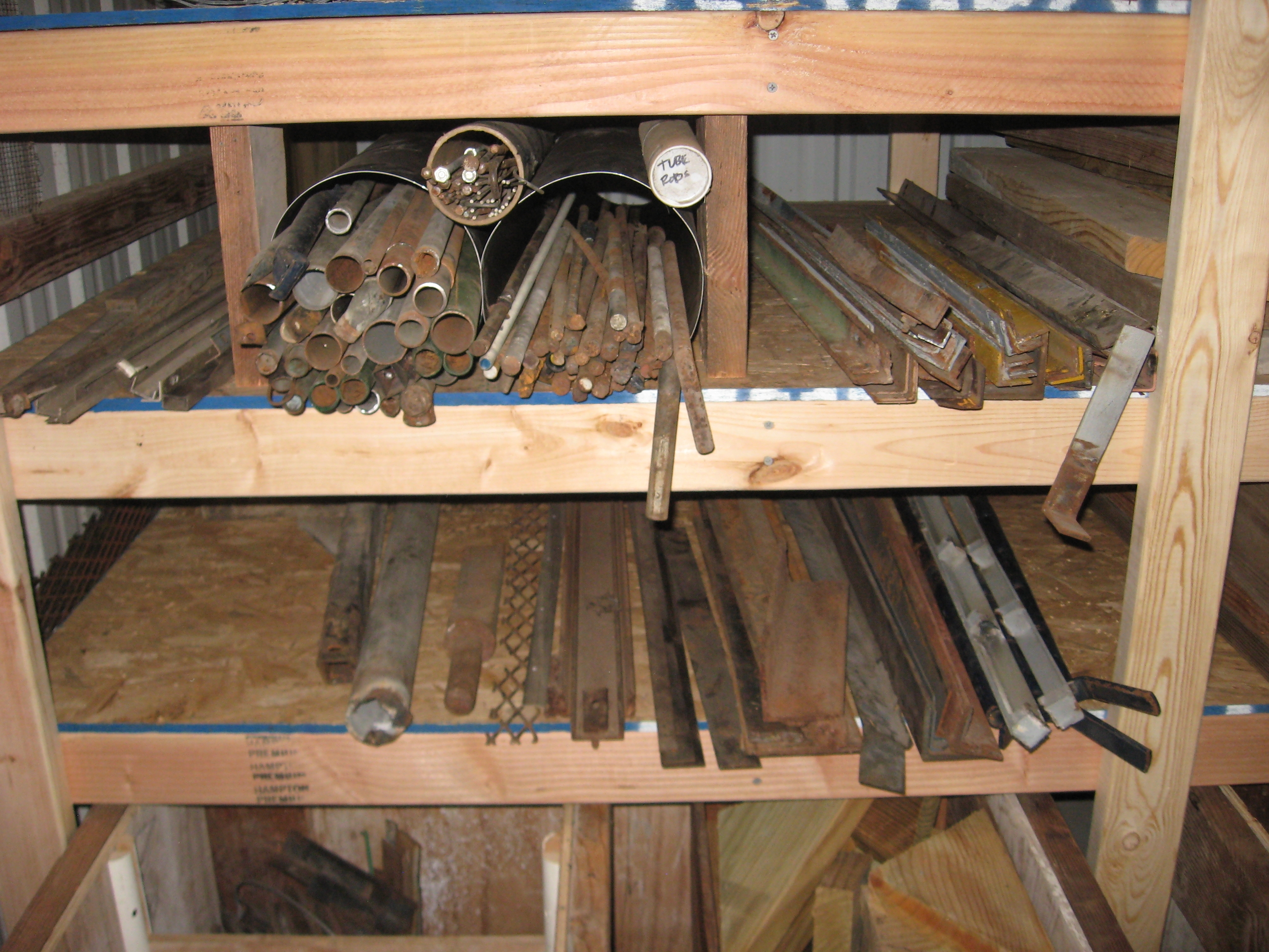

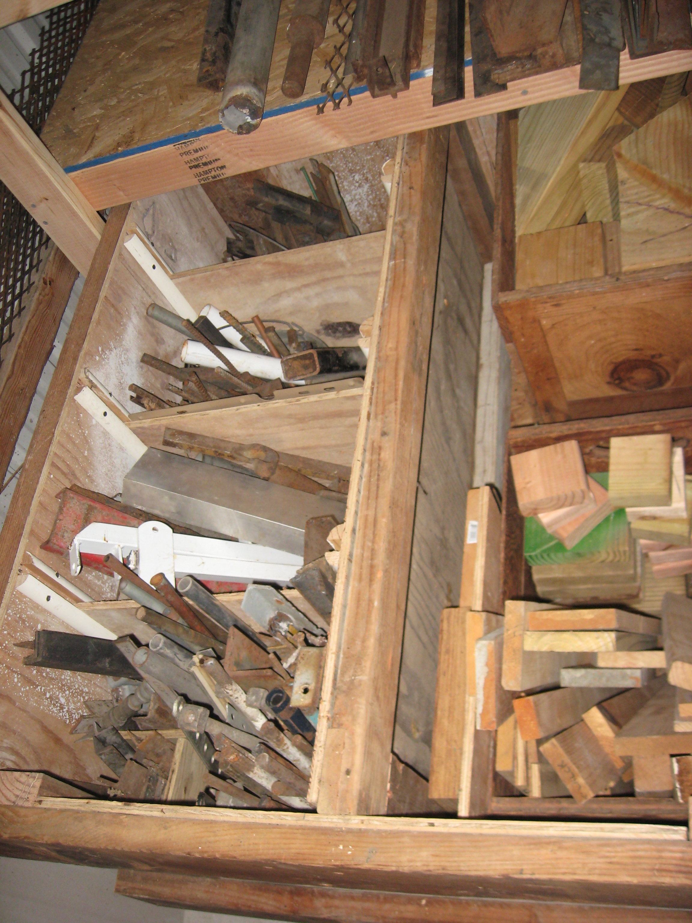

I did the same. I don't like the cluttered look of shelves and having everything getting covered in dust. The one thing I haven't found a good solution for is how to store short metal pieces for the lathe & mill.
/ Shop Interior Wall Panel choices #55

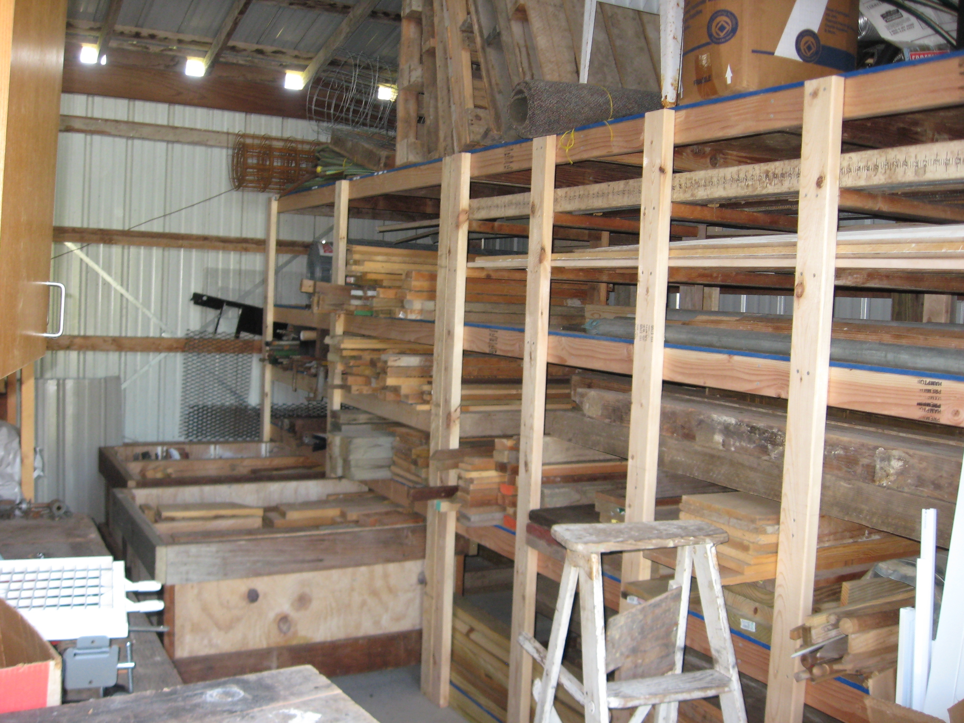

I cheated and moved them to another building. Built a wood and metal storage system just for all that stuff. Out of sight, out of mind.
#56
That's the problem I am already having. I'm not done with my main structure and already thinking of the other buildings I "need"...
