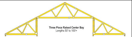

What spacing are you using for your trusses?

2' o/c trusses.

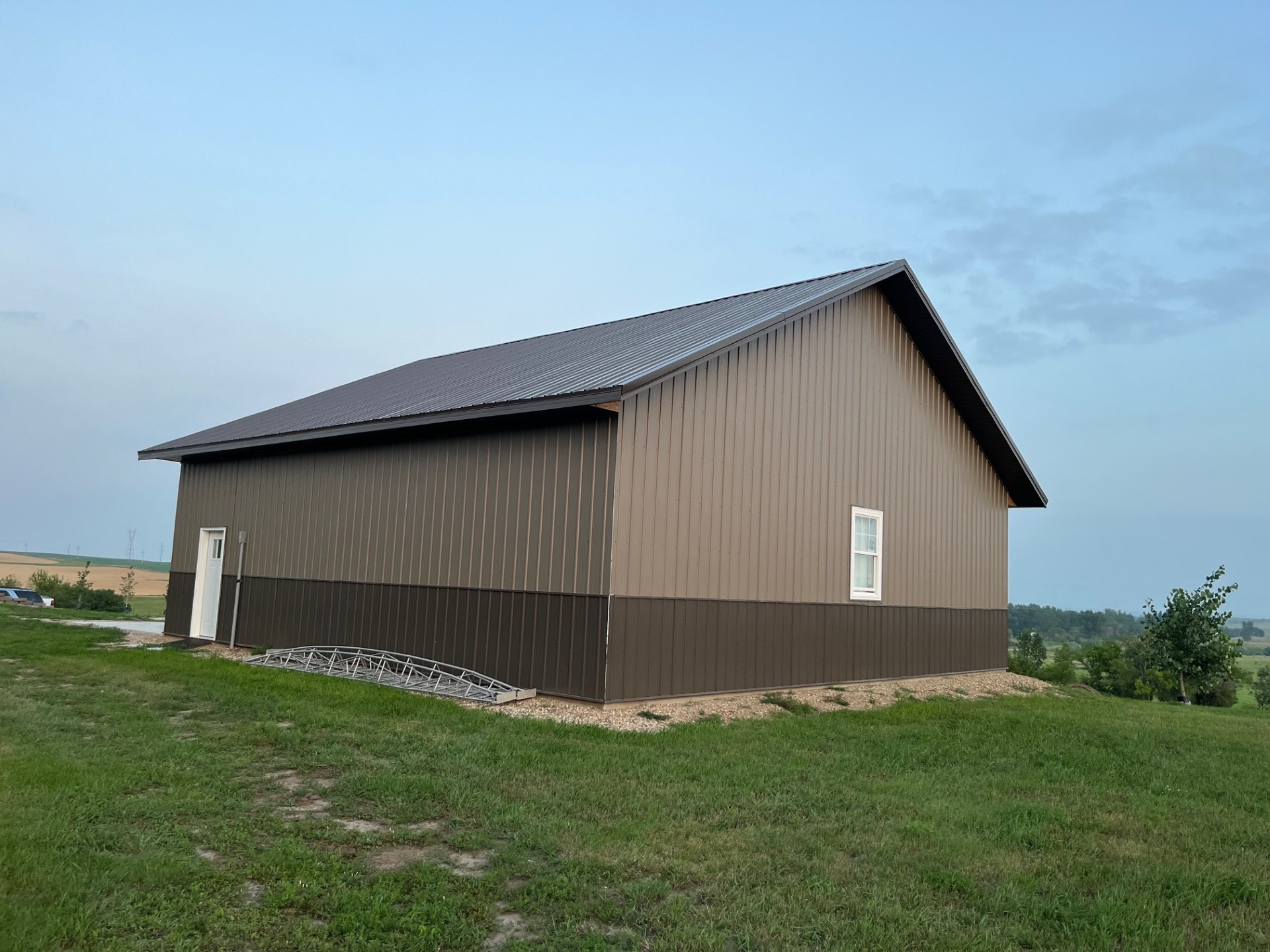

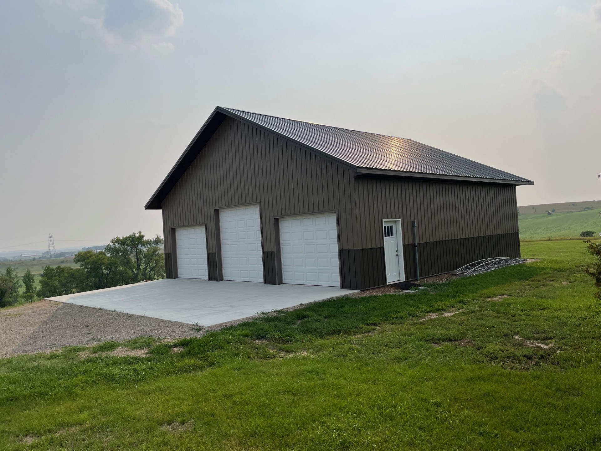

Looong overdue update.
40x40 with 12' 2x8 walls. 1/2" OSB with Menards Pro Rib on outside, now doing the ceiling with the same metal only white and then will blow in R-50 fiberglass. Walls will get 2 layers of batts. Slow going for a one-man-show but I am very happy with it so far.

Thanks. Needs gooseneck lights on the exterior, door weatherstrip and deco corners before the exterior is done-done.
Now I am racing Mother Nature so I can heat and work in it this winter.
   / New 3 stall shop suggestion requests #33
Very nice-looking building!!! I really like the two different browns you used for the walls.
   / New 3 stall shop suggestion requests #34
Nice looking building. When you get the inside finished lets see some more pictures.
