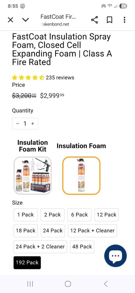

So, im coming up with a very fast, rough, 2800 sq ft of wall and roof area. It could be as low as $2.50-3/ sq ft per inch, but upto $9/board foot.
So, im thinking a min of $8,500; on upto $25,900. I have seen some people report as low as $1.50/bf; or $4320; but i doubt thats the price a homeowner will ever see.
If its much higher than $7500, I would seriously look at a kit. Kraken has a fire rated, 1900 sq ft kit, at $2999.View attachment 4274868
I did 2" closed cell. I wish I did more thickness. Buy once, cry once. The money I saved going only 2" disappeared into propane bills shortly after.
I tried one of those kits for a cold cellar ceiling and said never again! It's a messy nasty job. The pros use heated kit with high pressure metered pumps. Everything requires maintenance to keep running smoothly.
The home brew spray foam kits give you a few spare cheap nozzles and good luck keeping the nozzles unplugged and chemical ratios consistent. They are designed as single use throw away when you are halfway through the job.
