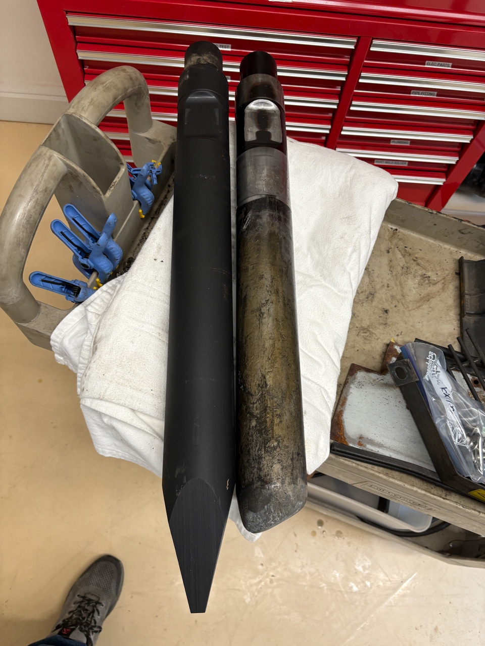

Just make sure the chisel is well clamped down before you try it.
For sure, but I'm still struggling with how/why a carbide saw blade will cut the material where a mill that presumably also has a carbide blade can not. Is there something different between the two? I don't want to just trash a $150-$200 saw blade.
/ Another barn build #44
Well I'm not saying it will for sure cut the bit but I think it's worth a try.
A machinist will look at it from the point of view of making money on the job. By the time he builds something to hold the chisel securely he can't charge you enough to make it pay for his business. Especially if it's only a one time job. You on the other hand are looking to stretch out your $700.
What I would do is take the chisel that you showed us a picture of and try to slice a little bit off the tip with an old blade. Then you'll have an idea if it's worth your while to proceed further.
Now I don't know where you are buying your blades. I pay roughly $35 to $55 in USD ($50-$80 CAD) at Princess Auto if I catch a sale. I believe $80 is their regular price but I haven't bought one for a few month's. I usually keep 1 or 2 blades in stock depending on how old/worn my current blade is. This is a 14" blade.
If I'm careful with the blades I can usually get the same amount of cuts as if I was using the equivalent $ worth of 12" abrasive blades. And carbide tipped blades just cut so much nicer.
I mostly use my abrasive saw for hand held work. Stuff that I can't hold in a vice and I use the carbide tip for everything else. If I get a rare good setup I can cut right down the edge of a piece of steel with the carbide and just skim the paint.
