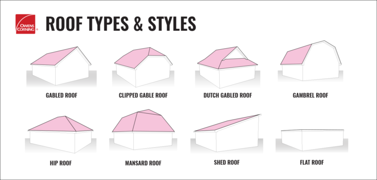

Gambrel and hip roofs are different.
Roof_types_styles_illustrations_1540x738-770x369
/ roof leak
It is a gambrel but most people around here call it a hip for whatever reason.
