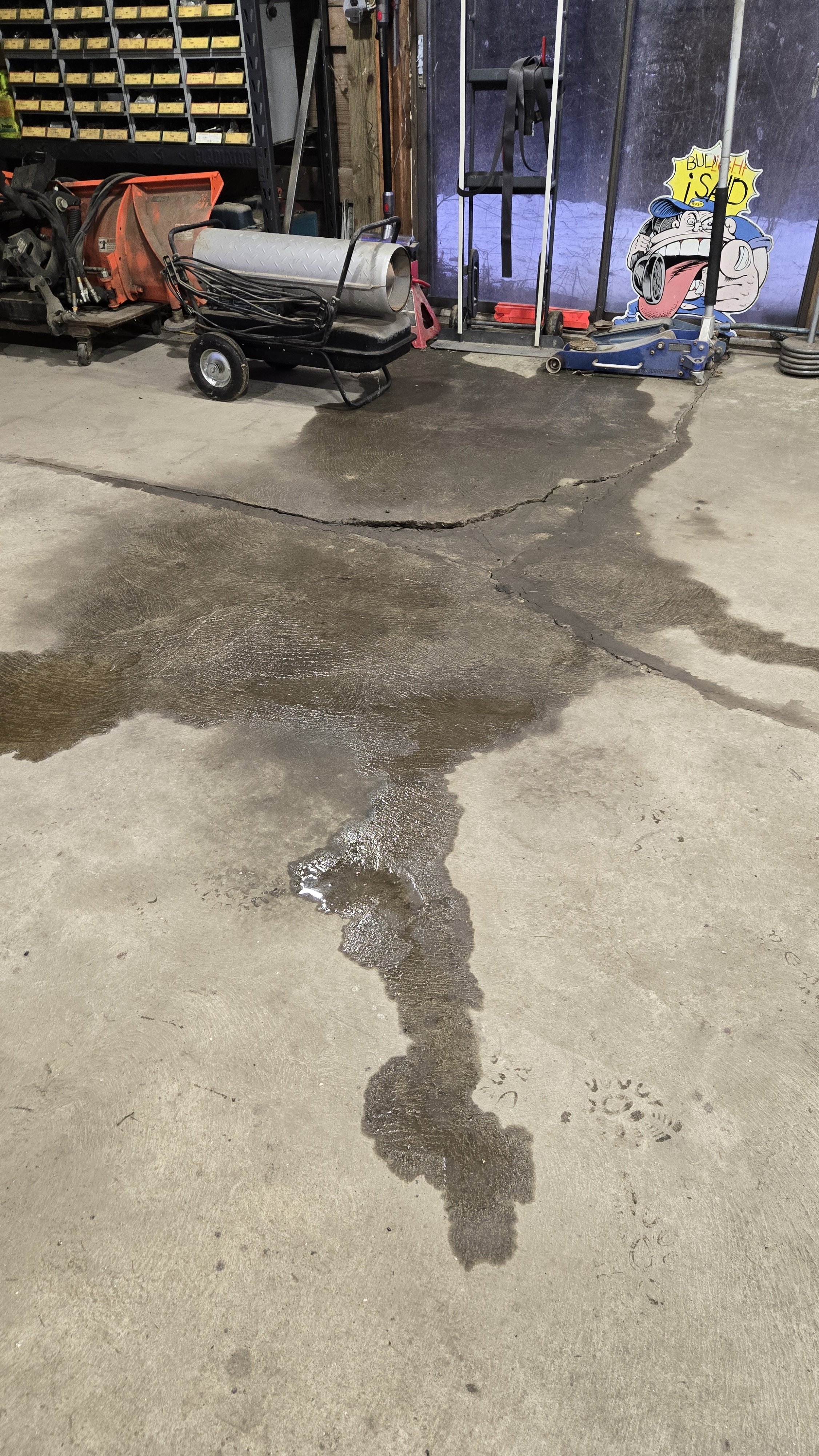

Pretty sure this is not condensation.

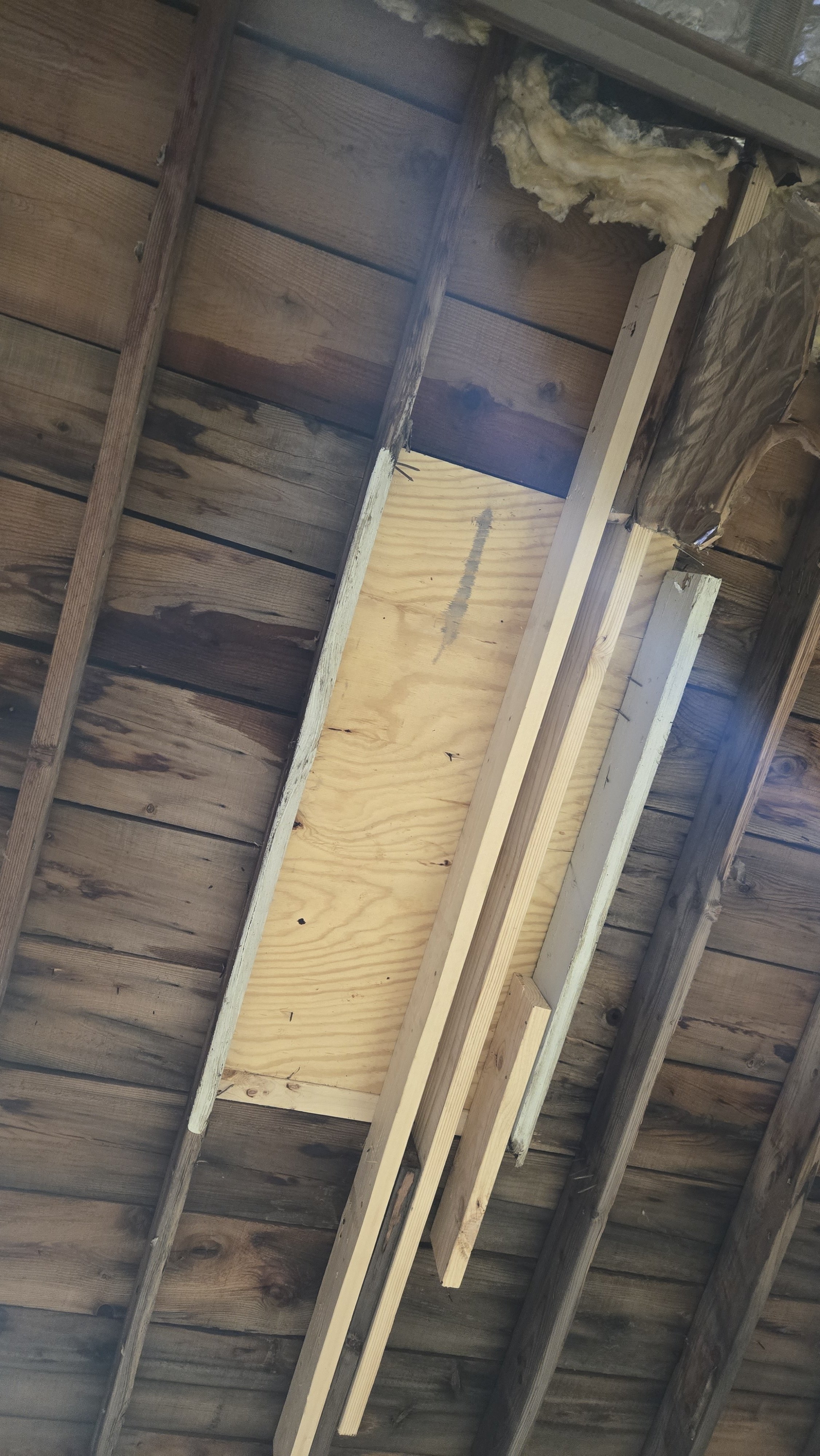

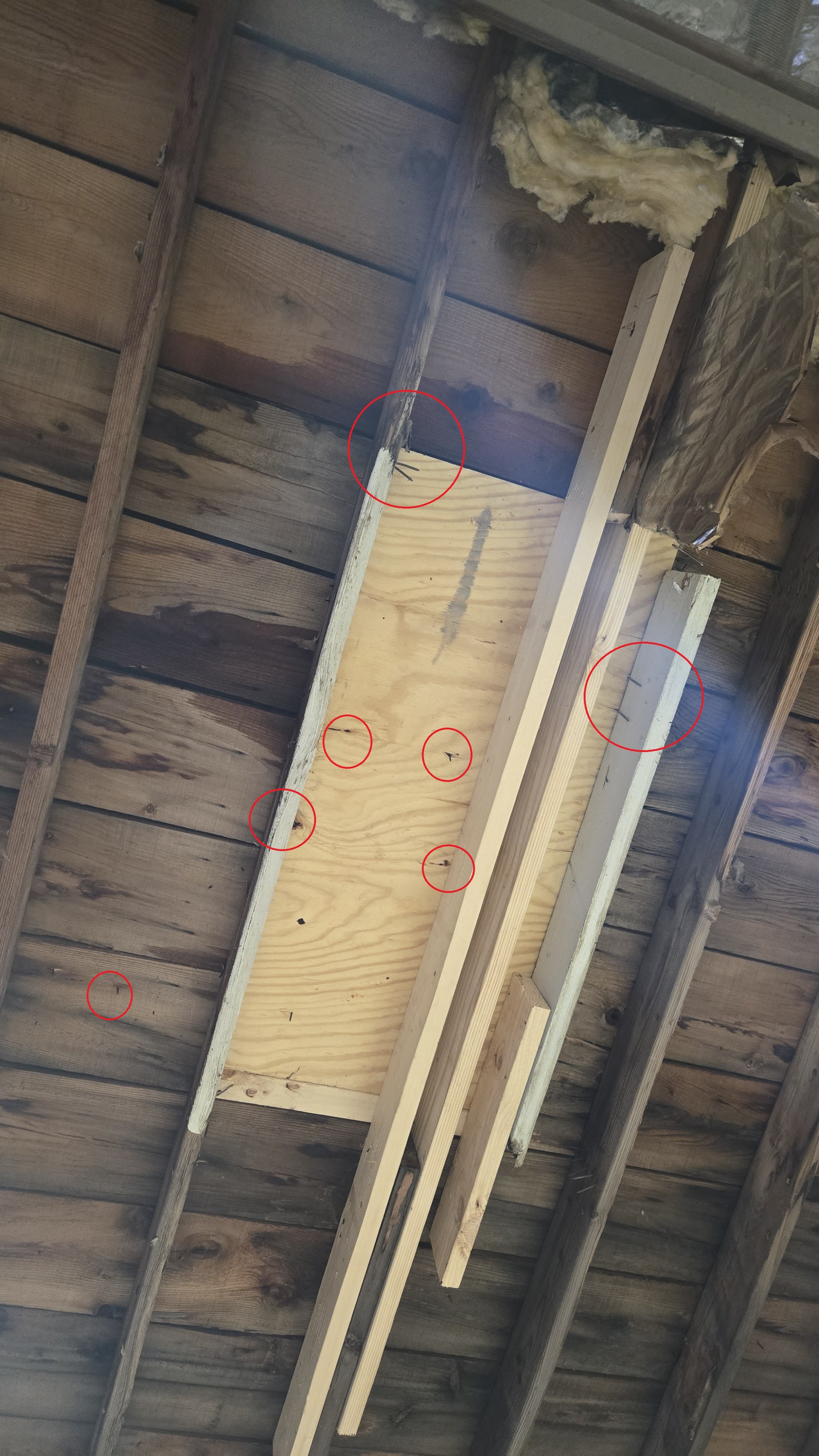

Boy those roofers were not framers by any stretch of the imagination.
The skylight fix did not fix your problem. They did something wrong there, It's too bad we can't see what they did on the top side.
Ya.. most roofers aren't. Looks like they just went over the replacement plywood with the furring strips and then the metal, no paper.
I would like to see the actual flashing and trims, and whether they used the foam closure strips and butyl tape. That said, you *can* get quite a bit of condensing moisture under the metal. If it was there, froze then thawed all at once..? This is why the roof itself is still supposed to be protected from moisture. If the original shingles are bad, they get tore off and an underlayment gets put down like any other roof.
I'm not a framer either. But I could have framed up that skylight hole much better than that

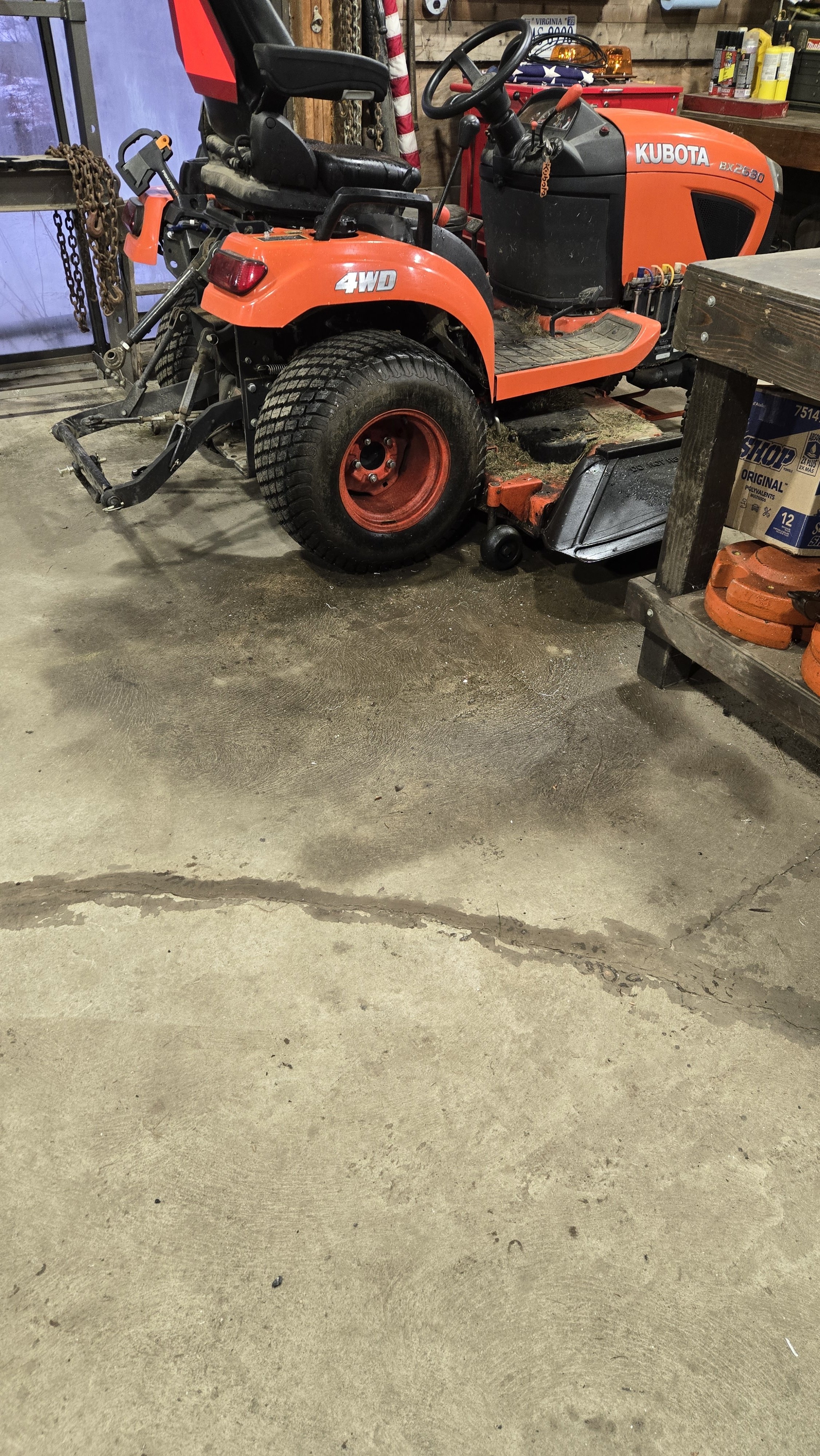

You sure the floor spots are not originating from the outside walls?
And are these nails coming through the roof? I had thought your new roof was panels and screws.
Those look like they missed when nailing the plywood filling the hole (corner).. and then the nails from nailing the furring strips on (across the center)..?
   / New metal roof leaking, need advice. #38
Just hope you did not have a contractor that did work like this... and these are not even some of the worst examples.
