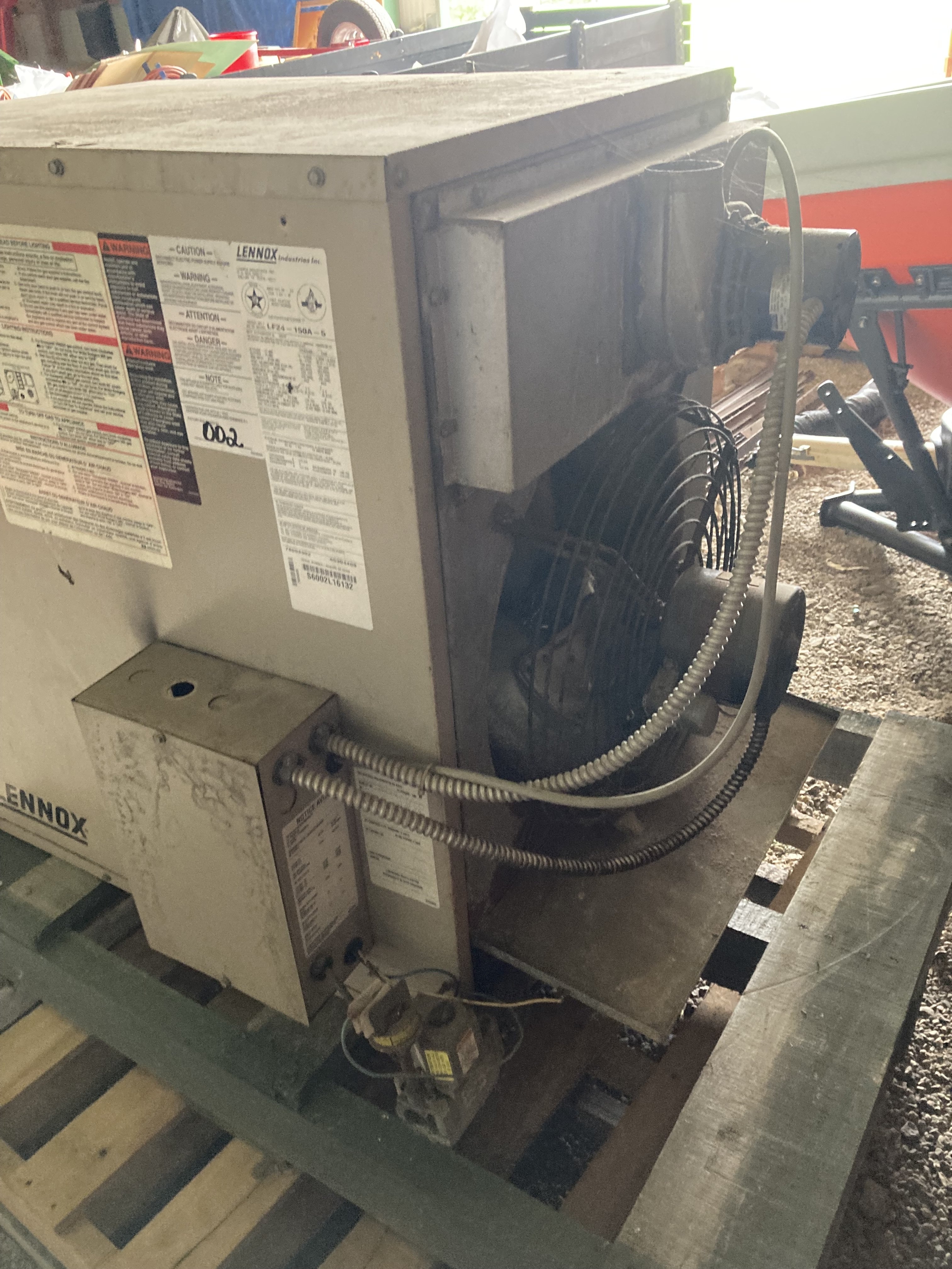

In doing my research on this, I called a local farm company that sells and installs furnaces like this. My goal was to find out what a new one would cost and to ask some questions about the old one and venting the exhaust.
My biggest question was can the vertical exhaust be converted to horizontal. I got some maybes there but he's doing further checking, talking with an older installer and maybe calling a tech at Lennox. He said he thinks--and is pretty sure the vertical exhaust can he angled to horizontal but not positive.
Here's the pic of the back again showing the vertical vent.
We also spoke about the newer furnaces with enclosed flame and I do like that. The question now is on the vertical to horizontal exhaust and what I can learn. CH4--can this exhaust be vented horizontal in any way?
The manual will typically provide a graph showing how much horizontal is allowed; typically some is, but whether it is immediately or not varies.
Power Venting indicates that kits are available to convert to side venting; my bet is that they're pricey.

I'm not sure you want to hear this, but here's my opinion . . .
If some engineer at Lennox tells you how to do it, or what to modify in order to do it, you can do it. You'll need to hang onto his written approval just in case you need to assure someone or some insurance company later. Anything can be done if it's specially engineered. I'm pretty sure you won't get an engineer to put anything in writing.
Barring that . . . Note the designation of "Category I" near the top of the rating plate on your unit. That means this unit is non-condensing and uses a "negative pressure" vent. In other words, it does not produce sufficient positive pressure to vent horizontally and it depends on its HOT flue gases to create a chimney effect in a vertical vent. That's the ANSI rating plate and the ANSI standard that this furnace was designed to. Even though it has an "induced draft" fan, this simply establishes air flow through the heat exchanger and is not powerful enough to create positive pressure sufficient to vent horizontally. It is NOT a "power vent".
A Category III unit has a positive pressure vent and can be vented either way. (It could look almost exactly like yours.) However it's still "non-condensing" meaning it has "hot" flue gases and must still use special sealed high-temp vent material -- whether vented up or out. Most of the new units are using metal vent but older units were required to use expensive high-temp plastic materials. This would be the cheapest solution.
A Category IV unit has a positive pressure vent but is condensing (higher efficiency, cooler flue gases, has a secondary heat exchanger). That's why these high-efficiency furnaces have a condensate drain teed into the PVC exhaust vent. These units can be vented up or out horizontally and can use cheap PVC because heat is not an issue.
There are units, especially from the mid-80's, that are listed as BOTH a Category I and III. BUT it's right on their rating plate. They are designed such that they can be vented either way, if instructions are followed. They require the expensive high-temp sealed vent material if vented horizontally. Their design limits are right on the edge and the way that it's ultimately vented determines whether there is positive or negative pressure in the vent system.
Based solely on the rating plate, your heater is a Category I heater and must be vented vertically using natural draft.
Having said all that . . . . You asked if there was any way to vent that unit horizontally . . . You could mount a separate power vent at the outside wall and run standard metal vent to that. You'd penetrate the wall using a special termination kit that comes with the power vent. This would create a negative pressure between the heater and the power vent fan and then it would be sealed from the fan outlet through the wall termination kit. It has to be wired into the gas valve to ensure the unit won't operate unless the fan is operative. (Not difficult to wire in.) This would be an expensive option too. This used to be done a LOT -- No way would I recommend it today.
