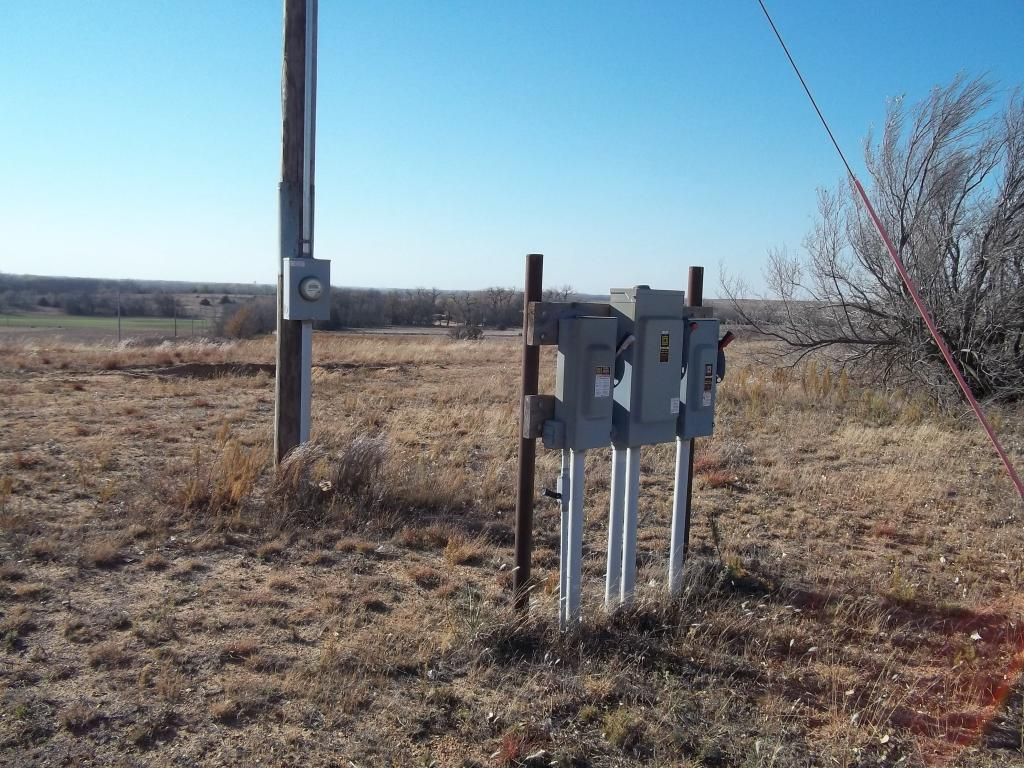

Here is my electrical installation...

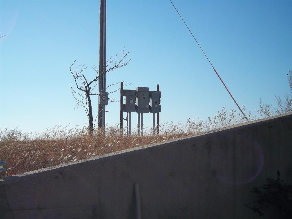

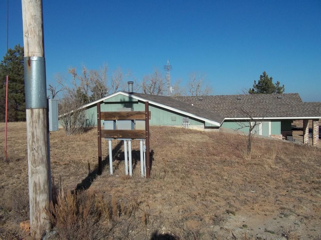

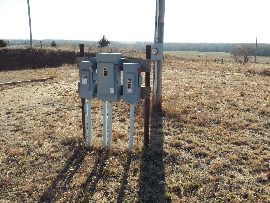

Interesting meter placement. All locations I have ever lived have required a sealed meter be attached to the residence or outbuilding. They have also required locks on all electrical service boxes to prevent someone from exploring and either disconnecting the electrical service or being seriously injured and to limit service provider and customer liability.
/ Power & Utility Questions #28
Where I live out in the county (Pratt County) meters don't go on houses they go on the pole. In town they go on the house. Meter is sealed, but I have in the past cut of the seal to remove the meter so I could complete the installation. Power company just installs new seal. If some idiot wants to come out here and explore the insides of my electrical boxes....be my guest.
