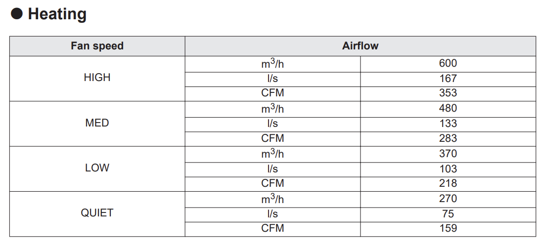

Below is the fan speed table for this unit
Keep in mind, no matter what the outdoor temp, it won't affect the indoor blower speed.

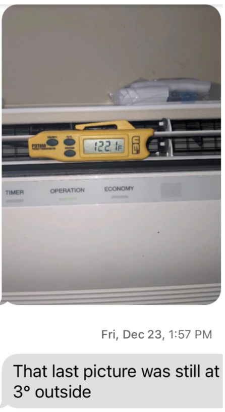

What I can tell you is that for this system in heating, this room (I'd need to go back to my manual J for the exact measurements, but it was done correctly) can maintain a 68F indoor temp at a 5F OAT all day long.
Older heat pump systems used to produce a discharge temp of around 96F, which is why a lot of people didn't like them. Although in cooler temps the room could be kept at 70F indoor, to people used to gas heat (much higher discharge air air temp) a heat pump felt cold if they could feel the air blowing on them because the discharge air temp was lower than their body temp.
I'm a big proponent of experimenting on my own home for "real life conditions" and what I can tell you is that you can use some standard ducted heat pumps and maintain 70F inside at 10F outside air temp all day long, even in New Hampshire (and a single stage will bring on your strip heater faster than a two stage compressor at the same outdoor temp).
I was never a big proponent of whole home dehumidifiers because the argument was that a variable speed blower with a multi stage compressor can dehumidify better that a standard blower with single stage compressor, and that is true, but it can never come as close as dehumidifying better with a single stage compressor with standard blower HVAC system using a whole house dehumidifier.
Don't get me wrong, I would still use a furnace for back up heat if I lived up north, but I would still dual fuel it with a heat pump if I we're on LP for fuel because pretty much any single stage heat pump will handle down to 30F OAT without strips, and in most cases generally cheaper to run electric than burn propane (at least in my area where it's over $3.50 a gallon. For the price difference on a heat pump outdoor unit vs AC outdoor unit (using pretty much the same coil) the ROI can be had in the first year on high dollar LP using gas as a secondary heat.

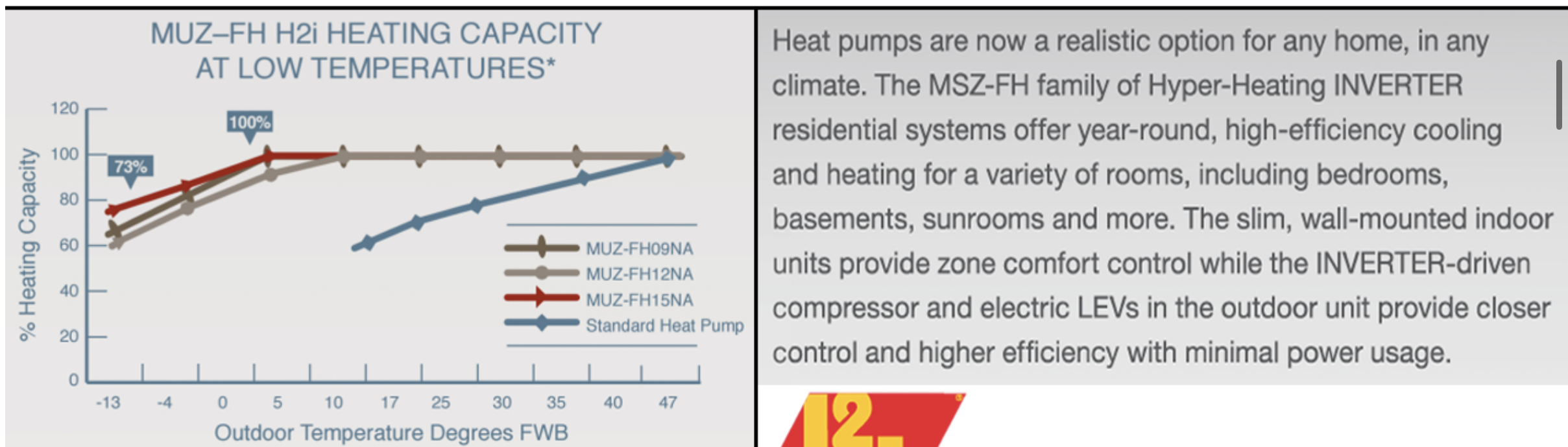

9K Mitsubishi MSZ-FH09A 30.5 SEER, and 4.0 COPF at 47 degrees, and a COPF of 2.73 at 5 degrees. (1 W in = 2.73 watts heat out)
I’m looking at the specs on that unit, and it’s showing 100% efficiency (expensive electric heater), at 10F , which seems about right.
How are you coming up with 273% efficient @ 5F ? Maybe you mean 5C
I've got to ask, where are you pulling your information from when you state "it's showing 100% efficiency at 10F"?
I'm seeing
7,630 BTU/h heat @ -13F OAT
9,260 BTU/h heat @ -4F OAT
10,900 BTU/h heat @ 5F OAT
12,200 BTU/h heat @ 17F OAT
No where do I see 100% efficiency.
My COP's are slightly different than Carl's, but I'm looking at the MSZ-FH09NA and MUZ-FH09NA model 2.37 COP @ 5F OAT

That 100% heating capacity, NOT 100% efficiency.
The issue with efficiency is how AHRI rates a inverter compressor (which I mentioned in post #203) which has been going on since day one when mini splits first came into the US market over 40 years ago.
Below is the AHRI certificate for a new FX09 "Hyperheat" system
Honestly, I've given up on exactly what our leadership is trying to do when it comes to efficiency and HVAC systems. What I do live off of is engineering manuals to give me the actual data I need to determine the best system to meet the requirements along with price point options (I don't know anyone in NC who does a load design for heating over a 23F OAT).
The above system will give you 14,500 BTU/h of heat at -5F outside air temp. However, the issue is when that inverter compressor is working over 100% to achieve maximum output, it's very less efficient.
