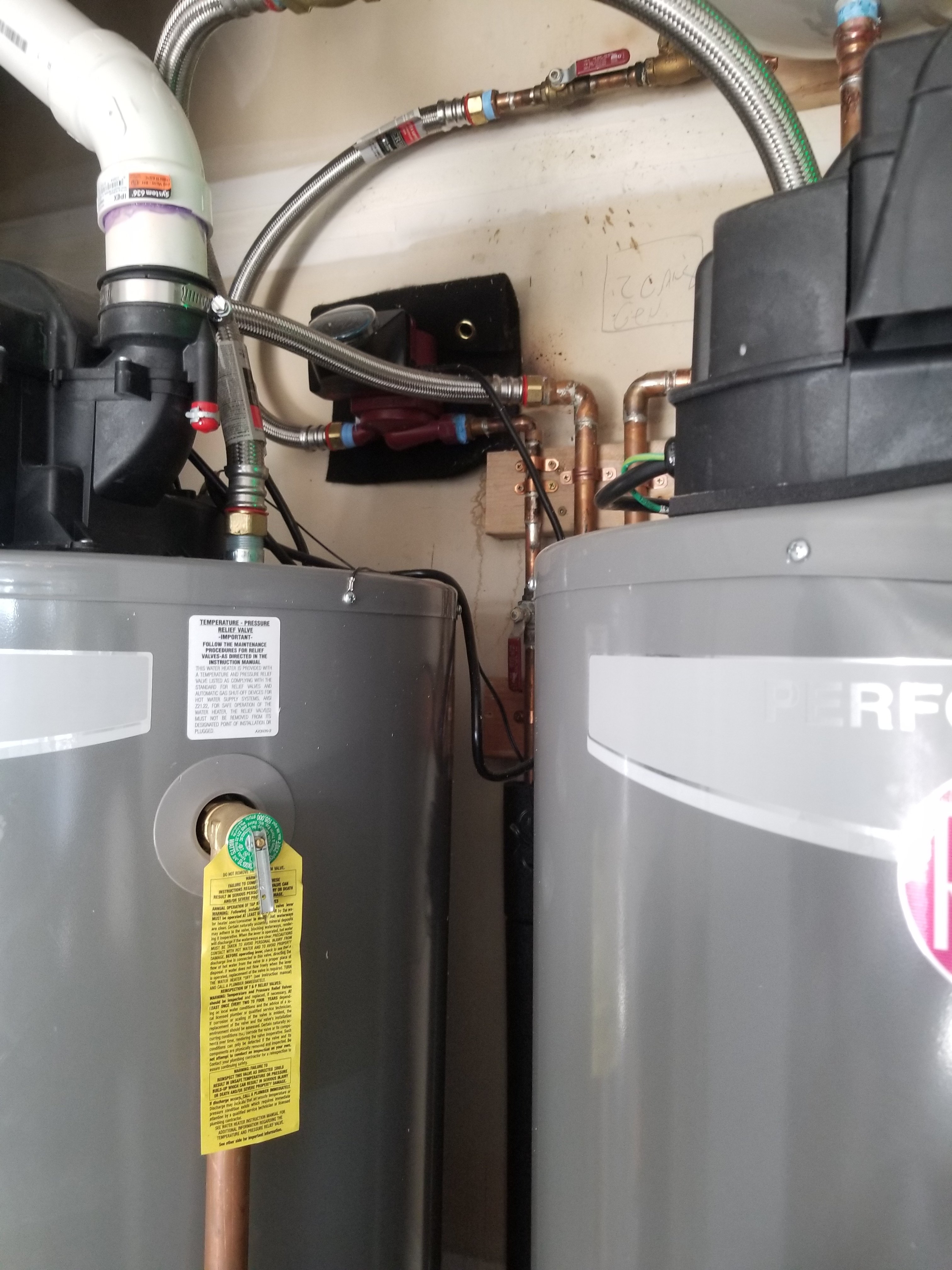

Good point. I have aprox 100’ round trip on mine. My Grundfos pump handles that without issue.
Hard to see in pic, but its to the top of the left waterheater mounted on block. The blanket was temp while soldering final connections.

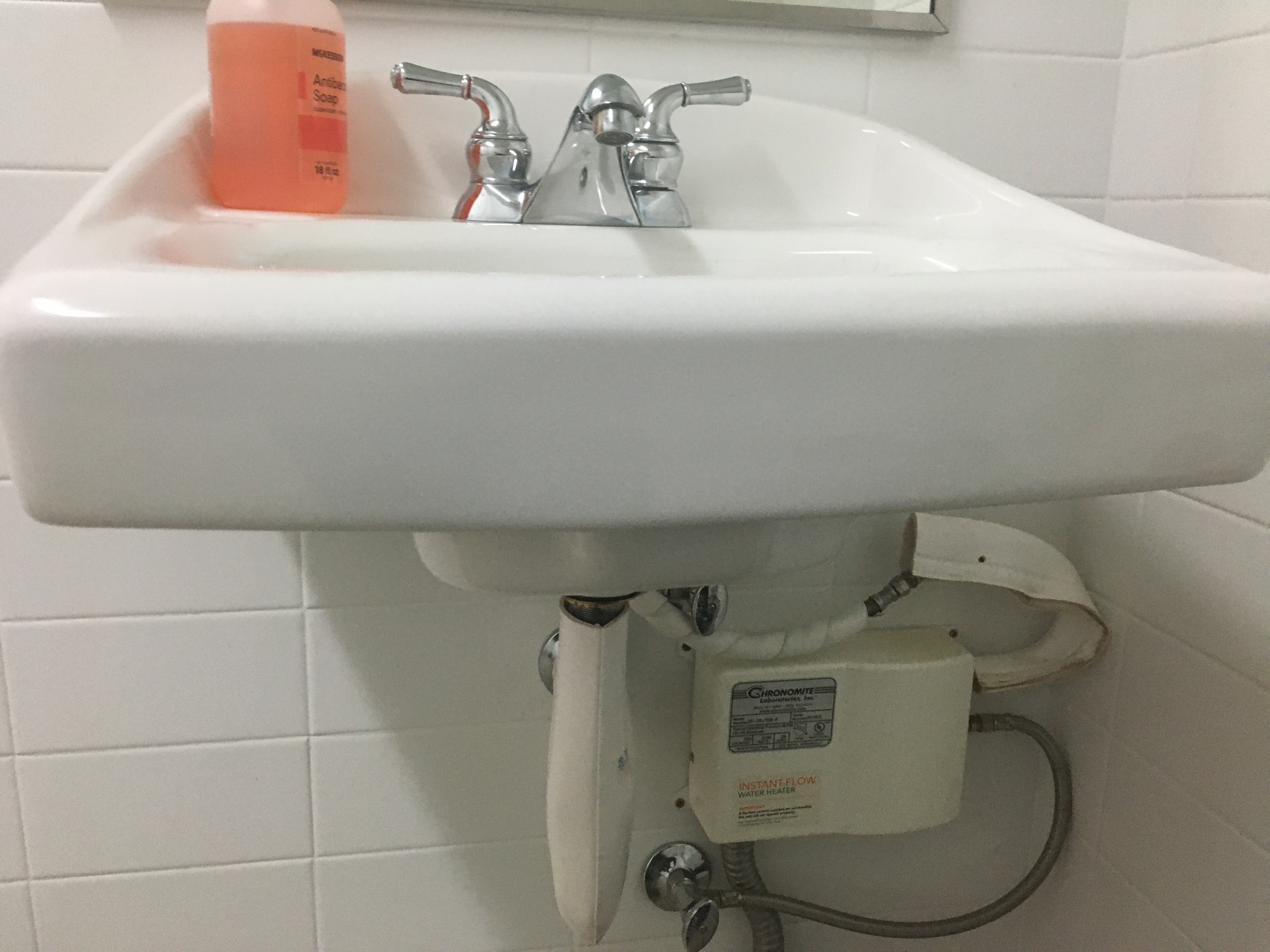

Here is a sink in the annex some distance away that is plumbed with only cold water and no recirculating loop…
It’s been 10 years since installation with out issue.
Hard to see in pic, but its to the top of the left waterheater mounted on block. The blanket was temp while soldering final connections.View attachment 3083991
