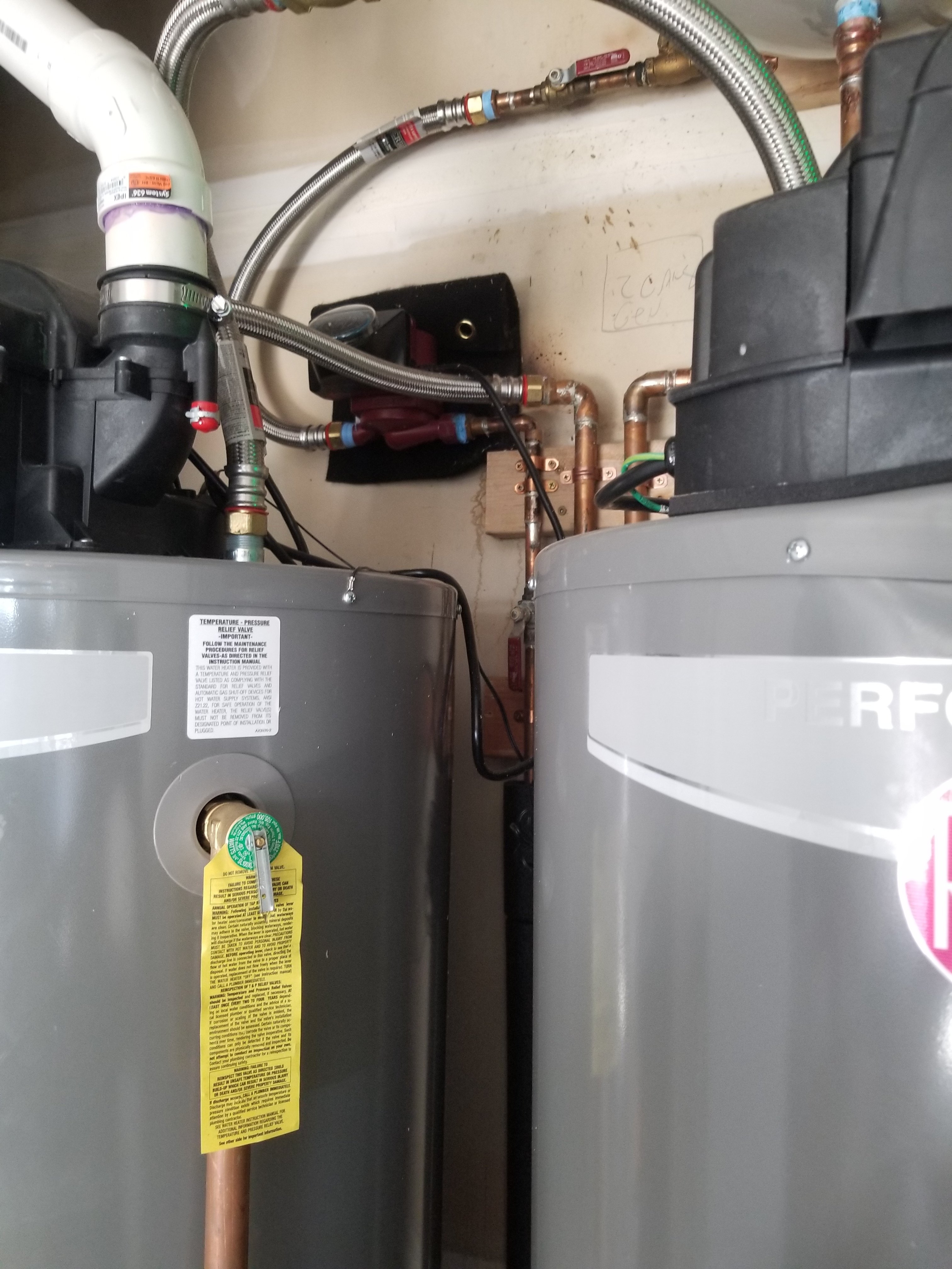

Twin 40 gallon gas direct vent units. The return is piped into the intake side with a back flow installed

Good point. I have aprox 100’ round trip on mine. My Grundfos pump handles that without issue.
Hard to see in pic, but its to the top of the left waterheater mounted on block. The blanket was temp while soldering final connections.
Hard to see in pic, but its to the top of the left waterheater mounted on block. The blanket was temp while soldering final connections.View attachment 3083991
