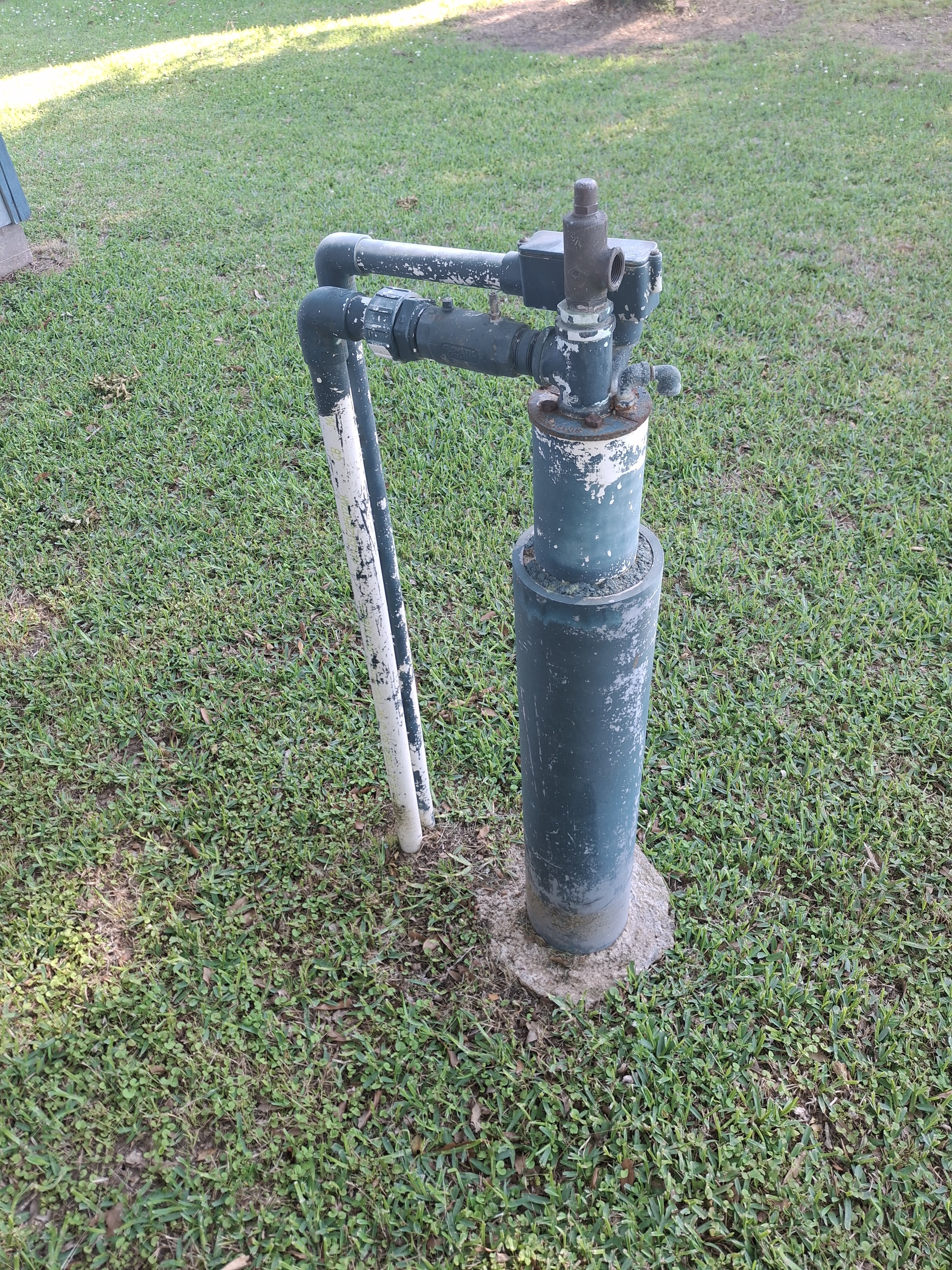

That looks like a normal well head to me, check valve, pressure regulator and power, albeit one that has no frost protection...
