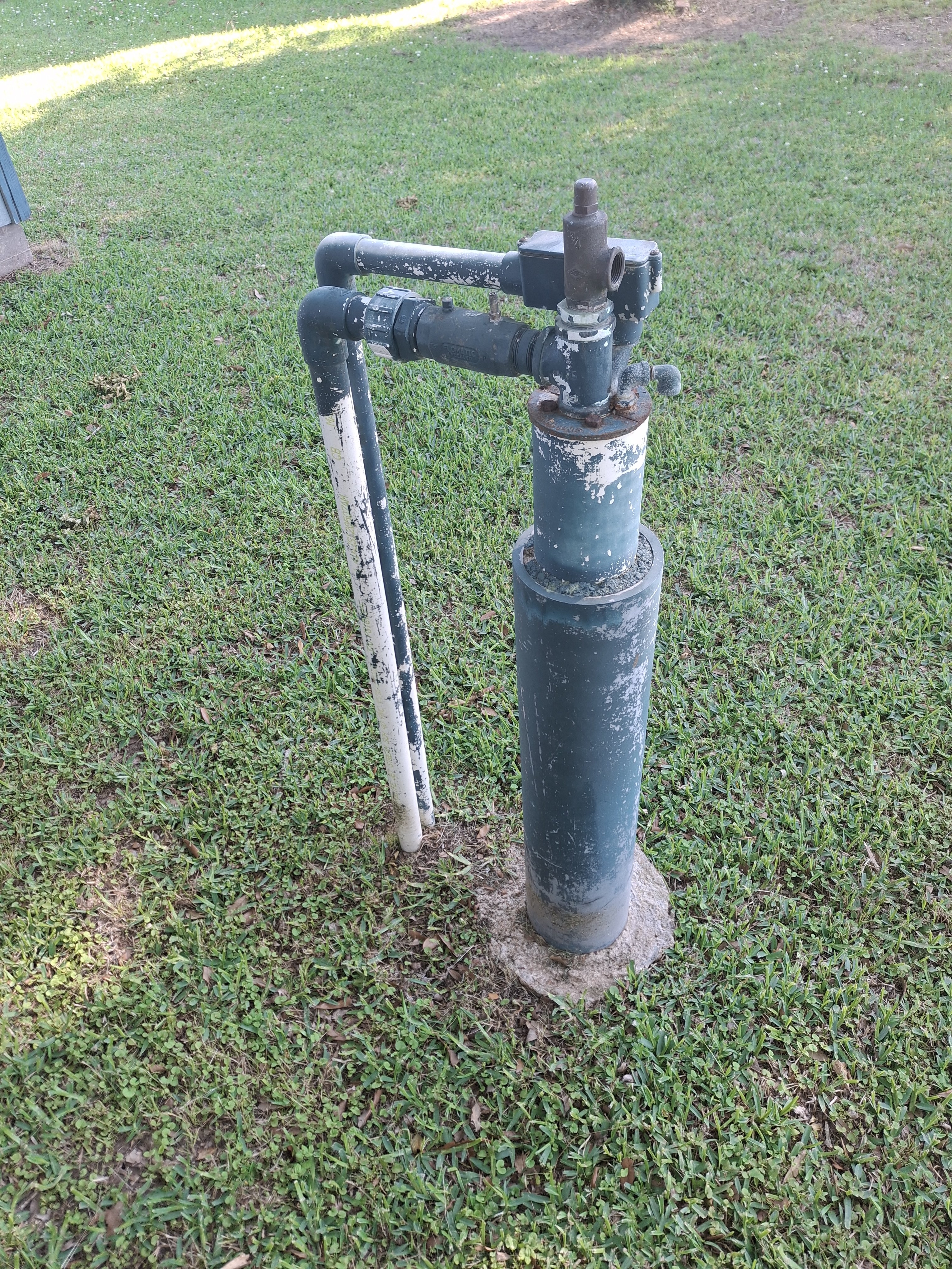

This is what they look like. The wires are in the conduit and the water exits the casing 4+ feet down. I think the casing is 6" and most wells are 130+ feet deep.
Wells | Wisconsin DNR
Ours is 4". I don't know how deep it is, but the water table is only 35-40' down. Pump is set about 60' down. Only 1 conduit for electrical above ground. The water line is connected 5' down here.
I was curious as to why the large casing with the smaller one cemented in at the top?
Usually there is the bore diameter (say 6"), then there is a casing that goes down far enough to prevent surface water and soil intrusion, then inside the casing there is power for the submersible pump, usually fastened to the water pipe, and a pipe from the pump to the surface along with a torque reducer to prevent the pump start up from torquing the water pipe. Here, the cap is an insert plate with holes for the water pipe, electrical conduit, and a breather finger to let air in and out of the well. (The little finger on the right in @strantor's photo above.) In @strantor's case, it looks like they used cement.

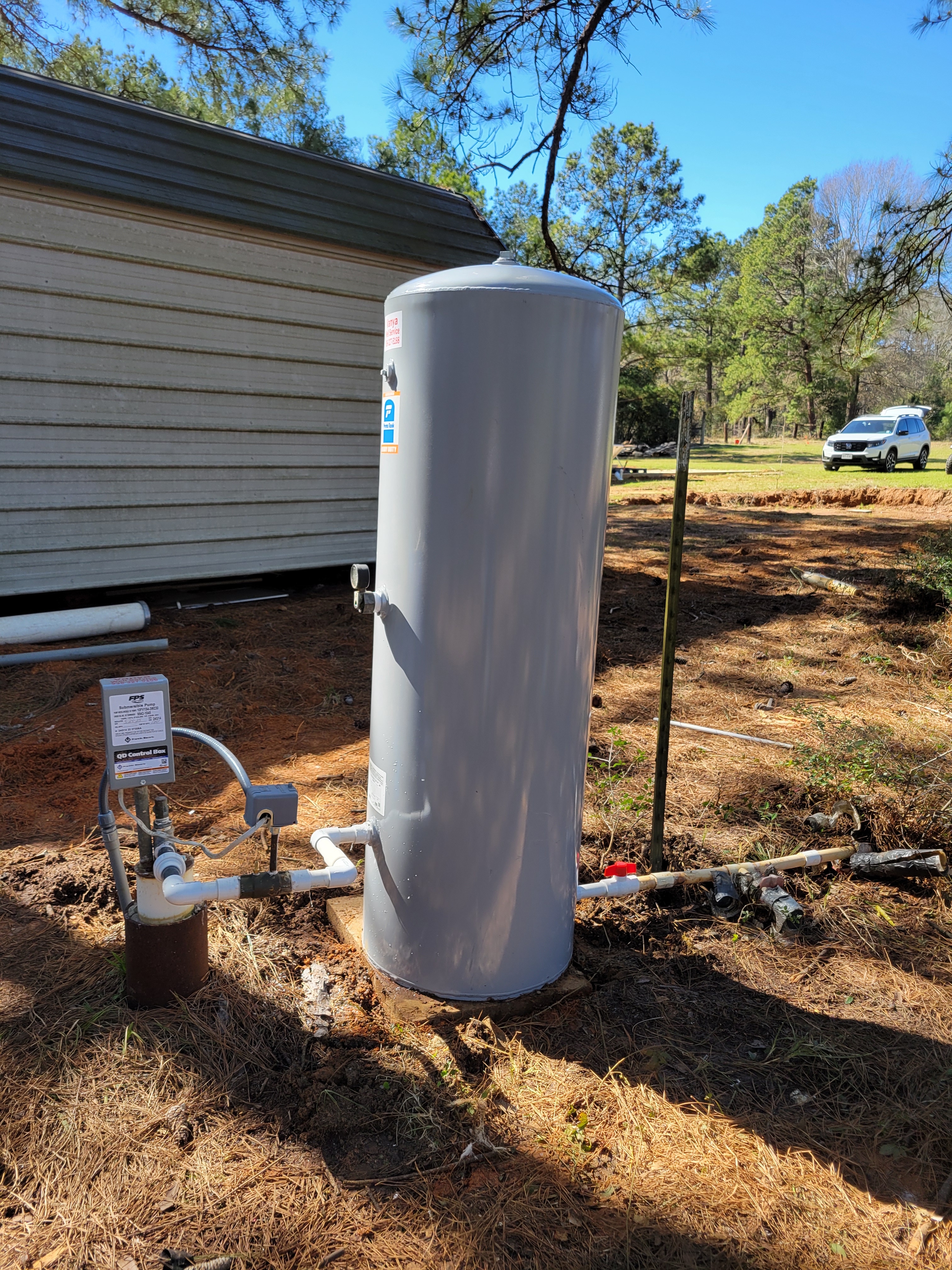

"no idea. 6" PVC comes out of the ground."
That sure doesn't sound like a good well to drink from to me. You owe it to your family.....money spent on clean water is well worth it.
I just had to have a new pump and tank installed.
180' of PVC piping up to the controls and then PVC to the tank and PVC from the tank. What exactly is the alternative? Black iron, copper, PEX (Cross-linked polyethylene)?
I have one of the more shallow wells. I'm told that you can get water at ~ 50' to 75', but that's not the "good" water which is why they go deeper.
As far as the OP goes, I'd either go deeper, or put in a holding (clarifying) tank, and maybe try a solar still. But definatly not pool water.
