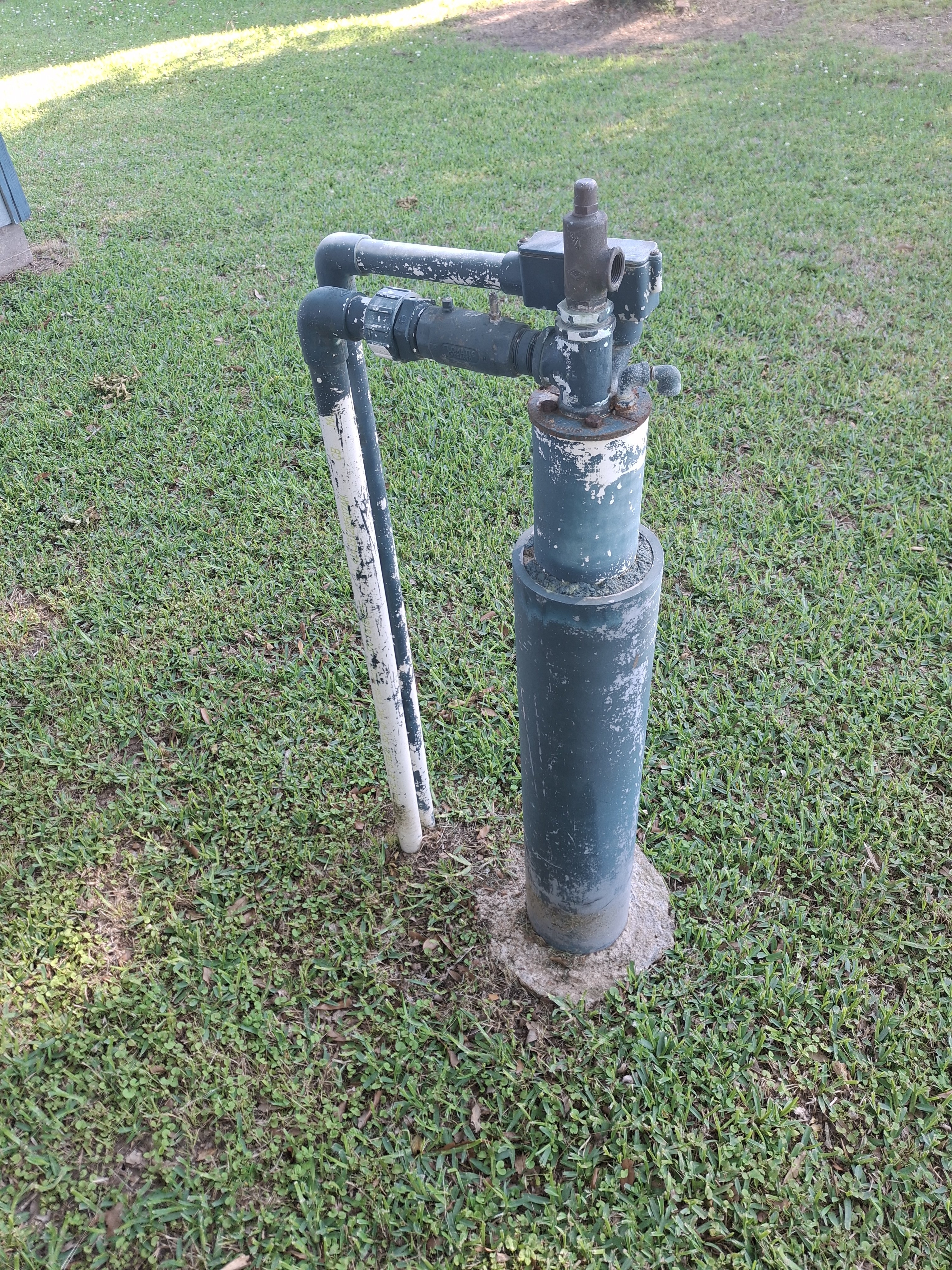

My well water eats copper pipes. I am in the process of re-plumbing the whole house in PEX, one area at a time, in response to leaks that keep springing up just randomly in the middle of a pipe somewhere.
The water is full of black sediment. Don't use the sink for a weekend, then turn it on, water runs black for a bit.
I recently had to replace the lower element in the water heater but first had to spend 4hrs with a long drill bit, digging out enough silt and calcium to make room for it.
It smells like sulphur and tastes bad.
I had a guy come quote me a system and it's not a whole lot different than what I already have (and don't use) because it's ineffective. I have an inline filter that I have bypassed because it doesn't even last a week before needing replacement which is a pain and costs like $40 each time. and the water softener just eats salt (money), creates another chore, and restricts the flow of the water. I can't tell any difference whatsoever between when the softer is in the loop or bypassed, except that when it's bypassed I get actual usable pressure.
So what I'm thinking is...
We have an above ground pool which we do a lot of work to keep clean and clear. We add chemicals to keep the PH right, we run a sand filter to keep the crap out, and the quality of the water in the pool is way better than what comes from the well. When we have to refill from the well, we get some sediment in the bottom of the pool that my wife vacuums out. I'm thinking, what if we just redirect the well straight to the pool. It can be on a float switch so that it just comes on as needed to keep the pool level up. Then a booster pump sends pool water back down to the pump house to charge the tanks and feed the house. This will give the water plenty of time to off-gas whatever gas is in it, settle out whatever sediment is in it, get its PH corrected, and get filtered before it gets to the house.
Nobody likes the idea of peed-in pool water coming out of the tap but I can guarantee anyone filling a glass from the tap would be getting a 10,000% better product than what comes straight from the well. I am sure the pool maintenance will go up but I would rather spend time maintaining the pool than crawling around in the attic replacing pipes.
Yall please tell me what I'm missing. Why isn't this a good idea?
Don't use your pool water. It is not sanitary, and has a bunch of extra chemicals that you won't want in your drinking water.
I think first things first. Get your water tested, and then move onto what the next step is. In some counties, it is even free, but even if it isn't, it is cheap to test for coliform (generic standing for bacteria), TDS (total dissolved solids, e.g. hard water), metals (iron, manganese, lead...) and pH. Try to get a sample as close to the well as possible and let it run for a few minutes so your sample is accurate for your water, not whatever is sitting in the pipes.
Once you have that information, I think you are in a better position to plan out your water treatment needs, and technologies.

God knows what's in the pool water. It's open to the air where critters can eliminate in it. I've drunk from streams in the mountains but even in the high country now there there's Giardia and you need to filter.
Get it tested and find out what it takes to treat it. Otherwise you're just guessing, and meanwhile you're drinking bad water. "top 25" (metals and minerals) testing + coliform cost me about $425 in Oregon last year with a local lab.

Post 12 is your best avenue. Get the well water analyzed and treat accordingly. We have sulfur dioxide here as well and we treat our water accordingly. I just happen to inject H2O2 in the raw water which precipitates out the sulfur and turns it into a solid which I filter out but I don't ascribe to homeowner grade filtration either. I use an industrial sized Cumo filter that takes industrial sized elements I buy wholesale and one element lasts a couple months.
Neither here nor there as your situation may be different but the important thing is get the raw water tested, see exactly what is in it and proceed from there and IMO only, RO units are a waste of money. Easier to purchase bottled water and a heck of a lot cheaper to boot.
