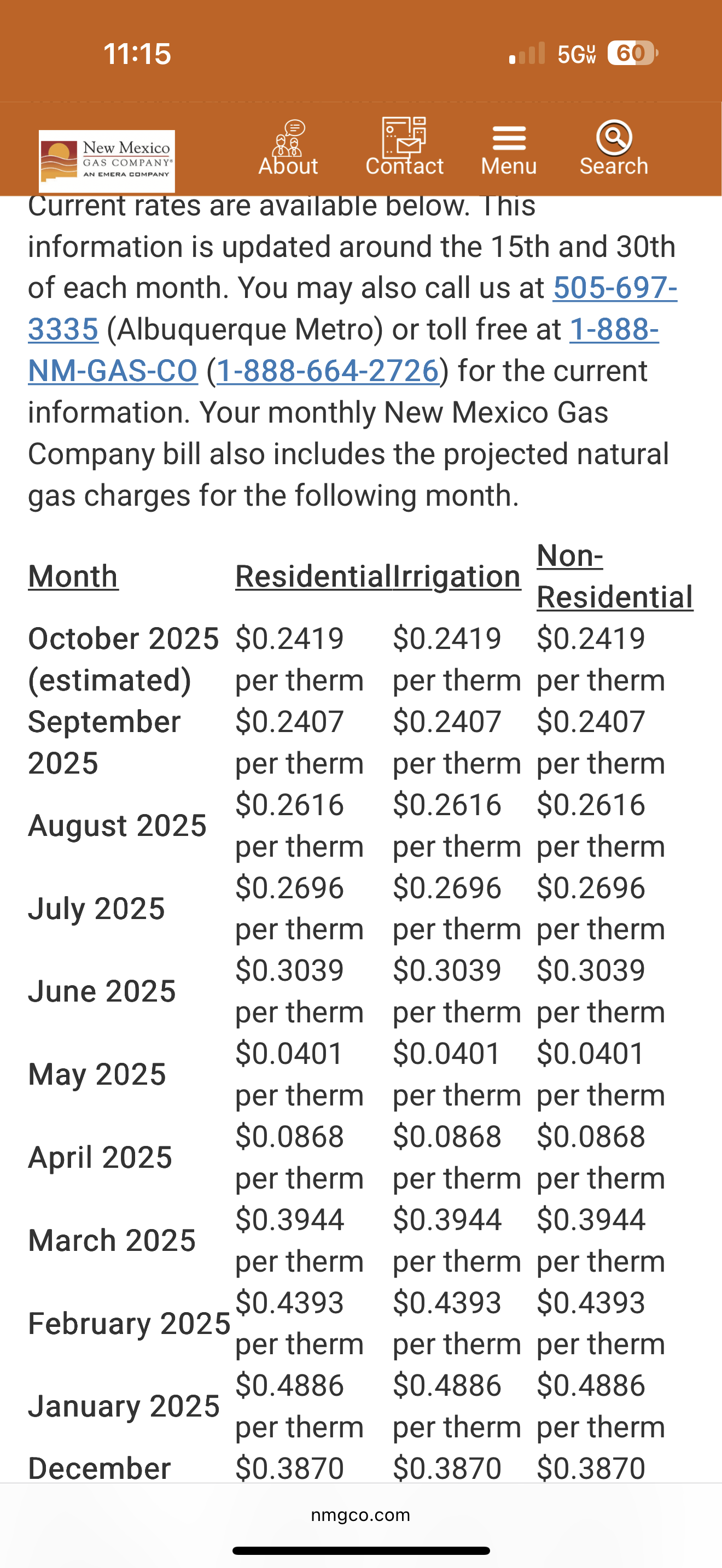

this house I bought was all elec. I had local gas co out. They said they would run the line to my home (400ft) off the road free if I installed a gas WH.
I had to pipe the house up for gas and purchased a tankless and installed it.
I had intensions of installing a gas furnace but got a deal on a VRF, so I went with it instead of gas furnace. I now have the gas tankless WH, gas logs and gas dryer.
When the elec. range goes, it will be replaced with gas.

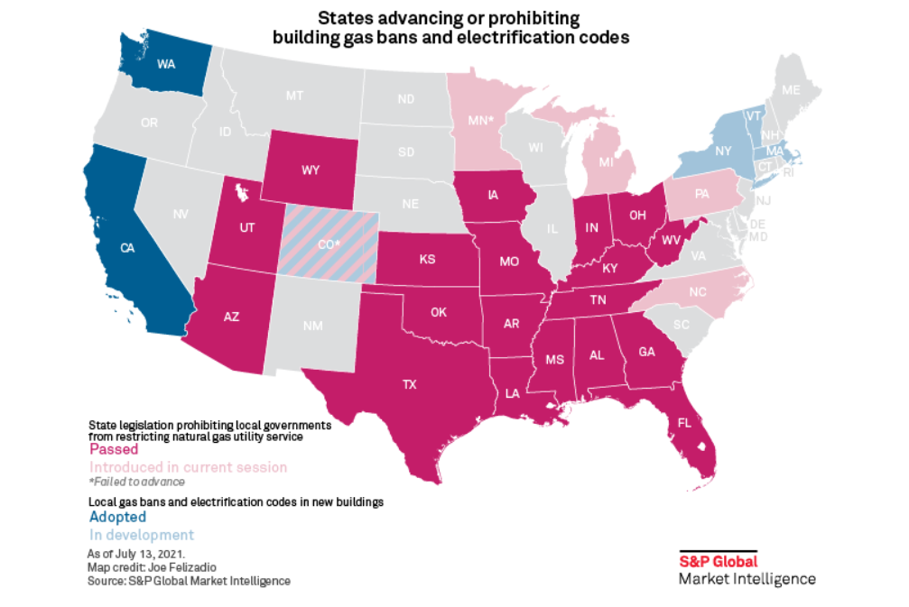

So the dumb question is there any reason why not to use natural gas if it's available?
I didn't read every post (and I am based in Canada) I thought most of the US is moving towards banning the continued use of gas? <<California, New York, Massachusetts, Colorado, Oregon, Maryland, Maine, New Jersey, and Rhode Island, Washington State and Vermont, etc.. can up after quick internet search>> with changes and gas limits coming quicker every year it seems.
In our national newspapers we are reading every day now that almost 20% of the natural gas used in the US has historically come from Canada but is no longer wanted so being tariff heavily and new pipe lines / pipeline maintenance requests being turned down. This has led to a large Federal push in Canada for fast track approvals and government funding of infrastructure to instead send this gas east to europe and west to asia. just a few weeks ago a new national law was passed here to allow fast tracking of these projects preventing protesters and provinces from stalling these plans to ship east / west versus south. Signed / sealed and delivered Bills C-5 (One Canadian Economy Act), Bill 15 (Infrastructure Projects Act), and Bill 5, aim to fast-track and fund infrastructure and resource projects to get gas, oil, lumber, steel, aluminum, and wood products as these exports to US is causing a lot of hate in Washington.
Would this not be a concern going forward????
personally i love our gas heating and cooking appliances. (wife is professional chef capable and this spring we ran a second 1" line to the house to feed a new 300,000 btu gas stove) This spring we doubled the pipe size to our place from the main line as our prices are dropping now that US doesn't want it anymore.

At first, I asked if the gas dryer would be ok ,and they said no, that wasn't a large enough load for them to install the line at N/C . I asked about a WH and they said that would work.
They gave me $300 toward the tankless which isn't much on a tankless but it beat zero .
Your chart shows the opposite. Most of the states are pushing back on limiting gas use. Only our far-left states try to limit human progress.
If they truly wanted to go green, they would fast track the use of nuclear reactors thus building up enough clean power to actually meet future demands. Then, and only then, could you reasonably try to phase out coal, oil and gas electricity production.
Until you have the clean electricity production, it's rather silly to prohibit the local use of clean, efficient NG or LP gas heat and heat related appliances.
When the US was using Canadian NG, it is largely due logistics. It is closer for some states (NE) to import from Canada than from PA or other gas-rich states. The US has vast NG reserves (about 8x those of Canada).
The 'problem' with exporting NG is that pipelines are by far the most effective way to transport it. Selling to Europe or Asia becomes cost prohibitive in many cases.
I had to look it up, but never knew that Vermont had a natural gas line. Vermont usually does follow California on it's loonyness.
I know the city of Burlington banned all gas powered lawn and landscaping equipment. Can't even run a generator if the power goes out without risking a fine.
