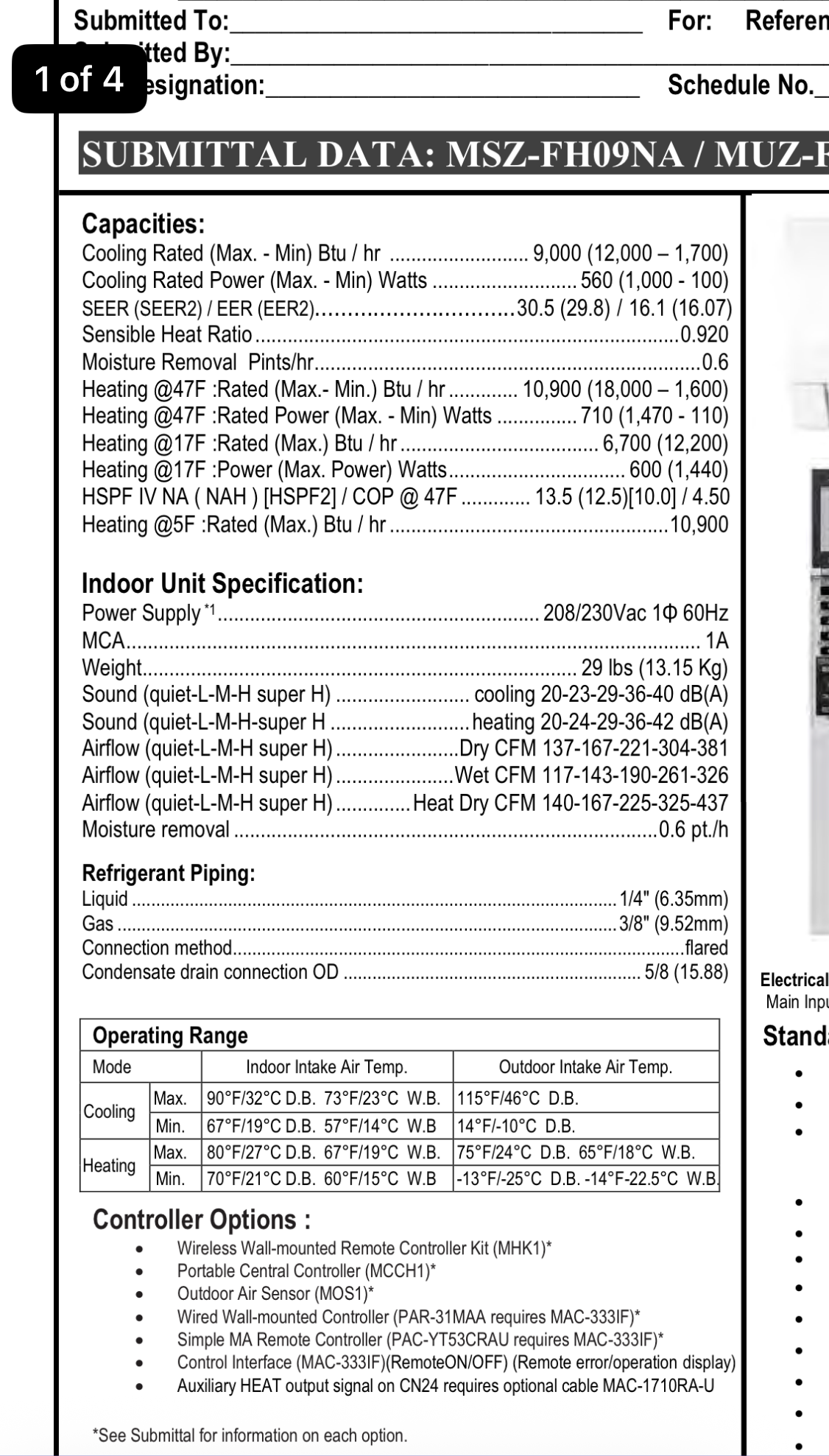

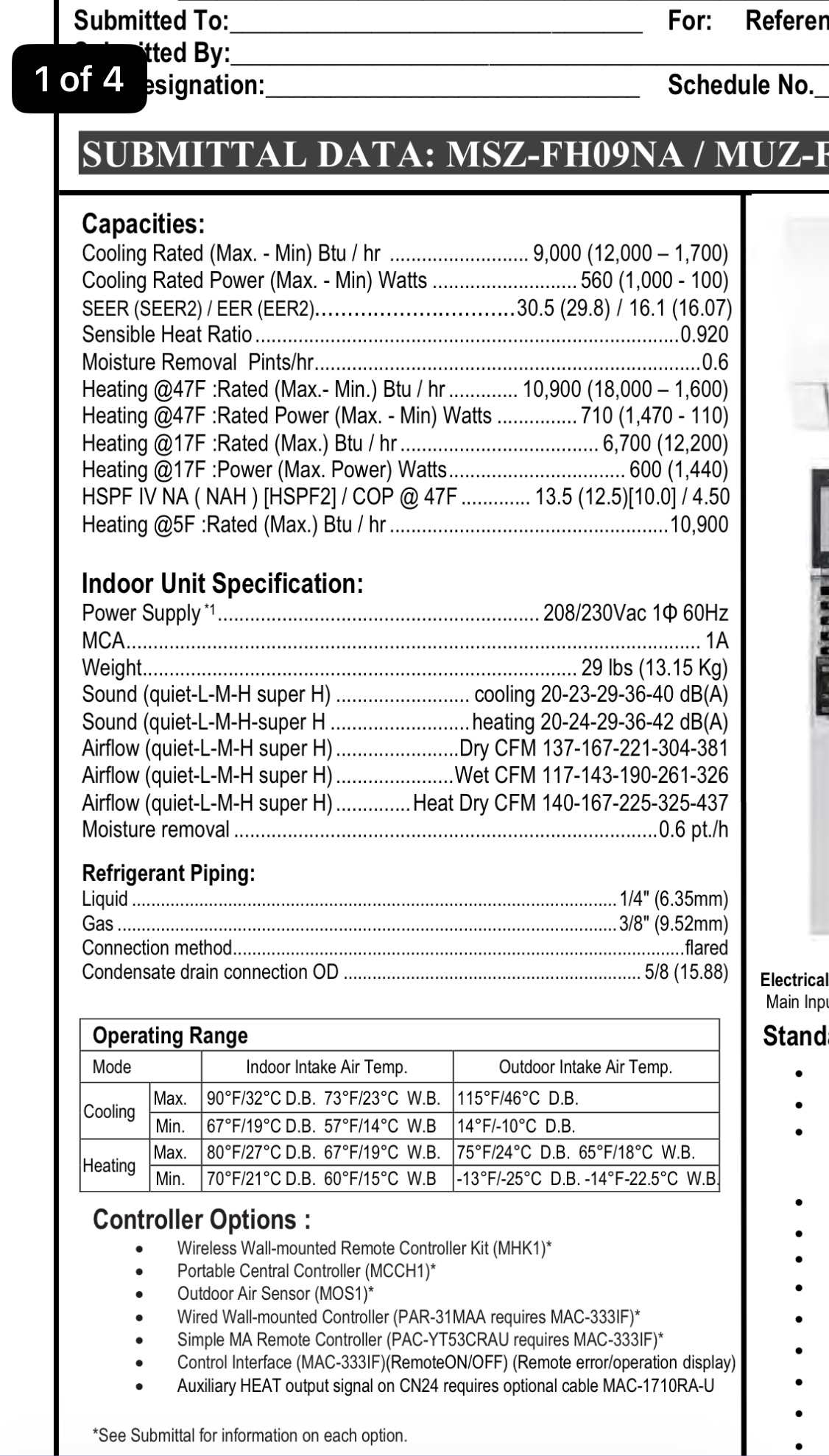

The above system will give you 14,500 BTU/h of heat at -5F outside air temp.
Where are you getting that figure from?
10,900 BTU’s/h at +5F. -5F would be much worse.
Yes, I know that graph I posted was of heating capacity, but unless you or the factory posts an actual temperature of 100% efficiency, or at least a power consumption vs temperature chart, then I’d have to assume the power consumption is nameplate, and unity ( 100% efficiency) must be at/near the sudden drop in capacity.
Actual power consumption seems an elusive specification with this model.
What is the power consumption at 5F? 10,900 BTUs is time equal to 3.2 kw.
Is it drawing substantially less power than 3.2 kw? That’s the heat of 32 100w light bulbs.
@230 volts that would be 14 amps. Does the indoor and outdoor units combined draw less than that?
My information is from the up to date submittal sheet (new FX model) from Mitsubishi's technical website.
The issue on your end is you're using the RATED heating capacity and not the maximum heating capacity at @5F OAT because they don't list the maximum heating capacity. The old FH models go down to -13F OAT which is what "hyper heat" really means per Mitsubishi's "name brand marketing gimmick name" (they hit a home run with it though IMO).
You hit the nail on the head though when dealing with the Japanese. Each manufacturer does things a little different on how they present their info and how easy and how hard it is to find because each manufacturer does it differently on exactly where to pull that info.
We can go back and fourth all day long on this. What I can tell you from my own experience is if a Manual J is done correct, you chose the right system for heating, and it will heat all day long to 5F outside air temp. That said, we don't get many days below 0F OAT to see how the system actually performs for heating in our world.
You made me look. I have some questions on their engineering data that I'm questioning and now I'll have to call to find out why they are listing what I could consider conflicting info (unless I'm just reading it wrong).

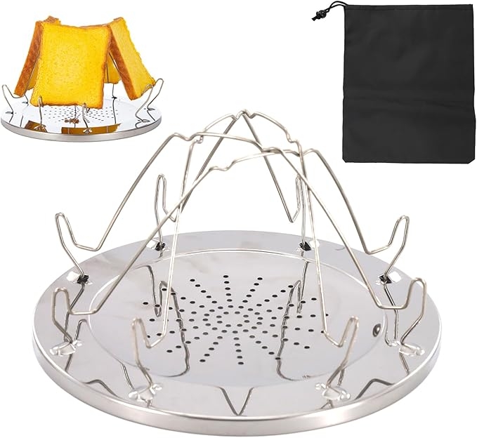

I have one. I have never used it. I used a stove top toaster years ago when I was camping, but that was more trouble than it was worth.
I used a top-of-burner toaster for years growing up until we got a toaster oven.
Pros: Toasts really quick, so you tend to stick around paying attention to it, unlike an electric toaster.
Cons: Burns the %$!@% out of your bread. You want fire? That's how you get fire, use that toaster.
I have checked amps years ago on the 9K Mitsubishi Hyper heat model and was around 6.5-7 Amps 230V at the max setting and in normal mode once it reaches temp in the space was between 2-2.5 A 230V steady state.
/ Natural gas? #234
Thanks. So a COP of around 1.6. How cold was it?
