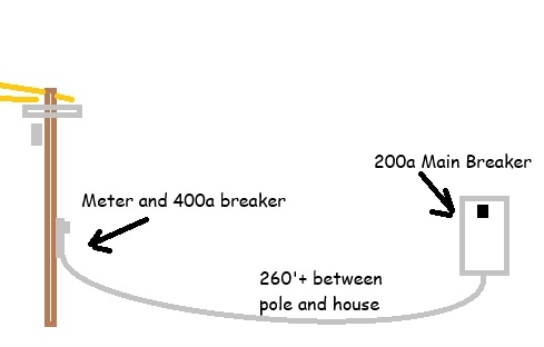

For that long of a run, you will need to upsize the wire that you run due to voltage drop. If it were me, id run a longer primary utility run towards the house instead of a huge secondary wire required for a 260’ run.
As stated in my earlier post having a second pole will double my bill as far as basic usage. The pole in the picture also feeds my barn and the old derelict cabin. No EGC for those. I plan to build a shop and tear down the old cabin. The 200a main breaker panel is super overkill for a 600sq foot cabin. I couldn't find the panel I wanted two years ago when i bought the one I have on hand. I plan on gas heat, stove, dryer, water heater. No codes, inspectors in this rural are of the Ozarks. I'll come up with a plan when I talk to the coop guy in the next couple weeks.

The meter and the subpanel are in, appropriately grounded, and the County inspector has signed off on both.
Just reread your initial post.
Assuming you’re going to run a ground wire from your meter to your “sub panel “ ,I know you won’t,because you just want to get it done, but I wish you would ask your county inspector, how “appropriately grounding” your “sub panel “ doesn’t create two bonding points and create parallel current paths on the neutral and ground wires to the pole meter.
Should make for interesting conversation 😄
Or, maybe he’s approved it without a pole to house, ground wire connection. I don’t know

Ok, here goes.
The FIRST panel which includes the meter AND a breaker HAS to have a ground rod or 2 and the ground wire AND the neutral have to be bound together within the panel. In other words the ground and neutral can be located on the same buss, or the neutral buss will have a green screw that attaches to the metal can.
Years and years ago, only 2 hots and a neutral had to go to any other subpanel and at the subpanels the additional ground rods and wires were again bonded together. This went away a long time ago.
Currently, EVERY OTHER subpanel HAS to have 4 wires run for single phase, 240v power. 2 hots, a neutral and a ground. Every subpanel has to have a isolated neutral buss (cant be mechanically grounded in any way) AND a grounded buss bar. The neutral and ground cannot connect together in any fashion in a subpanel.
Replying to Ponytug and grsthegreat for their posts re grounding. This is what I have: The meter (first panel/GE) has a shut off breaker and two ground rods, and my own add-in of a 20-amp breaker for a temporary 'test' circuit/outlet just below the panel box (the inspector told me to install that before he would pass it). When I installed that 20-amp breaker and outlet (outside the box) the first thing I saw was that there was only one bus. So, I checked with the guy that put the panel in - he was not certain, but he called the manufacturer of the panel and then called me and said all was fine as the ground and neutral were 'bonded' and it was supposed to be that way. So, I attached the neutral and ground to the same (and only) bus in the panel - and that was before the second inspection - which passed.
And while I thought the subpanel on the house was grounded (as I mentioned in my original post), and I saw a ground rod there before lying next to the box before it was installed, today I moved all the plastic, debris, etc. away and see no ground rod.
So, I hope this helps with the discussion. And BTW, I will be running a copper ground wire (#4 I think) from the meter panel to the subpanel - so, three 3/0 and one #4 ground in 2" conduit - maybe larger per Ponytug's suggestion.
I appreciate the comments- thank you all for reading and responding. I am educable.

2” will allow 4 of the 4/0 wires, so its plenty large for 3/0 wire. 2.5” conduit is nearly double the cost of 2” where i live.
   / Confirming Wire and Conduit size #35
The main meter panel should have ground and neutrals bonded together on same buss. So your install is fine.
So running the copper ground along with the 3 wires is fine. You just want to make sure the new house subpanel has separate ground busses and an isolated, insulated neutral lug. Keep neutrals and grounds separate on subpanels.
Got it, and thanks. I do recall that the subpanels - down line - need the separate busses- isolated. Appreciate your help.
