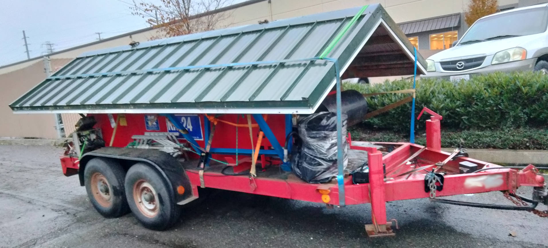

After quite a bit of scouring, I found a used roofing machine on Craigslist. Shipped to me down from Alaska.
So next summer will be about learning to make roofing.
This is an older type of crimped standing seam. While there may be some options to change patterns, it may well be orphaned by the manufacturer.
Most of the newer roofing is a snap lock standing seam. I'd imagine that my crimped standing seam will be very waterproof, but would be a bear to repair if that is ever needed.
