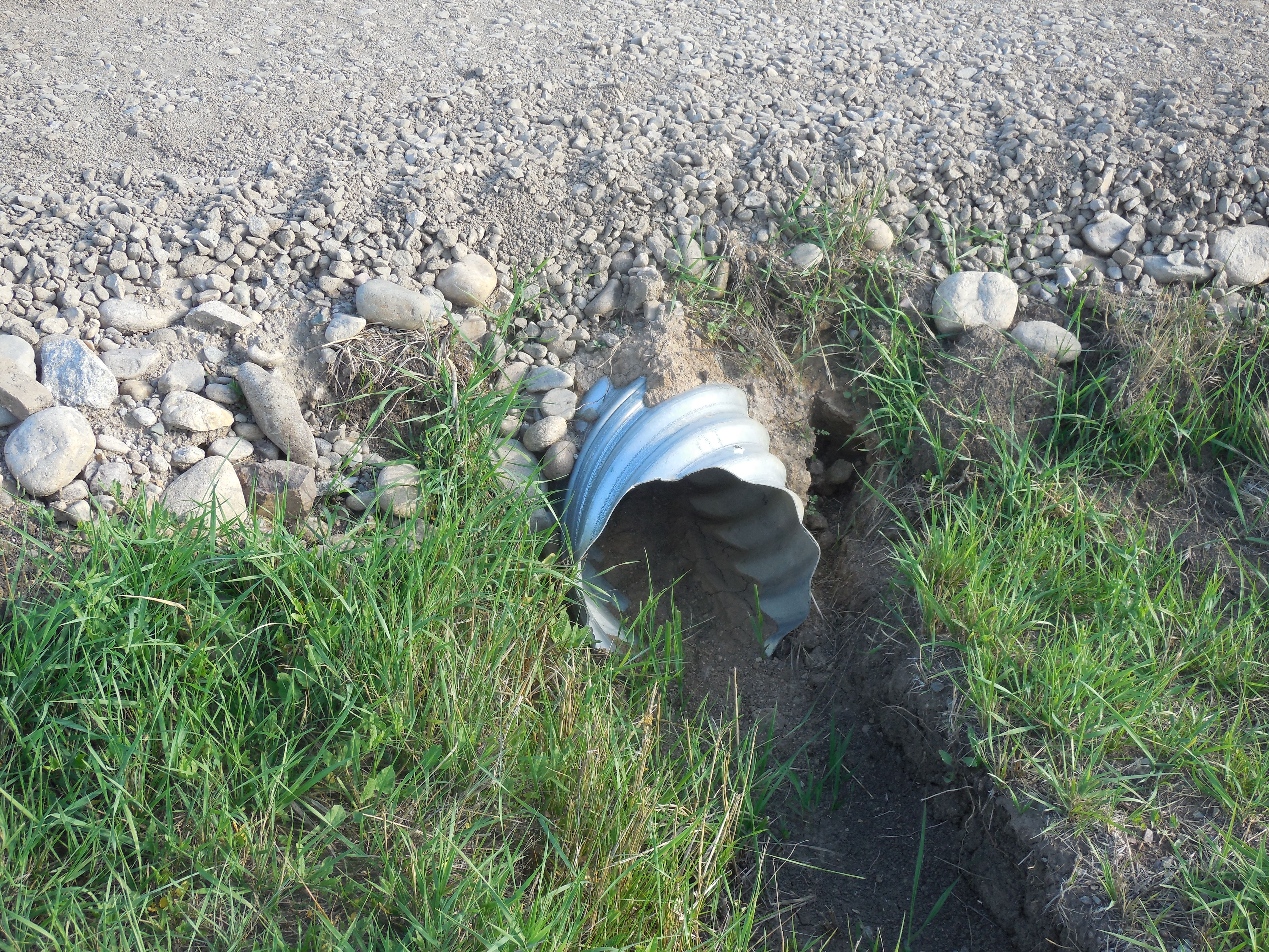

   / Putting in a gravel driveway #49
12" Minimum coverage, over the top of the pipe. So, if you are placing 12" of base rock, at a min you want the full thickness over the pipe.
Uh, oh. That sounds like the little 12" culvert I just lengthened won't make it.
Well, I'm not worried. With a few culverts like that, all of which have survived so far, it might live.
After all, the 24" one that has supported dozens of fully loaded end dumps and other machinery over the years is alive and well, with about the same amount of fill above it.
   / Putting in a gravel driveway #50
Uh, oh. That sounds like the little 12" culvert I just lengthened won't make it.View attachment 980854
Not saying less coverage will immediately crush, but 12" of coverage is generally spec'd by any public works/road department, and is a good guideline. Our OP has the ability to get the coverage, and frankly it helps his dip problem, so coverage is his friend.
   / Putting in a gravel driveway #51
True, in his case it helps. For me, I have to go by what depth the ditch is (pictured was a drain) and ideally I can keep the level uniform on both sides of it.
That described 24" culvert does have a somewhat substantial hump over it and bridges the main irrigation ditch. Sure, I could easily add some dirt to that one, but it's already a bit close to touching some trailer's landing gear.
But since that's not a drive I regularly plow, it's fine as is.
