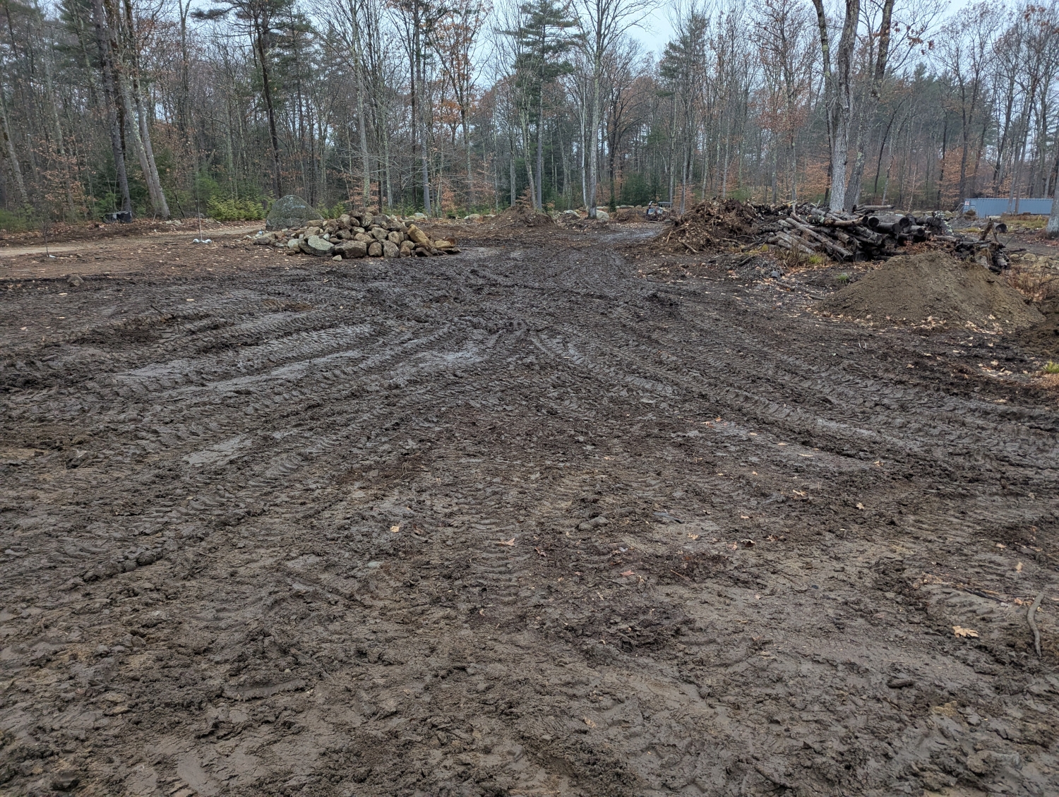

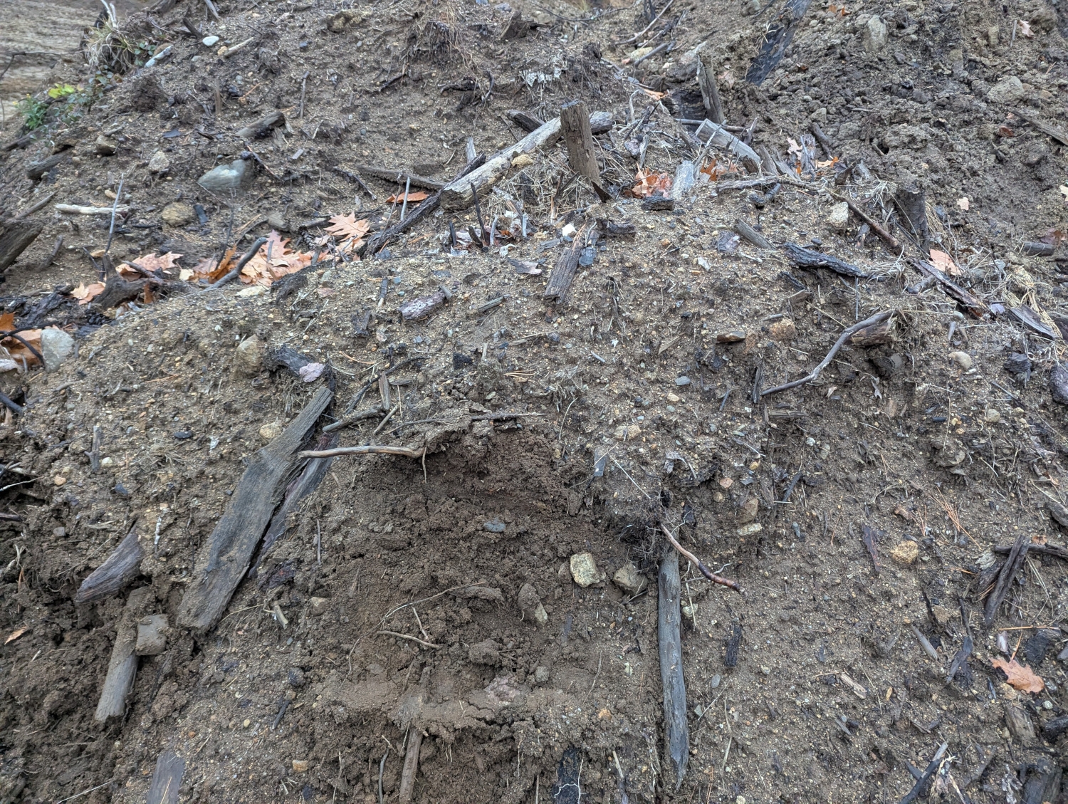

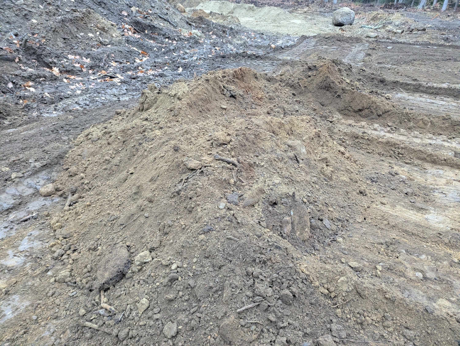

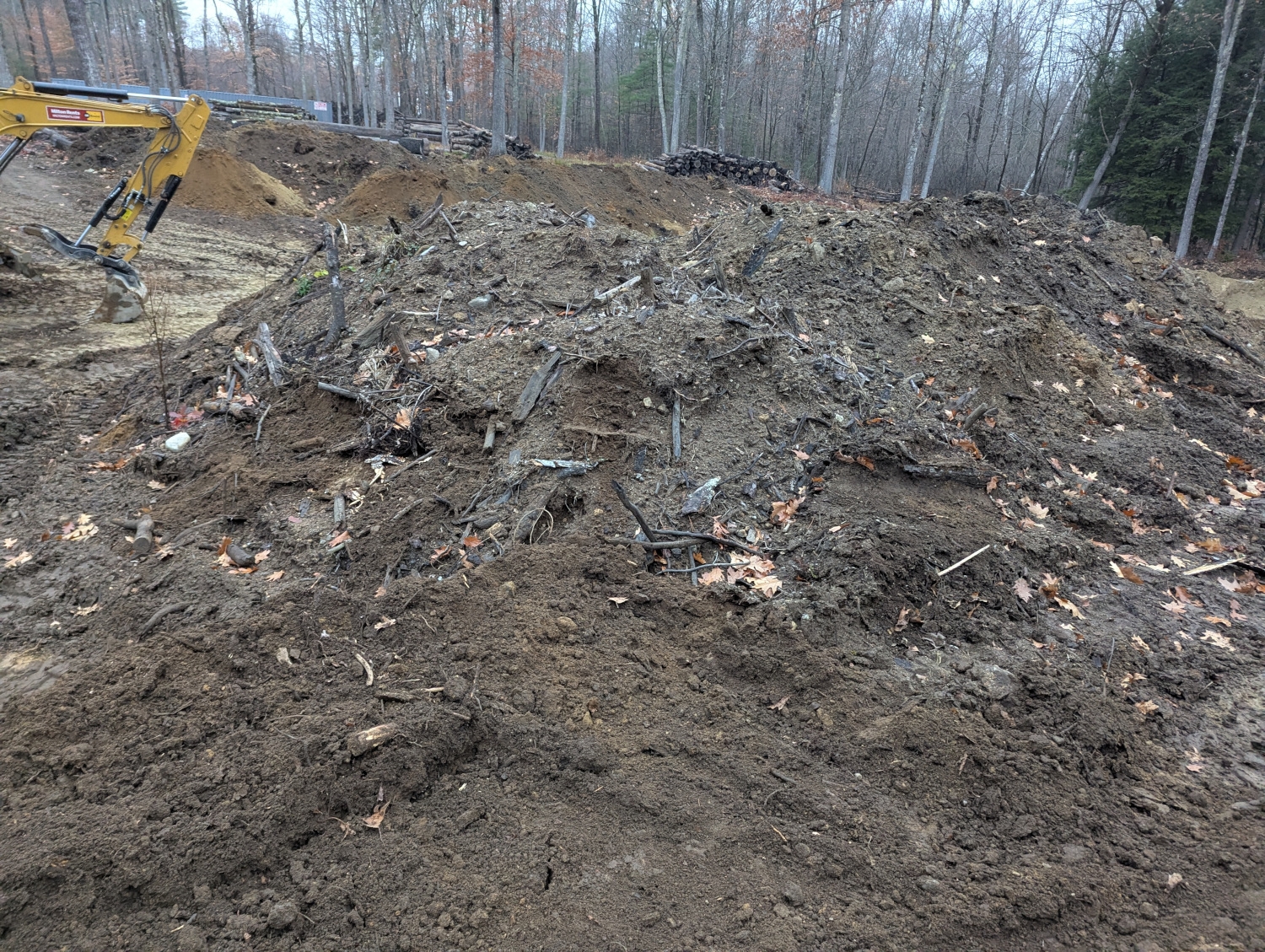

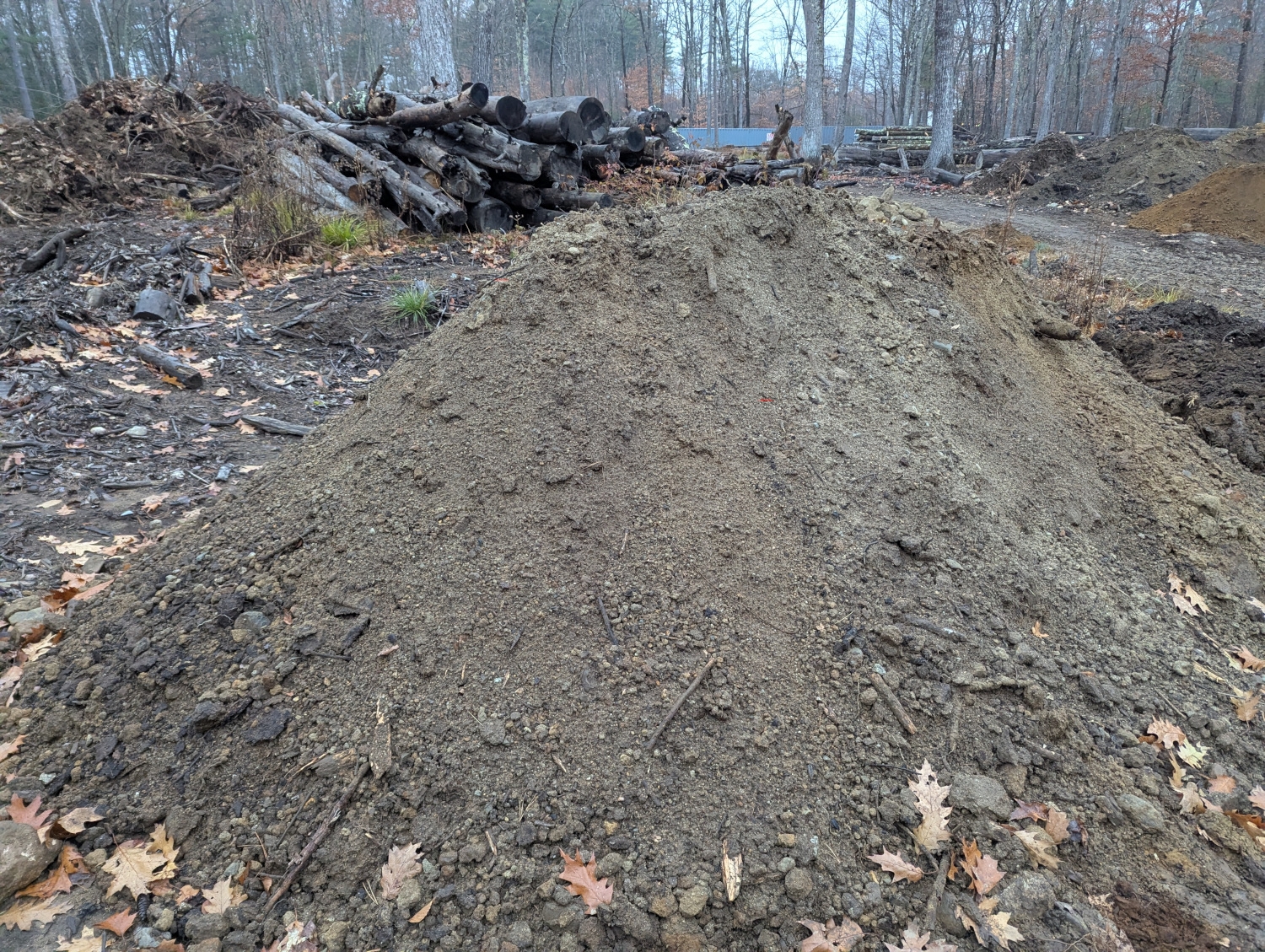

I have a piece of rolling land and I am at a point where I am considering filling a low point on the land (pictures below). What I am trying to determine is what is best to fill it with. I have a variety of materials handy. Everything from dirty fill(loam, twigs, small rocks, roots), to regular loam to a sand loam mix etc. The dirty fill is by far the largest amount of material I have but my concern is if it gets saturated it will be undriveable with my 60hp tractor. What would you use? I'm including images of the materials I have as well.

The question is why is that low spot there? When it rains does it flow a lot of water? If it does anything you put in there may erode away. Filling it in and adding some rip rap where the water would speed up would work.
It does collect some water but that area also slopes toward the back of the property so the water doesn't hang out. Even after we bring up the grade it'll still slope towards the back

I did the same thing as Eddie when clearing land here, but only a small area 50x80' low area that water would pool after heavy rain. I filled in with dirt, rocks, roots much like you have about a foot thick then had a few loads of sandy fill dirt spread on top of that then loam and grass.
Now I run over with my tractor 4000Lbs and don't sink in even with a load in the bucket. The amount of sticks and roots tend to bind together is my experience.

Its your 100% sure this area is just going to be grass, problem one helps solve problem two. Dump your tree debris, fill over that with the nastier material and top with the sand/clean fill.
Thats assuming you are 100% sure it won't ever be a structure, septic tank, driveway, or well.

A few points:
-fill needs to be compacted typically more than you think.
-Do your fill in layers with compaction following each layer keep layers at a modest thickness 6” or so per layer
-limit the amount of limbs and other woody material in your fill, these will break down over time and result i either collapse of your fill or voids in your fill
-avoid large rocks or concrete chunks in your fill as these can create voids and later collapse
- I like to start any fill of more than several inches with a good layer of gravel (crushed concrete works also) 4” if possible, this is for drainage. Again loom is fine for next level of fill, just not lots of wood stuff in it. The several inches of clean dirt for the final fill material. Then seed the area
