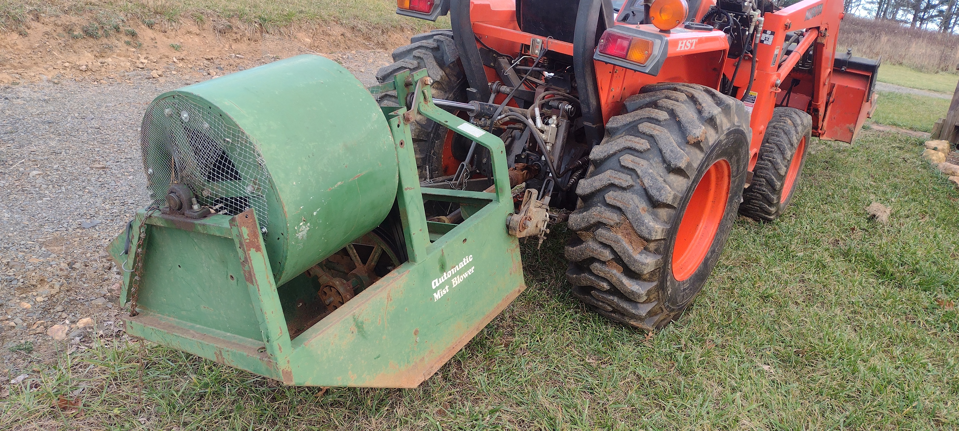

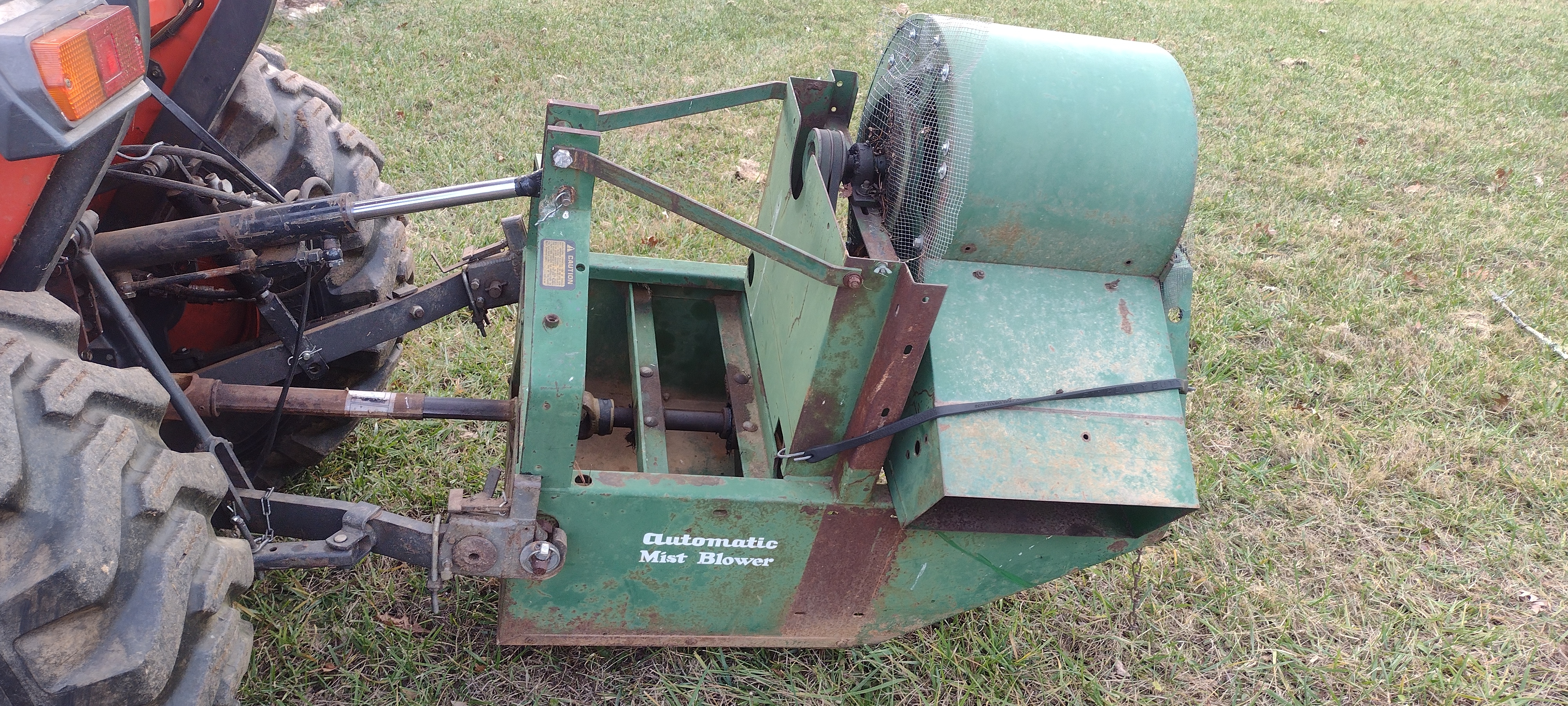

I use a blower that clears out my ditches.
When I rotate the drum to the other side (as shown in the photos), the opening points straight down into the ditch. In that position it blows gravel away. The position it's in the photos are set to blows leaves and sticks nicely.
