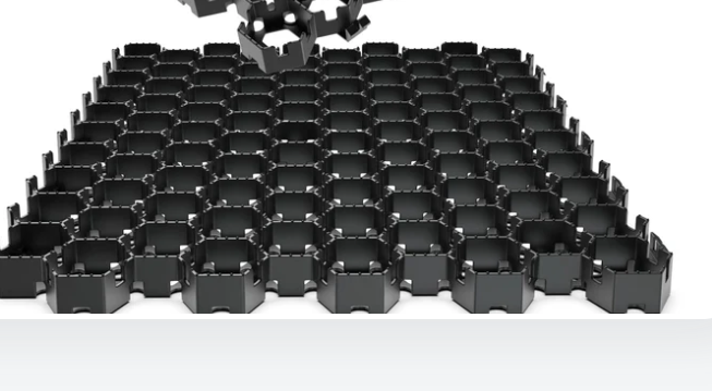

Thanks for the feedback. The driveway doesn't have to be perfectly level but that dip is pretty significant so it would need to be filled some. IU was leaning towards level especially for large trucks that are bringing building supplies. At some point we might have a large horse trailer and I feel like a large dip, spanning maybe 15', would not be good for that.
For the retaining wall it is not really a retaining wall. I am putting fill to the outside of the forms I was going to put up for support. The land slopes toward the back of the property so runoff is good.
As for the geocell. I haven't seen used on just the outsides of the drive. That would certainly save some $$. For a 12' driveway wou are thinking 4' of geocell on each side and leave the middle 12' open?
As for the geocell fill why sand and not gravel?
I see if the dip is not long then it make sense,

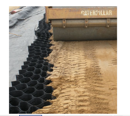

So what is your goal with the geocell? I was under the impression it was to used as supporting wall, to uses as lift to stood up the road quicker in order to keep the footprint narrow so stacking the geocell over each other. If that's the case then yes only on the edge and leave the middle without geocell... I would fill the geocell with gravel but fill with sand the middle to save money but that's for the supporting wall application... you can certainly put gravel all the way through but that will get expensive pretty quick, sand offer very good compaction, and good drainage, sand is used as road base all the time in our area.
If you want to used geocell as ground reinforcement, then it need to be the fill width of the road but if your soil is sand then I wouldn't bother.
even in the picture below they fill with sand
This would be for the entire driveway. No supporting walls needed with maybe the exception of the 7' dip.
As for sand bank run sand is the cheapest fill in my area. $7.50 per cubic yard. Straight sand is another $.50 per cubic yard. Then it jumps to $11 for -4 bank run gravel which has been recommended to me in the past as a base layer (no geocell)
