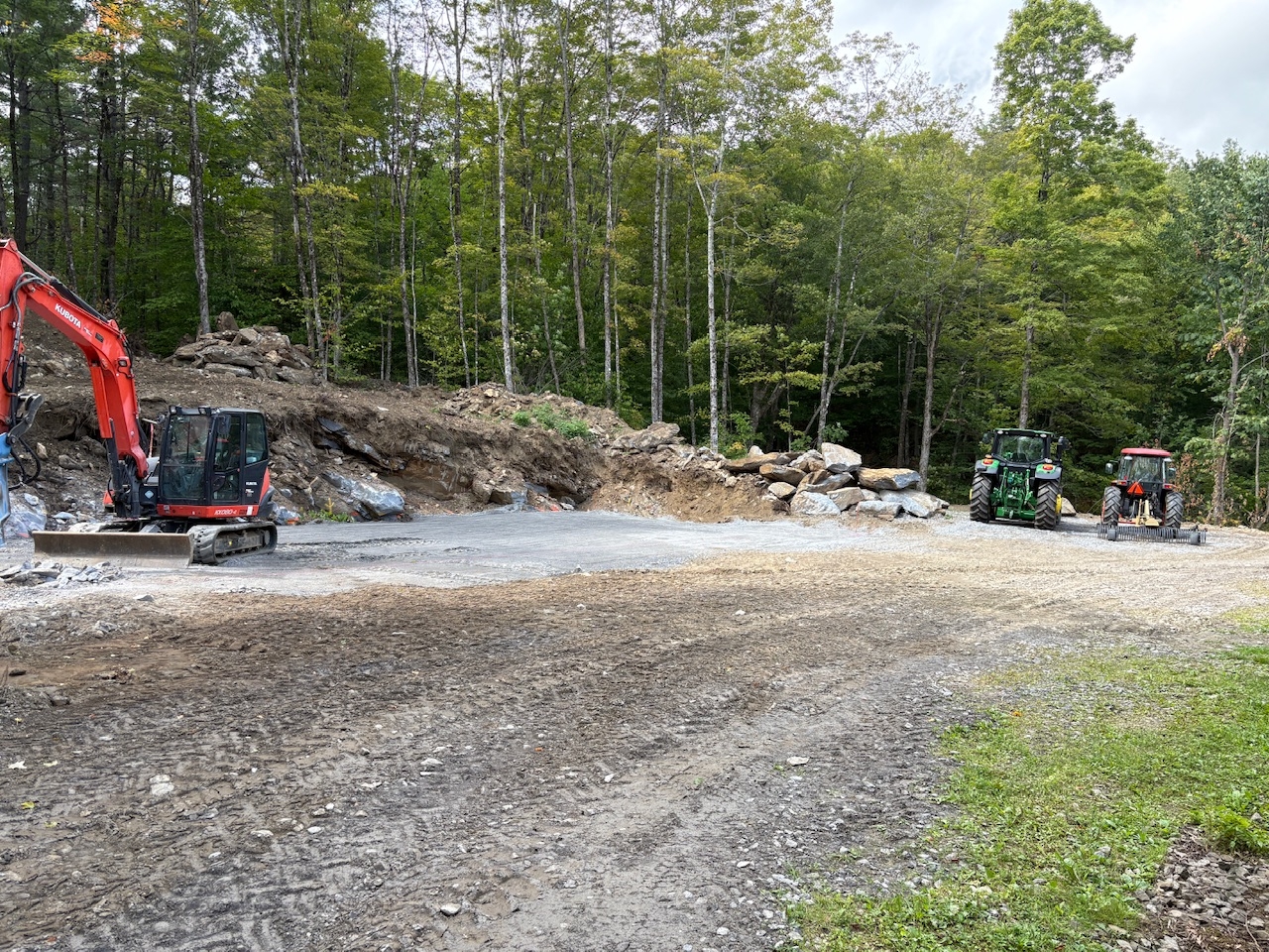

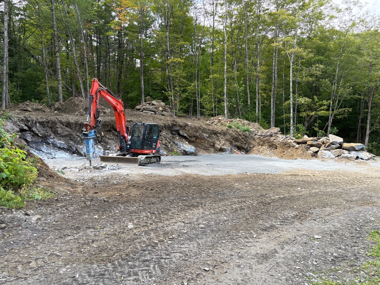

It is, and probably the last big construction project that I have in me. The stone removal was brutal and took WAY longer than I expected. I figured 2-3 weeks and it was 7 weeks, 2 chisel tools for the hydraulic hammer, 4 hydraulic hoses, and one hydraulic steel pipe. Plus over 70 dump trailer hauls, though thankfully the distance was only 100 yds or less.

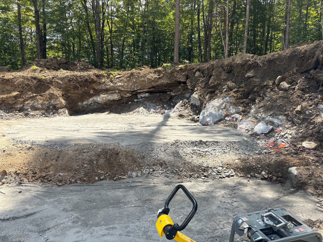

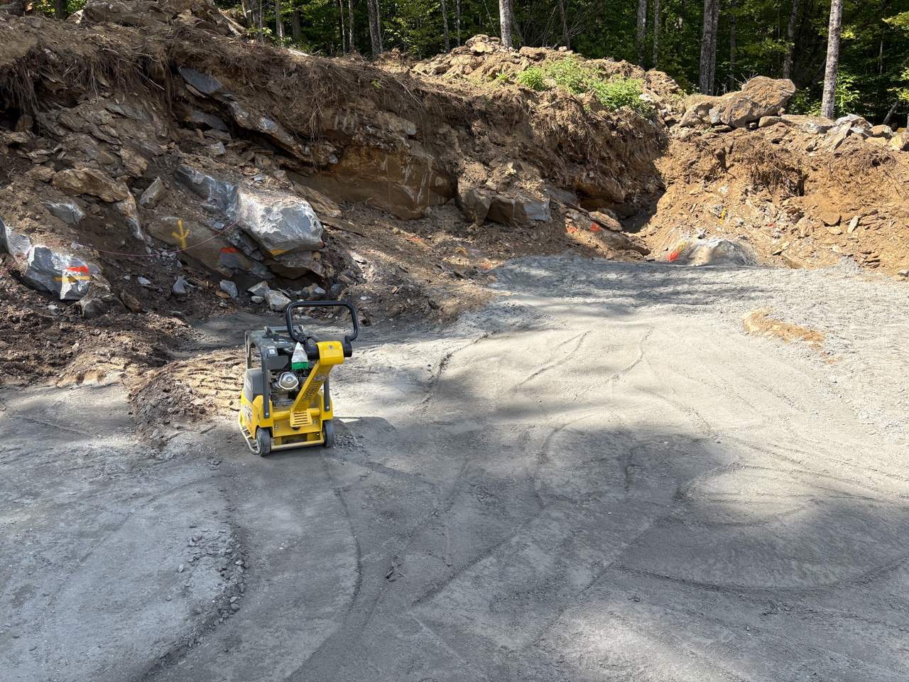

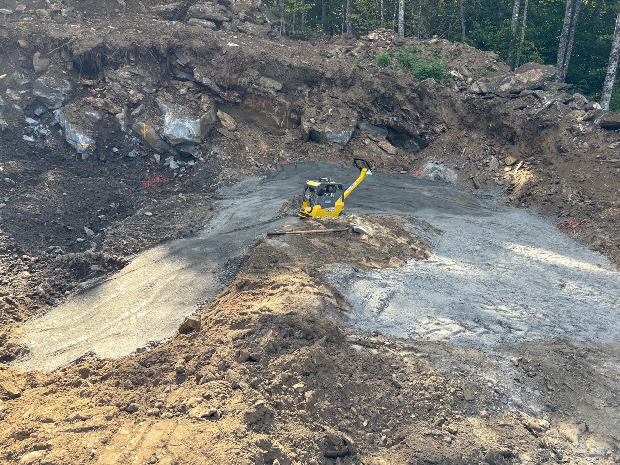

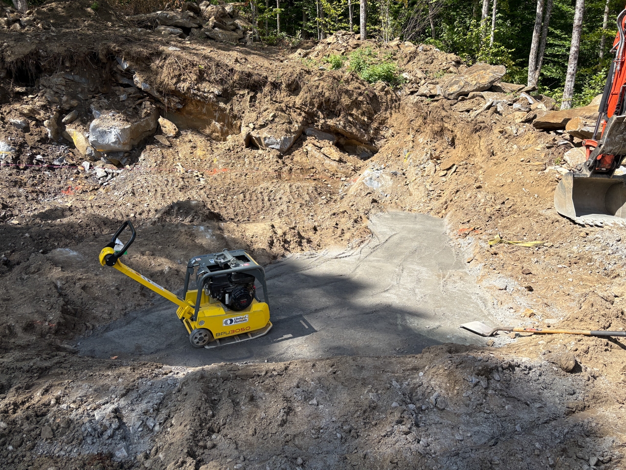

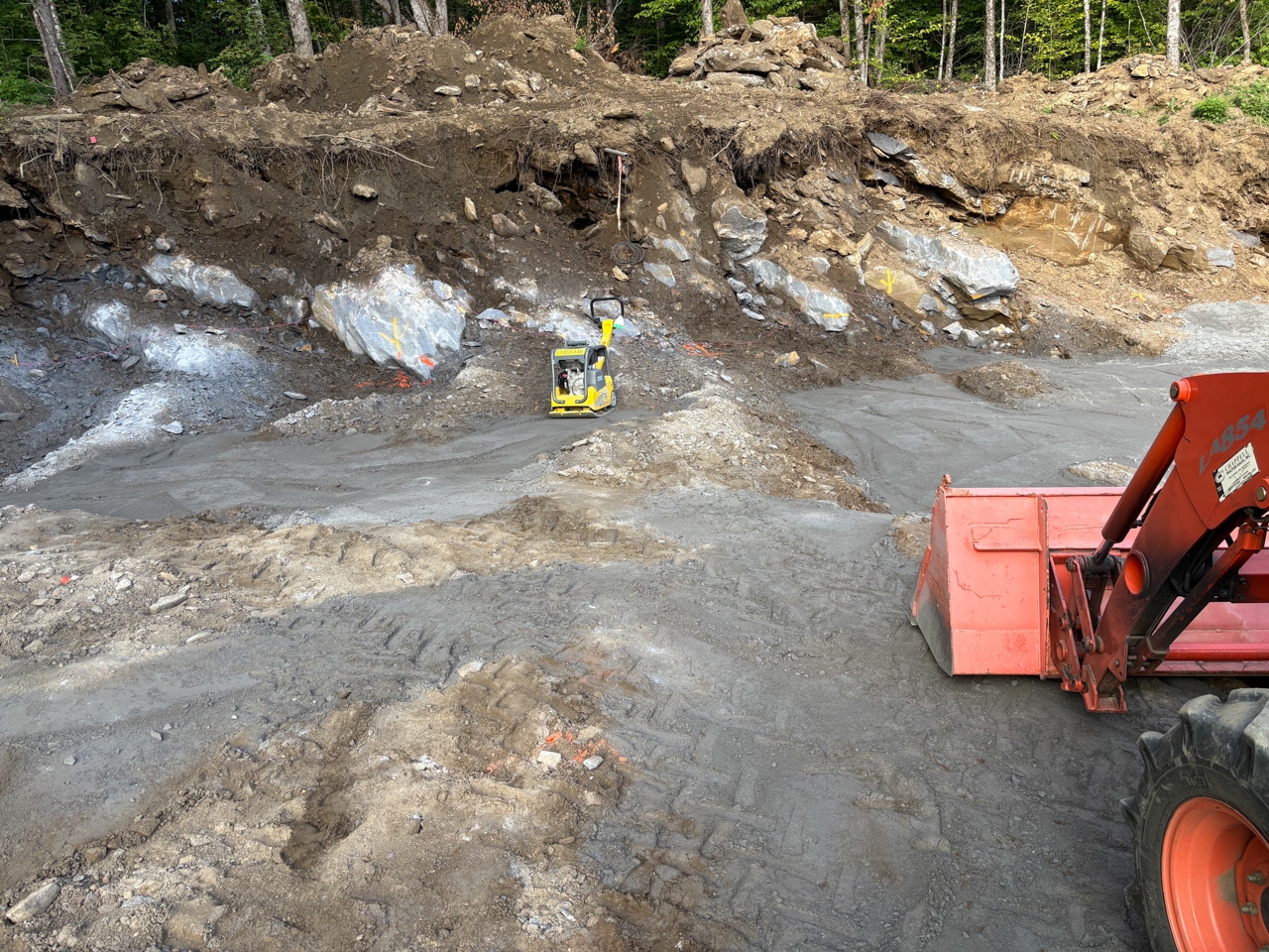

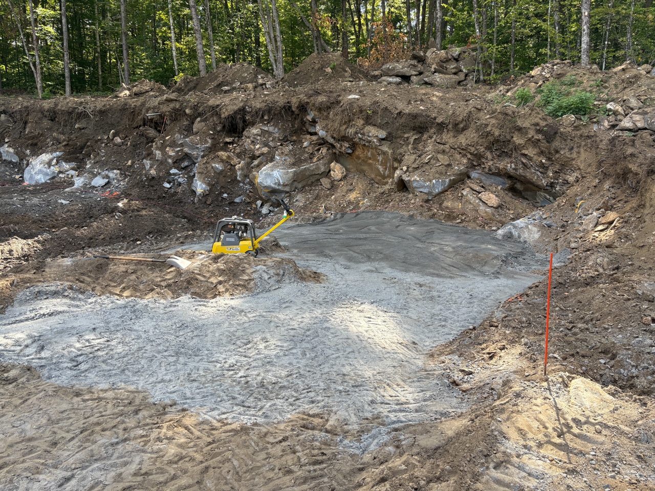

It’s now up to grade along the left end of the building, and within 2-6” everywhere else. And all the “islands” or rock outcroppings are now buried under compacted fill. That said, I did find one spot where the ledge was sticking up a bit more than I want, so I beat that into submission.
So far I’ve put in over 100 yds of compacted fill. And my 70 year old wife has been a real trooper running the compactor for several hrs each day while I move and spread fill.

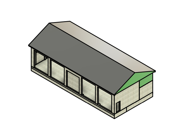

Well, I suppose I can tell the foundation saga while I'm waiting.
At first I hired a local engineer to design the foundation, but after the first meeting got pricing that was 3x what he originally told me. I interpreted it as "if you want to help" pricing, so I cut him loose.
The building company (Worldwide Steel Buildings) offers foundation design services, and in my meeting with them I hired them to design it. In the mean time, I lined up a guy who I have used before to built it.
My concrete guy and I met after I signed to purchase the building to look over the site and the various foundation styles that Worldwide uses. We picked one that made sense, and was actually the only approach that was plausible. You may recall from earlier in this threat that the building is dug into a hill side that is pretty much all rock. So a little over 2-1/3 sides have an 8' stem wall, and the remaining 1-2/3 sides are "walk/drive out". I documented everything and sent it to Worlwide as "guidance" for the foundation design.
A month or two later I got the final engineering drawings for the building, then maybe a week later I got the foundation design. The foundation design was ridiculous and bore no resemblance at all to what I had sent them. It was pretty clear that the info had not made it to the grunts who cookie cuttered the design. Plus, it was massively overkill. I showed it to a friend of mine who is the principal in a large commercial engineering firm is Vancouver, and he said it's more like you would build for a 20 story building. It all struck me as a case of an engineering firm doing cookie cutter designs with no consideration for the people who have to build them. And they are massively over designed to ensure they never come back to haunt them with structural problems.
I sent them back to the drawing board and they came back with a design that was in line with what we asked for, but still massively over designed.
In the mean time, my concrete guy said he would only do the project if it was massively simplified. Instead of stem walls with pilasters to support the steel frame posts, he wanted to just pour a really thick stem wall with no pilasters. Well, it would have to be at least 16" thick to provide a sufficient landing pad for the posts, so I said no to that. Meanwhile time was ticking away with winter approaching, and a complete shutdown for concrete work.
We then showed the new plans to another concrete guy who does more commercial buildings, and he also baulked at the plans. He said for similar buildings they always just do a thickened edge slab, then pour the stem wall on top of that. I asked him to price it and he came back with $80k (yikes), and could only do it next spring/summer. Now we are talking to a third concrete guy who comes highly recommended, but he's booking out next year too. So I finally called it, and we will sort out the foundation plans over the winter with a late spring start once the roads are no longer posted from mud season.

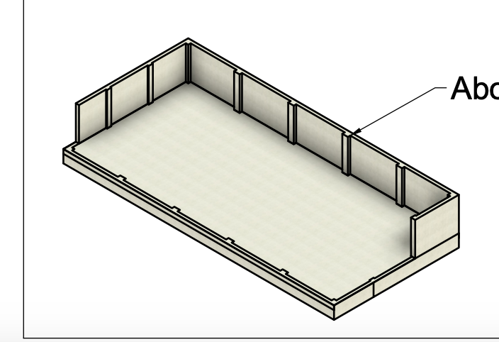

A septic system is the only thing I would need a permit for, and I'm not building one of those, so no permits required. I can do whatever I want. Around here a pole barn just won't last because the poles will move with the freeze/thaw cycle. They are quick and easy, just just don't have the longevity of other approaches.
As for "thinkers" vs "contractors", I half agree. Maybe even 3/4 agree. I'm a former engineer myself, though a different kind, and I know all too well the phenomenon of engineers sitting behind desks looking at specs and drawings, yet having never seen a construction site, let alone actually built anything. Pretty much all trades rag on engineers for being clueless, whether it's mechanics, or contractors, and a lot of it is well deserved. But contractors also only have part of the puzzle. Yes, experience counts for a lot. But at the same time a lot of people just keep doing things wrong over and over again because they haven't seen it cause any problems. It doesn't mean it's not a problem, they just haven't seen it. And when circumstances change, what you did before somewhere else might not work again. In my experience, it takes both.
In this case, one issue is the force of the retained soil pushing against a tall wall and wanting to overturn it. And if that soil is saturated with water, the force goes up significantly. The tipped force is counteracted by the "toe" created by the thickened edge of the slab, both from its leverage, and also from its weight. In houses where there is a floor deck on top of the wall, that provides a significant amount of the required support. I don't have such a deck, so all the force has to be carried by the wall. The end result is just as you describe; make the wall thicker, add more rebar, and start pouring. But how much thicker, how much rebar, how thick for the thickened edge, and how wide does it need to be.
I'm listening to what contractors are suggesting, and our current thinking is MUCH more in line with what they suggest vs what the engineers came up with. I have pretty much discarded what the engineers came up with. But I do want to check what contractors are suggesting to make sure it passes some basic engineering checks.
As for wall thickness, that has become an interesting topic. I think I mentioned that one guy didn't want to form all the pilasters, and instead just make the wall as thick as needed. That's pretty much what you are saying, I think. The challenge is that the columns need an 18" landing zone, so that would force the wall to be 18" thick which strikes me as crazy thick. It might be OK to shrink that down to 16", but it's still a really thick wall, and a lot of extra concrete. But maybe that is the right way to go; just simplify the job by throwing concrete at it. What do you think about a 16" or 18" thick wall?
Where we are right now is to just pour a thickened edge slab floating on a bed of crushed stone. Then pour the stem wall on top of that. There will be a perimeter drain, but I have been worried about water coming in between the slab and stem wall seam. One guy mentioned some seal that they have used successfully. Maybe you know about that? Also current thinking is a 12" thickened edge for the slab extending 5' inward towards the inside of the building, tapering to a 6" slab in the interior. Then 10" thick stem walls with 18" pilasters.
