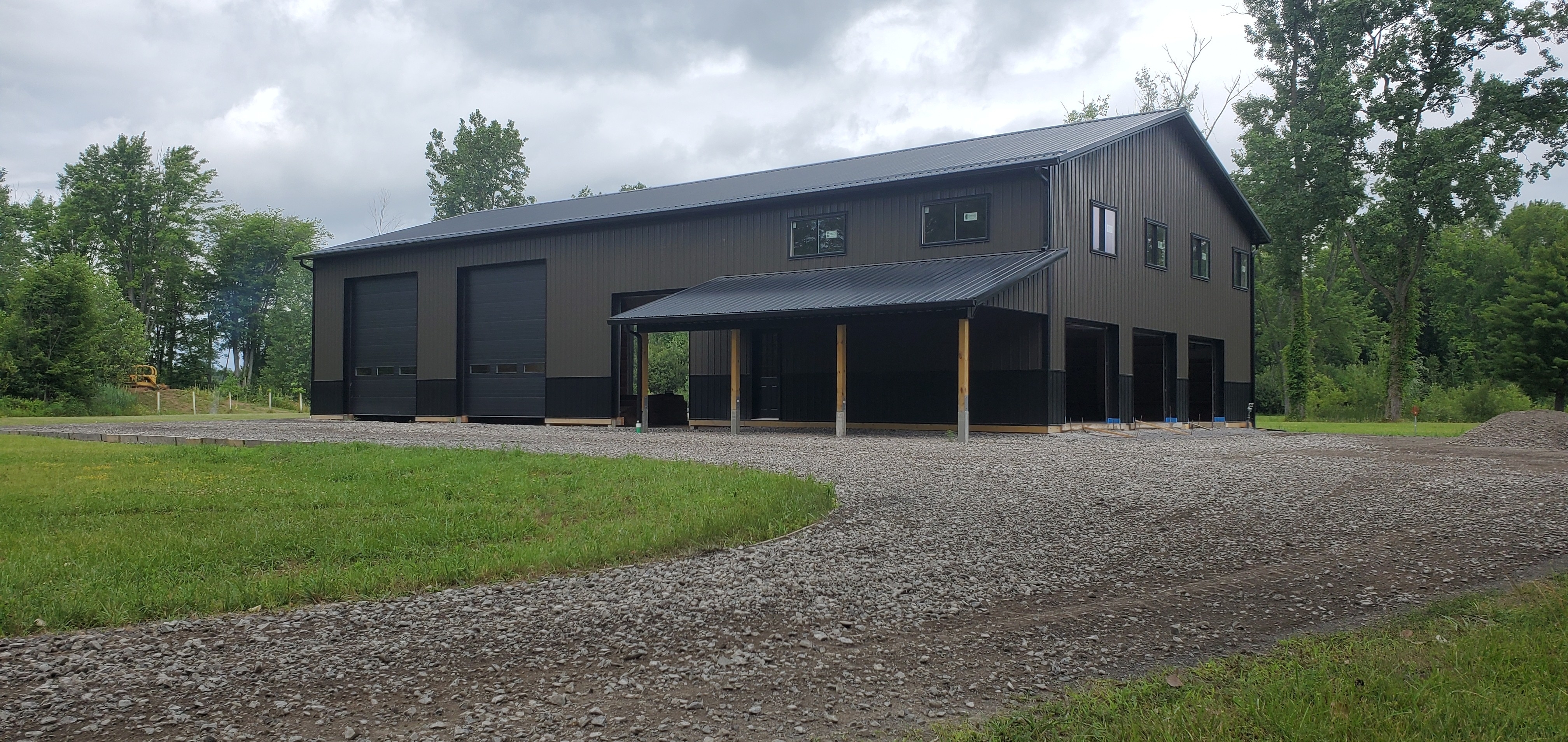

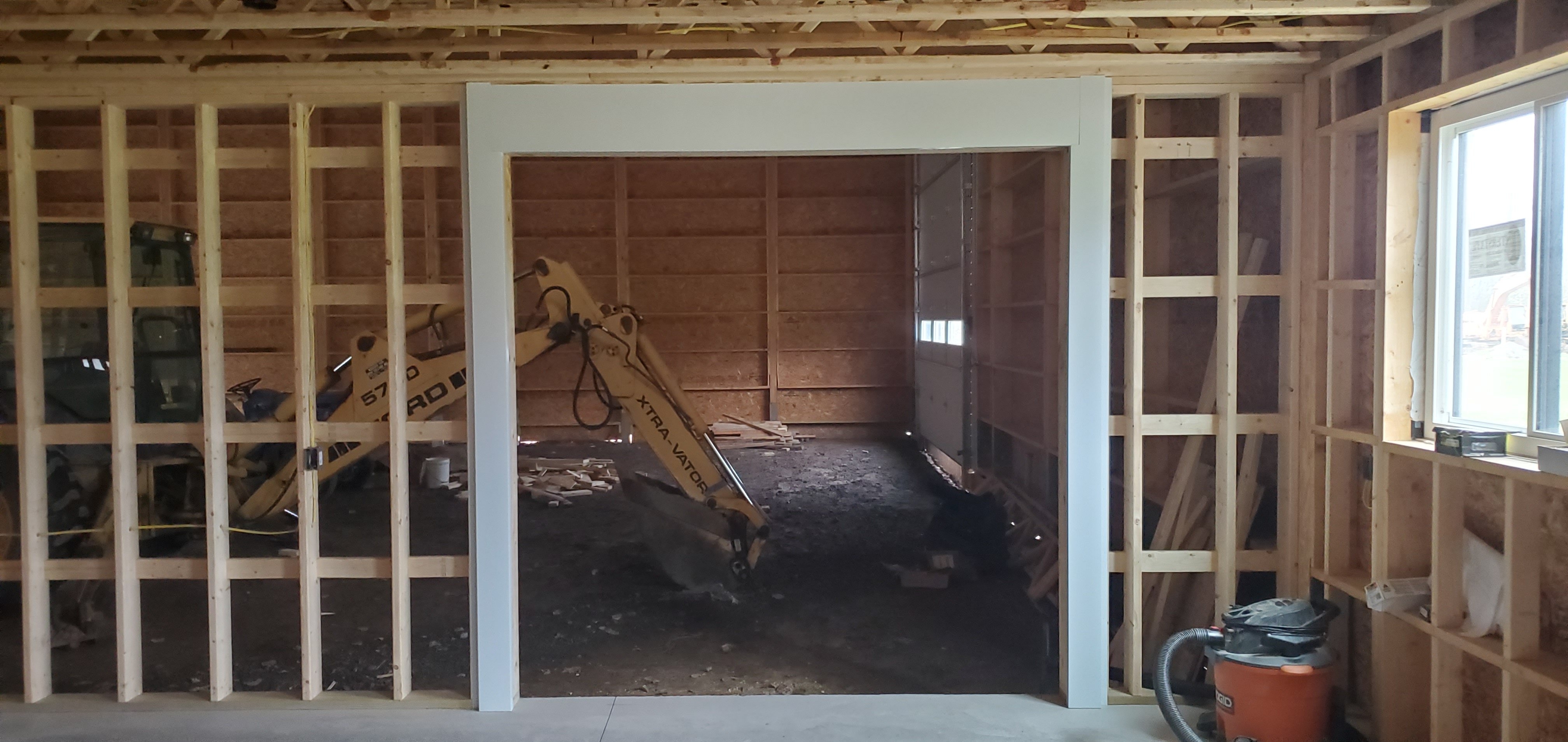

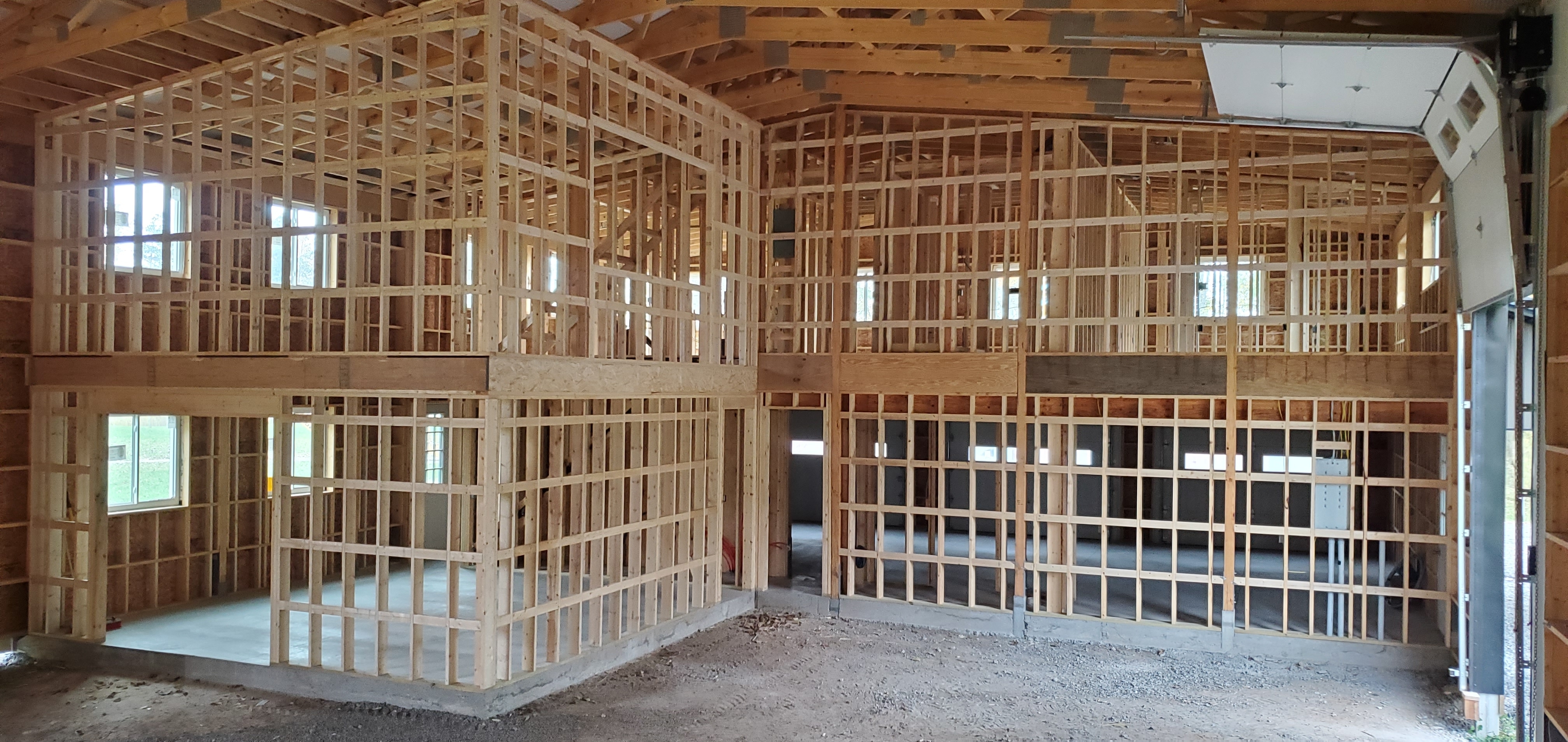

I am building a "barndominium" ( I hate that term but it's what they are called I guess) and need to start thinking about the final solution for the shop interior walls.
I have trimed out all the OH door openings with white steel so that no lumber will be showing when the walls are finalized.
For the garage and lower workshop area where there is living space above, the walls will be drywall.
For the shop, my initial thought was white corrugated steel from the floor to the ceiling. However, I started to think about a plywood wainscoating that I would paint white. Otherwise there would be 18 ft tall white steel panels that if the bottoms were to get damaged from pushing workbenches/cabinets/equipment against them, fork truck etc, they would be hard and costly to replace. The plywood is not going to dent like the 26 GA steel.
Initial thought was sideways plywood for a 4ft tall wainscoatinng matching the outside wainscoating height. But then I got to thinking that 4ft high might be enough to mount outlet boxes above workbenches, but then no room to mount racks to hang tools etc. If I go vertical with the plywood and have an 8ft wainscoating that is the height of some of the interior doors and would look wierd. Going to 10ft long sheets of plywood would fix the 8ft door opening height issue but then there would be more plywood on the walls than the steel and might look even weirder...
My initial goal was to not have to paint anything on the inside of the shop, hence the full height steel panels.
I'm wondering what others have done, and what they like/don't like about their choices.

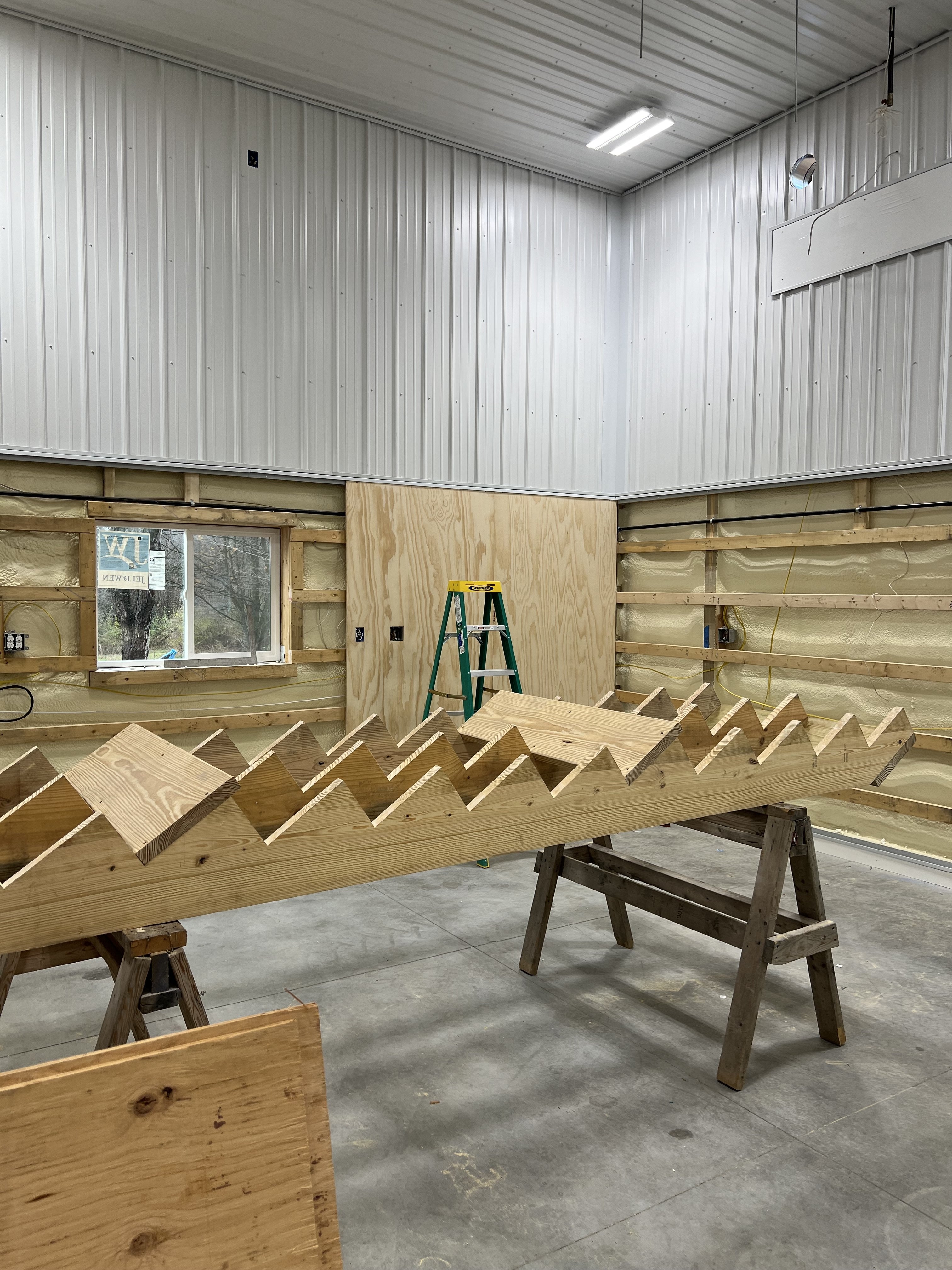

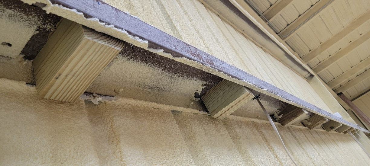

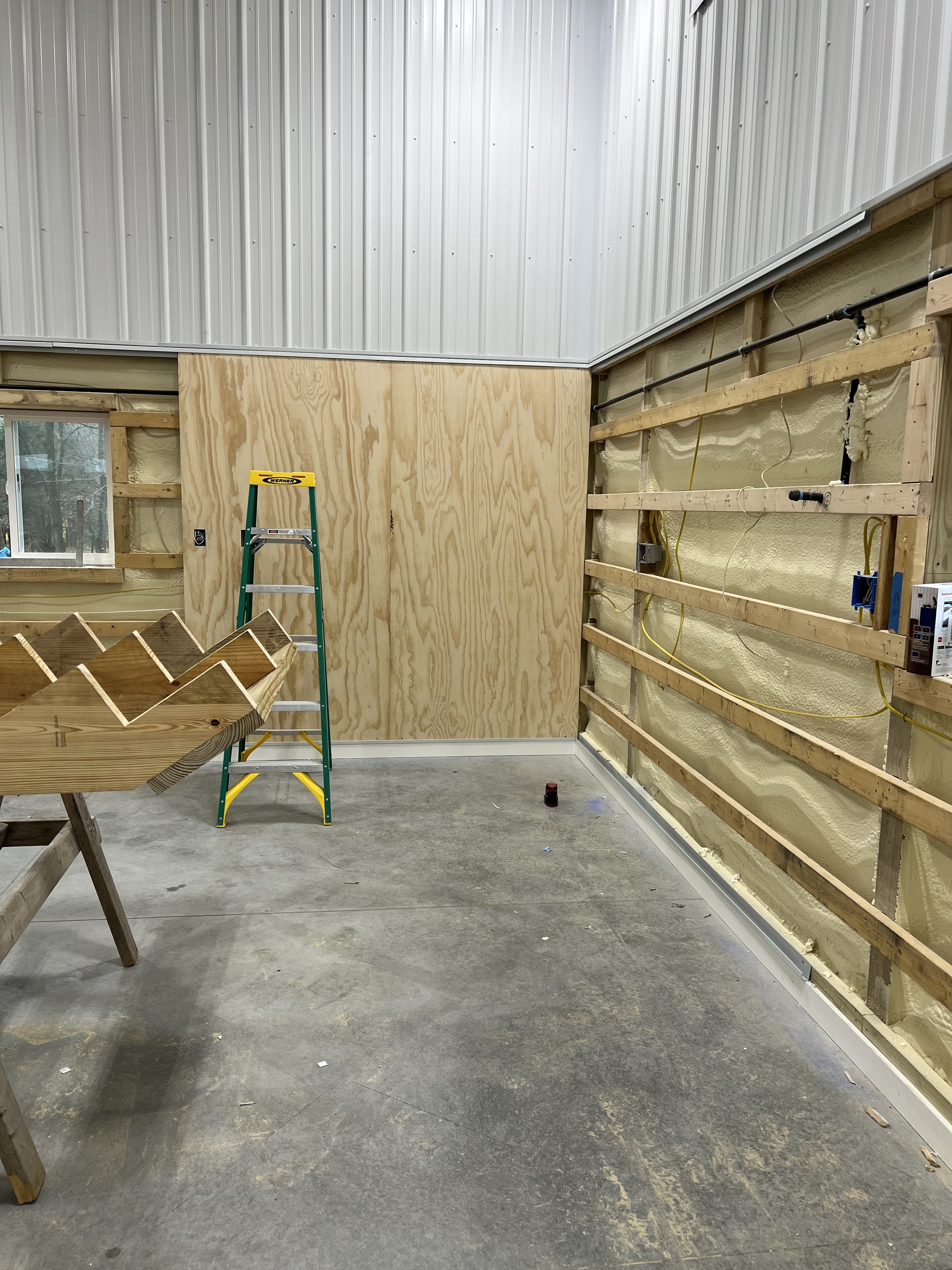

My shop is a metal building here in East Texas. It was a bear figuring out how to frame it with lumber without the walls protruding. Long story.. we were still in PA when the shop was being built. I should have planned better and had it built to accommodate framing but I didn't. Initially I had the whole shop spray foamed but that in itself was another story. Sprayfoam guy was inexperienced.. sprayed on a 100 deg day. Nothing but issues. Foam didn't expand well.
So for additional insulation, I got two open cell DIY spray kits... enough to do the lower 8 feet.. adding additional inches to the first spray.. Then on top of that I installed 3-1/2" fiberglass insulation to bring it flush with the studs.
Installed plywood vertically... yes i know it's not as rigid this way.. I should have gone with two, staggered horizontally but i like the look of this better. I really don't like the idea of metal walls. I would be super hesitant to drill holes in it and then change things up.
To do the initial framing, I glued and screwed 4x4 blocks under the girts for something to shoot the top plate into and keep the framing flush with the verticals. Shot the bottom plates with a .22 nail driver. Didn't bother with pressure treated there as it is sitting on epoxy.
This is just a stiffening member across the backs of the top of the plywood as the plywood extended higher than the horizontals.

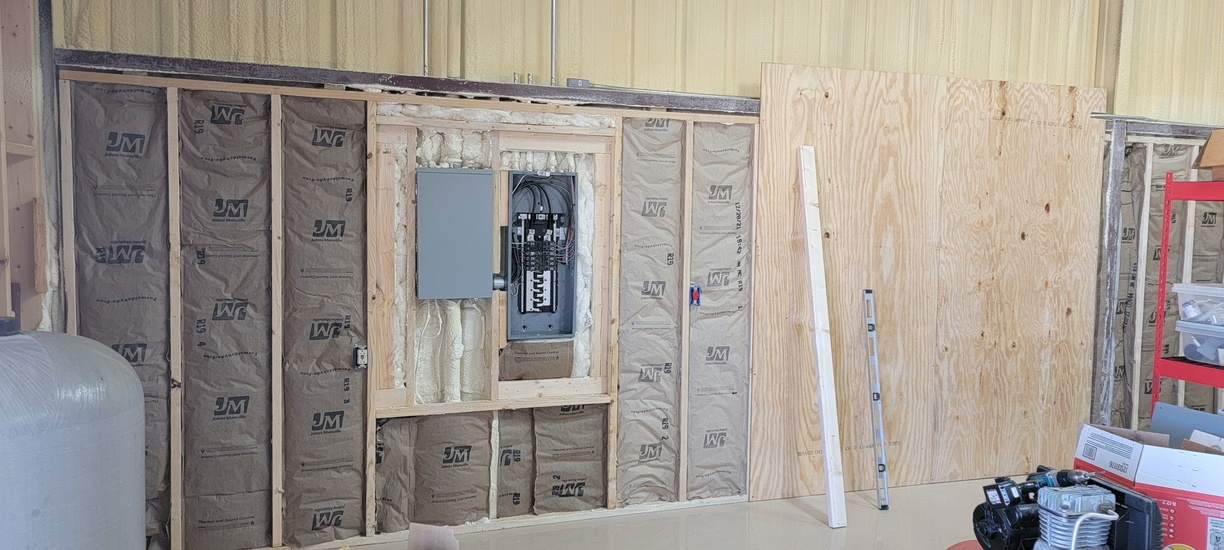

We just set up and moved in a new-to-us auto repair shop. Used 5/8 plywood on the walls, vertical 8 foot, set up a quarter inch off the floor. Clear coated for easier cleaning... so far it seems like a good choice... It is easy to attach anything on the walls, if you want to attach shelving be sure to locate wall studs for support brackets!

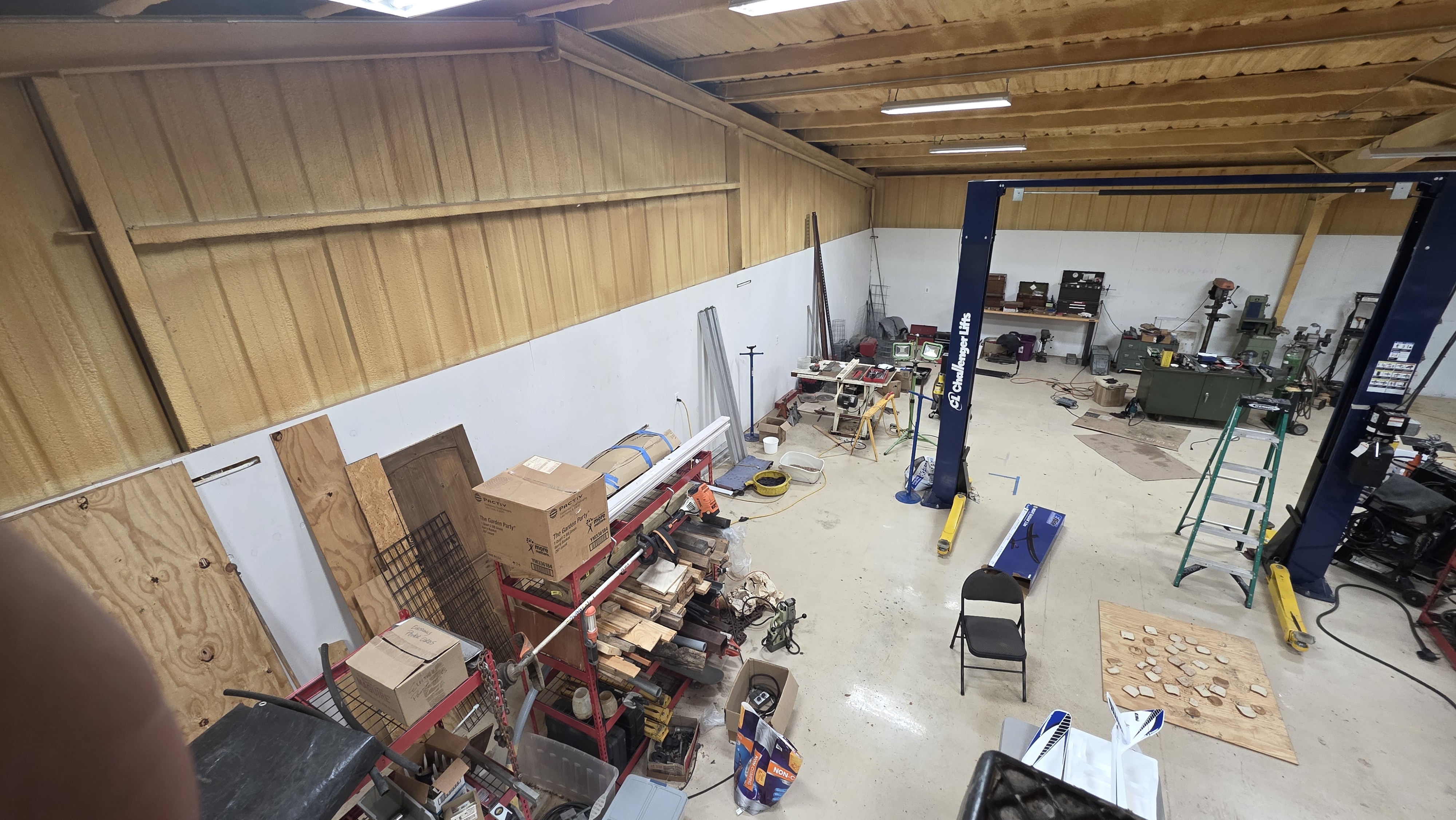

Late to the thread, and I didn't read all four pages, but every garage or shop I've ever owned has had either plywood or OSB wall board, painted a light (off-white) color to enhance lighting brightness.
And as silly as it sounds, the paint is absolutely crucial. I had one shop with un-painted OSB for several years, and it was like working in a dark dungeon, no matter how many shop light fixtures I hung in that place. Just about impossible for doing any detail work.
Here's the current shop:

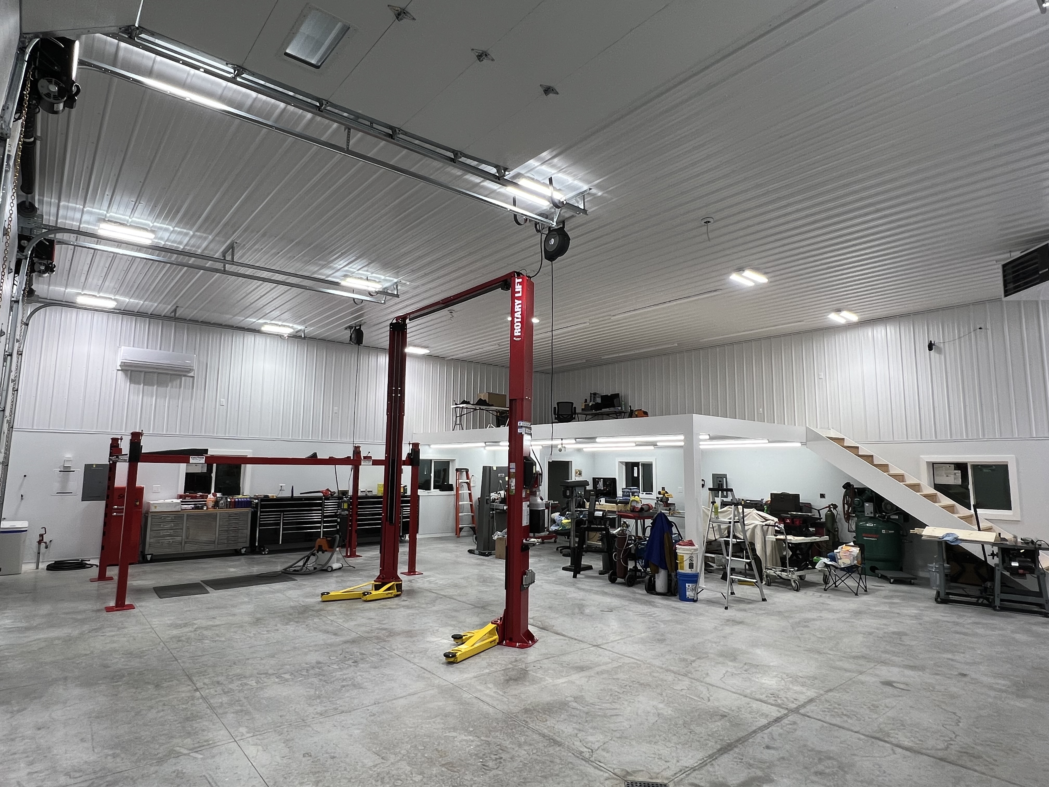

I used sanded three-quarter inch plywood for the first 8 feet and then metal to the ceiling. I set the plywood on Azek trim to keep the water from wicking into the plywood. The joints were chalked before painting, but I left the screw heads visible in case I need to pull a sheet off to get behind it.
That minisplit handles that?

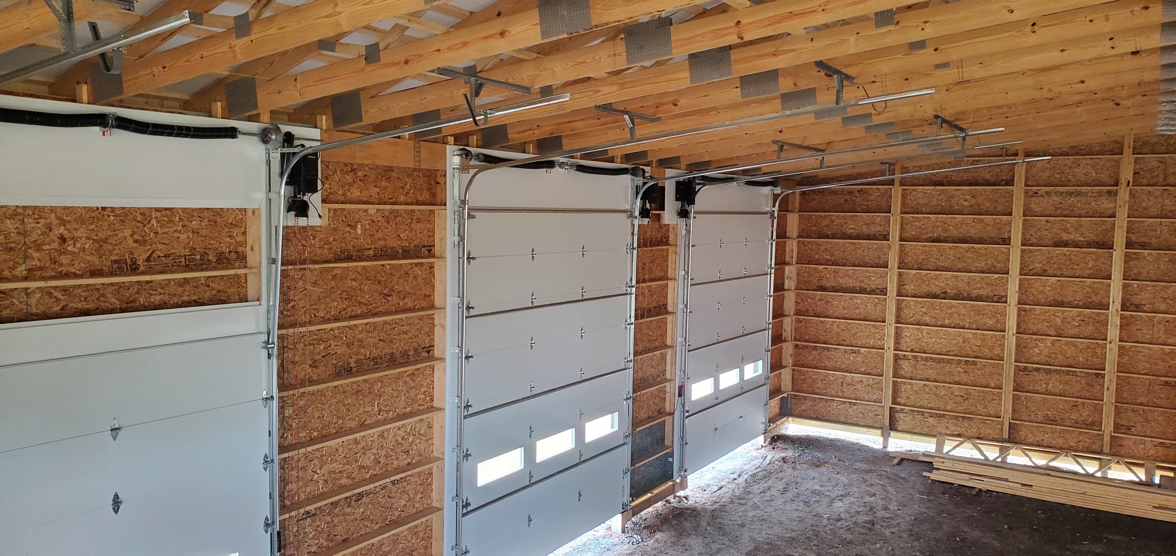

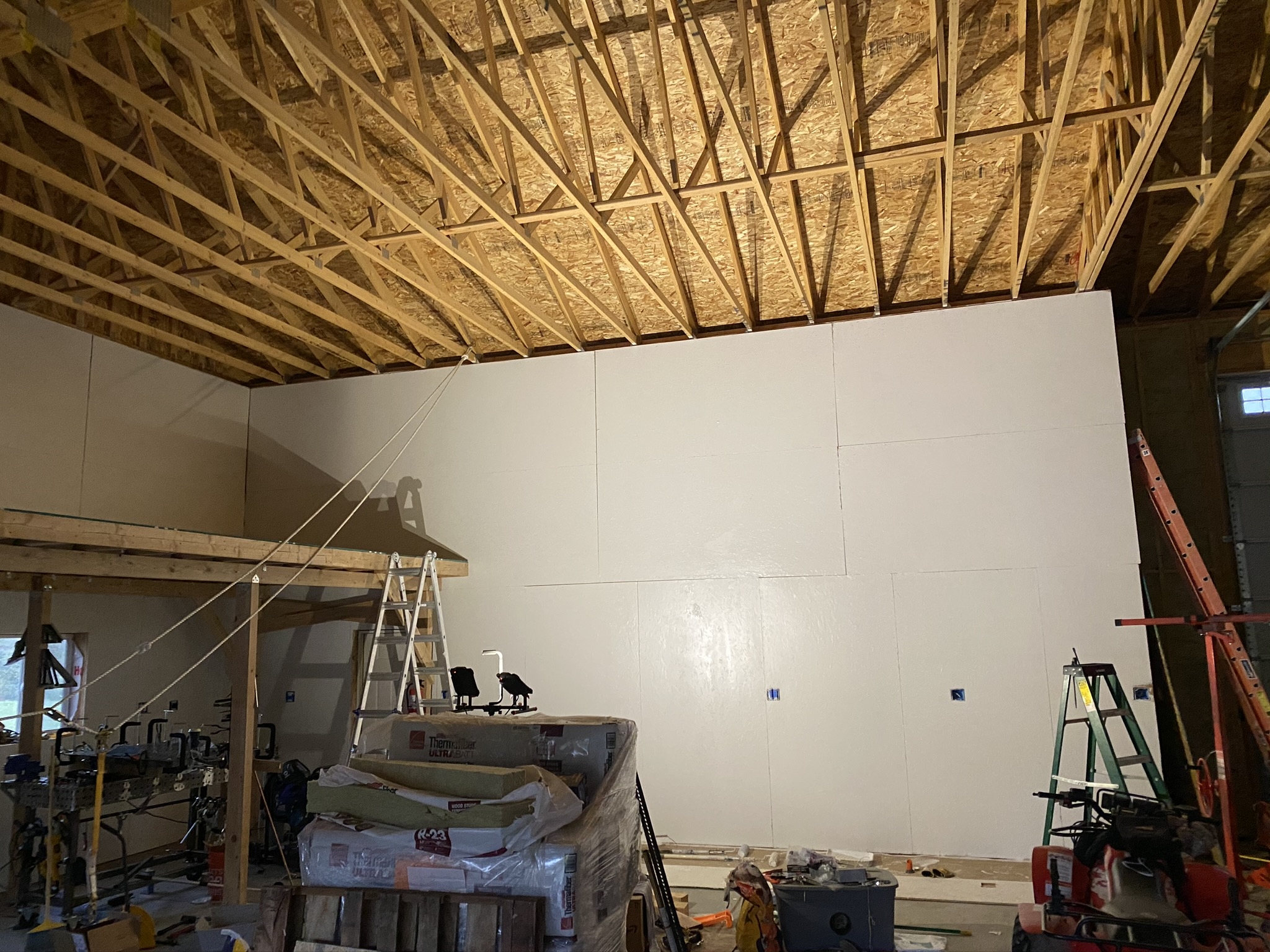

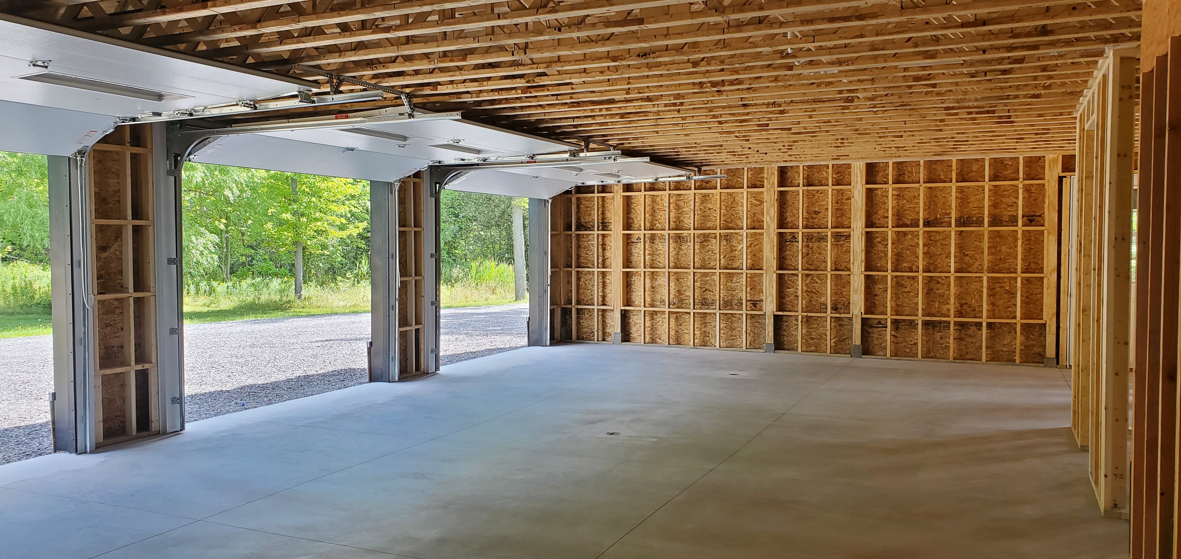

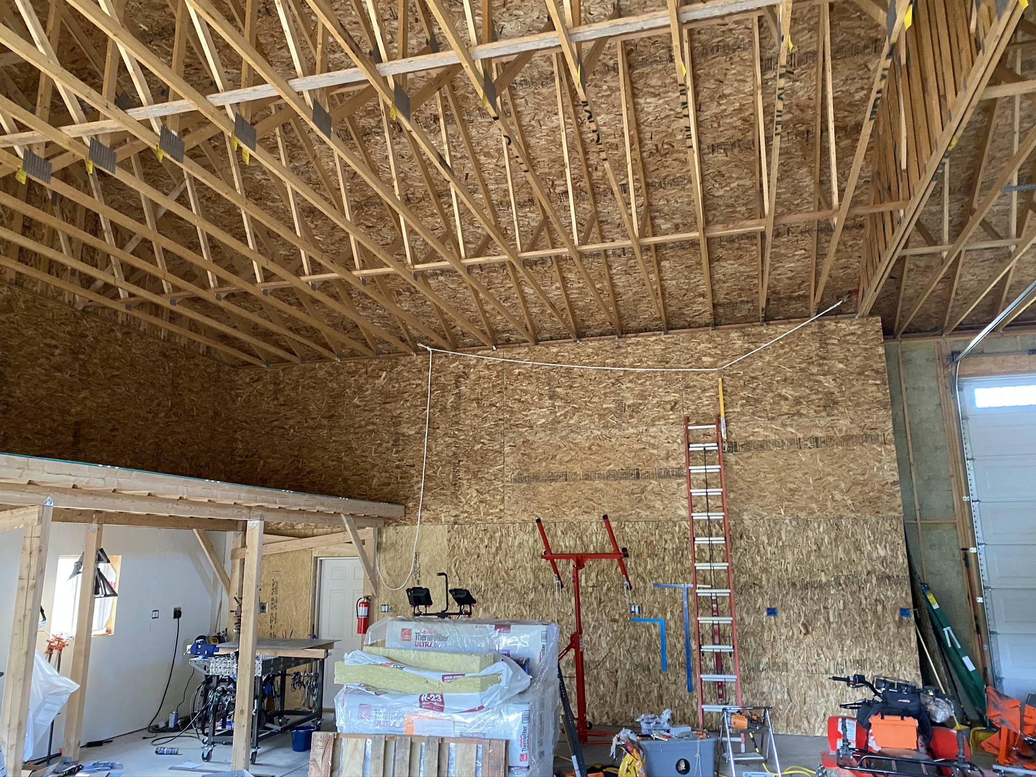

I used 7/16" OSB. Hung it first and rolled on 2 coats of Kilz white Primer. I'm really happy with the result. Easy to hang stuff on and really helps with lighting to have white walls. Cutting outlets was a bit of a pain. Jigsaw ended up being the best tool for the job. I do have insulation between the studs (not shown here).
IIRC, I hung the OSB about 1/8" off the floor to avoid any water on the floor from creeping up the OSB.
Thought about using plywood, but it was drastically more expensive and much heavier. Drywall would have been cheaper, but more difficult to hang and less durable.
