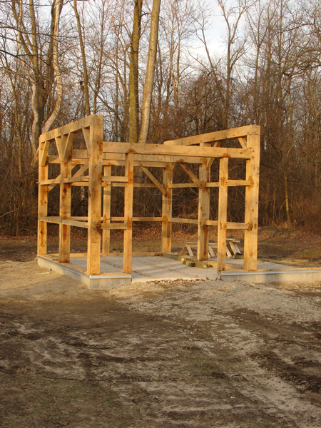

Excellent timber frame structure, both the Amish and you can be proud of your craftsmanship. Great pics and documentation of the progress, just like we TBN'ers like it.
Noticed that most of the mortise and tenon joints look "WET" in pics. Did you use some type of lube to ease assembly , or some glue to hold dowels ??
What does a package like that cost , how much to ship ?
Dull:
The wet you see is Linseed oil and terpentine. The frame has not been oiled and there is some debate on the value of oiling a frame while its still green but I at least wanted to oil the mortise and tennons prior to assembly to help fight water migration in the joinery while its standing naked.
As far as cost goes, the original okay given by the boss was for a couple of thousand dollar shed, lets just say that I could probably get quite a large pole building for what I will have into when done. Astetics outweigh size in this. As far as shipping; it was under $1k to bring 15,000 lbs 200 miles and it wasn't easy to find someone to do it.

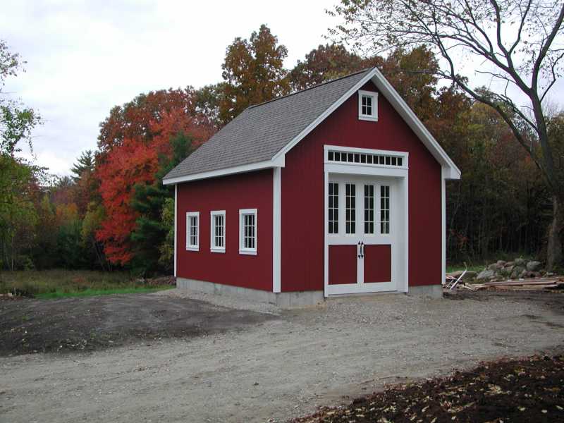

That little barn is going to be sweet. Sometimes when the building size is right for the property and the style just fits, it all really comes together.
This is our little barn just built last year.

cmhyland:
You have the same idea I do, its all about porportion and detail. When I stand inside the frame its massivness changes its size and the detail I have in my mind will make it fit.
Your barn is very nice and its the details that sets it apart. Did you do a thread about when it was built? I think I remember it.

/ Timber Frame Tractor Home #33
Rox,
Thank you for your comments. The little barn is pretty traditional in terms of New England style.
Of corse, if this were France I might have had to build it from field stone!
I've seen a few if those and man they are beautiful... Down south of here they used to build what they called stone enders. The gable ends were stone with post and beam side walls... Really a beautiful look.
So, sighting the building properly, making sure it does not overpower your property and the trim details make for something special.
KHD is building something special.

/ Timber Frame Tractor Home #34
Kevin,
I did do a thread when we built it....
Your little gem is really going to look nice. From what I see you could have built out much more space for the money, but instead opted for very high quality... It will really show in the end..
I have people stop and come to the house and ask about the our barn...
You will to if people can see it from the road.
