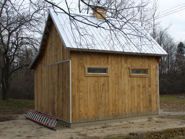

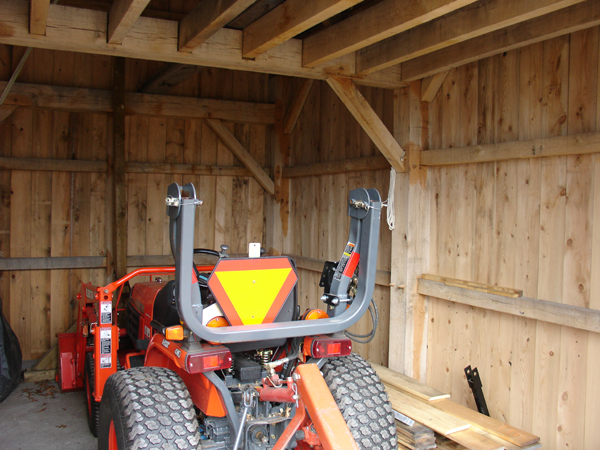

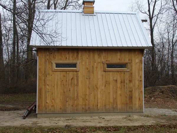

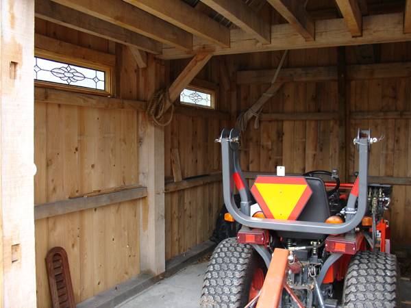

Well, winter is upon us again. It is also officially one year since I started construction. I had the foundation done the week of Thanksgiving last year. I have been working on it bit by bit but again, travel for work doesn't leave much time to get things done. I do have it closed in for winter as the siding is all on. Will be hanging a tarp over the door for winter just to keep snow out as the tractor has been officially moved in. I hope to get the doors built in the garage over the cold months.
Attached are the latest pics. Today I got the two side windows framed and set. The first two show the exterior with windows and the last two show indise with windows.
Hope everyone had a good Thanksgiving.

I really like the look and the craftsmanship of that building. Down here, though, the bugs would eat that building in 2 years...termite shield or not...

Looks great. Anybody can build a barn, but you've created a work of art!!! Truly one in a million.
Thanks for sharing,
Eddie
Thanks. We have 'em here to but carpenter ants are more prevalent. BIL has his own pest control business and I already have him keeping an eye out for all pests.
Kevin
