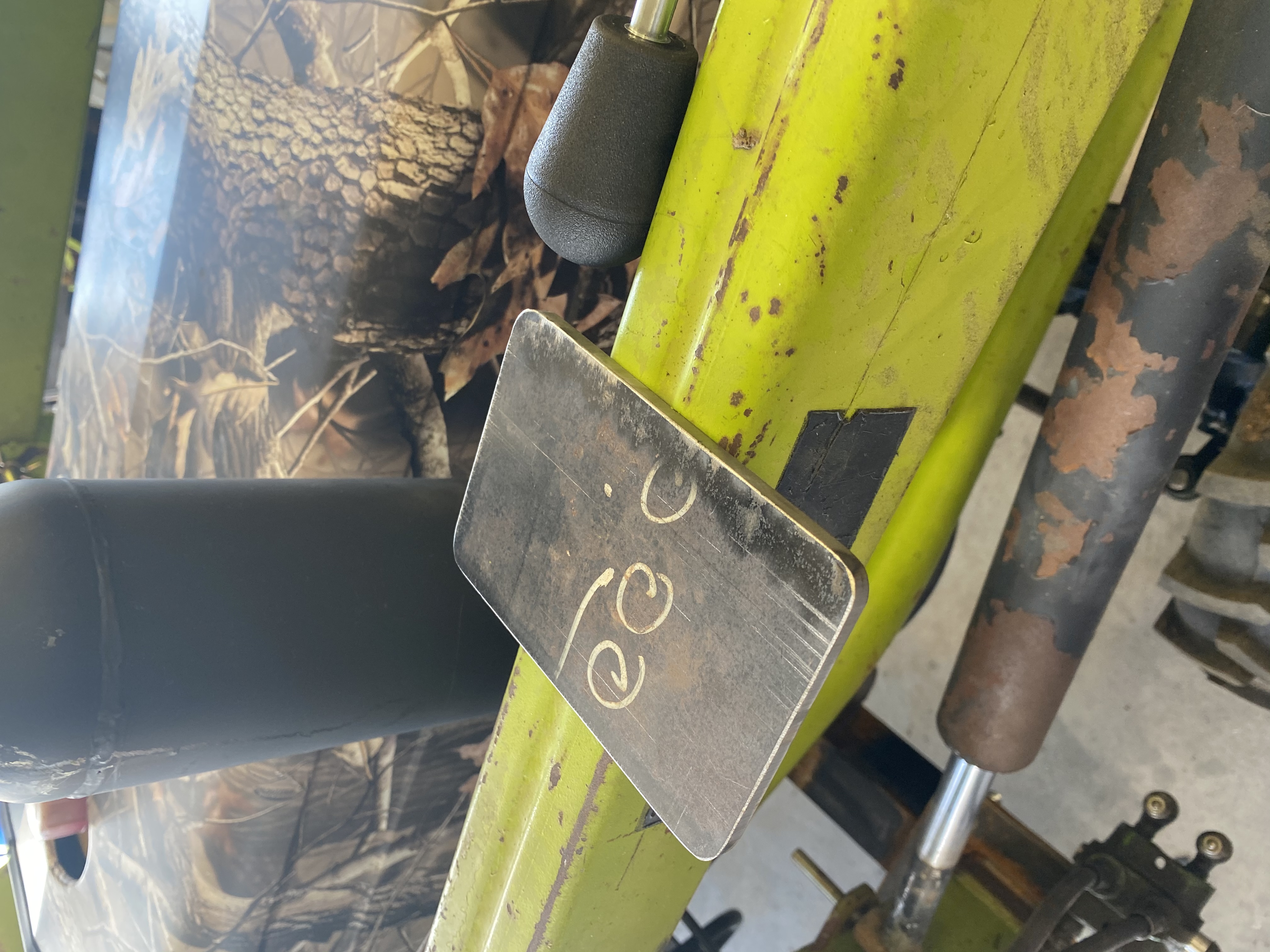

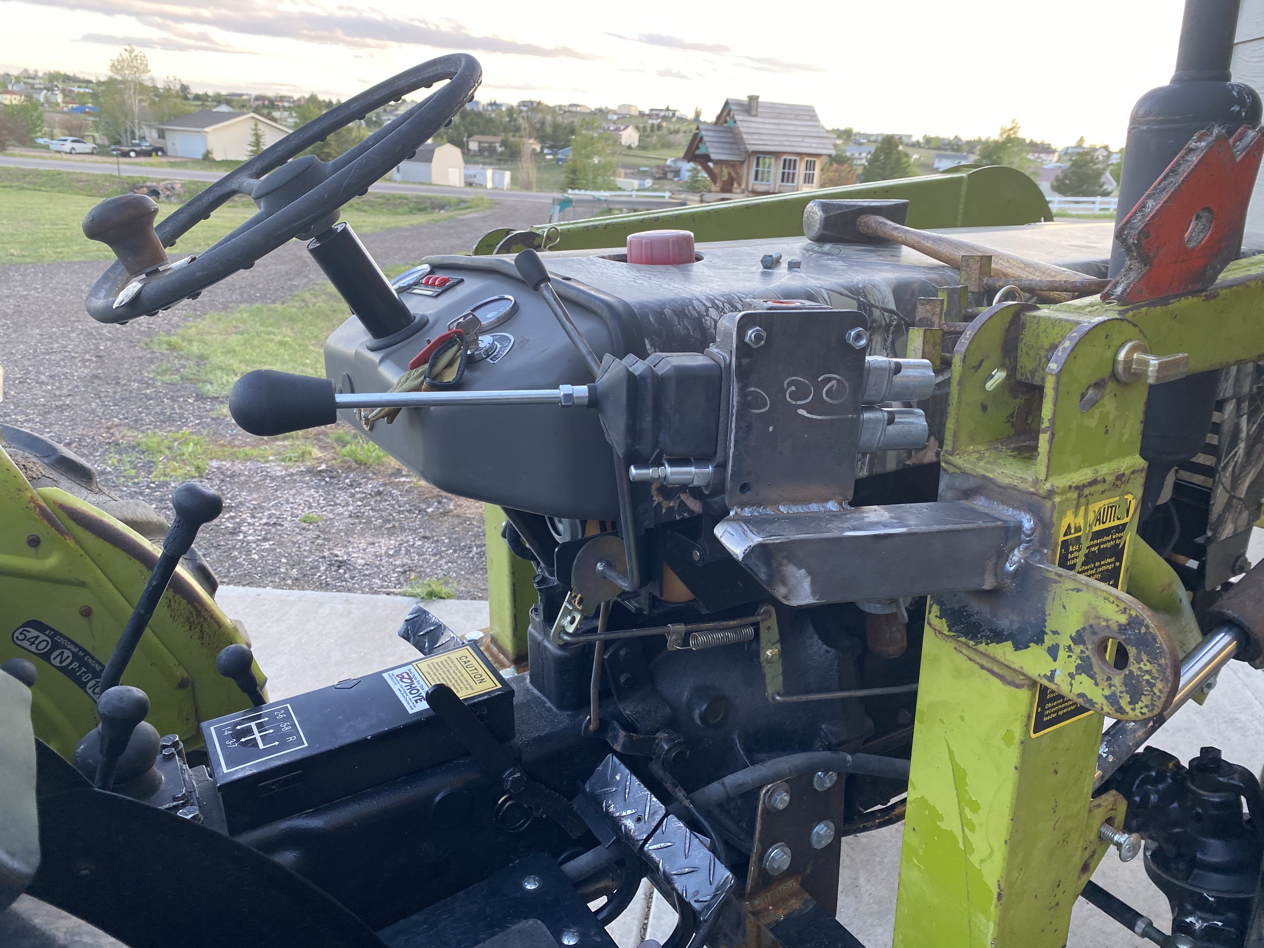

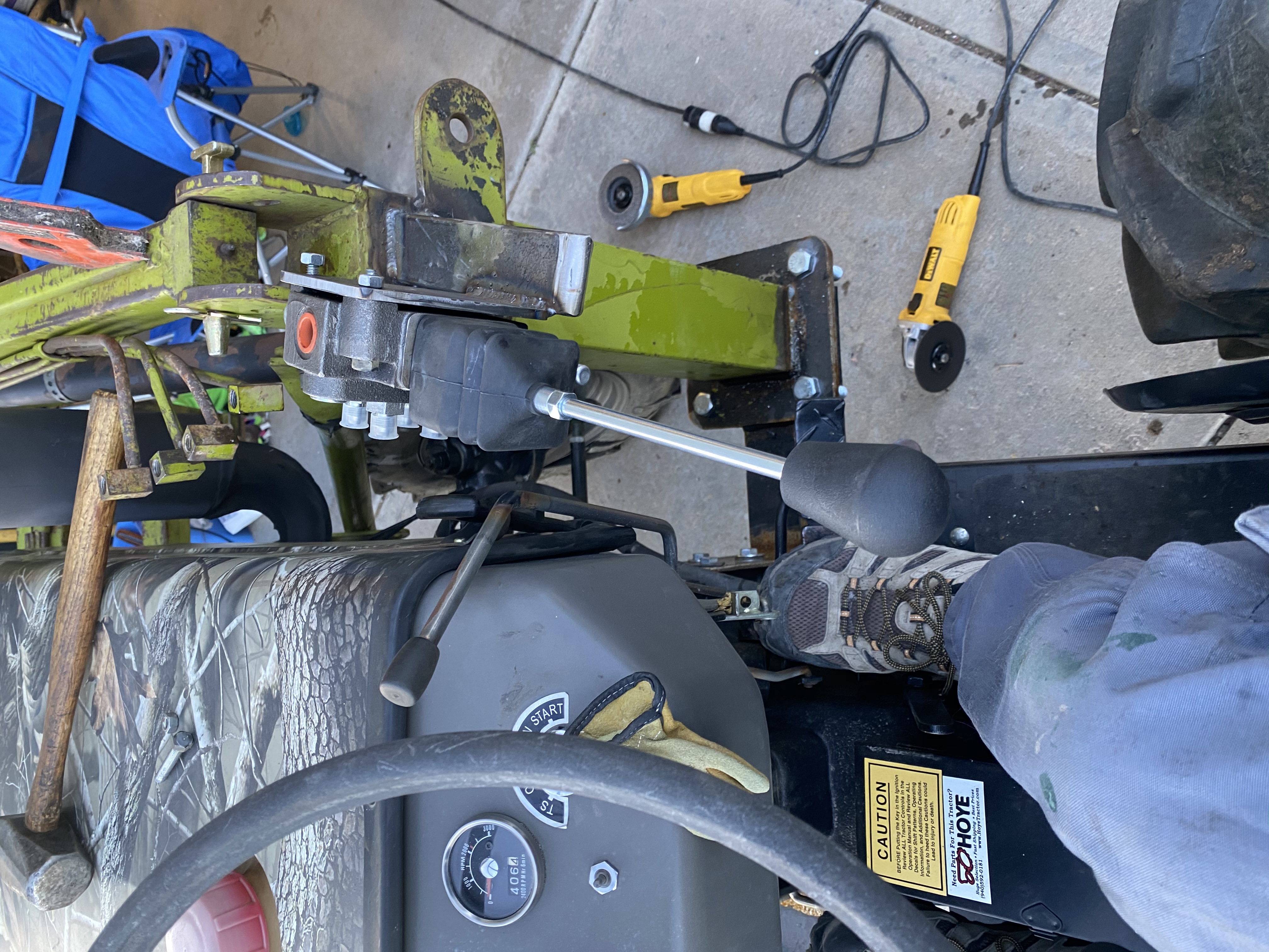

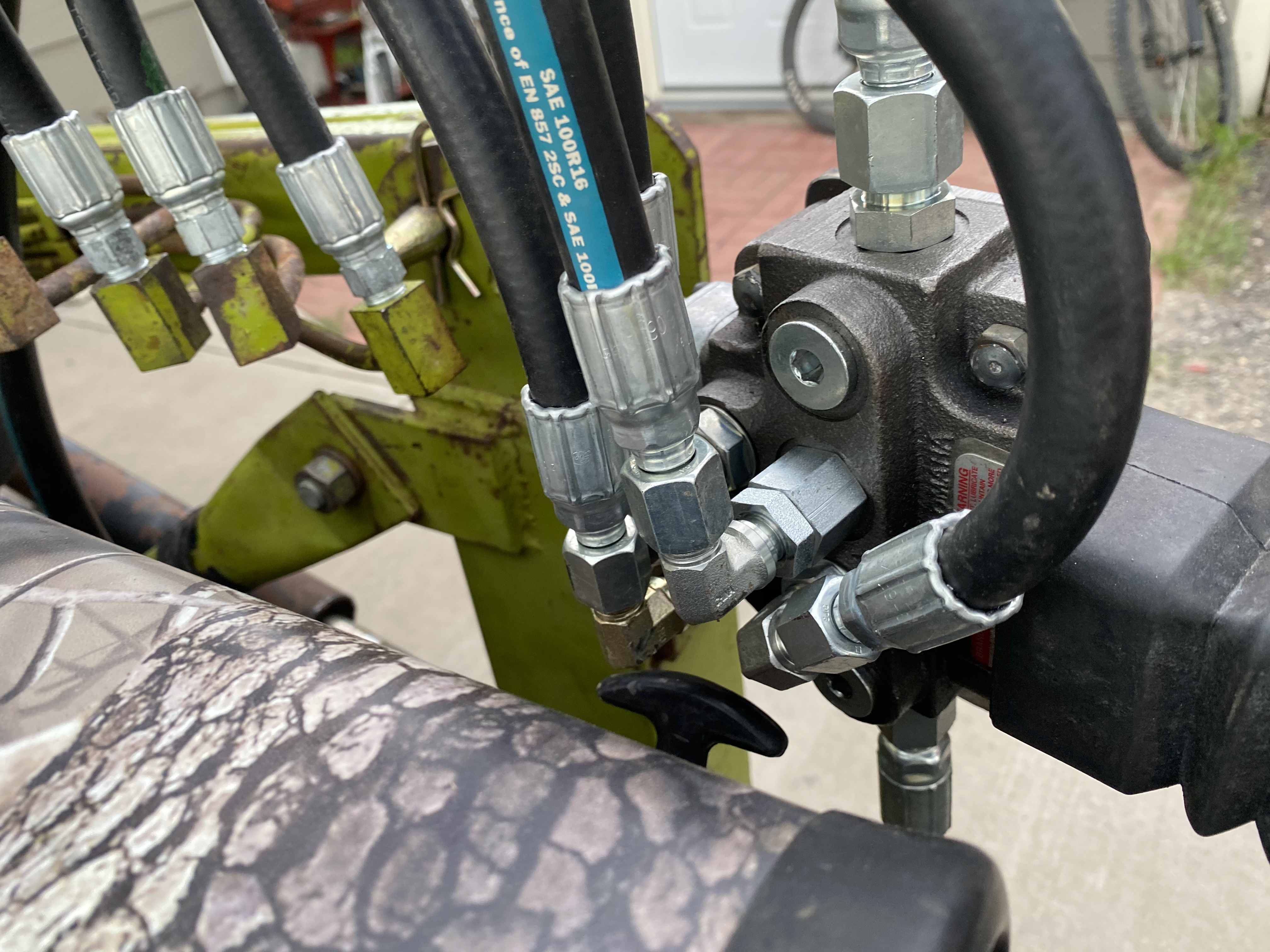

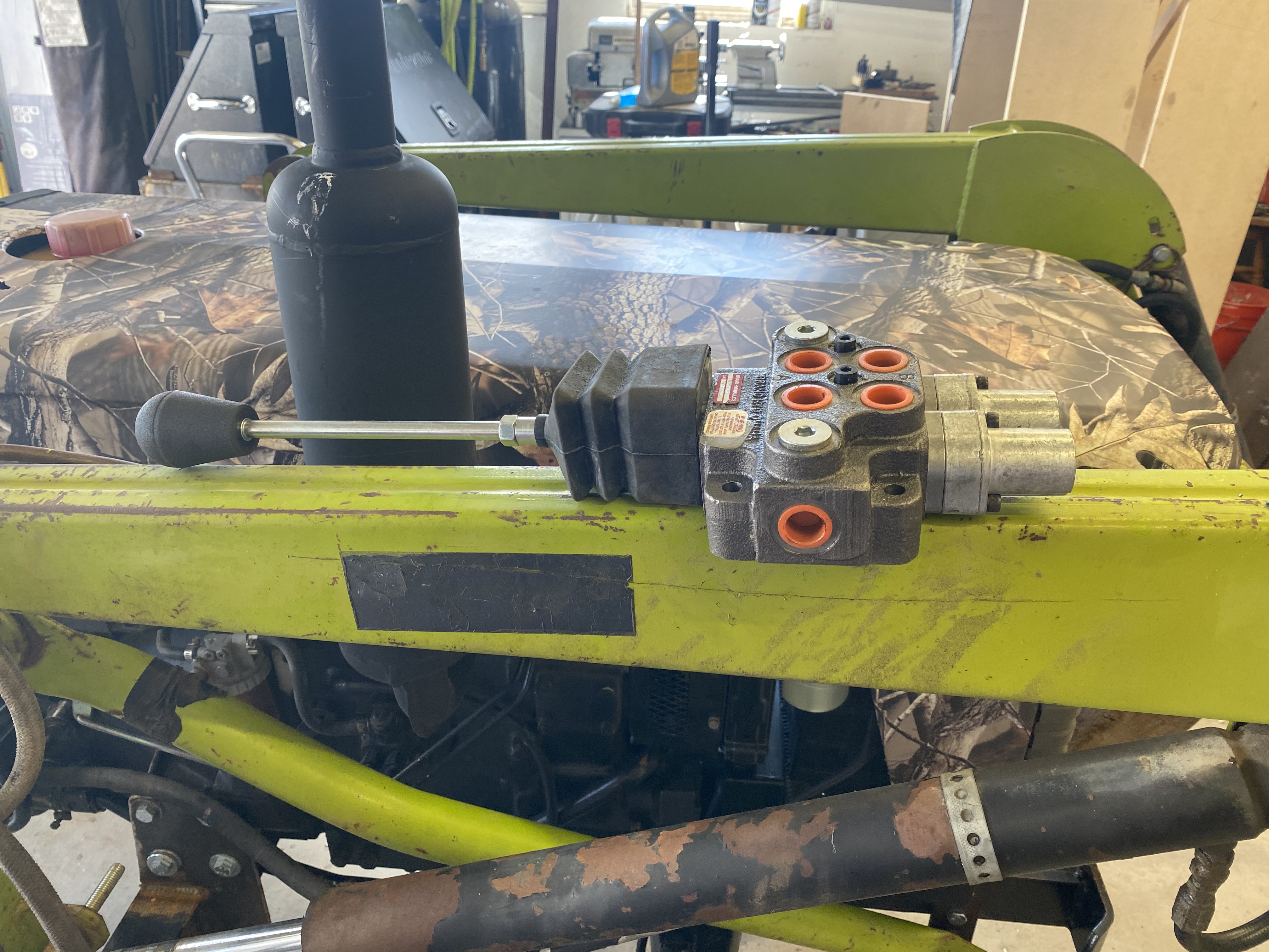

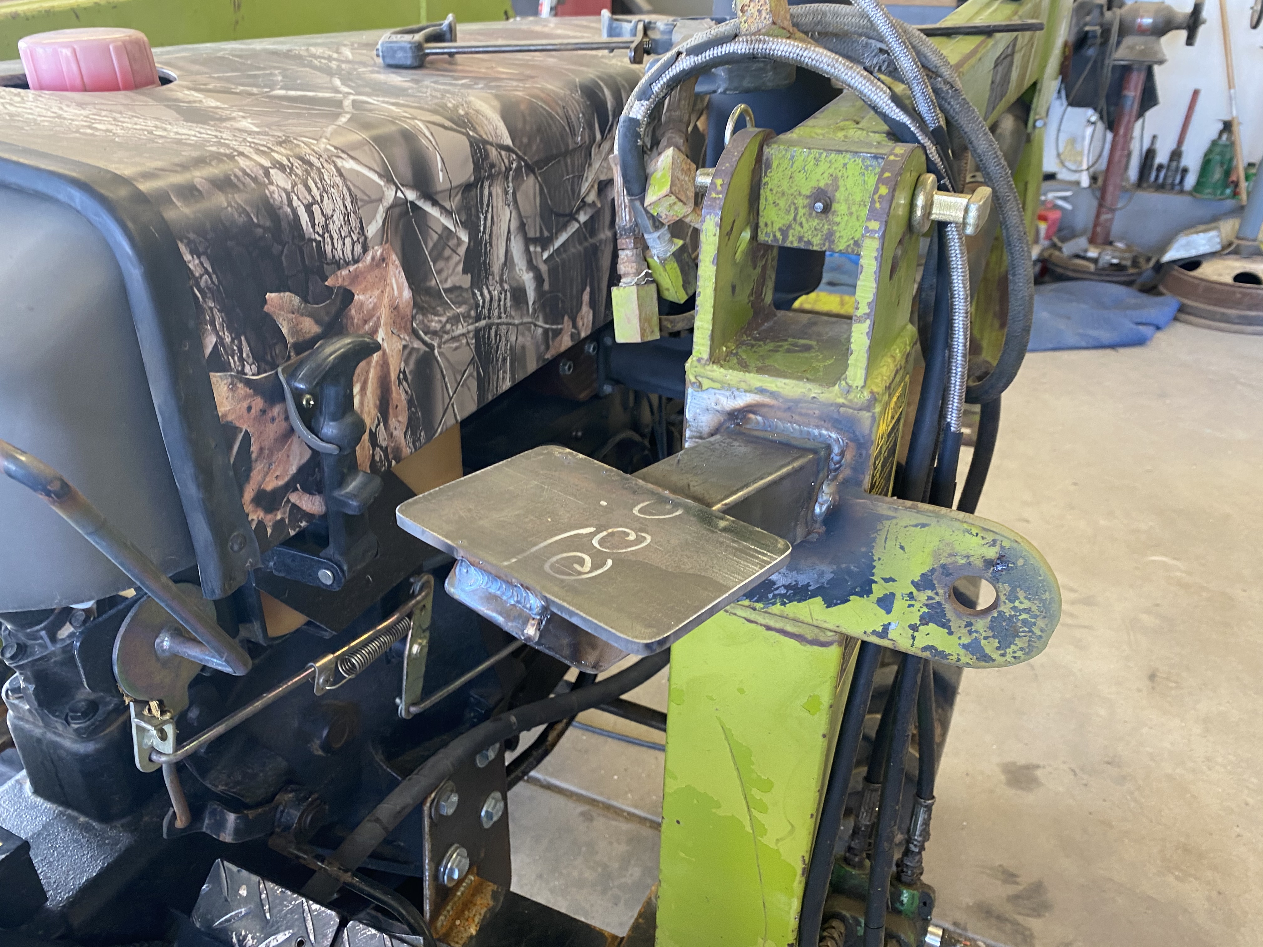

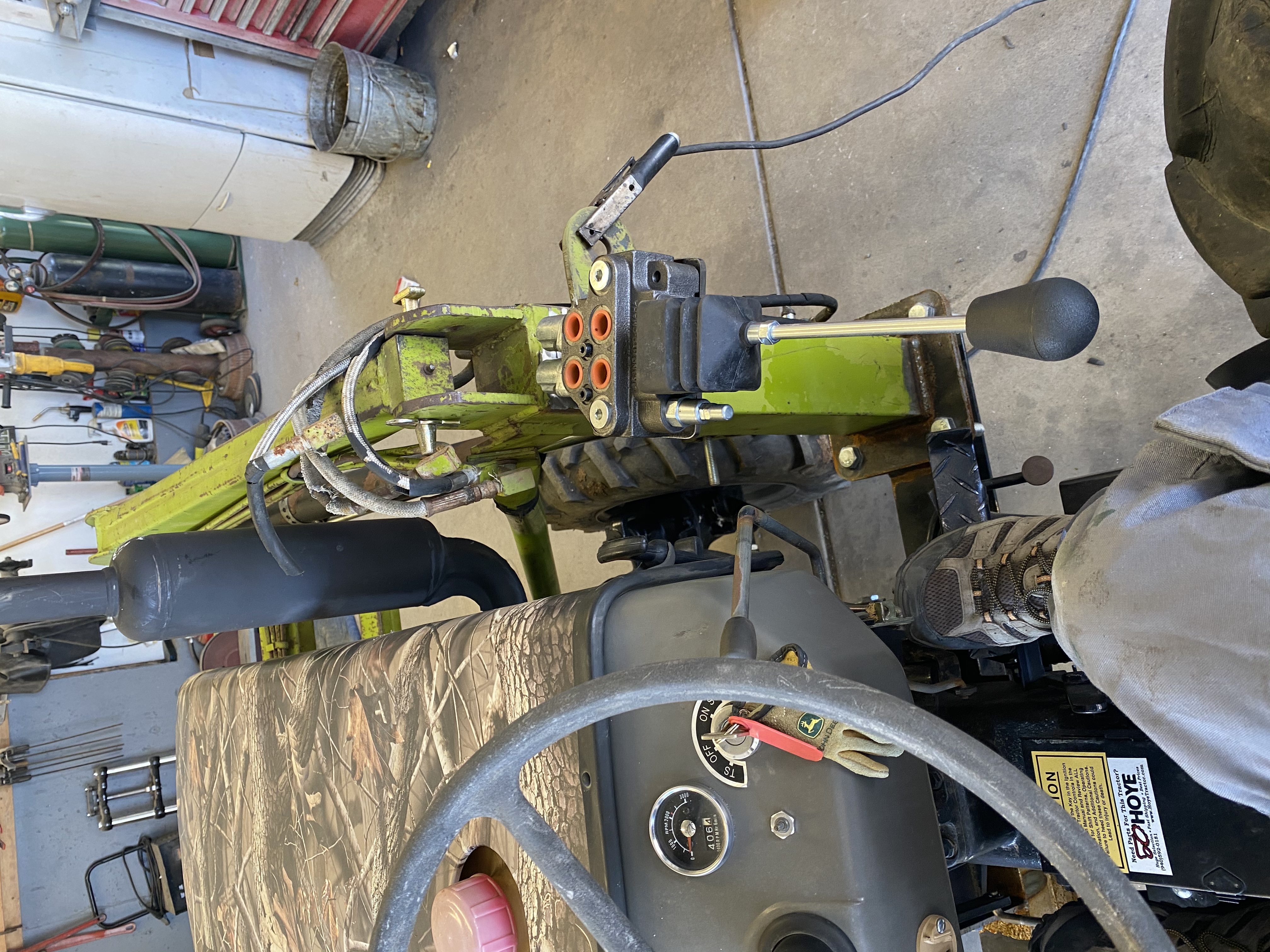

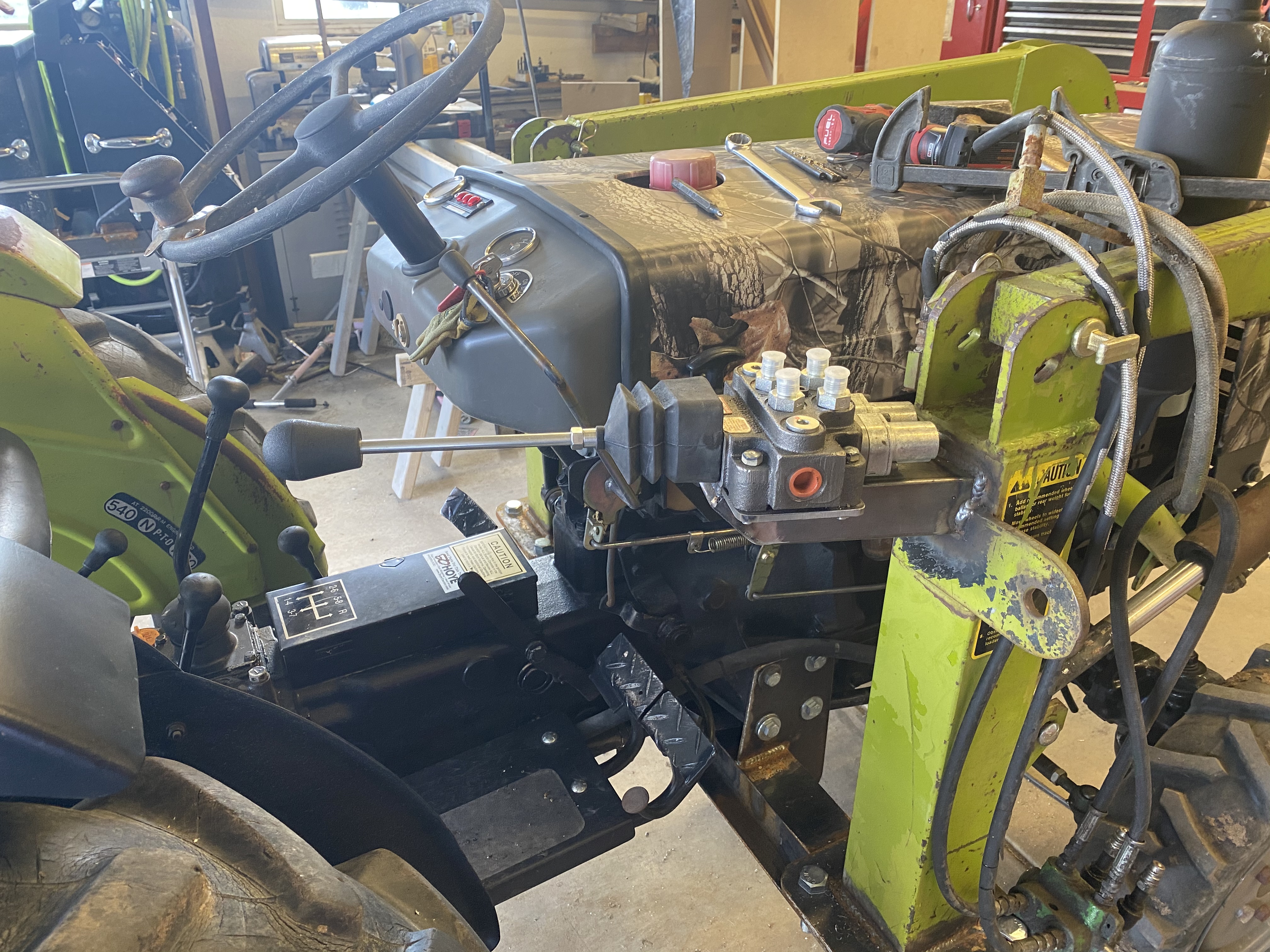

After awhile I got my loader valve from Hoye, and more importantly, a little time to mess around with it.
There was no clear position the original valve was installed on the tower, so I have the opportunity to place it where I feel most comfortable.
I eyeballed where I felt it should go, then made a plate to bolt it to. I just used some scrap 2 box tubing. I beveled the end of it just to make it look less home brewed.
The placement felt great. I had easy operation in all positions with my arm resting on the rear fender.

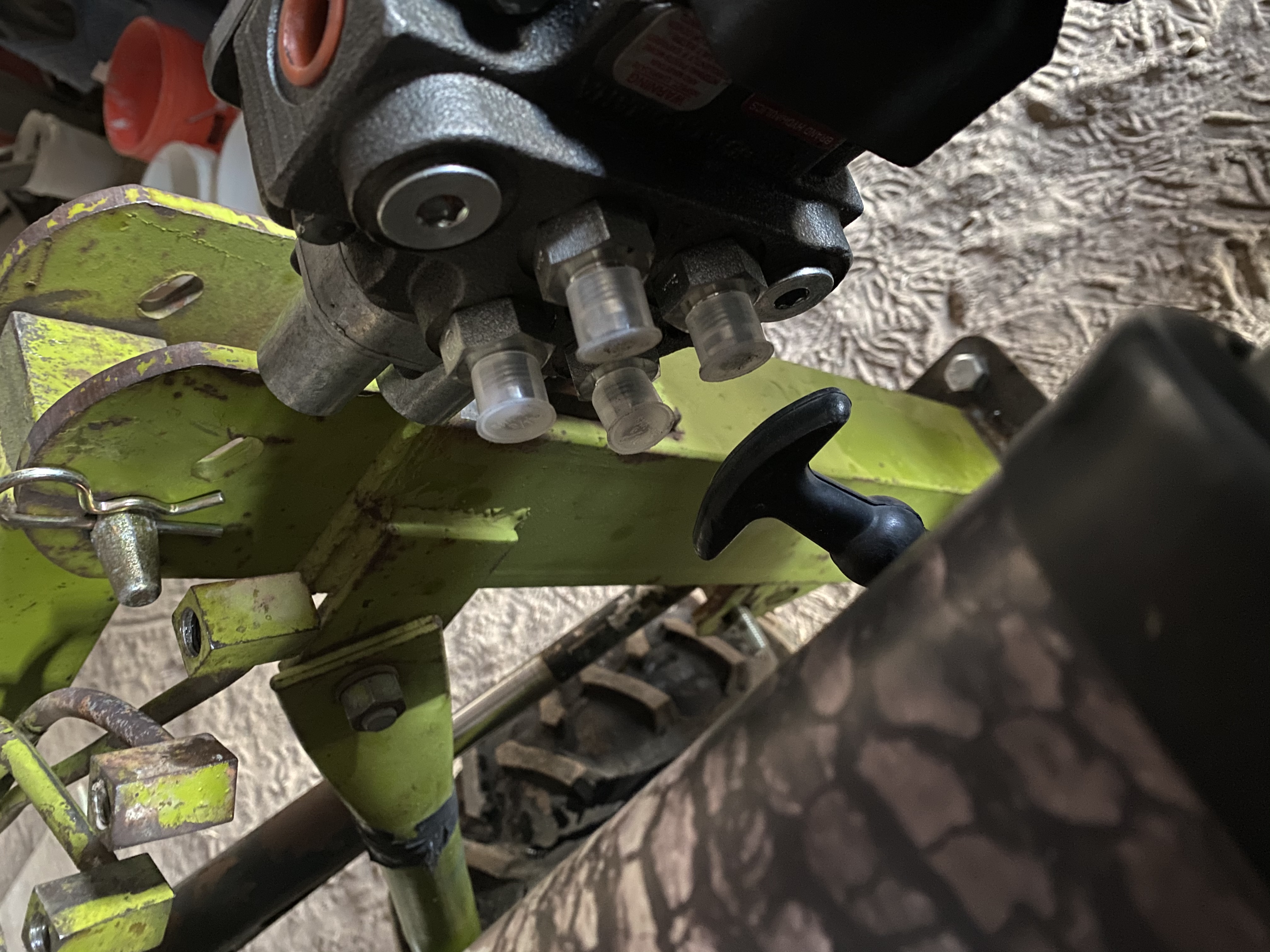

However, once installed and bolted down tight, I found the 吐loat function was in a weird place. Joystick far left would activate float.
Whoops.
I didn稚 feel this without the valve bolted down because there is a substantial detent that I couldn稚 get into without it locked down solid.
*****sigh****
I personally liked this position as it allowed the hydraulic lines to exit out the top making a nice east loop to the steel lines on the loader arm.
The way it痴 SUPPOSED to be forces the hydraulic lines to exit towards the engine.
Without completely starting over on the mounting arm, the only way I can remedy this is to get 90* adapters.
Looking on Hoye痴 website for the adapters I purchased, it states 菟ort from loader to -6 JIC? This isn稚 much help.
I知 guessing the proper term is 3/4 ORB to -6 jic elbow.
I知 learning hydraulics and all the nomenclature that goes along with it. Always frustrating when there are so many options.
Oh well.

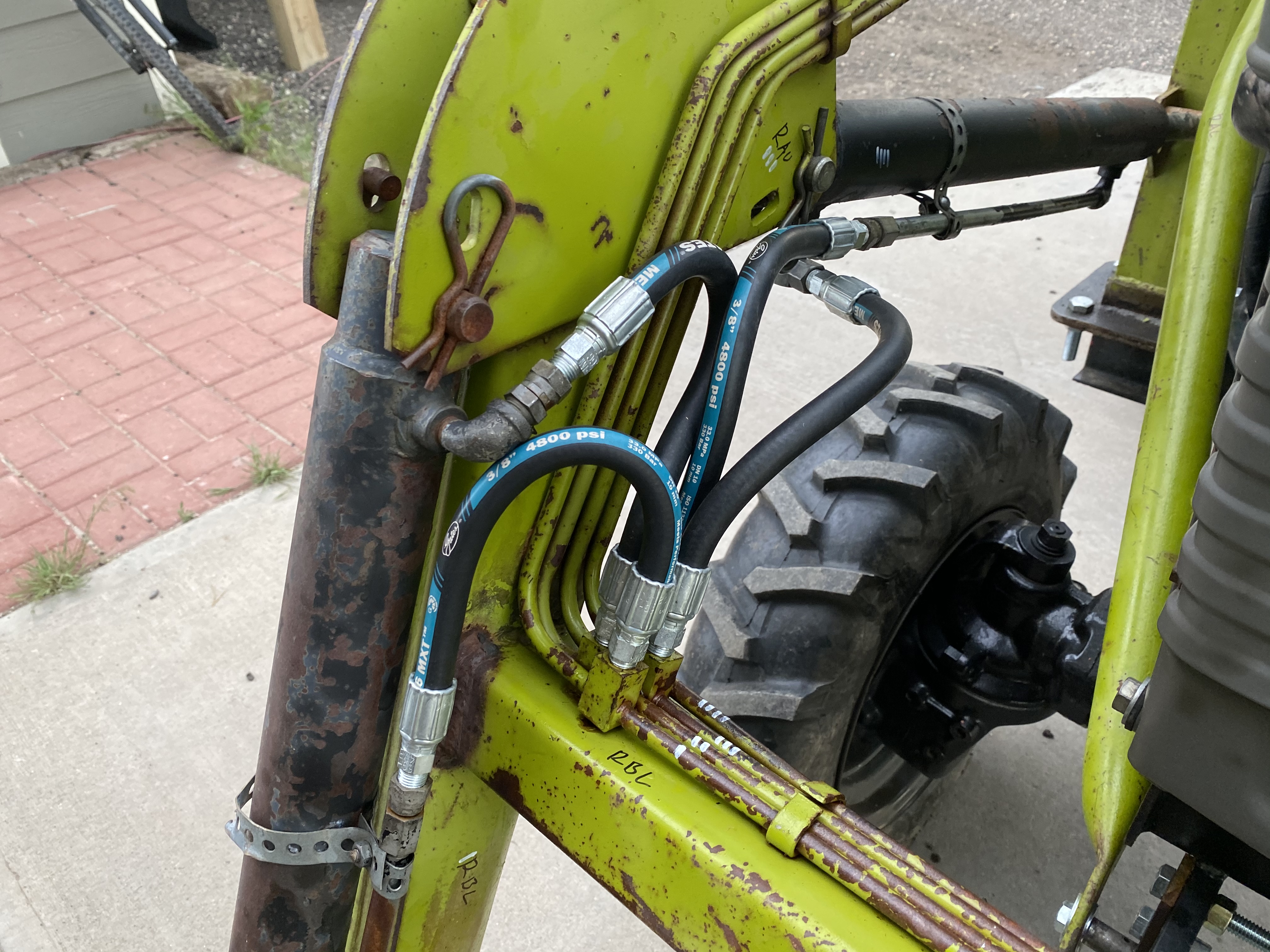

I also removed all the short hoses from steel lines to the cylinders so I can have them rebuilt.
I also want to have all the cylinders rebuilt. They all seem okay, no leaks and no rust or pitting but I壇 prefer to just have them in new shape.
Anyone have any idea what it typically cost to rebuild these cylinders?

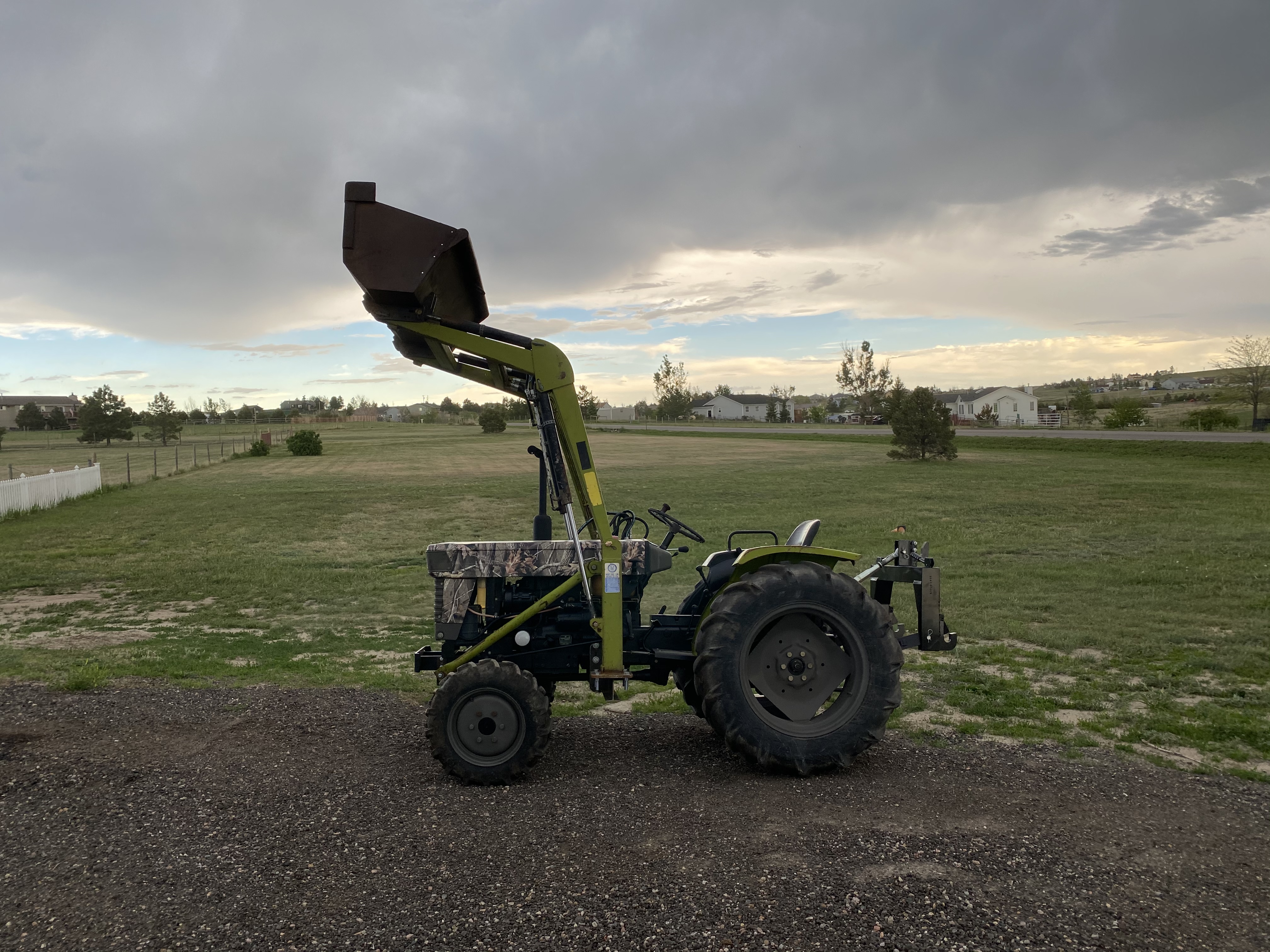

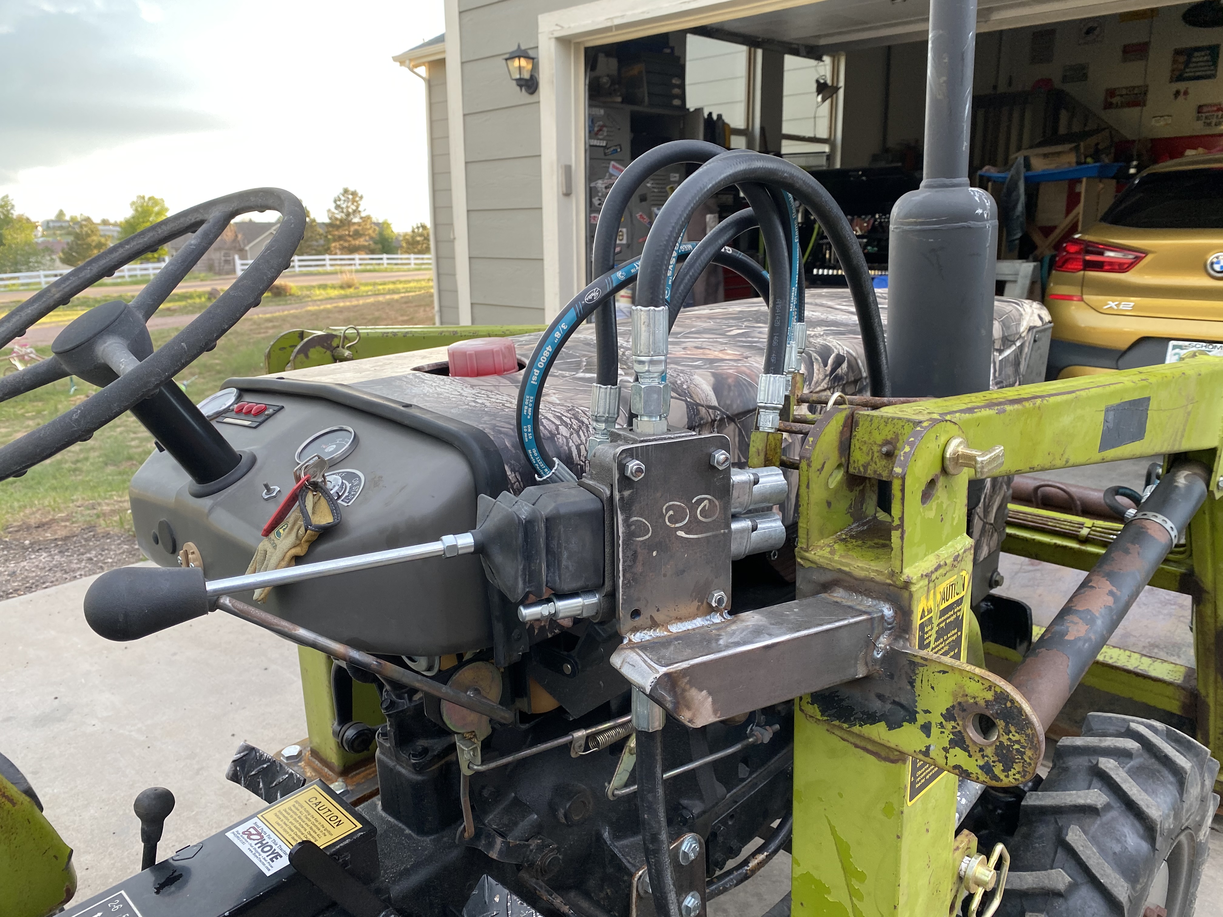

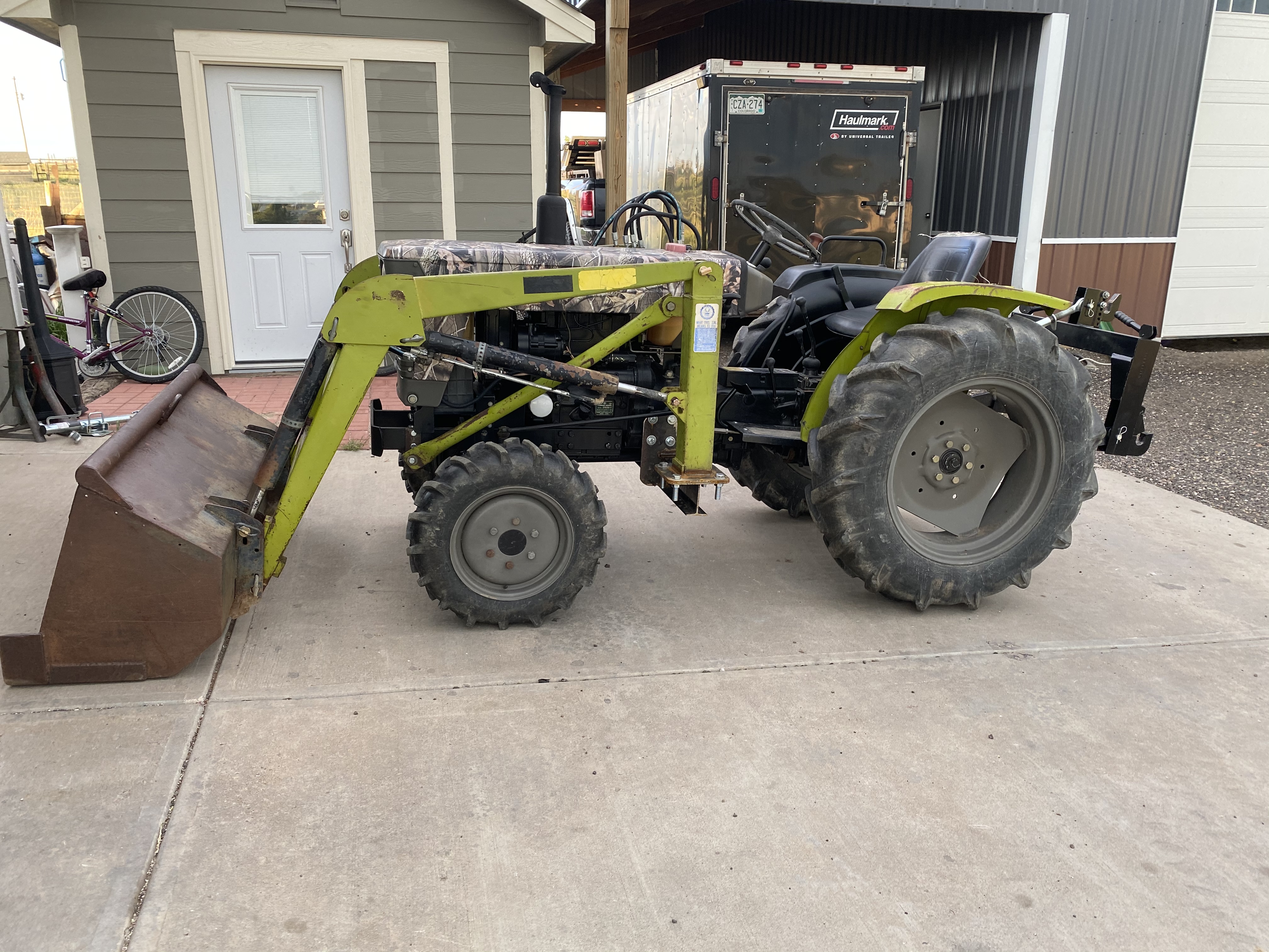

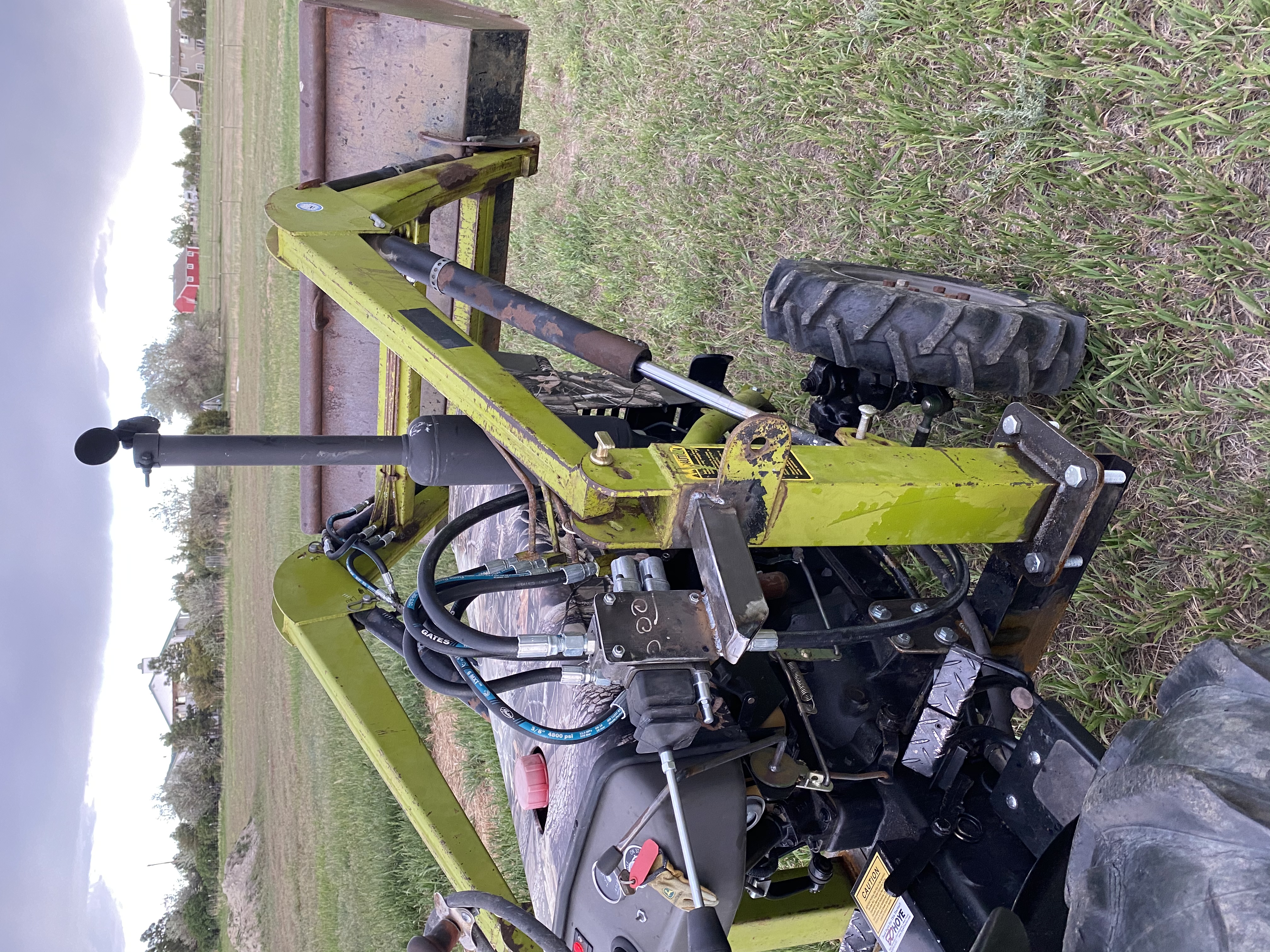

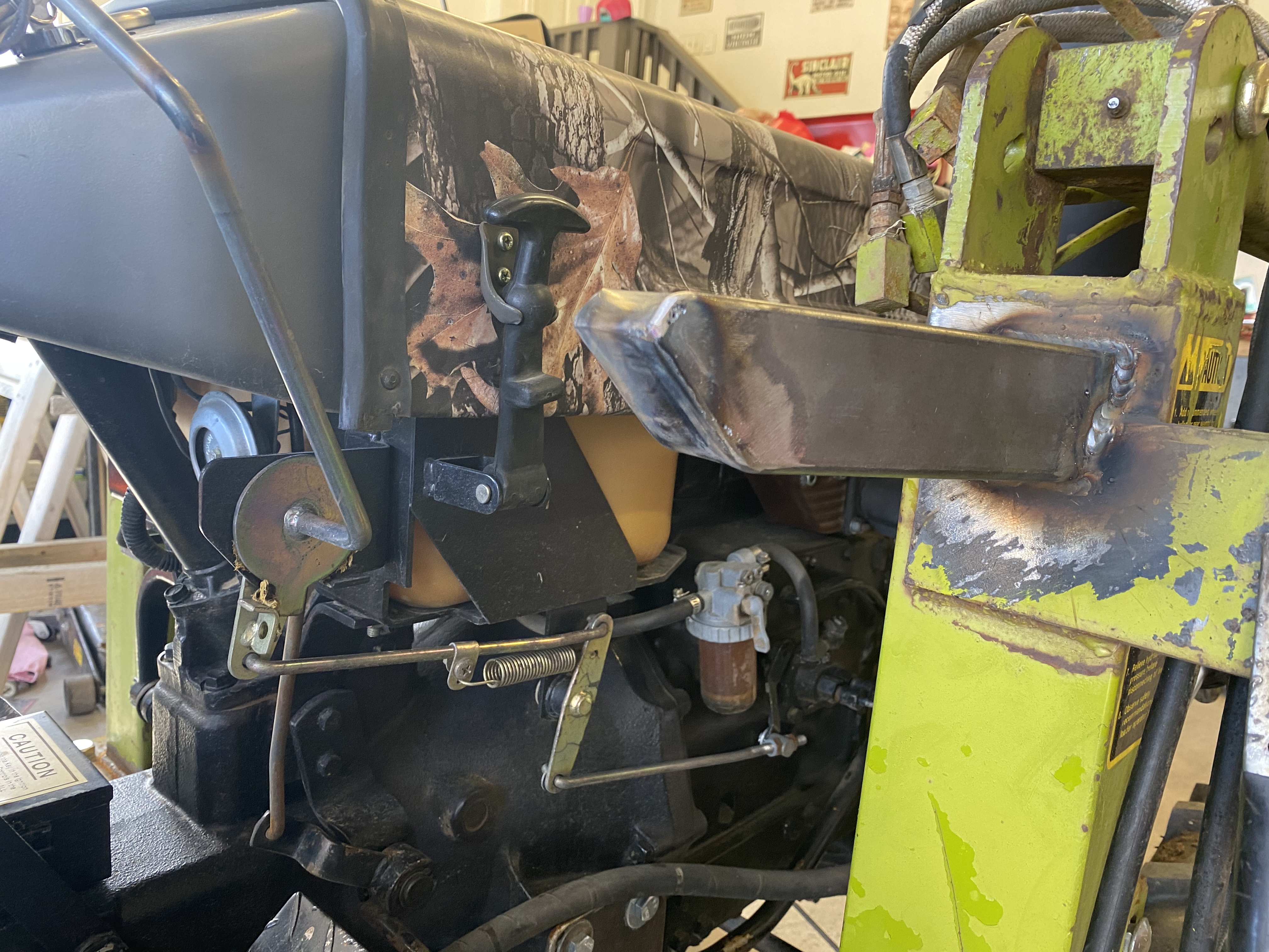

Welp, it痴 finally operational.
I still need to redo the front diagonal bracing to raise them up a bit. Right now the steering knuckle hits the brace at full lock.
And also need to fabricate the rear brace to the axle.

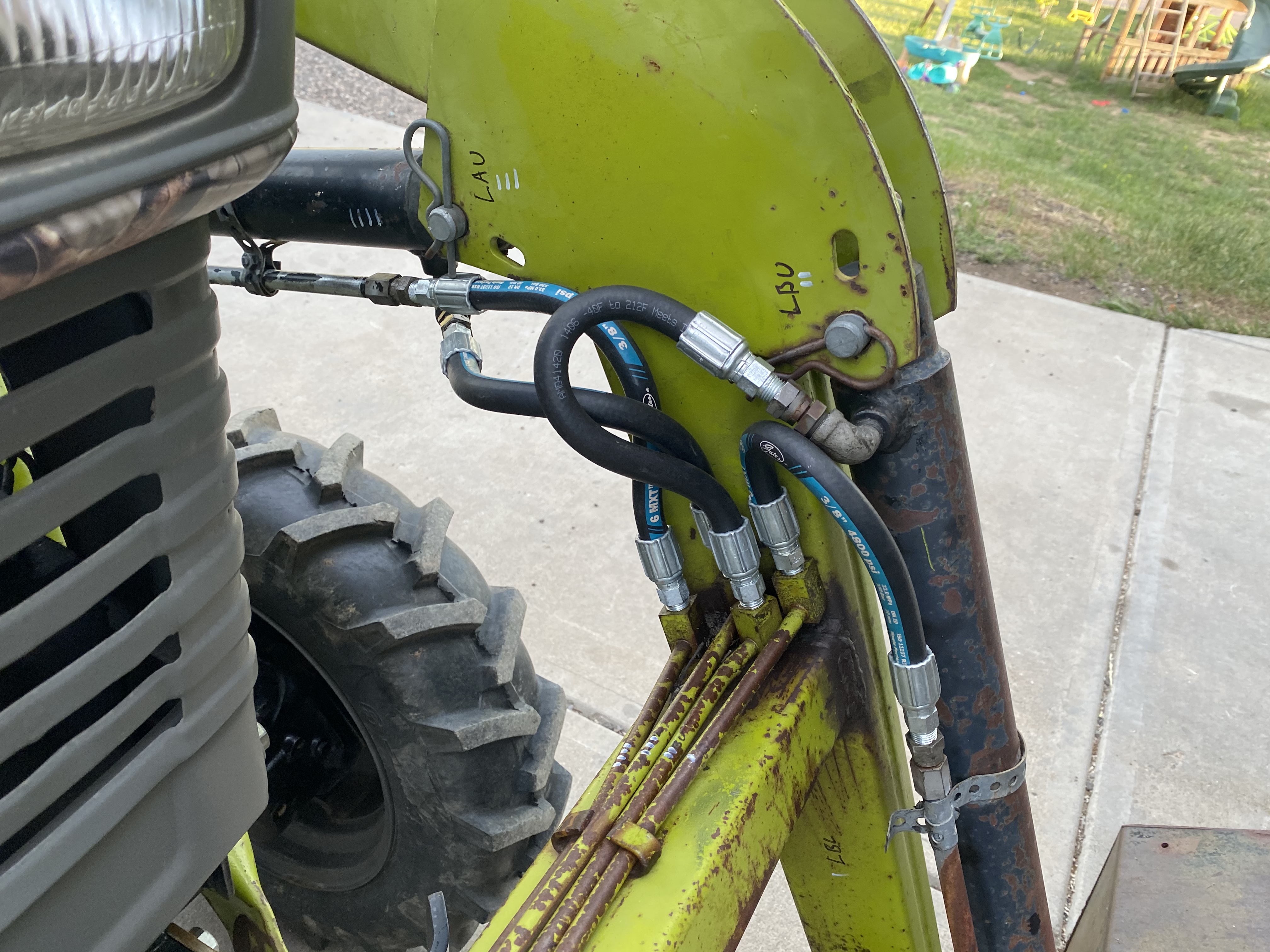

But on my way into work this week, I stopped by the hydraulic shop and had them build me all new hoses. Then a couple more trips to get adapters and fittings to get them all hooked up.
Man that痴 a chunk of change for 14 hoses.
Had to get creative on the elbows going into the valve because they pack them so tight together you can turn them without them hitting the ones next to it. *sigh
But tonight after picking up the last two adapters today and having the supply and return lines made, I hooked it all up, fired up the machine and wouldn稚 ya know it, it lifts and curls!
I couldn稚 be happier!
This is going to make work around the house and shop SOOOOO much easier.
It痴 certainly not fast. Maybe a higher flowing pump would remedy that?
Also need to build a bucket level gauge. I can稚 see the tip of the bucket to know when it痴 flat to the ground.
I知 used to skid steers where you can see the cutting edge of the buckets.
Considering I致e never worked with hydraulics before, I didn稚 have to remake any hoses (for not knowing the technical names and sizes of each fitting), AND nothing leaks!
I知 glad I decided to tear this all apart. Every single fitting had Teflon thread tape on them :(
Got all that cleared out.
I also figured I would run these cylinders for a bit to see if they actually need rebuilt.
At this point, it doesn稚 appear they do. No leaks from them either so I値l just roll with them.
If I don稚 include the cost of the tractor, only the cost of the loader, I知 about $800 all in with the loader, all new hoses, new valve and using scrap out of my pile to hook it up.
I can稚 complain much about that for the use it値l see.
