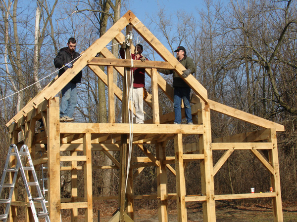

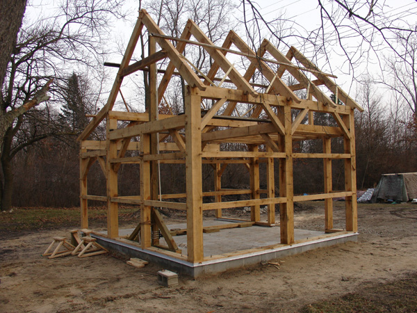

Saturday was a beautiful day. The fog burned off by 11 and by two it was shirt sleeves and sunshine. Started by 7:30 laying out rafter tail cuts. Then I used the old rule: Measure 10, cut once , start the saw put it back down and measure again. Its a little nerving cause you can't just run to the lumber yard and get a new 4x8 white oak rafter.
Help arrived by 11:00 and then we hoisted the 3 three middle rafters peice at a time and the assembled on the loft and raised. These were quite simple and it didn't take much time. Then it was time for front and rear. These were assembled on the ground and then hoisted. The front one was a bear because of the loft door framing and my rafters are taller than my gin pole can lift. The pic shows it being set.
I am very pleased with the overall height. I have 7'4" from the loft floor to the inside of the peak. When you are 6'4" you come to appreciate these things. Everyone was teasing me all day as they went up, asking where the cross went as it looked more like a church than a barn.

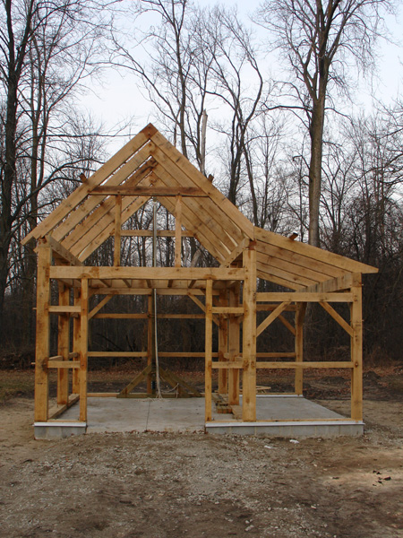

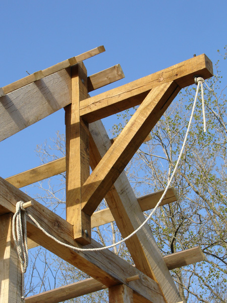

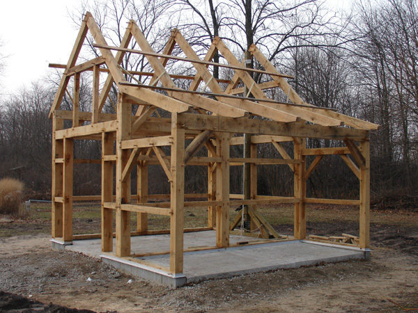

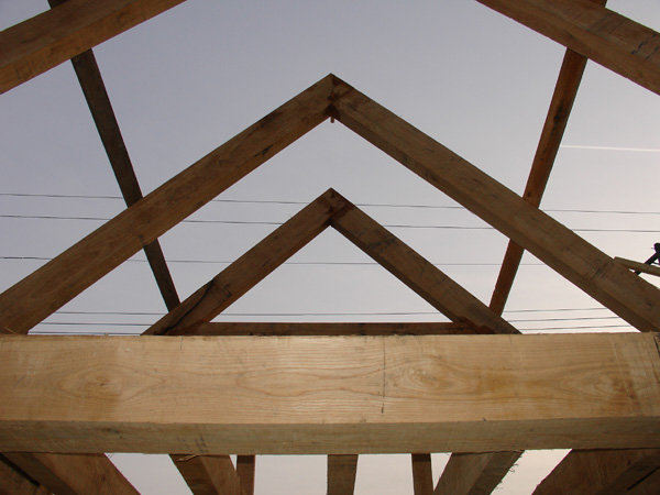

Got all the main rafters up. The next logical step was to anchor them to the plates but since I had help and nice weather I thought it would be better to get the lean-to rafters up as there was only enough daylight left to do one or the other. The lean-to rafters all had to be layed out in place and be cut and notched so it was put 'em up mark them, bring them down, cut and set.
So now I have all the frame up. I suppose the heavy stuff is done. Anyone need a good used gin pole? Hate to see it go to waste but were do you store something like that? Now I need to anchor the rafters to the plates and get the purlins on then it's on to finishing.

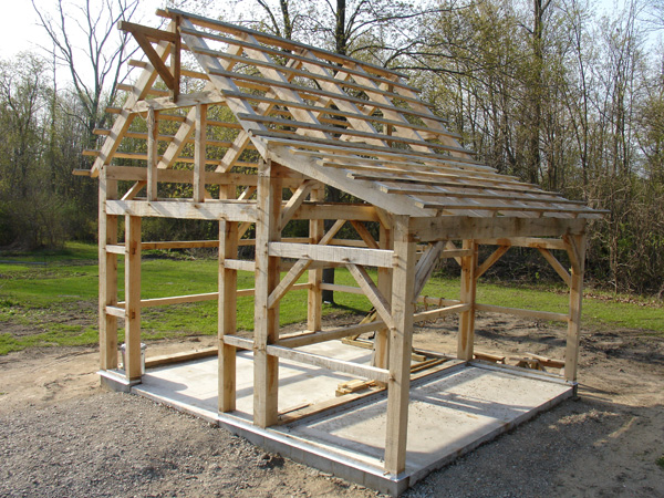

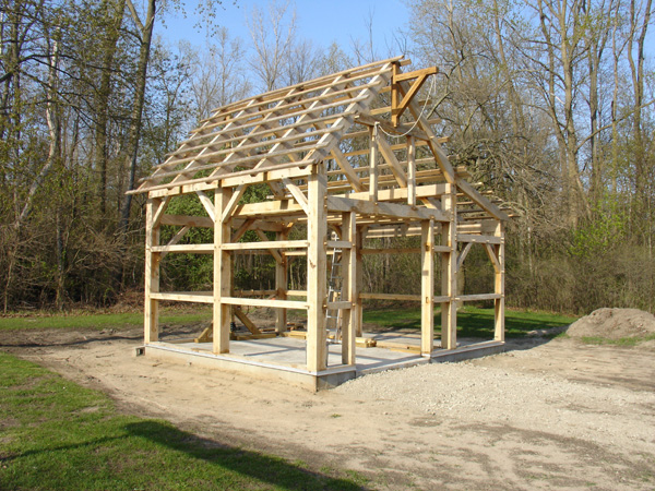

Pic one is looking up on to the loft from inside. Pic 2 is the lean-to side, 3 - rear and 4 front.

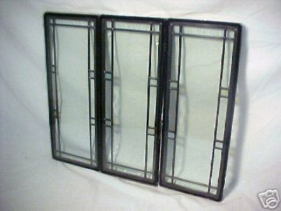

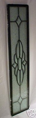

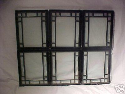

I bought my windows. I found leaded glass panels for them all. I went with clear glass and I was able to find matching windows. These are new but are sandwinched between two layers of safety glass and sealed so I will be happy with the life of them. The doors will have a row of windows across the top (transom style) and I found ones that are almost deadnuts on to size that I had designed. These are the same as the side windows. Since all the windows will be fixed, building the frames will be simple. Pic 1 shows the side wall windows. They will be mounted horizontal. Pic 2 shows the main door windows. I will be building 8' x 6.5' double swinging doors and each will have a row of 3 windows. Pic 3 shows the loft door windows. The pic shows six windows, the door will only a have one row of 3.

I've been putting purlins on for a wile. Got four up on the prevailing side back in late December just to hold things up. Last weekend and today I finally got all the rafters set. The lean-to rafters took quite a wile to do as the each had to be lagged at the header and pegged at the transition. Each one took about an hour. I broke the head off the screw the holds my chuck on my cordless drill while I had an 18"L 1" in. auger bit buried in a rafter now I have to find a one. Finished that up and set the rest of the purlins. Now I have to go through and cut off about 10 bent nails that didn't drive. Once you hit the oak if anything stops the nail it will bend instantly and there's no getting it out.
Hopefully next weekend I'll be able to cut and install the fly rafters and box in the soffits. If I get that done then I'll be able to start setting the tin.
Here's two pics. as it looks tonight.
