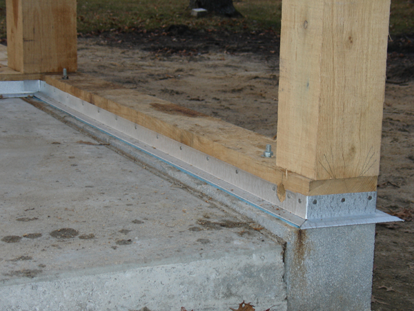

Well, it was another full day on the barn, out at day break finishing up some undone work.
Started by pulling the lean-to sills so I gould drive the last 2 pegs. Then reset them and finsished up the the tin. The lean-to sills are wrapped as they will only be semi-protected. This is all exposed and will be seen.
Kevin

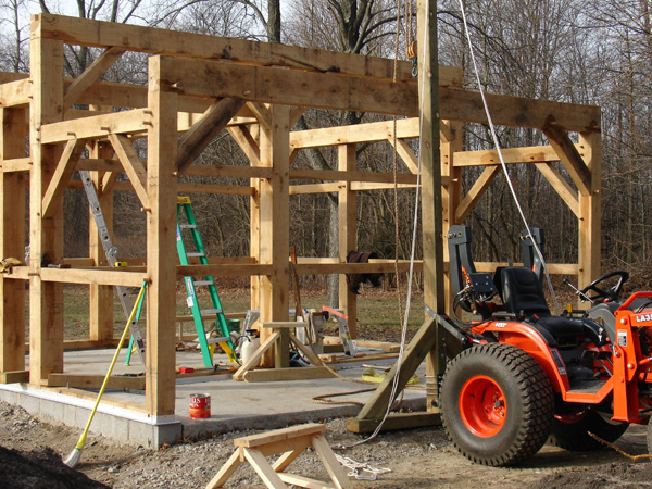

Then it was on to raising the lean-to. This was lighter work to start but a little more time consuming as it had to be put together while standing.
Pic1 shows the end wall up and the plate being readied for lift. Pic 2 shows the plate in place. This was lifted with only two people. Me hoisting and the other back and forth on ladders positioning. It took everything I had to do it. Just carring the timber on the FEL almost tipped the tractor and two carrying from fell to horses the comment was made it was like carrying a tree.
Kevin

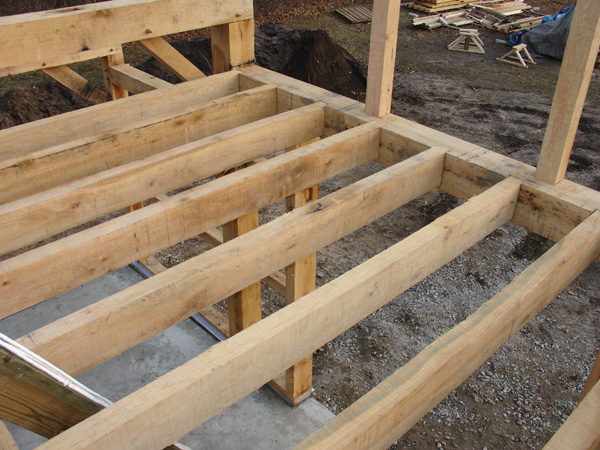

#47
Figured the loft joists would be the next logical choice as it will give a good platform for raising and setting the rafters. After hoisting the lean-to plate neither of us had much left so this was a chore. The joists probably came in at 75 lbs each and since there is no electricty at the barn they had to be carried to the garage have the ends squared and cut to length, then carried back and walked up a ladder and driven home.
Pic one shows the joists started. Pic 2 and 3 shows em all in and a view from above. The two uprights you see on top of the plate are the loft door framing as I was trying to get a sense of overall hieght.
Kevin

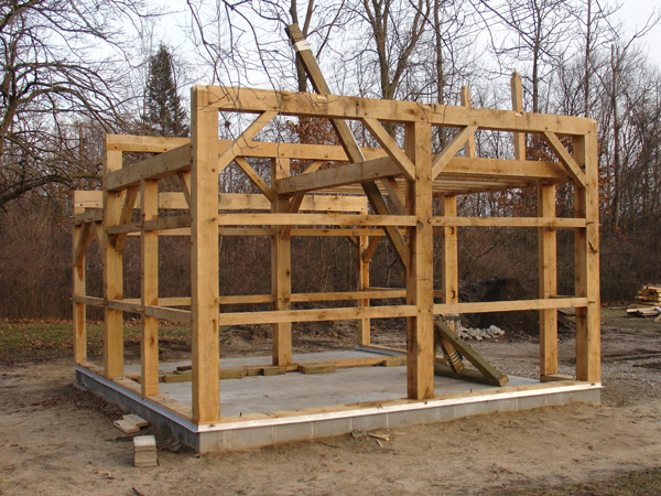

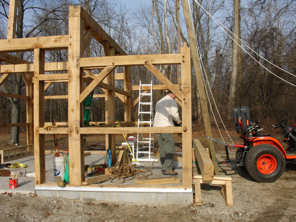

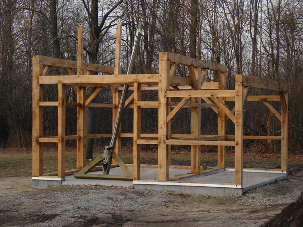

#48
Here are some shots of how it looks tonight. Supposed to be 54 tomorrow but a chance of rain so I might take the day off and let the knees rest.
Kevin
