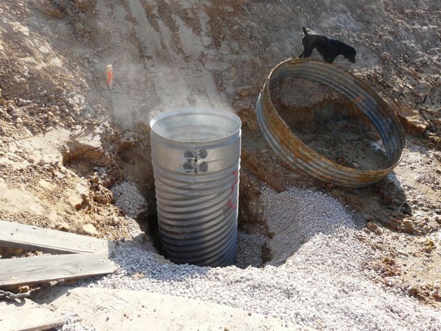

The dog is a stray that wondered on our place last year and has not left. The DNA test show she is part:
Cocker Spaniel
German Shorthaired Pointer
Greyhound
Poodle
Bichon Frise
Great Dane
She like to bark at snakes and has an awesome coyote howl, (bilingual).
We thought she was a Whippet and name her Whipper (Whip for short).

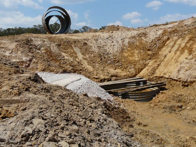

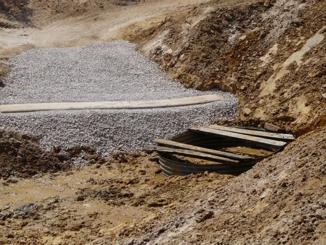

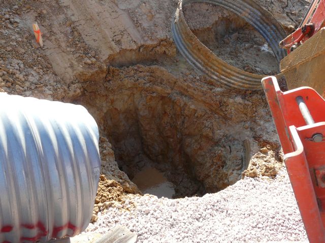

An unwelcome surprise this morning, apparently when I cut the BH access ramp I uncovered 2 more springs. I removed the mud and quickly put down 6 FELs of rock and compacted it. I also made the ramp less steep.
With the culverts nearby the site is ready. But with the temp at 104, I'm taking the rest of the day off. (I still ned to put on the BH.)
It is starting to get exciting, the race will be to put in the culverts and rock before the sides cave in. If successful water should be flowing over the top culvert into the pond.
