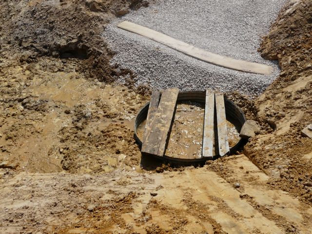

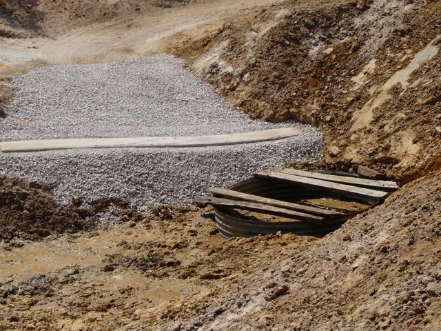

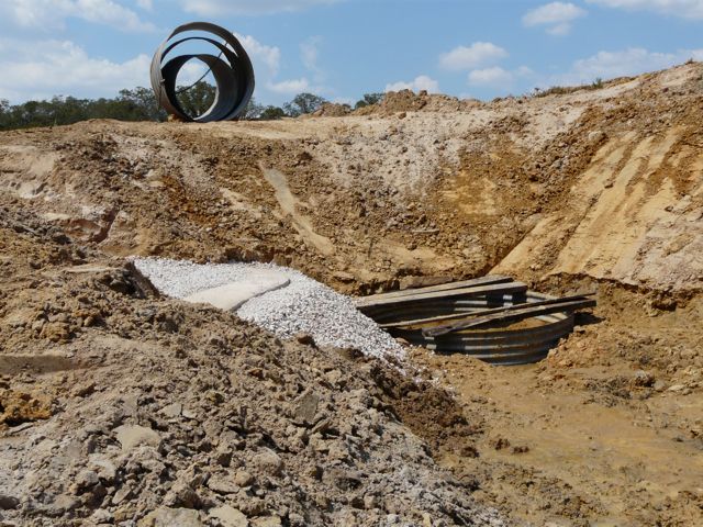

An unwelcome surprise this morning, apparently when I cut the BH access ramp I uncovered 2 more springs. I removed the mud and quickly put down 6 FELs of rock and compacted it. I also made the ramp less steep.
With the culverts nearby the site is ready. But with the temp at 104, I'm taking the rest of the day off. (I still ned to put on the BH.)
It is starting to get exciting, the race will be to put in the culverts and rock before the sides cave in. If successful water should be flowing over the top culvert into the pond.
Don,
One of those " something goes haywire things" I didn't mentioned. I think the gravel will give you a much better base for the tractor when you use the hoe.
You can probably use some of the ramp gravel in your culverts when you get to that point. It sounds like that hill has been holding a lot of water. I was concerned that when you said the water seepage was slowing down that you might have just hit a pocket and it would dry up in time. You never know about water until a year or so from now.
Good perspective on the pictures.

I'm starting to second guess myself on the culverts. Would one 3' diameter by 6' long be better than 2 to get the 6' length vertically of different diameter. I saw the 3'X6' in town the other day. ??

That middle photo really shows the slopes well. What were you planning to use the rock for?.........before the bubbling H2O came up?

I didn't see where the water went in your last set of pic's??? Is it flowing under the rock???
Don,
It depends on the cubic feet of volume you want to retain in the vessel.
1- 4' dia culvert 3' high with a 3' dia culvert 3' high stacked even to give 6 ft total would hold about 38 cu ft of volume.
I-3' diameter culvert 6' long would only hold 28 cu'
So you would have 75 gallon more in the 2 pieces.
Brandi is right about 1 less piece to install. I'm not sure why alignment would be critical in what you are doing though.
Getting one 6 foot long piece level when you fill around it might be harder than with short pieces stacked. The final height and volume capacity will depend on the vessel being level.
I'd dream about how I would have to stake the culvert in place to keep it level while back filling and the teeter factor of 6' vs. 3', etc. etc.
Of course I always think I'm building stuff to last forever. ha.

The rock is left over from my driveway paver project. I used it as the base and compacted it and then put sand on top of it, leveled/sloped it then tapped in/set the pavers and then used polymer sand to bind it all together. Well, the first 500, I still have 12,000 to lay after I finish the last 160' of curbing.
Kyle the water is flowing from all sides, I can't really pinpoint a specific spot. Is this how a spring flows?
It seems like the clay has fingers of sand running through it in it and the water is following through the sand fingers, straw size.
