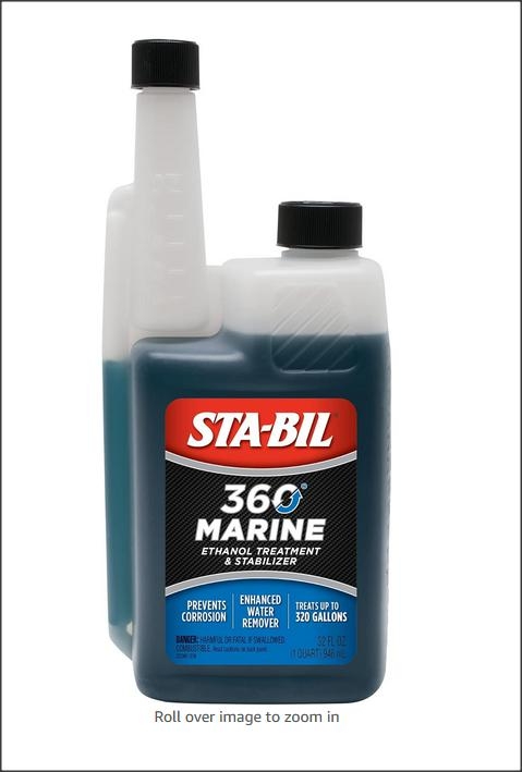

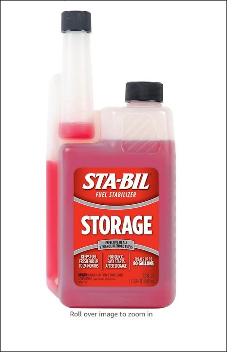

Two kinds of Sta-Bil gasoline additives I have used:
Ever since it became available I have been using the marine 360 with ethanol gasoline in small carburetor 2 & 4-stroke engines, and have had zero fuel related carburetor problems.
I always add it at the station when buying the gas.
Cheers
