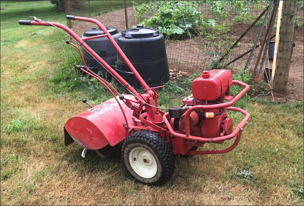

Here is a prime example, my 1976 TroyBilt Horse which almost always starts on the first pull after sitting 6 months or months in the barn.
PS. The gas tank has a fuel shutoff valve.

I've got a 45 YO Sears front tine walk behind tiller. It has a 8 HP BS engine with the gas shut off above the glass bowl. I use it less and less as I get older...........But.......when I do use it I just drain residual gasoline, remove and clean the glass bowl, add fresh gas.......and .... it starts right up year after year......even though it is stored outdoors with a big wash tub hainging upside down over the engine. I've been using ethanol free gasoline with red Stabil for years.
Cheers.
Mike

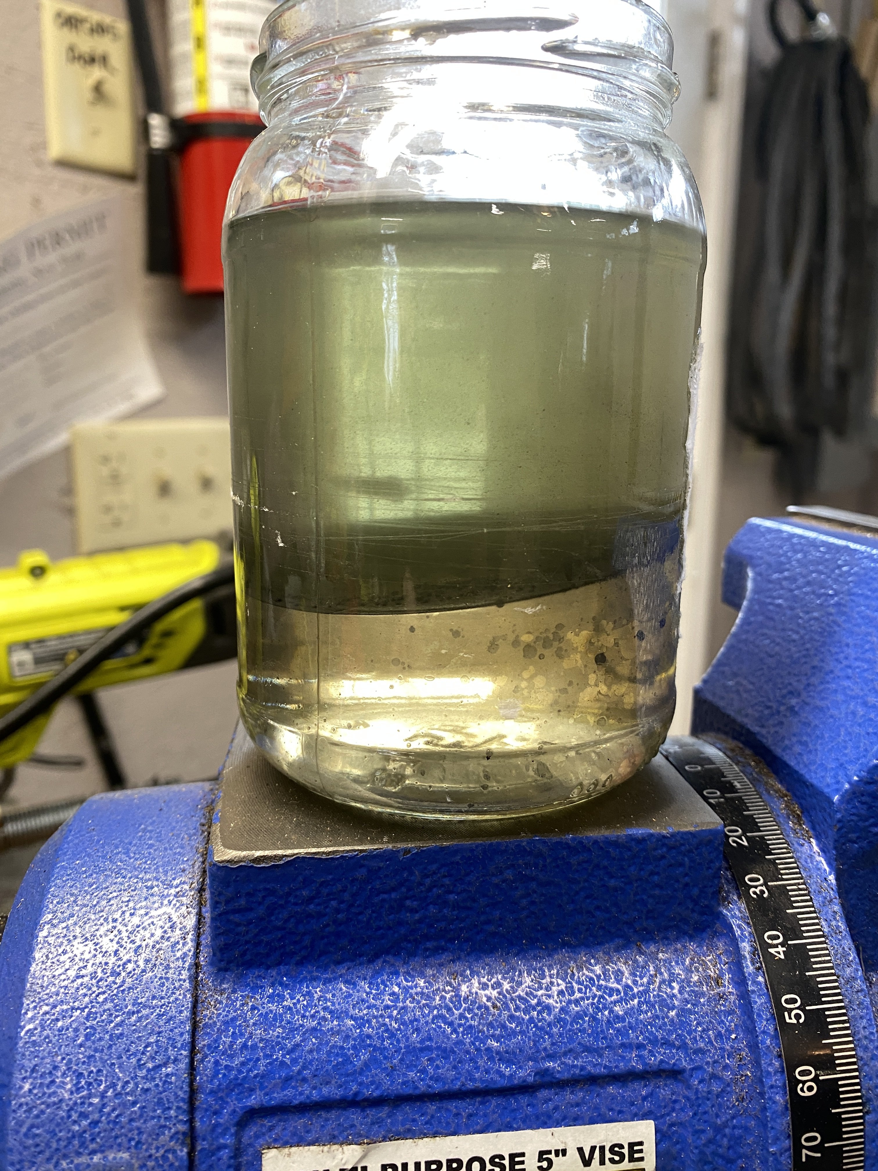

You have alot of water in that fuel tank. I would dump, clean and put fresh on.
