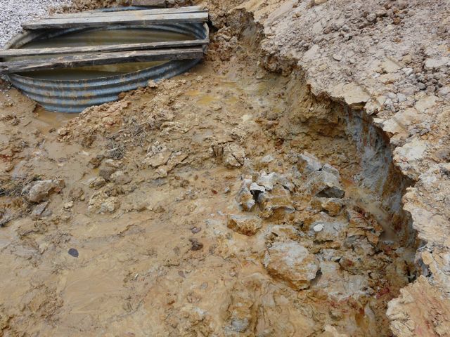

Pacerron, The PVC pipe in the first pics was a stand for a solar panel and was on the other side of the pond. It has been removed. The plan was just to clean the pond out with the track-hoe and be finished. But then Jim mentioned about a culvert and that started another realm of projects that seem to be mushrooming.
I bought a 30" culvert 6' long this morning that I will use. I will level the top of the 30" culvert so that it is above the spillway. The large culvert ring will be raised slightly and filled with gravel for a solid platform leading to the 30" culvert. There ares several other options available and I'm thinking of new ones daily. Monday when the digging starts I'll figure it all out.
Do I need to drill holes in the side of the 6' culvert on the bottom half and then put rock on the outside?

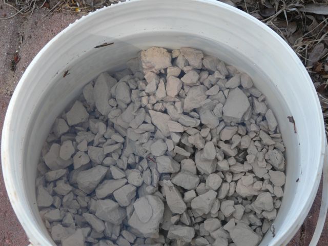

Anything for the wives. The stone and water test is commencing. I used pool water with a known PH. I'll check the PH with a pool PH strip in the morning. The water is a murky white, but the washed stones have a grey-ish color. Temp 106.
Is this stone good or not for a percolating filter, it looks like it does have sharp edges?

Don,
It might work since it has various sizes and shapes... but you can't beat river gravel or pea gravel as Jim mentioned since it is roundish and smooth and won't clog up or compress like sharp cornered stone.
You said you compacted the ramp for your hoe a little. Take a bucket of water and poor it gently onto the stone and see. If you poured it on river gravel or pea gravel ( at least the Ohio type ) it would run right through.
Call your county extension agent or a gravel company and ask them which is preferred.
Try some stones in a bucket of your clay laden water to see what it looks like
and then let it settle.
Easier than working in the heat!

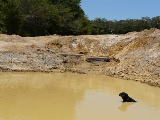

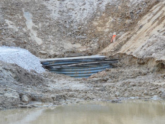

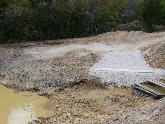

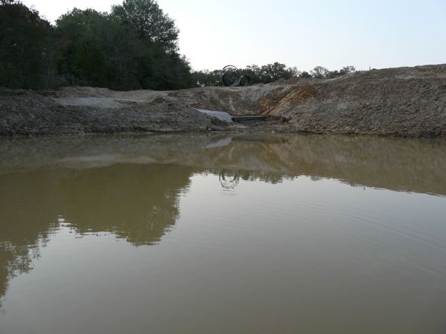

Pacerron, the water in the bucket of rock was perfectly clear after 3 hours and the PH changed slightly from 7.6 to 8 after 12 hours.
My additional stack of culverts is ready to go.
I'll take some pics when I put on the BH.
In the picture with the stake the orange ribbon is 6" above the level of the spill way (according to my laser level) and will be the height of the small (30"X6') culvert.
As you can tell the water is still rising at a good rate, I'm feeling a sense of urgency to complete this.:)
Monday will be pea gravel day and Tuesday will be installation day.
Any last minute advice is still welcomed.

Looks like your ready to dig. Where are you going to pile your spoil as you dig? Who knows, you might hit a big layer of water sand.
Can you tell from your water well log at the house what type of strata you may be getting into? It won't be horizontal but the layers may match and you know what has been cut through already.
Whoever bulldozed your pond shape and field water barrier wall did a good job.
Last minute advice: Big drinking water jug, tall barn boots, and have somebody up there while your digging the pit. The dog doesn't count.

Don, your rock looks fine to me for your purposes. That washed handful and the bucket show that it is not flat chips, but various sizes that will allow water to pass just fine. I don't think you'll have any problem with it packing and sealing.
The small pea gravel my well driller used was tiny because it had to fall down on the outside of the casing in the space between the hole wall and the PVC casing. Keeping small pea sized gravel ensured there were no dams forming and stopping the gravel from going all the way to the bottom. In your case, you'll have no worry with anything like that.

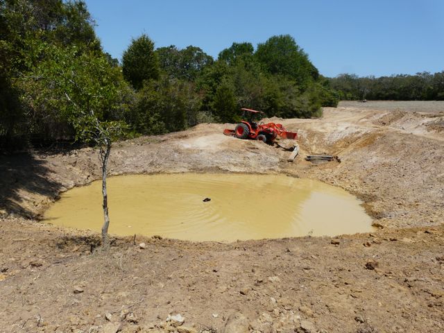

When they did soil testing on the hill for the house foundation they did hit a layer of coarse sand after the red clay. I just don't remember at what depth it was.
The spoils will go on the bank (to the left of the picture below) and I can take them further up after setting the culverts.
The cave-in shows the virgin soil red clay with streaks of water laden sand. It looks like two areas of springs in front of the culvert also.
The culvert filled with water last night. I'll dig a small hole on the down side to drain it before digging.

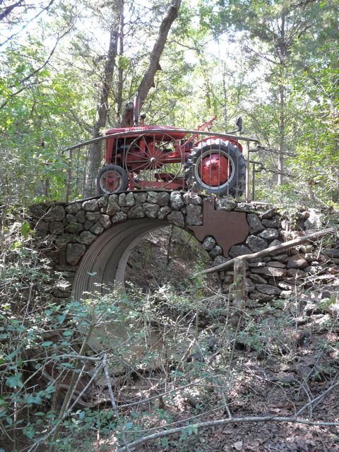

Jim, the bridge in the back is a lower elevation but is on the up-side of the fault line. Looking at the attached map at Lee county, the Carrizo-Wilcox Aquifer outcropings follow the fault lines through Lee County right through the middle of our place.
http://www.twdb.state.tx.us/publica...rts/R345 Aquifers of Texas/Majors/carrizo.pdf
Like the bridge, I hope to fix this up to be a focal point on the land.

Excuse the ignorance of a newcomer, but what is the "Bridge"

In 2004 A group of TBNers in Texas and one Okie got together near Dallas at Harvey's shop and built a bridge out of metal. We got to use a forge, wagon wheel maker, MIG, Cutting torch, stick welder, plasma cutter, metal benders, etc..... Whole families came out and we had a big BBQ. It was the best of times! Here is the 900+ post thread:
