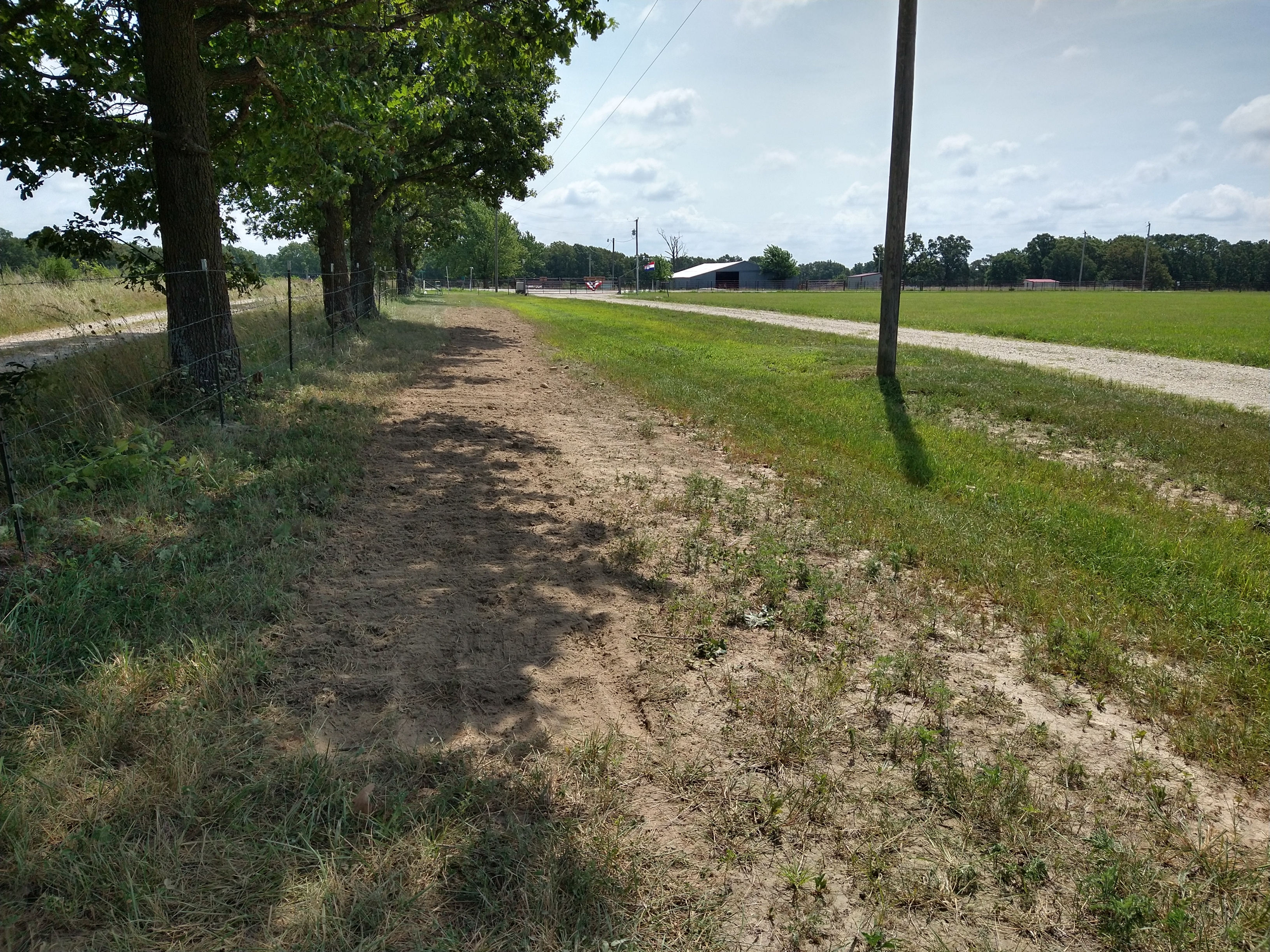

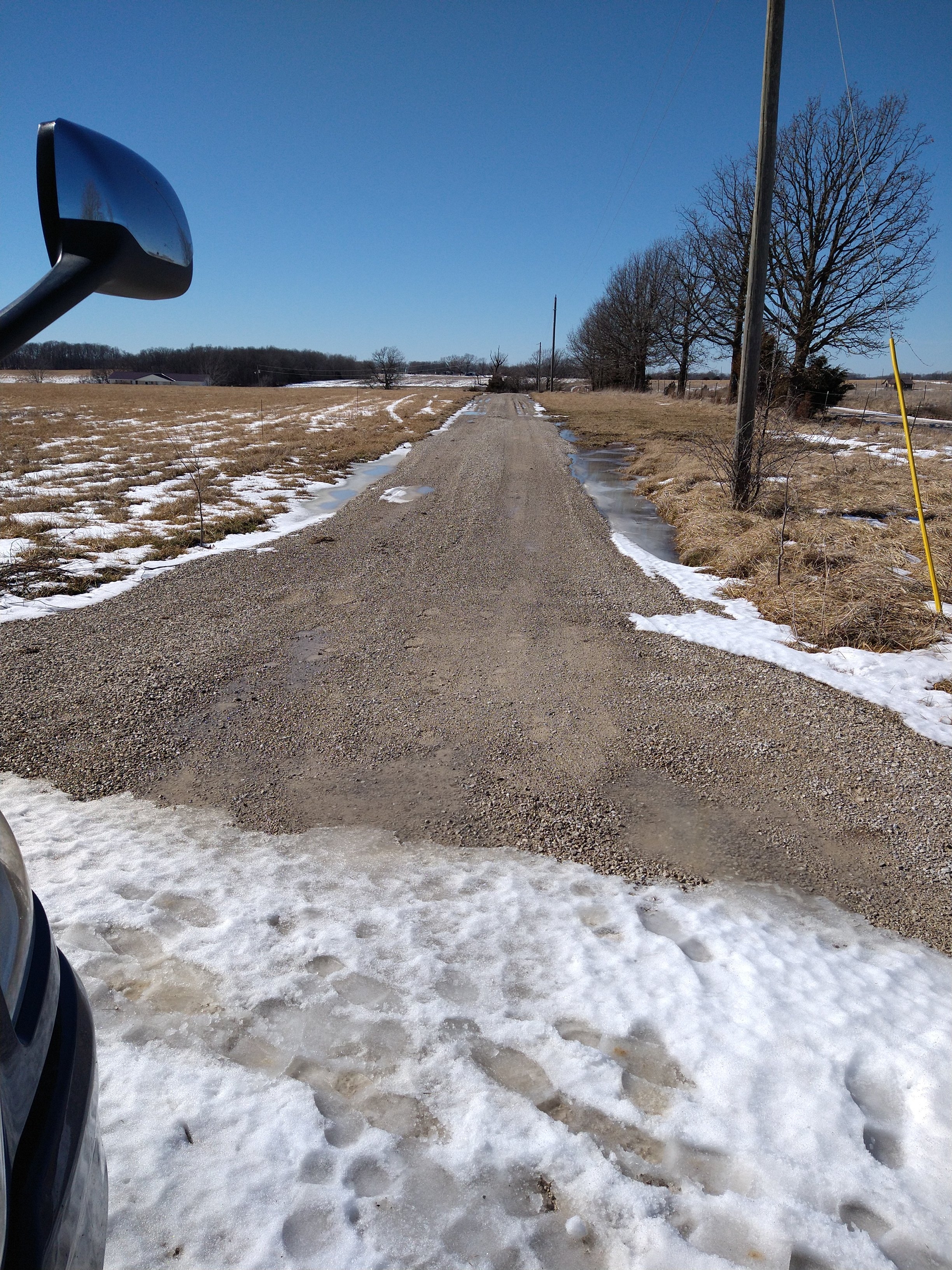

Finishing the job, hopefully I'm finally done!
When I bought this place 3.5 years ago, the right of way on the private road did not convey, so they put in a new “driveway” out through the hayfield, but all they really did was scrape off about 4” of sod, and spread out 4” thick of 1” base, which is 1” rock down to basically sand or “fines” … they put it right through a swampy section of the field … I brought in just under a million pounds of rock and gravel, put in three culverts, and dug over 600’ of ditch, which I had never done before, all with my tiny little SCUT … I found out that there is a 2.5’ rise from the road, before it starts going downhill to my creek out back, so … the ditch got quite deep, which I “mowed” with my 5’ brush hog, but the sides were steep, especially near the utility pole, as I didn't want to get too close to that . . . I fiddled with it off and on when I was home and it was raining, trying to get it to drain and flow properly. Finally this spring I was satisfied, but it was nearly 3’ deep in places!

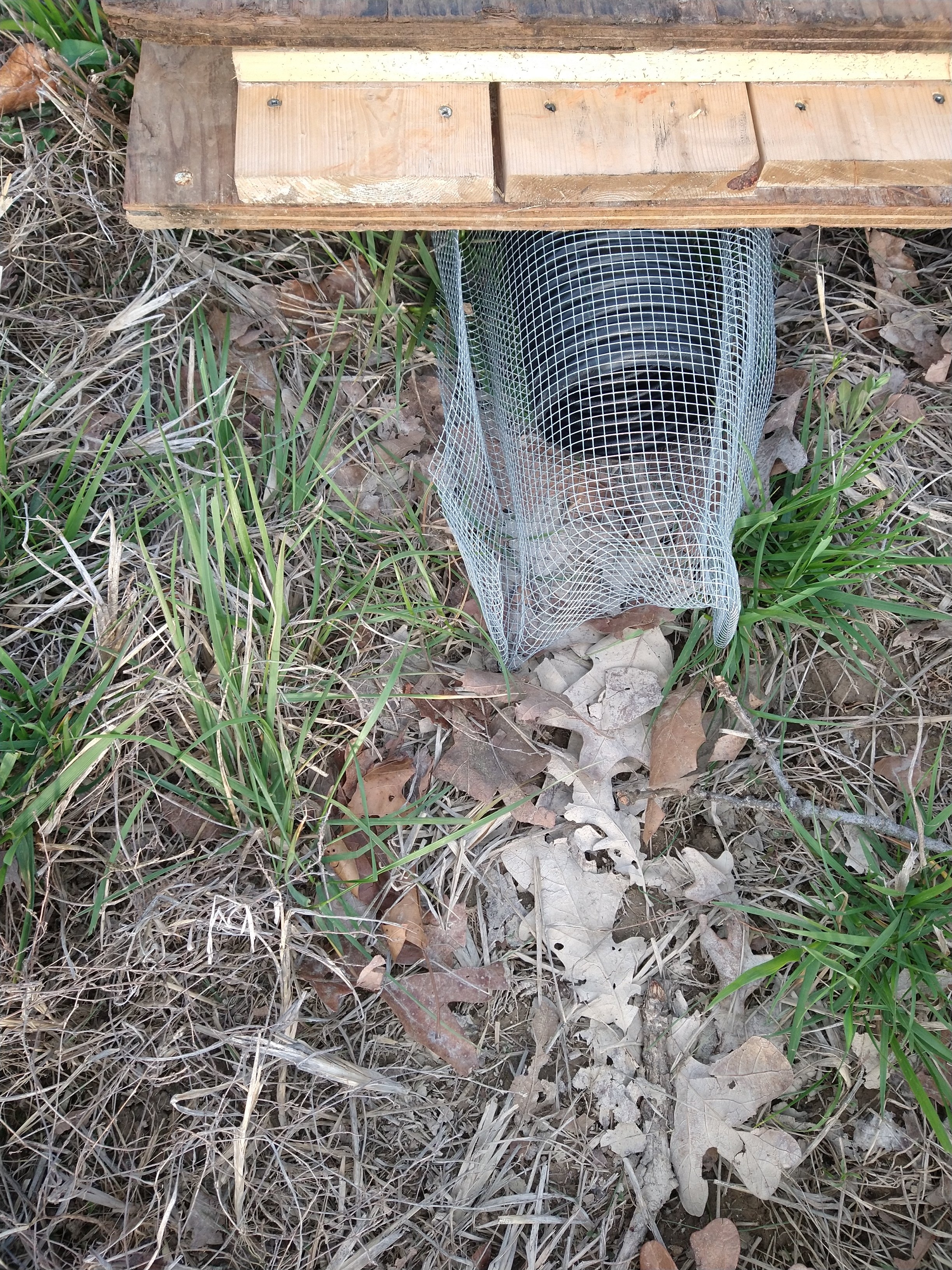

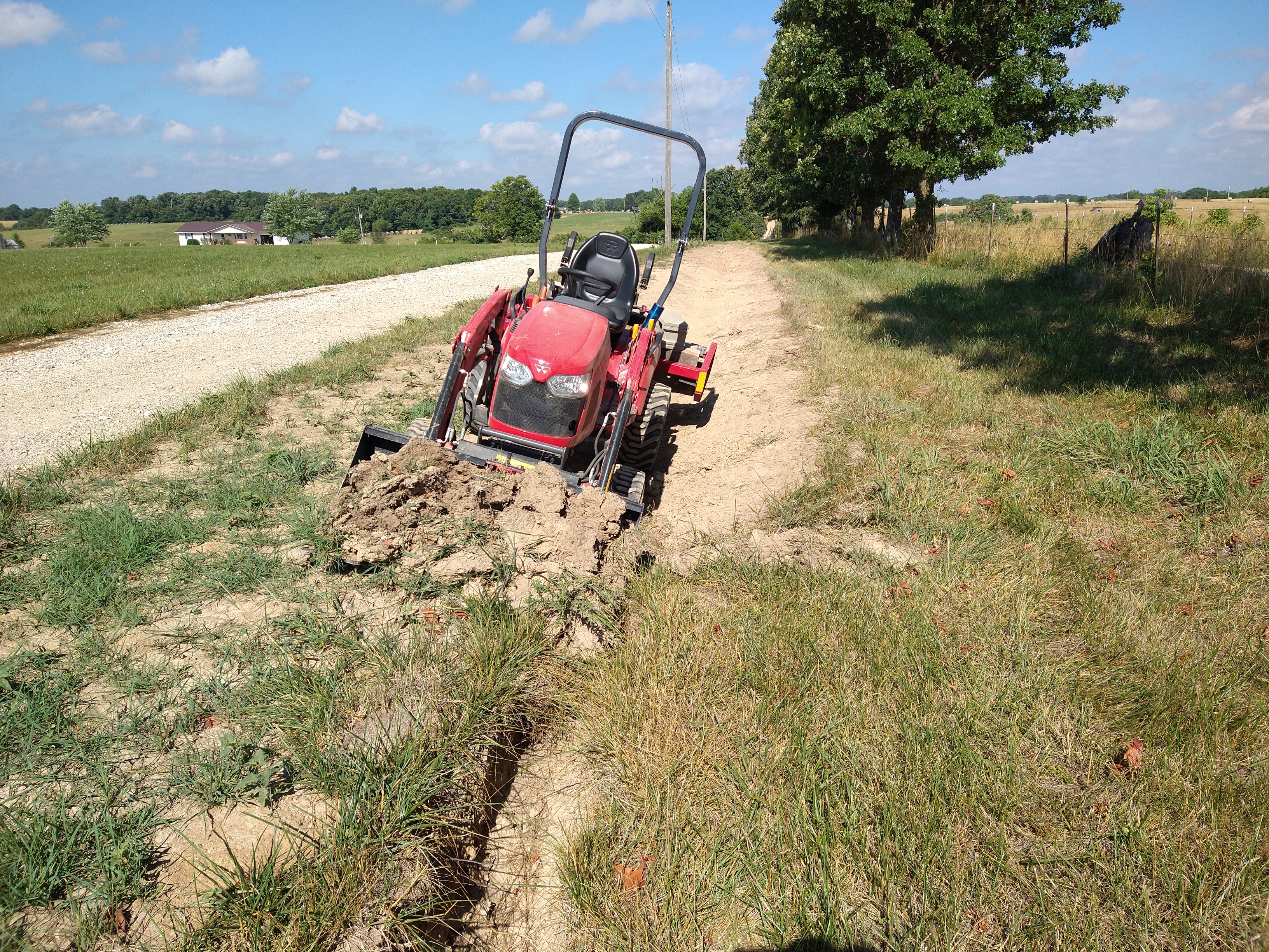

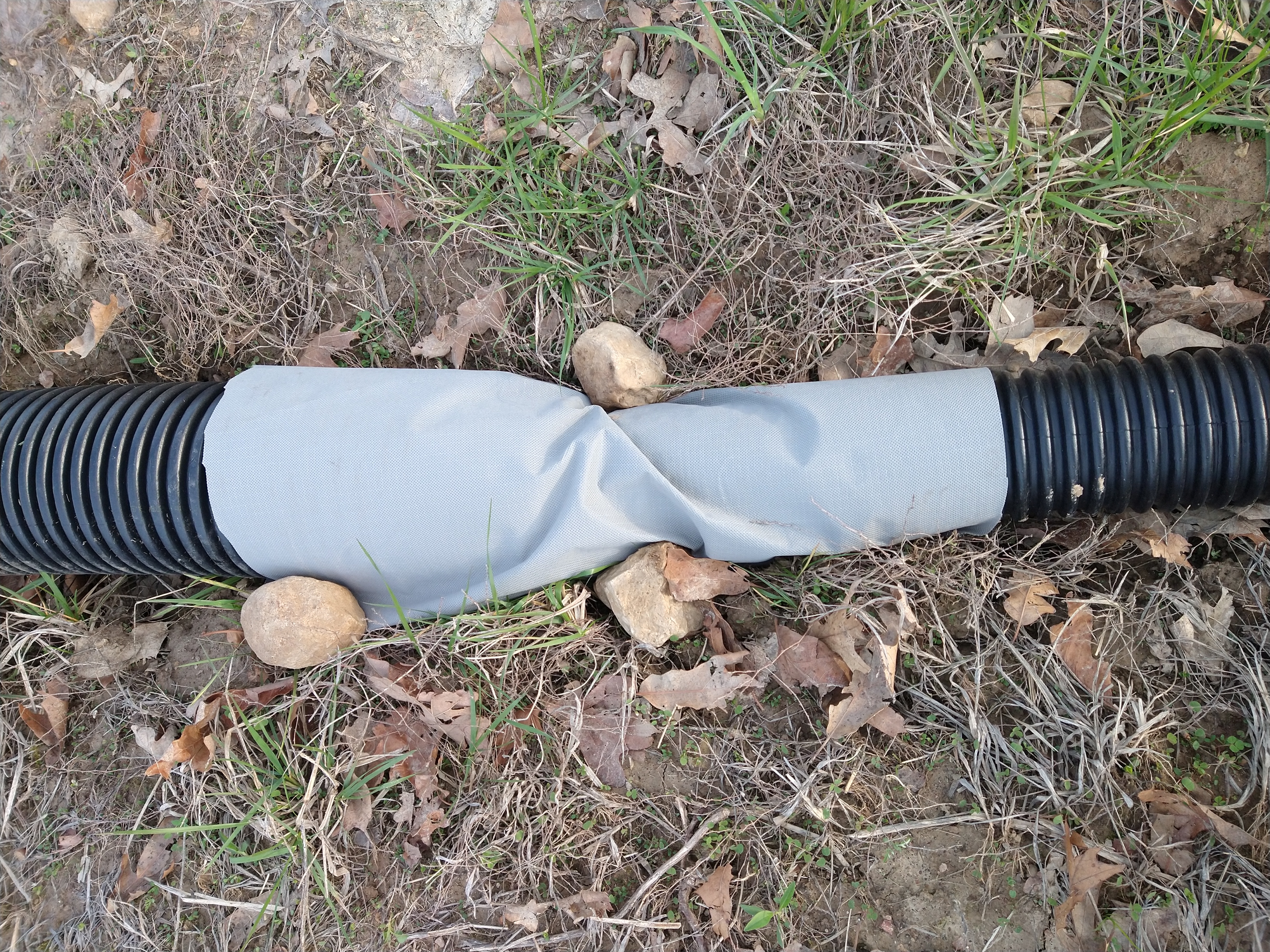

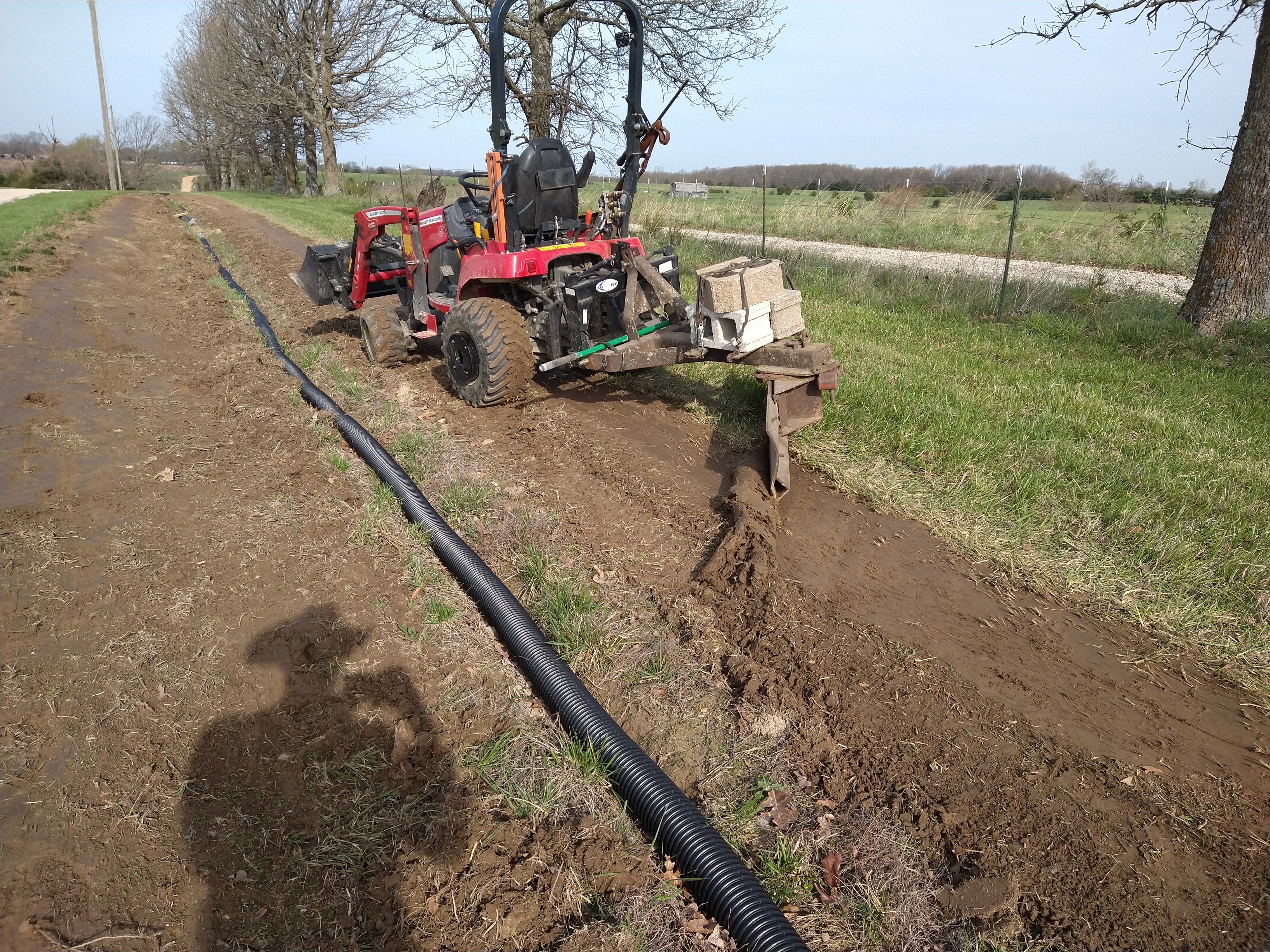

I got 200’ of 4’ flexible pipe, and already had some 6” pipe sections, that I used for “connections” by sliding the 4” into the 6” a foot or so, covering with a double layer of weed barrier, figured that it would let and ground water in there, drilled a few small holes in top of other sections covering with more weed barrier … made “ends” out of ¼” hardware cloth to keep snakes out … and started to reduce the sides down by scraping and pushing it on top of the piping … I ran out of time, but got most of it done …

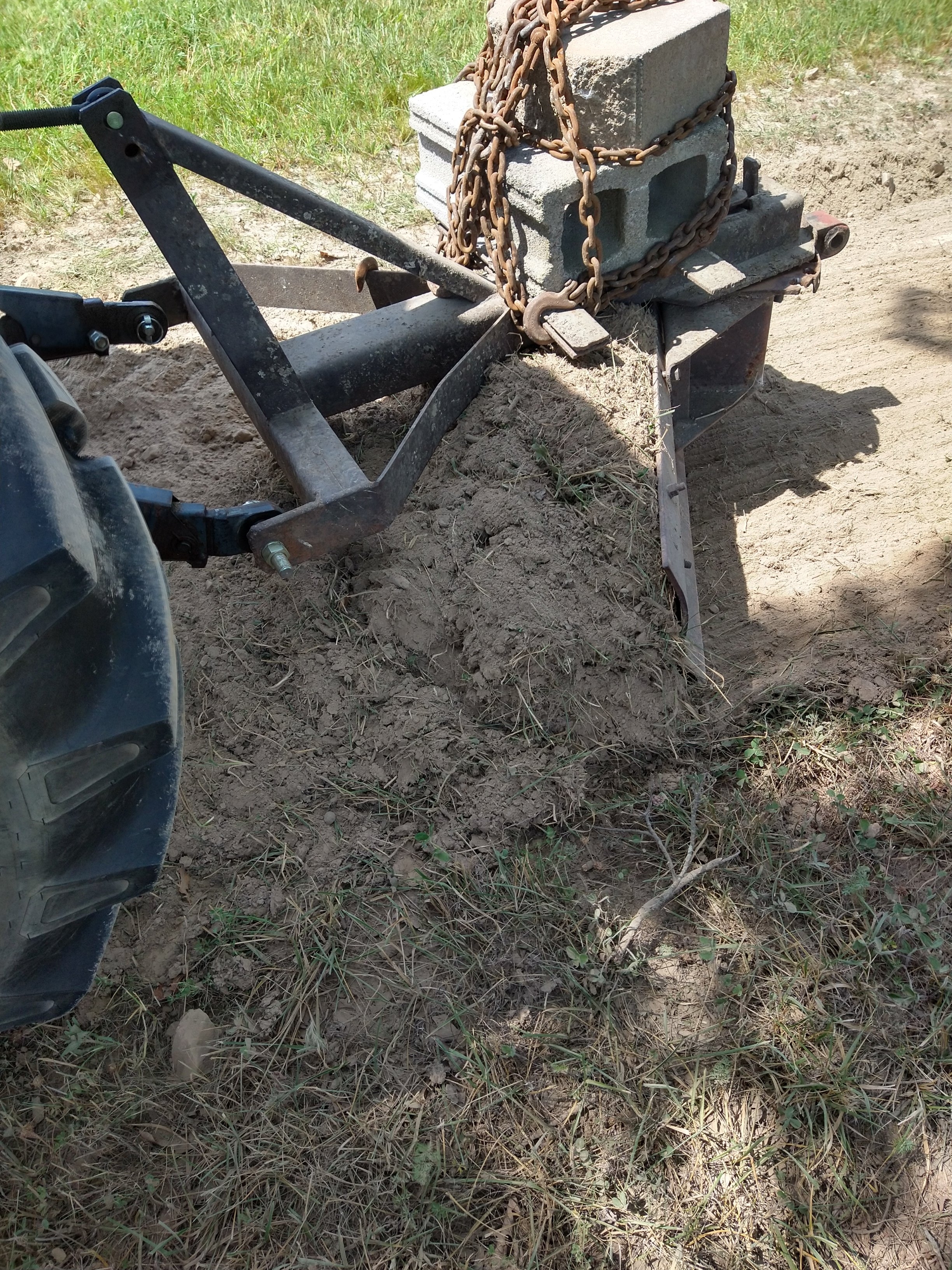

I had trouble scraping it, as if it was soft enough to dig in, it would push the back sideways, even though I had filled tires, 70 steel wheel weights on each side, plus 200 Lbs of weight plates I made a way to mount to my BH frame ...
Only the top few inches were soft enough to scrape, once the sod out of the way, then it was too hard, after trying a few different things, I used my rototiller to dig it up, then I could move it with the rear blade!

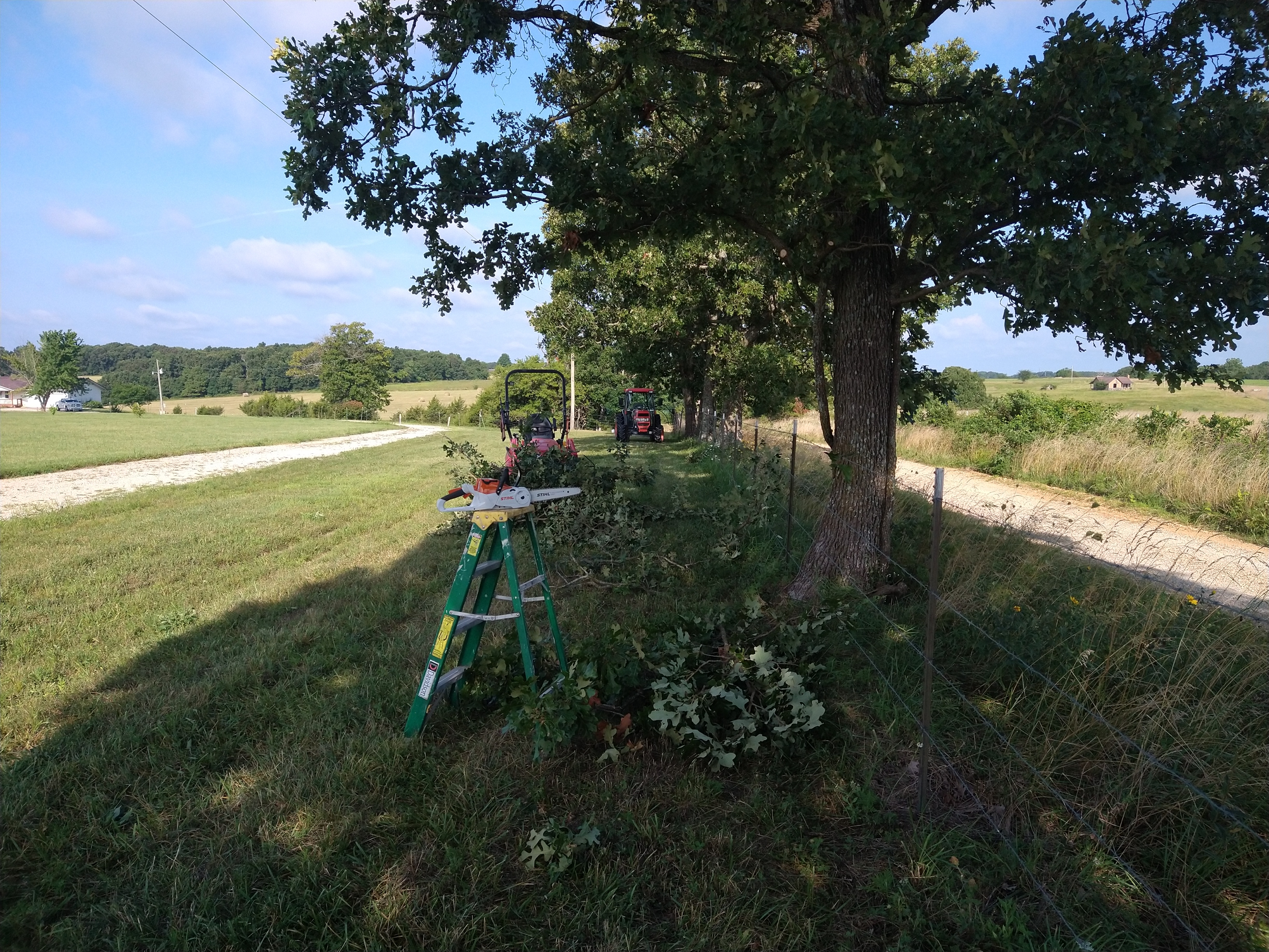

Since I got a bigger tractor to pull a bigger mower, I needed to get this done, but had to trim some of the trees along the private road that overhung the field to clear my cab, so that was the first order of business.
Step ladder and chainsaw, forks to carry the branches away ...
A full load!

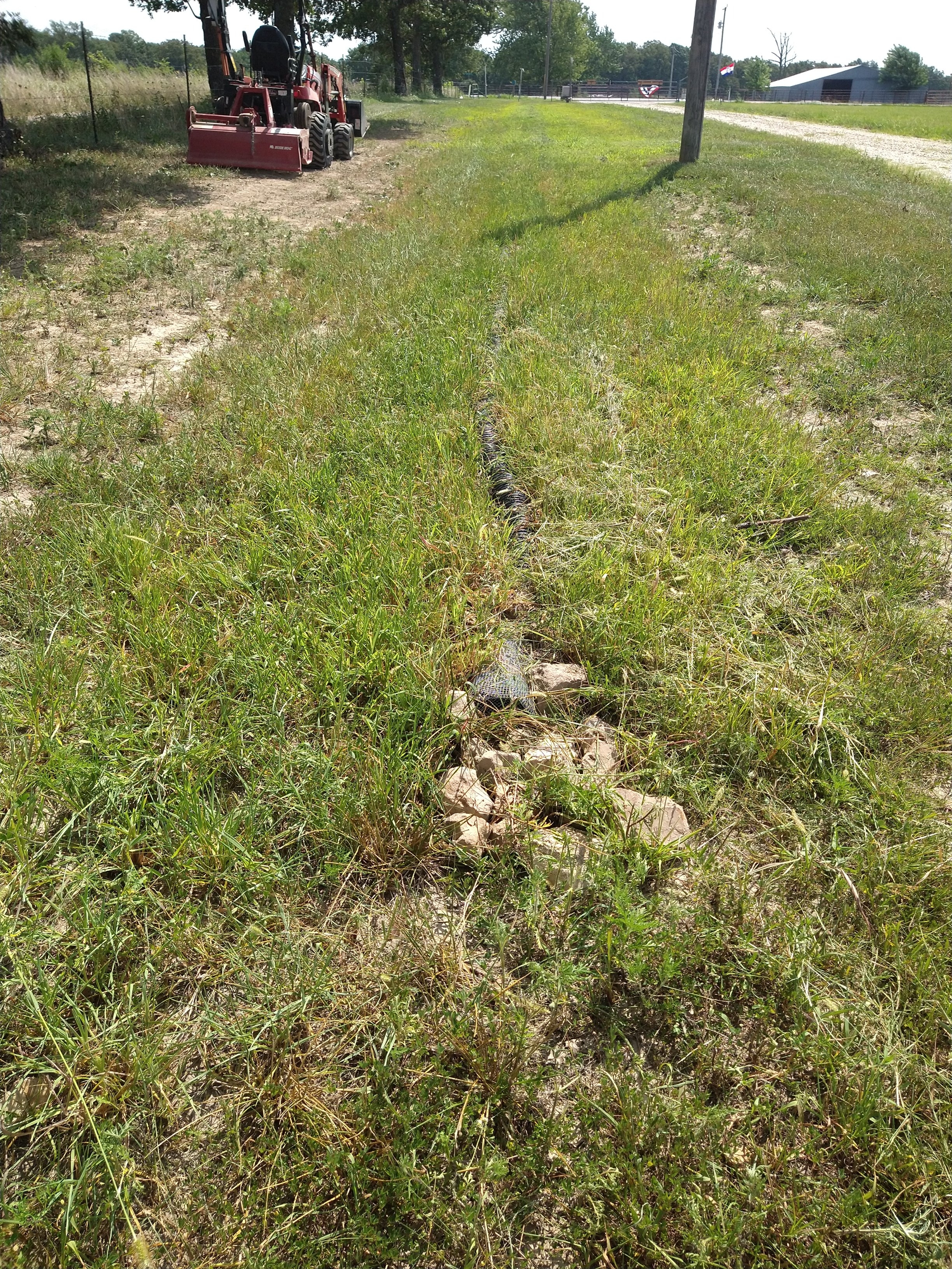

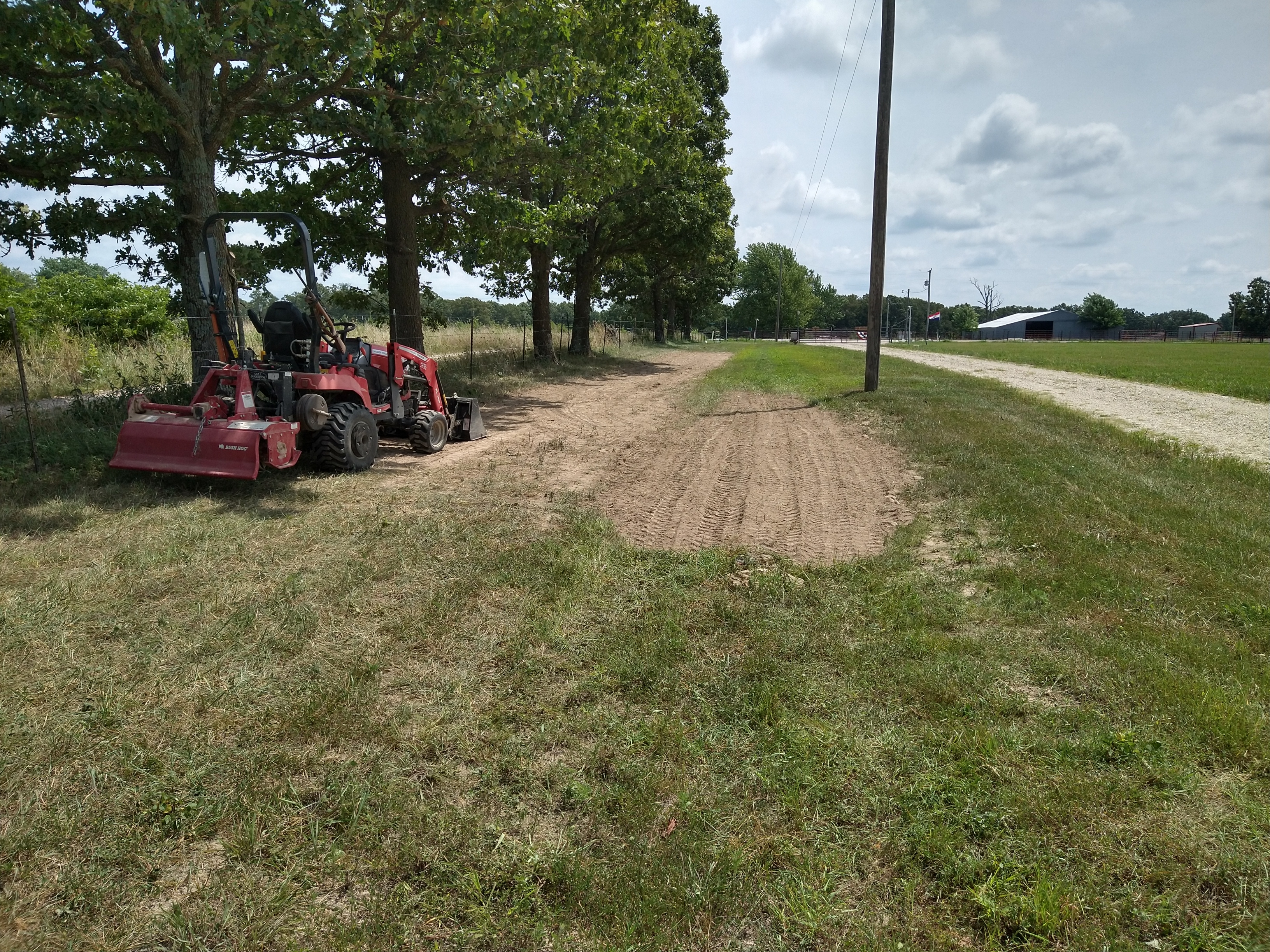

There was still a section of pipe not covered up, so I needed more dirt ...
I placed rocks near the ends, so the water can flow through, but I won't crush the end of the pipe running over it!

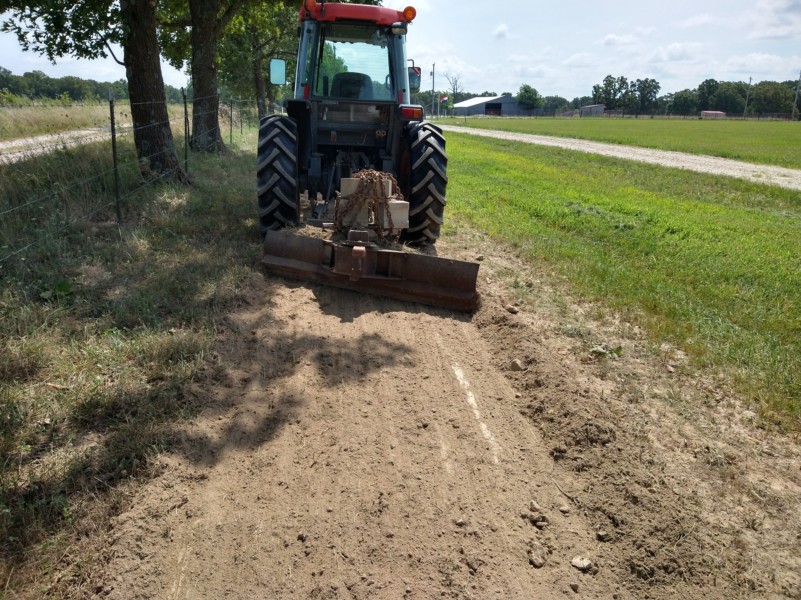

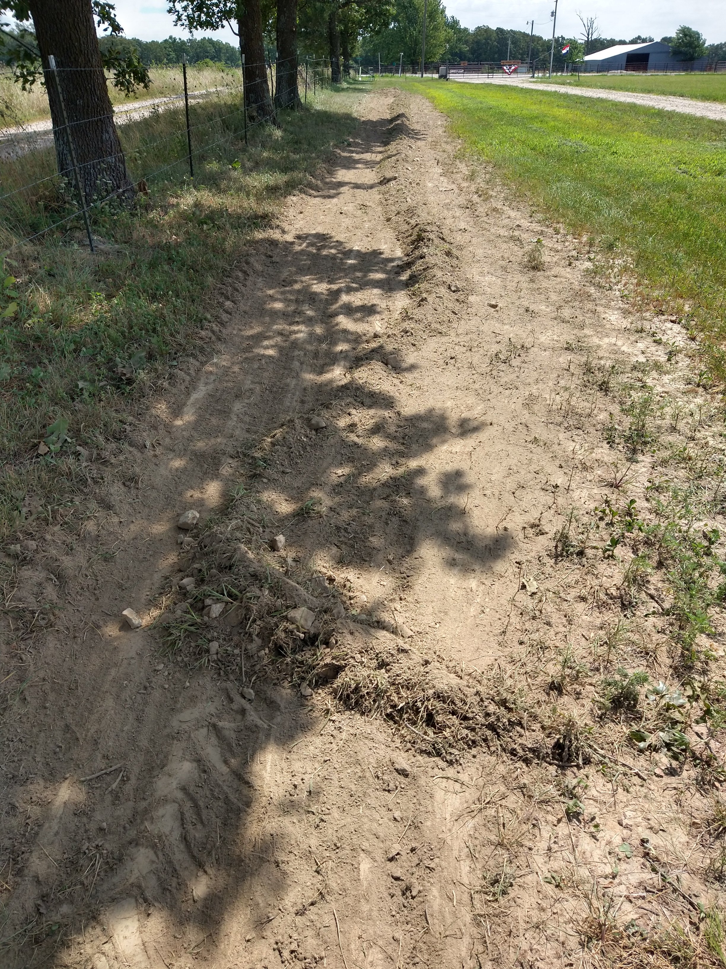

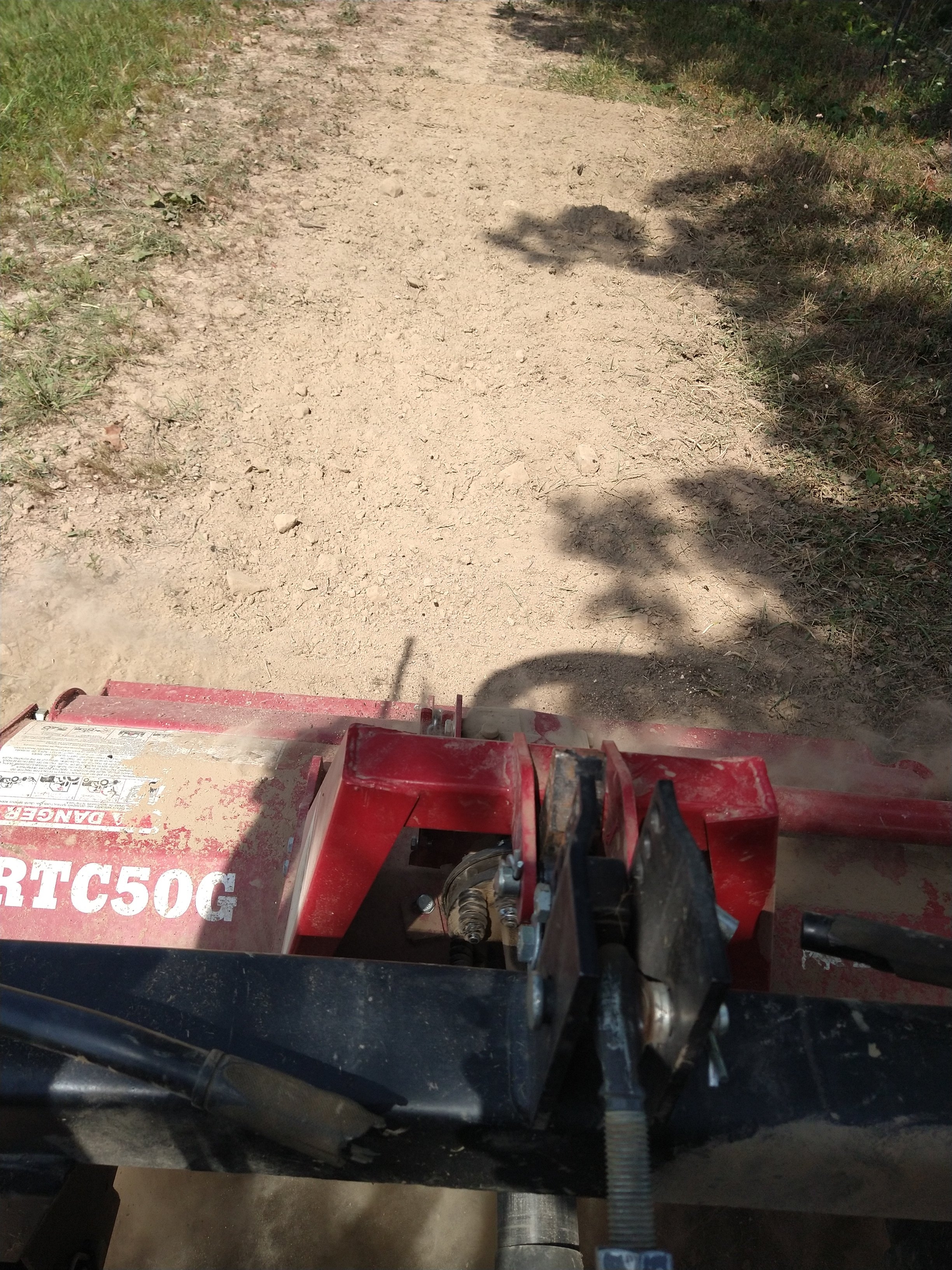

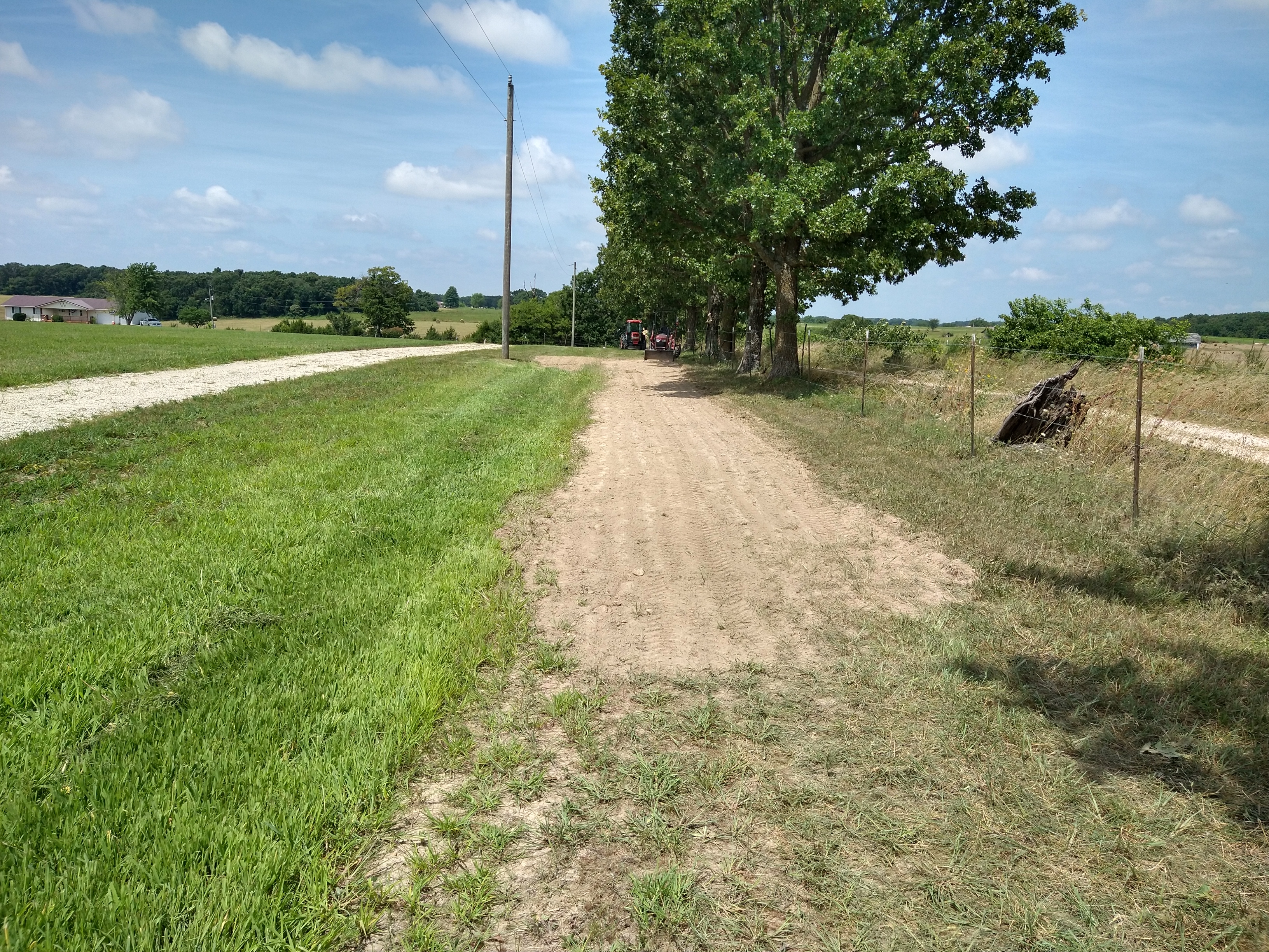

This is basically virgin ground, hard packed clay, that was dry, it wouldn't scrape/plow like when it was damp in the spring, even with the bigger tractor …
So, I got the rototiller to chew it up, it was tough and slow dusty work, but I got it chewed up!
15 second dusty video!
Rototiller virgin ground
Then I used the rear blade to put it in a row, to scoop up with the bucket and dump on the exposed piping …
May not be perfect, but the piping is covered, and it's “mowable” now, good enough for a field.
Unfortunately the time inside the cabbed Kubota was short, compared to the time on the Massey Ferguson SCUT, or using the chainsaw ... Hot and humid today, I'm wore out!
But glad I got this done!

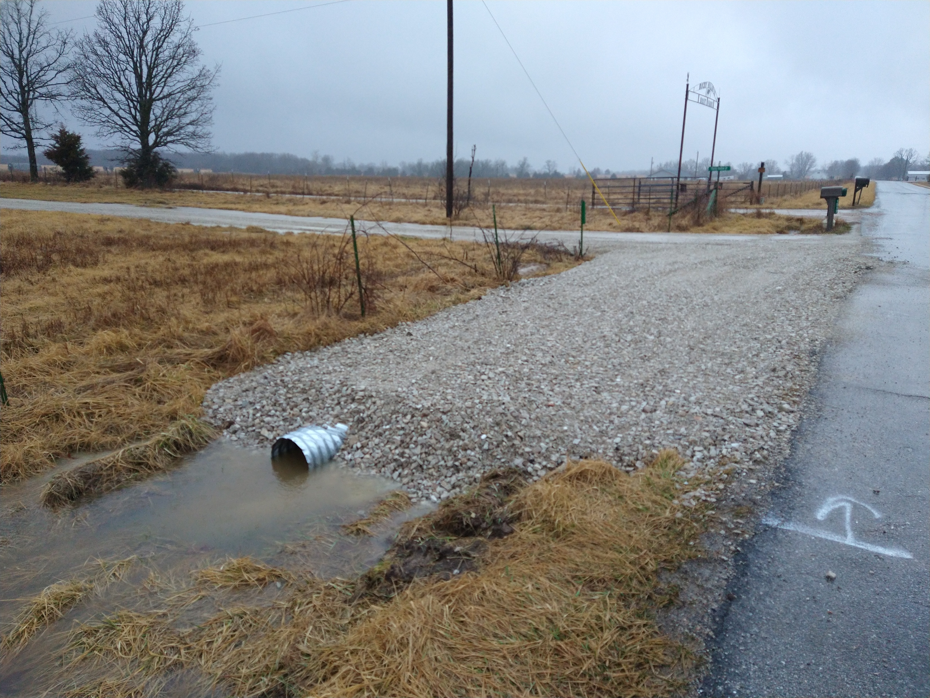

Yeah, back in the spring of 2022 I couldn't even get a contractor to call me back, so I decided to just do it myself! That's why I bought the TLB, I really wanted a much bigger one, but it's done an AMAZING job!

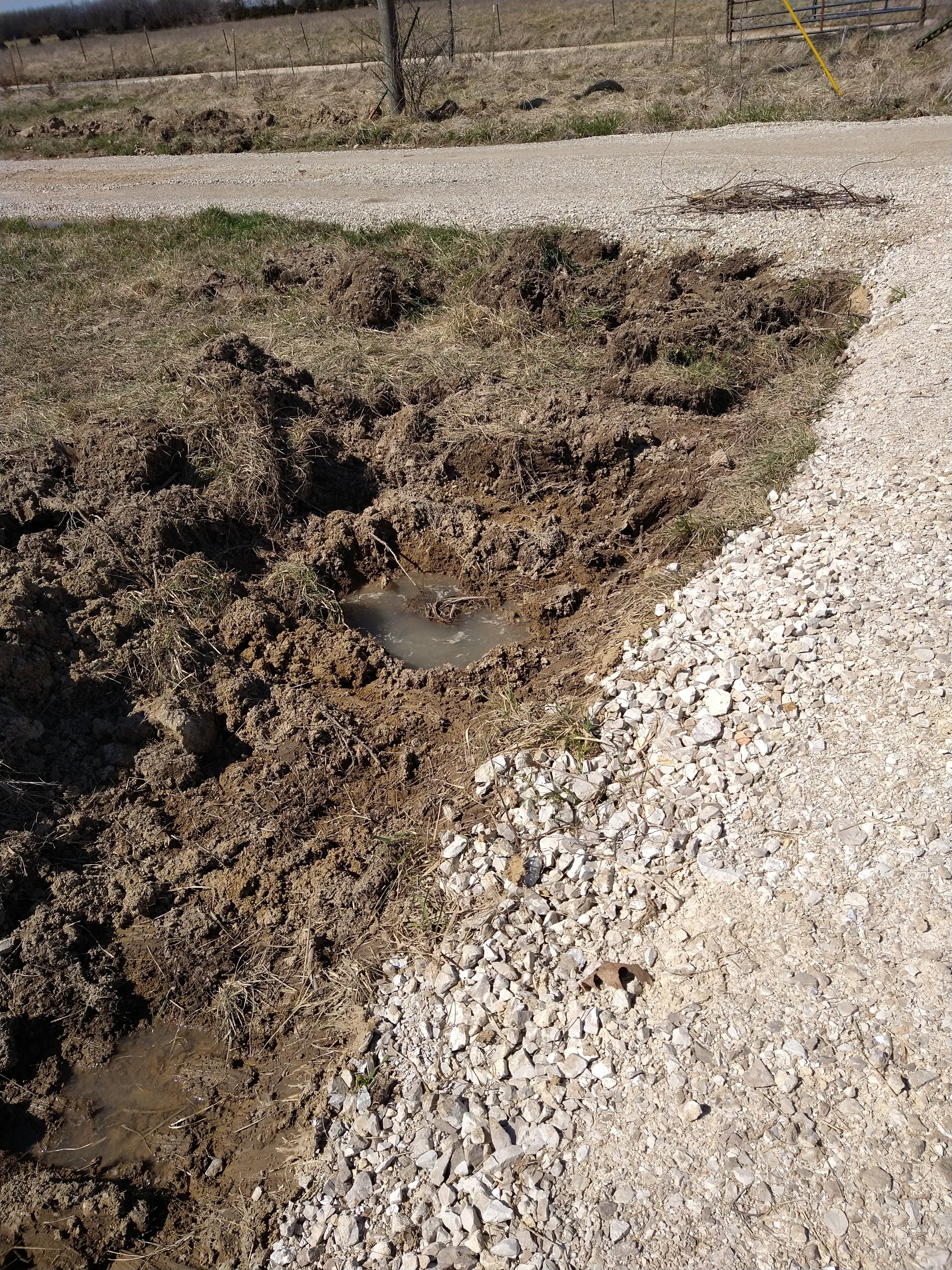

Here are some before pictures ...
UPS nearly got stuck, then refused to come down my driveway after this!
This is basically the area my gate is now ...
I had the county add another 30' section of culvert to the existing 30' so it would be wide enough for me to back my semi-truck off the road ...

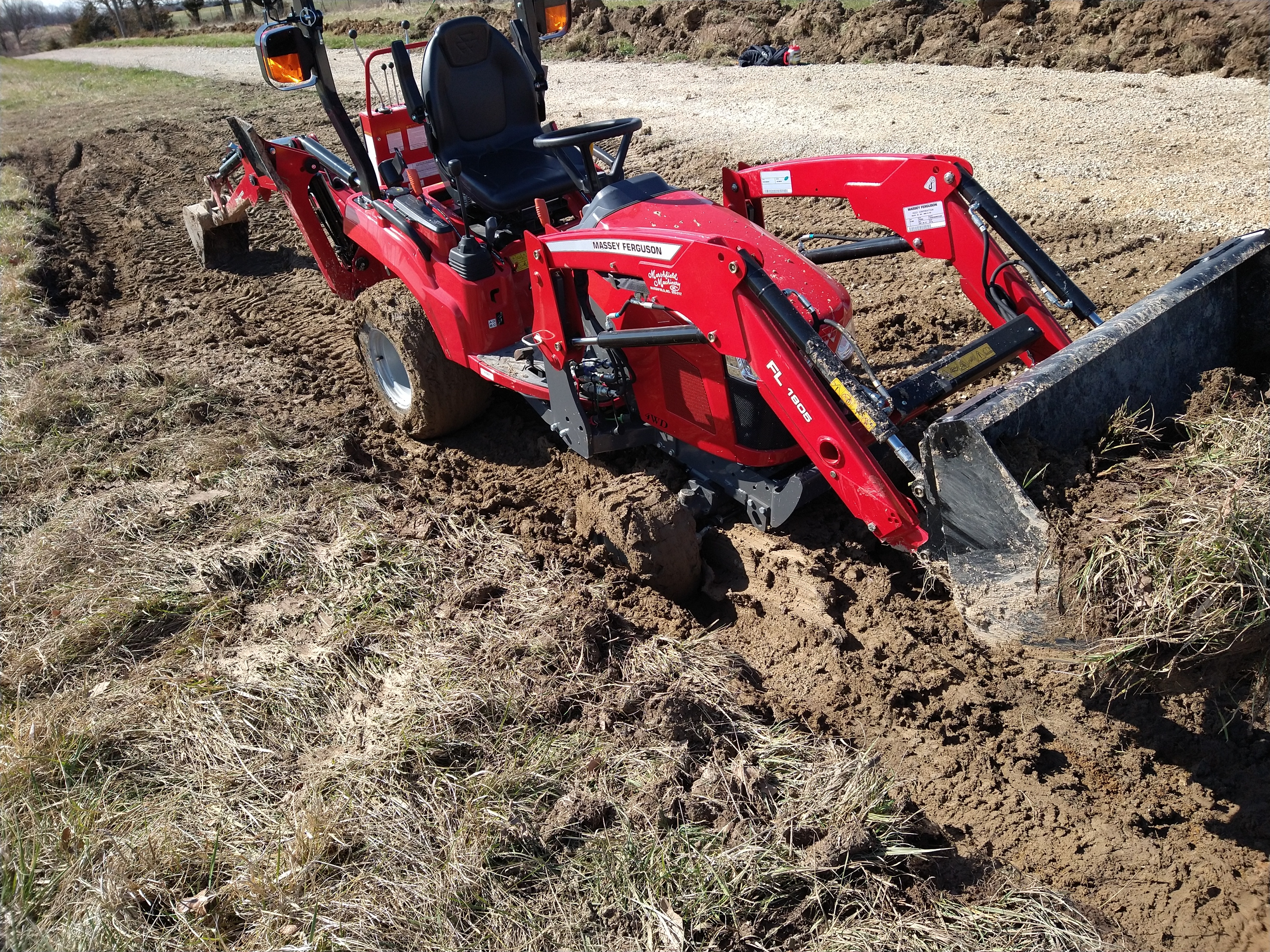

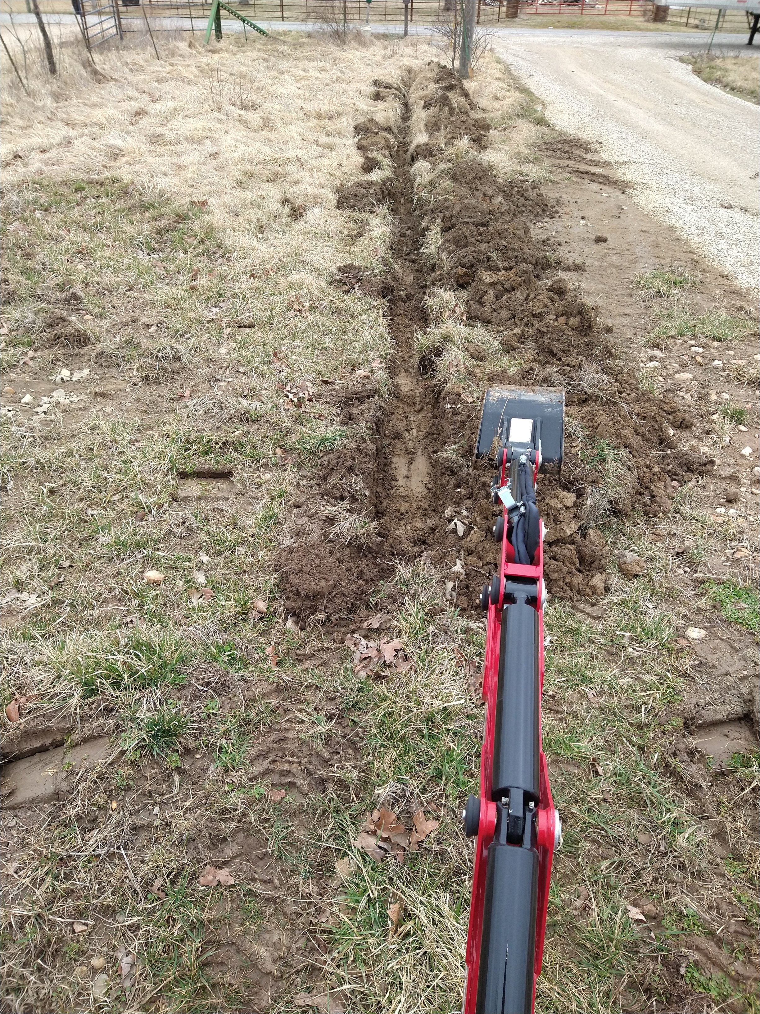

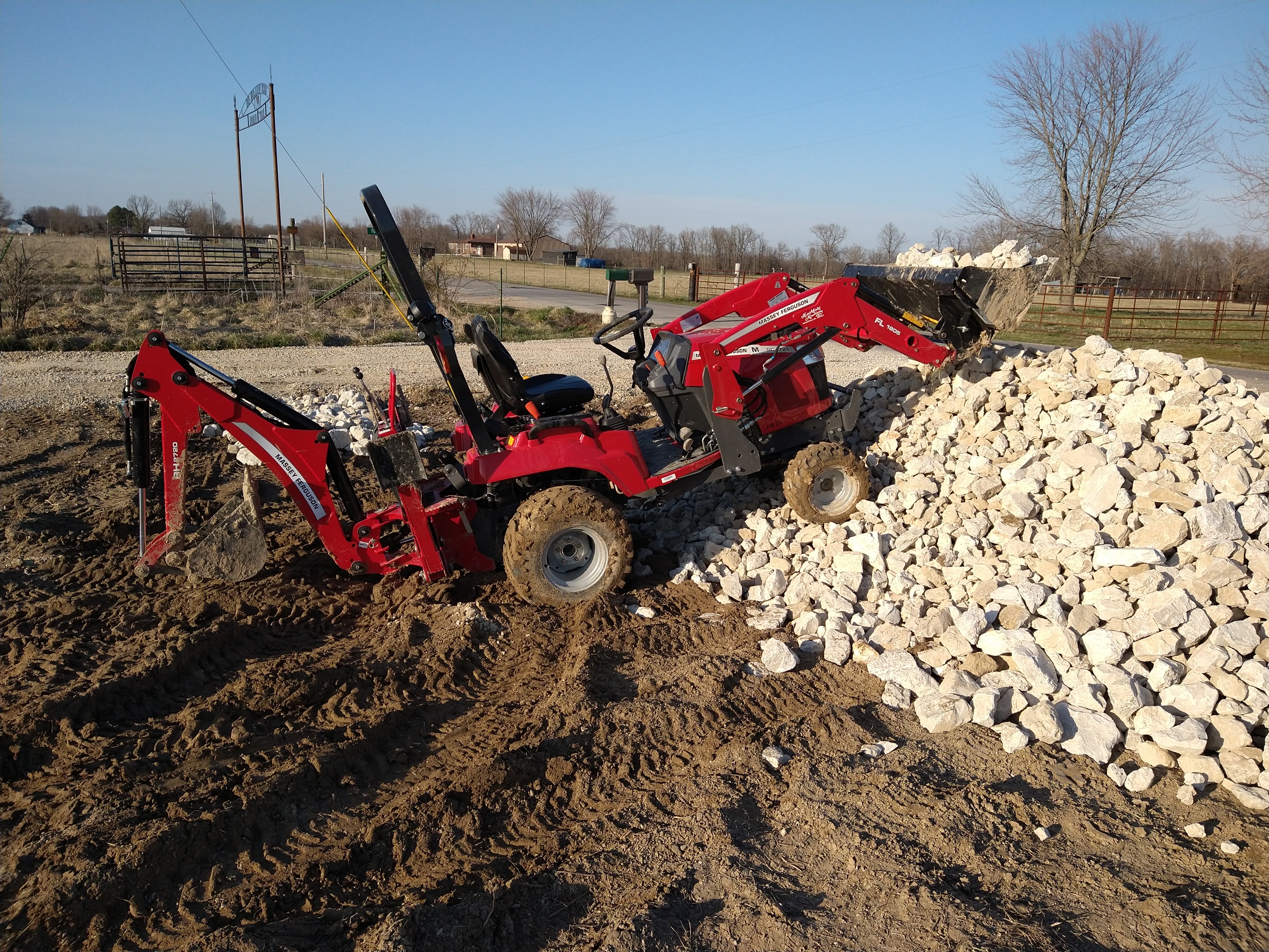

Then I got my TLB and put it to work, while learned how to use it! The "dirt/clay" was soft enough that I quite often had to dig it out of the bucket!

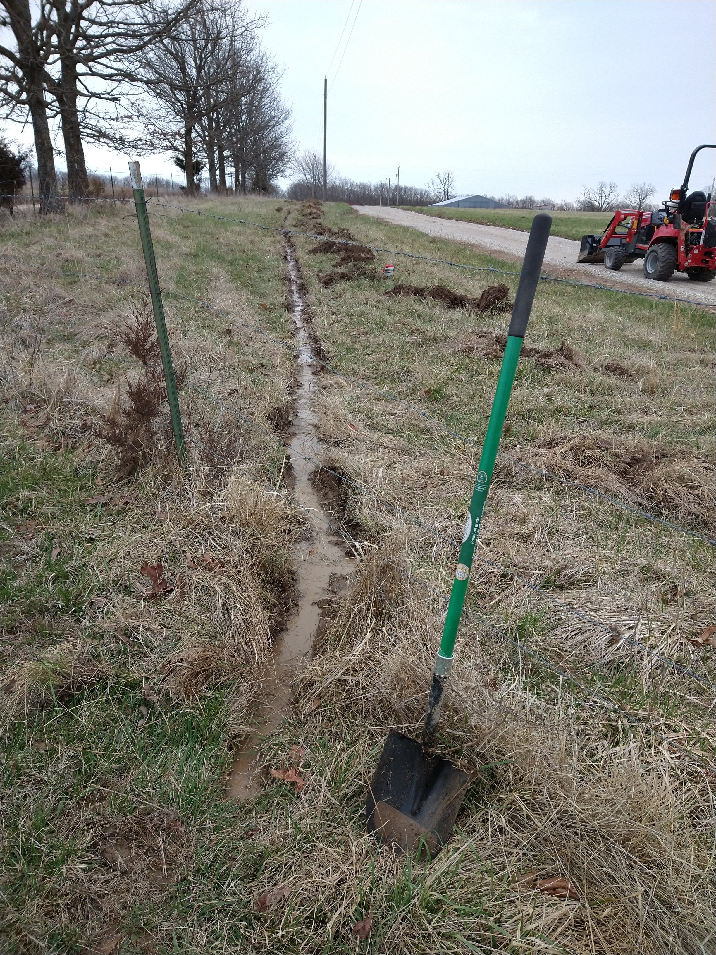

Once I got it down enough to start draining the area ...
I went back up by the road, removed the barb wire, and T-Posts, and dug out the multi-flora roses, water table was pretty close!
Then proceeded to remove the sod ... Got stuck multiple times, fortunately I had boughten "The Un-Stucker" model! ;)

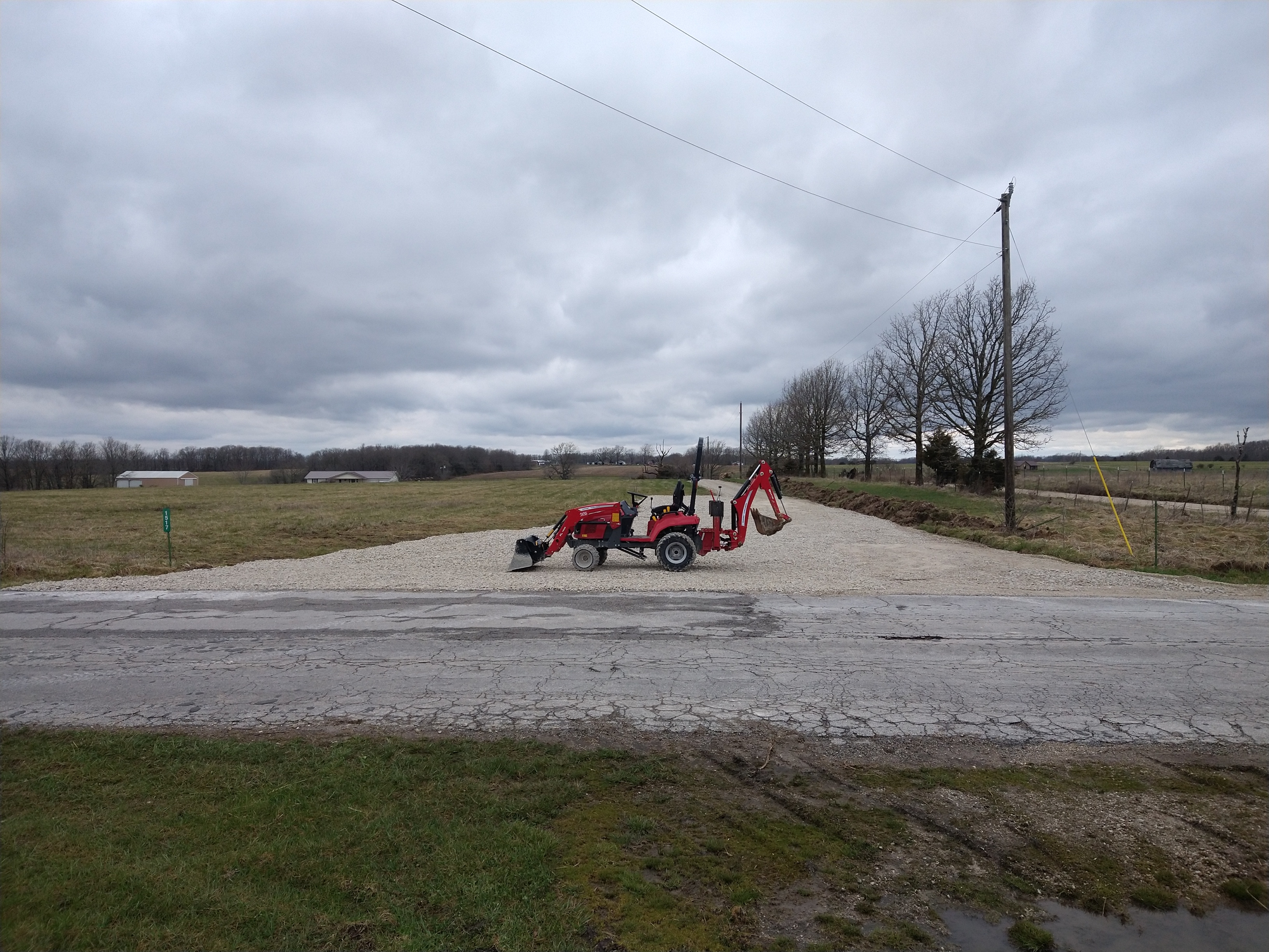

Then I finally got a guy to bring me rock!
/ Finally finished!
#9

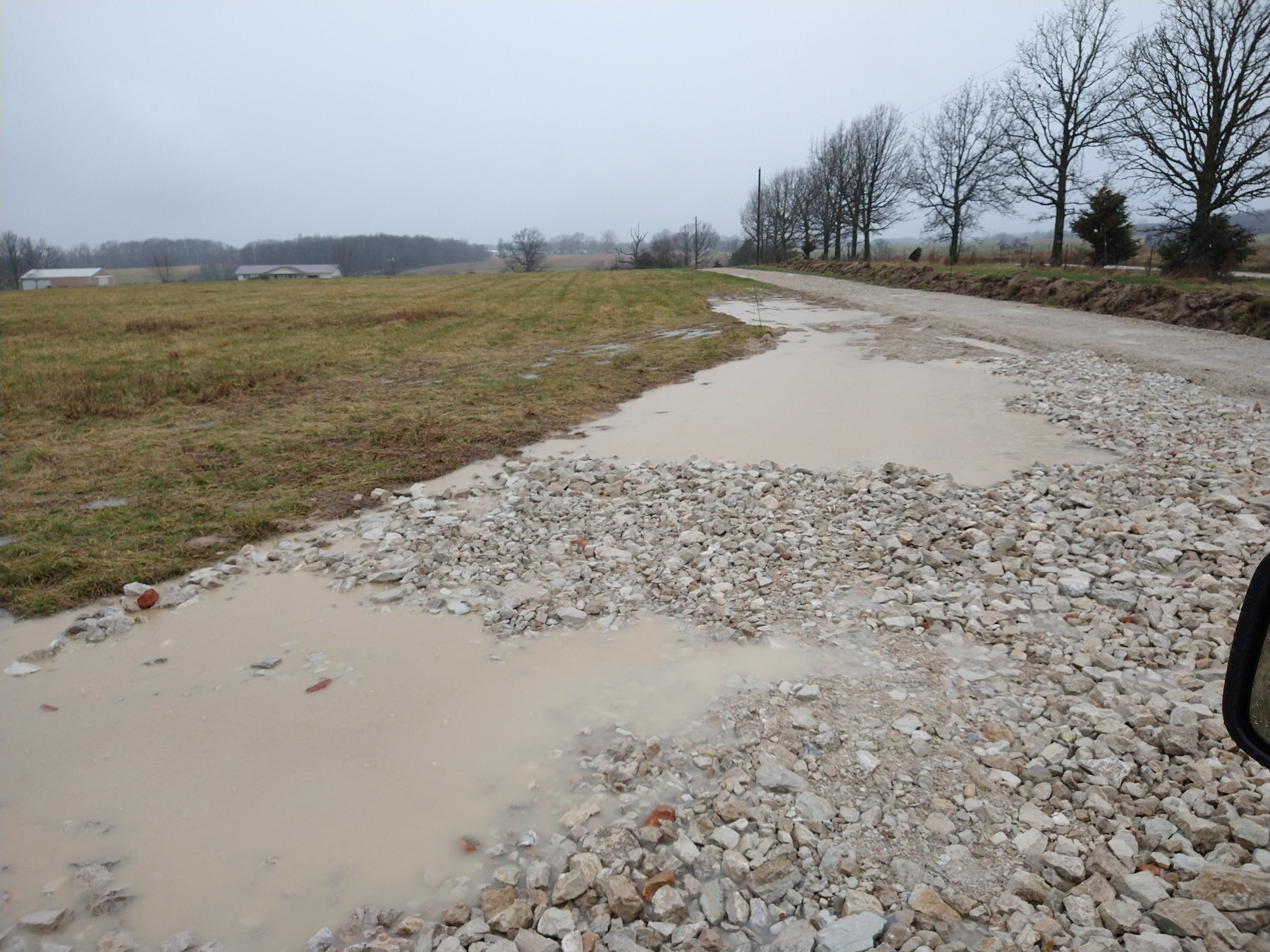

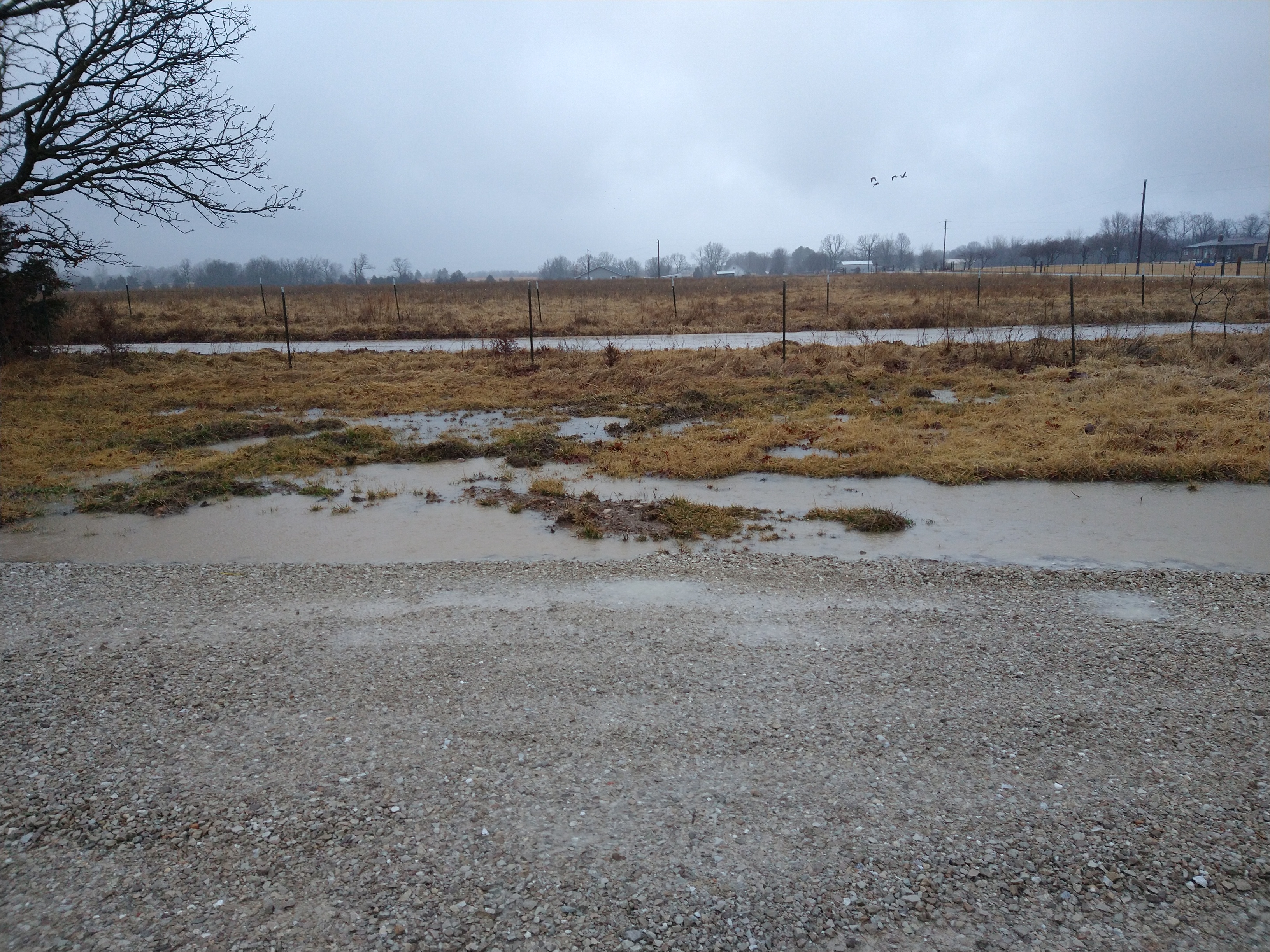

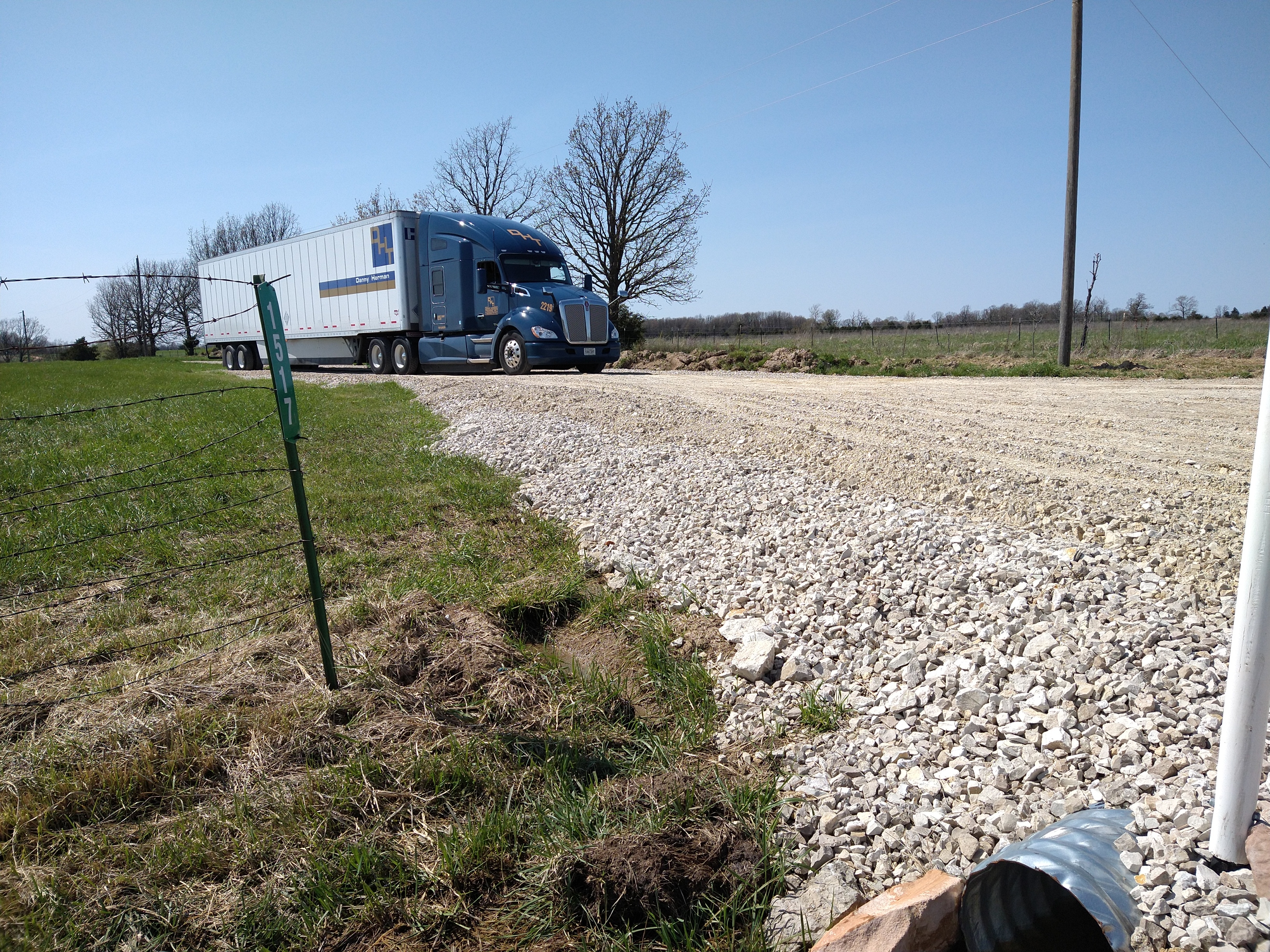

Three loads of rock, and a little rain ... I got a rocky pond!

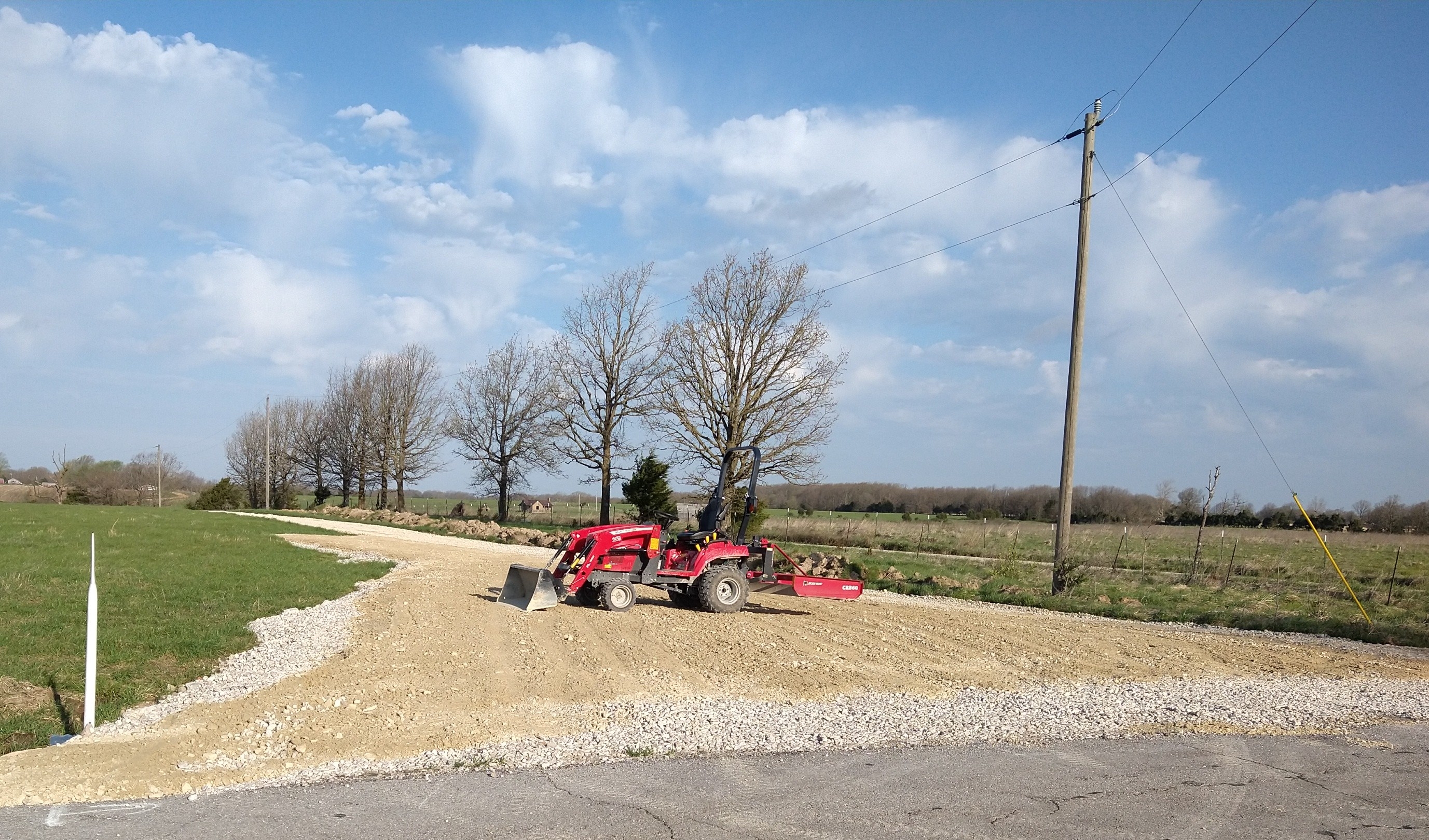

I told him to just keep bringing me rock! Until it kinda looked like a driveway ...
I used my semi-truck to roll/pack it down between layers ...
Kept adding layers ... It is now over 30" deep of rock I buried and packed in!
Every couple of months I'd add another 4" layer, until it was built up, letting it settle with the rain and me driving on it ... Then tried to bevel the ditches so I'd be able to mow them ... Kinda like a swale

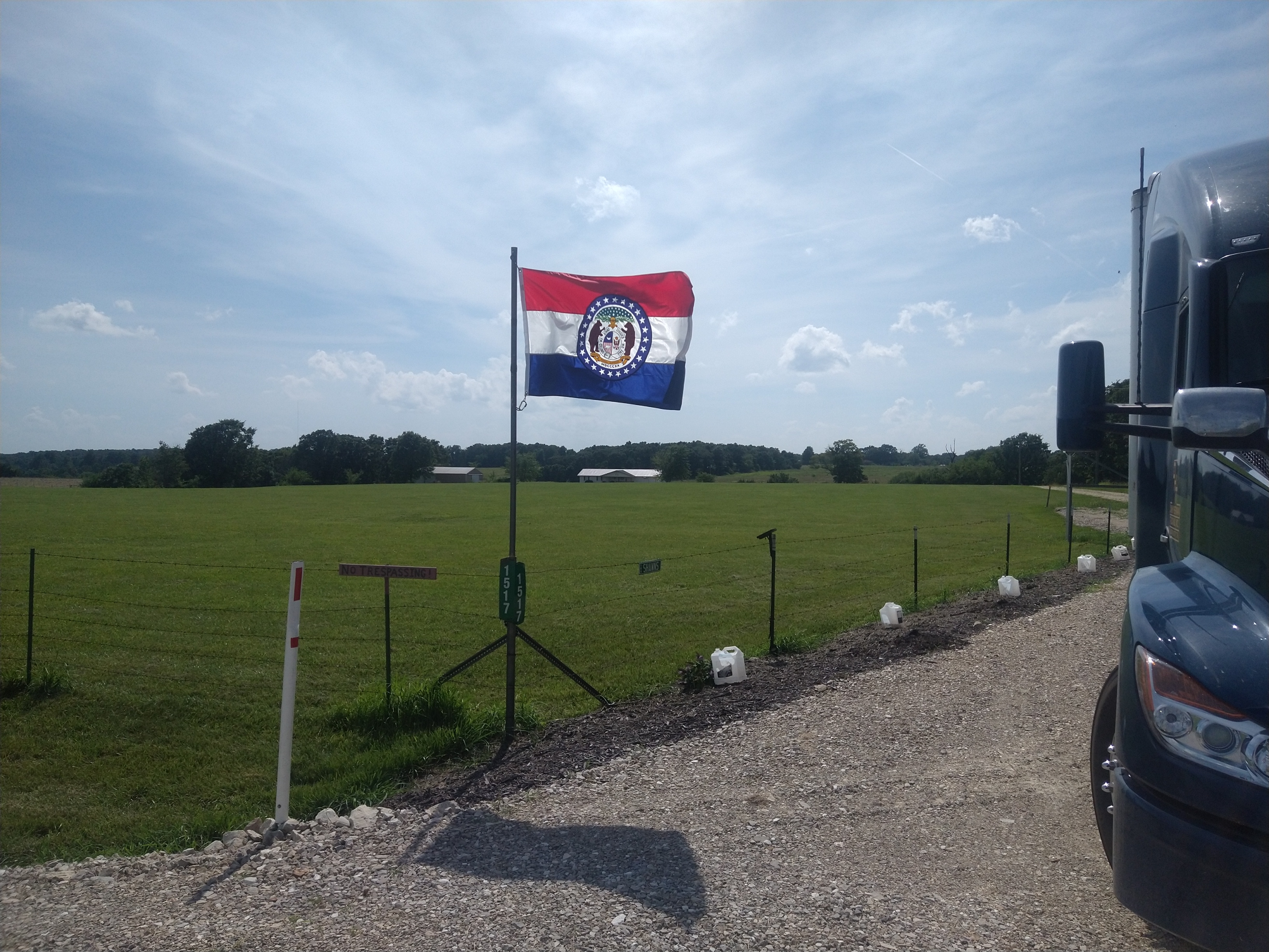

Then added gates ...
And extended fence, planted trees ...

Looks good. The only possible problem I see is the wire over the outlet. I retire with 20 years with highways dept. All the pipes I saw with obstacles at the outlet tend to gather any type debris and eventually clog the outlet end. Keep an eye on this. even though your pipe is underground you will be surpised what will wash out the end.

So my suggestion would be why even bother with the drain pipe? It's just gonna clog up and end up working fine without it as surface runoff.
Originally I was planning on keeping the "ditch/swale" open, but ... In order to get it to drain, I had to overcome the 2.5' rise, so it kept getting deeper ... I want to mow it with an 8' wide mower, so didn't want that short steep sides drainage area, plus the deepest part was by that one utility pole, which was only about 6' away from the center of my ditch, originally when I started digging, I only thought it would need to be 6"-8" deep ... So I didn't care how close it was to the pole ...
So I buried the pipe to make that area more level for easier mowing.
