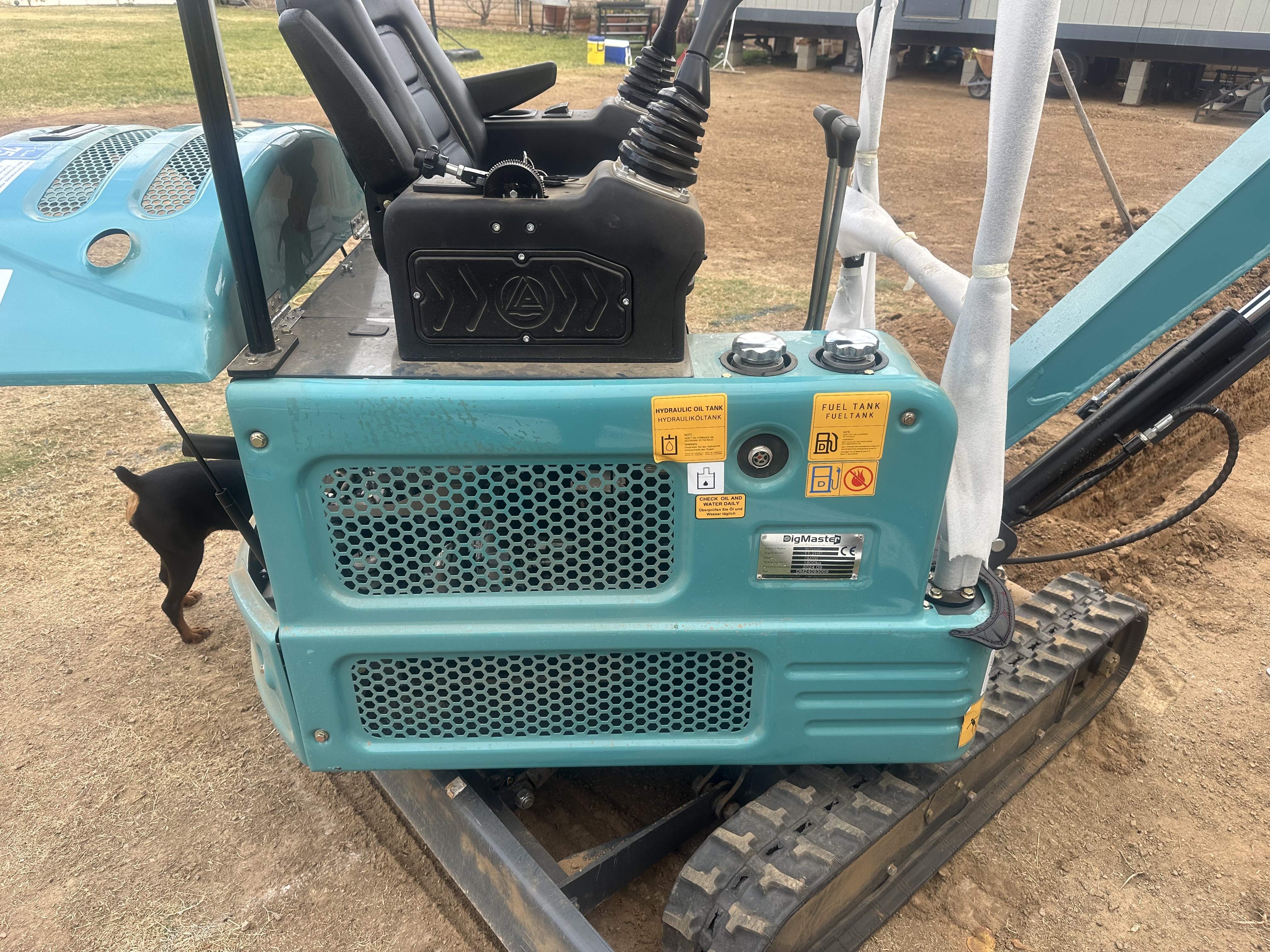

If any one locates the hydraulic filters, let me know where they are located at. I went down to my building and was trying to locate them. The way I am reading the book there should be 3 of them. The picture on page 125 of the manual is different than mine. I know there is a screen filter in the tank which I didn't see mentioned.. I see where ones appears to be on the right side that goes on the return line to the tank, looks like some kind of valve . Looks like they are showing a cartage, filter a canister and pilot filter. I removed the floor board where the control sticks are and did not see a pilot filter. Also does any one know where you can get touch up paint?

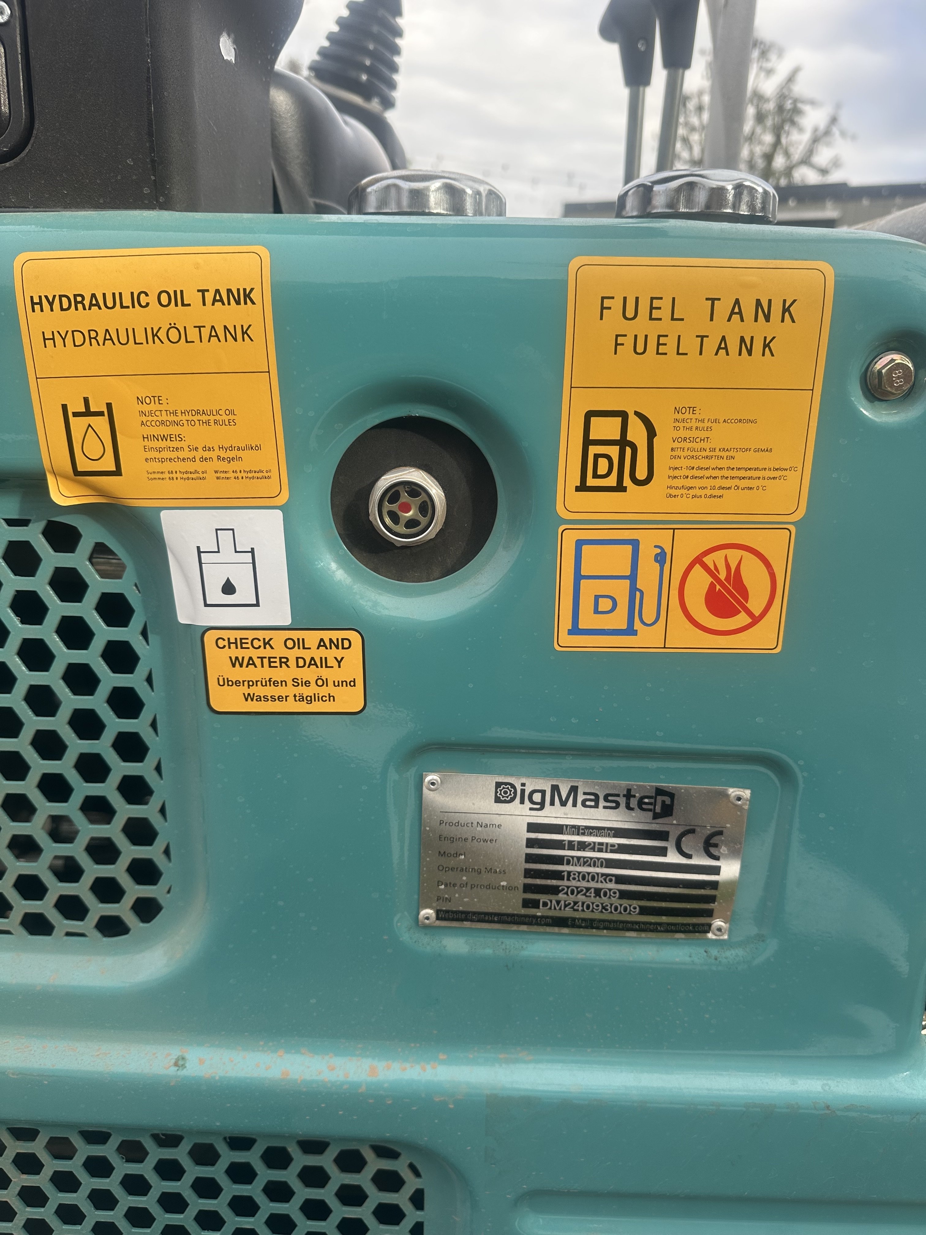

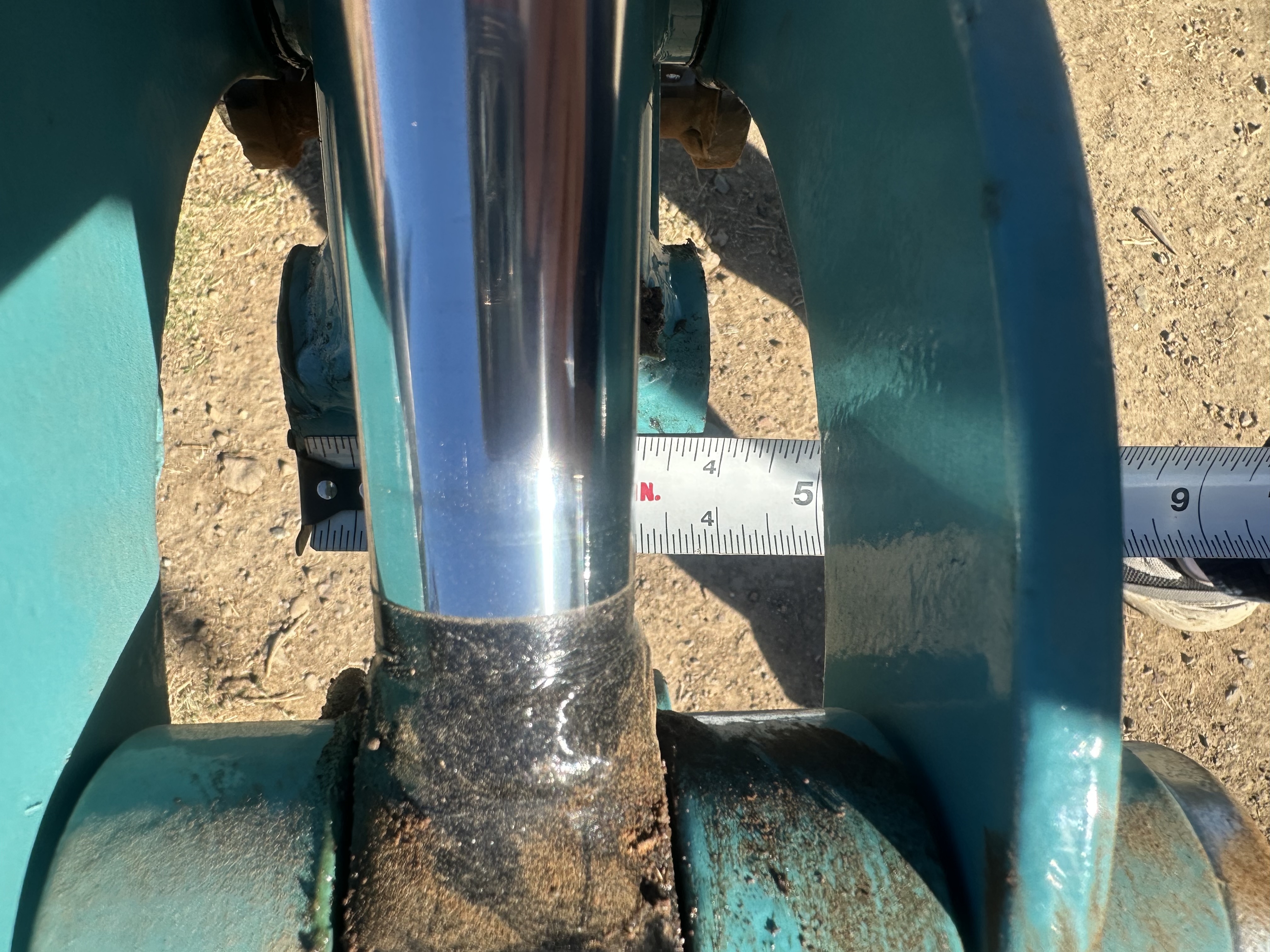

#58
Any one know where the hydraulic drain plug is located at? It warmed up today did a few things on it. Got my 12" bucket on it. Works fine, will have to get a couple spacers between the ears. A lot heavier. Took it and transplanted a small bush. The main thing i am going to have to do is change the control to the JD pattern. no way can I use it like it is. Any one know how that reset switch works on your instruments and I see that it doesn't show my RPM.
/ DigMaster DM200 Excv. #59
John - can't help on the instrument reset but the Hyd tank should have a plug on the bottom - if you remove the side cover then swing the machine so the tank is between the rear tracks you should see the drain.

John, If you look at that video, he shows you where the drain plug is.
