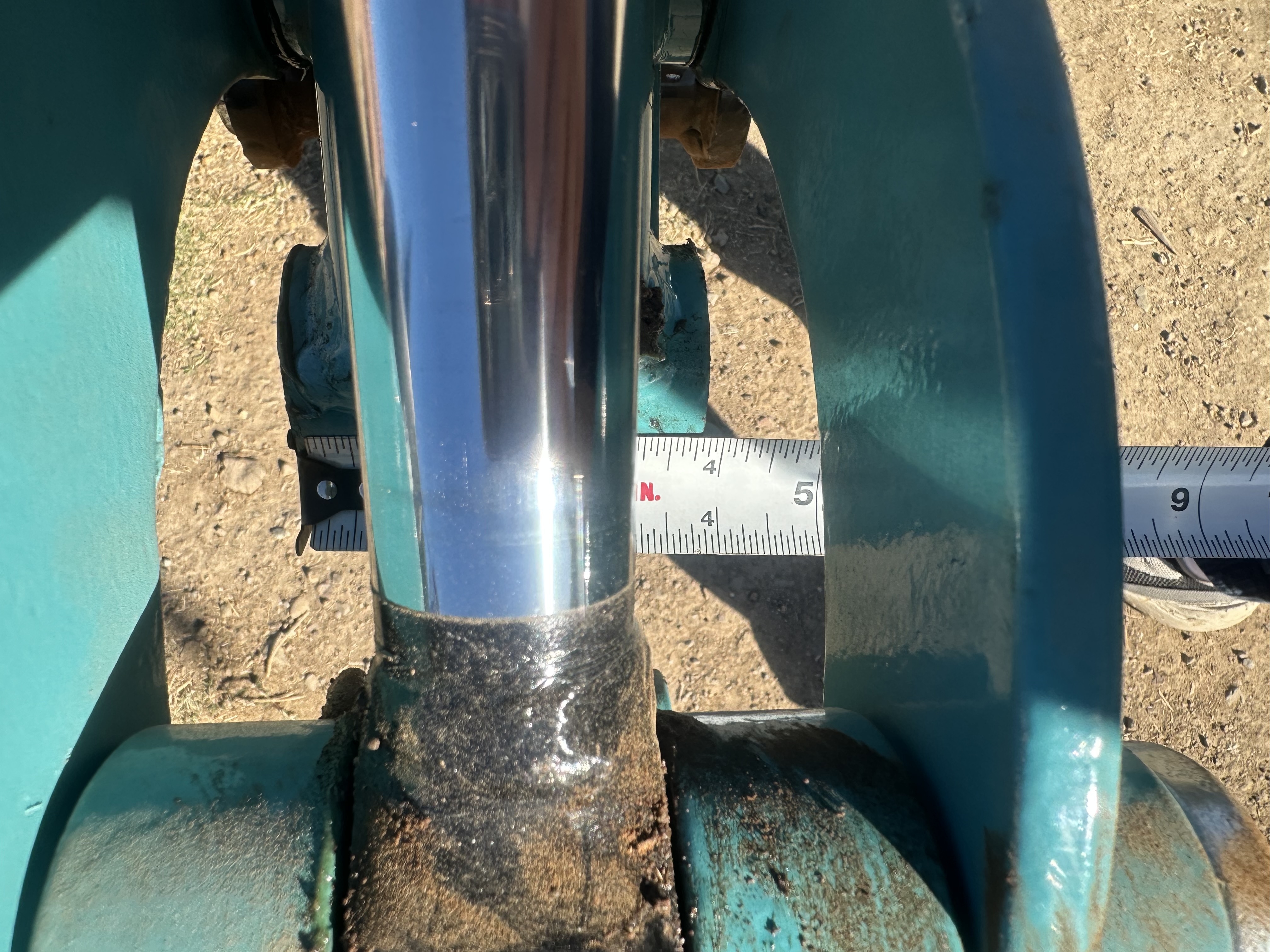

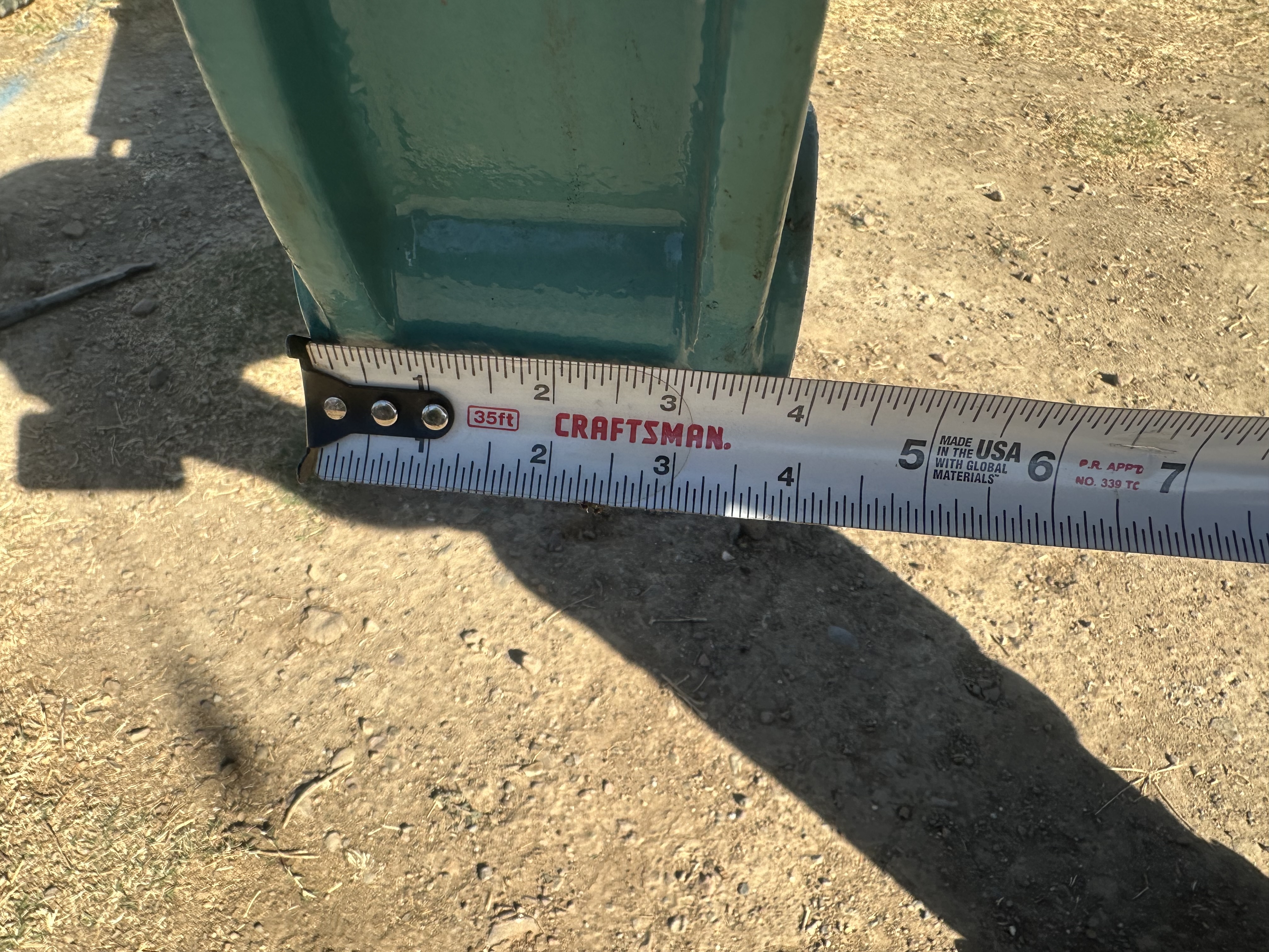

With a 4" dipper stick width, you are locked into bigger more $$$ attachments.
But you could get a standard 90MM quick hitch for $150, cut the sides off, weld up a 4" wide version which will take the standard 90mm attachments.
I measured the stick width at the bucket pin last night on my 1.8T unit and it was 3.4" and the bucket ears are at 3.6"
/ DigMaster DM200 Excv. #22

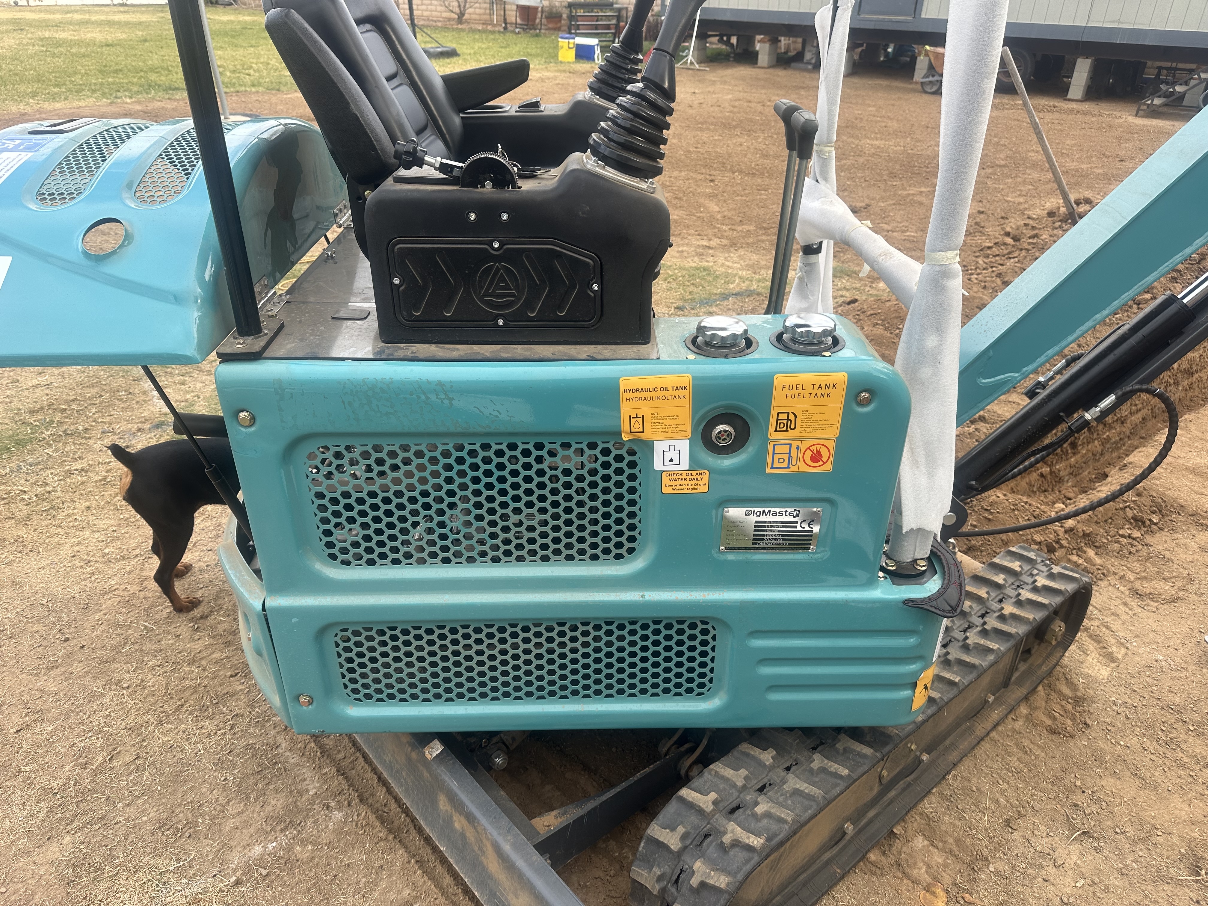

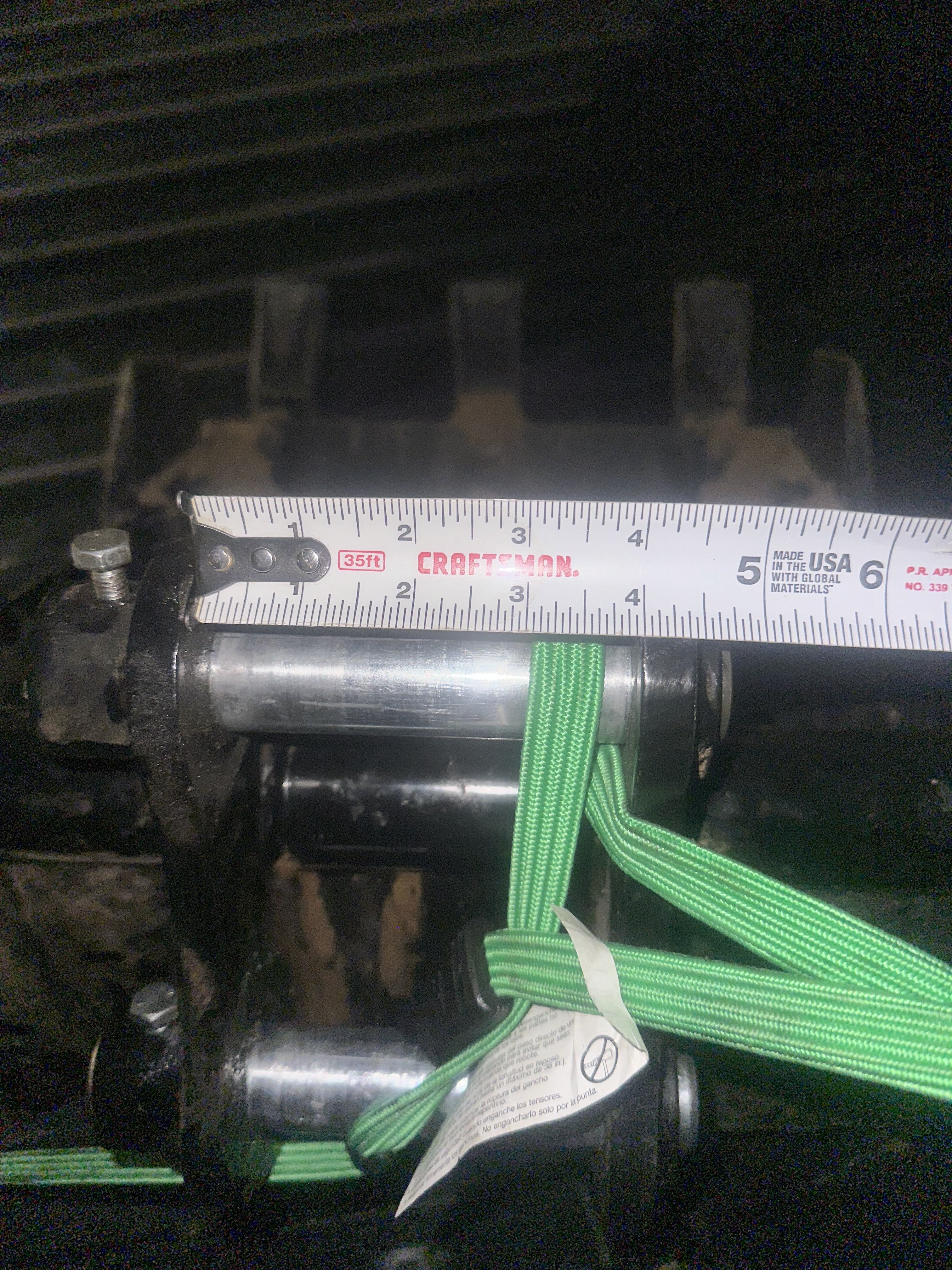

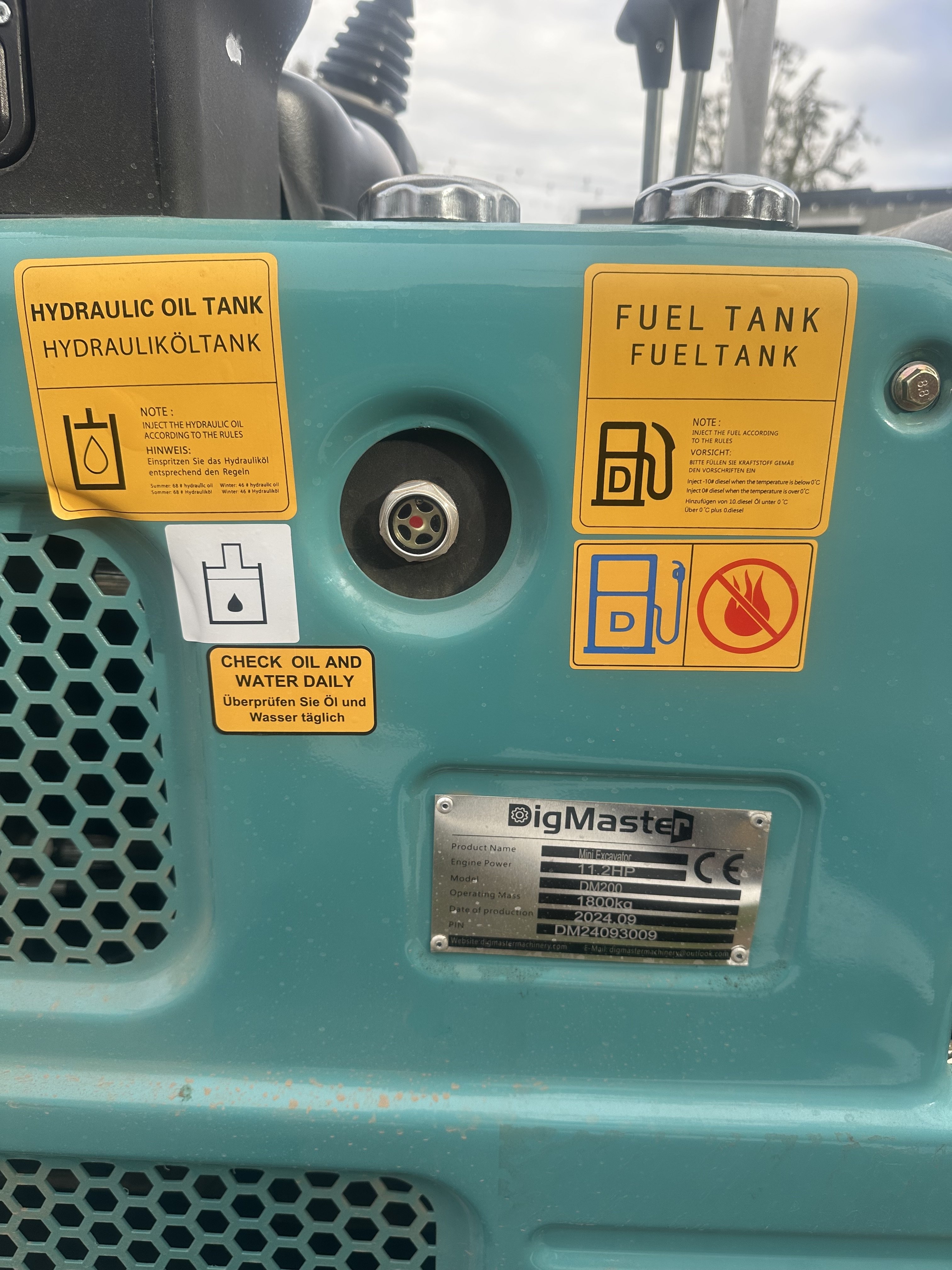

Here some pics for the 1800kg DM200.You can see the measurements in the pics.
I am really liking this machine so far.

Yoncey - thanks - those are good pics and confirms the dimensions. Then the least expensive option to use the 1-2 ton attachments is to get the normal quick hitch and make it 4" wide from 3.6" it is now.

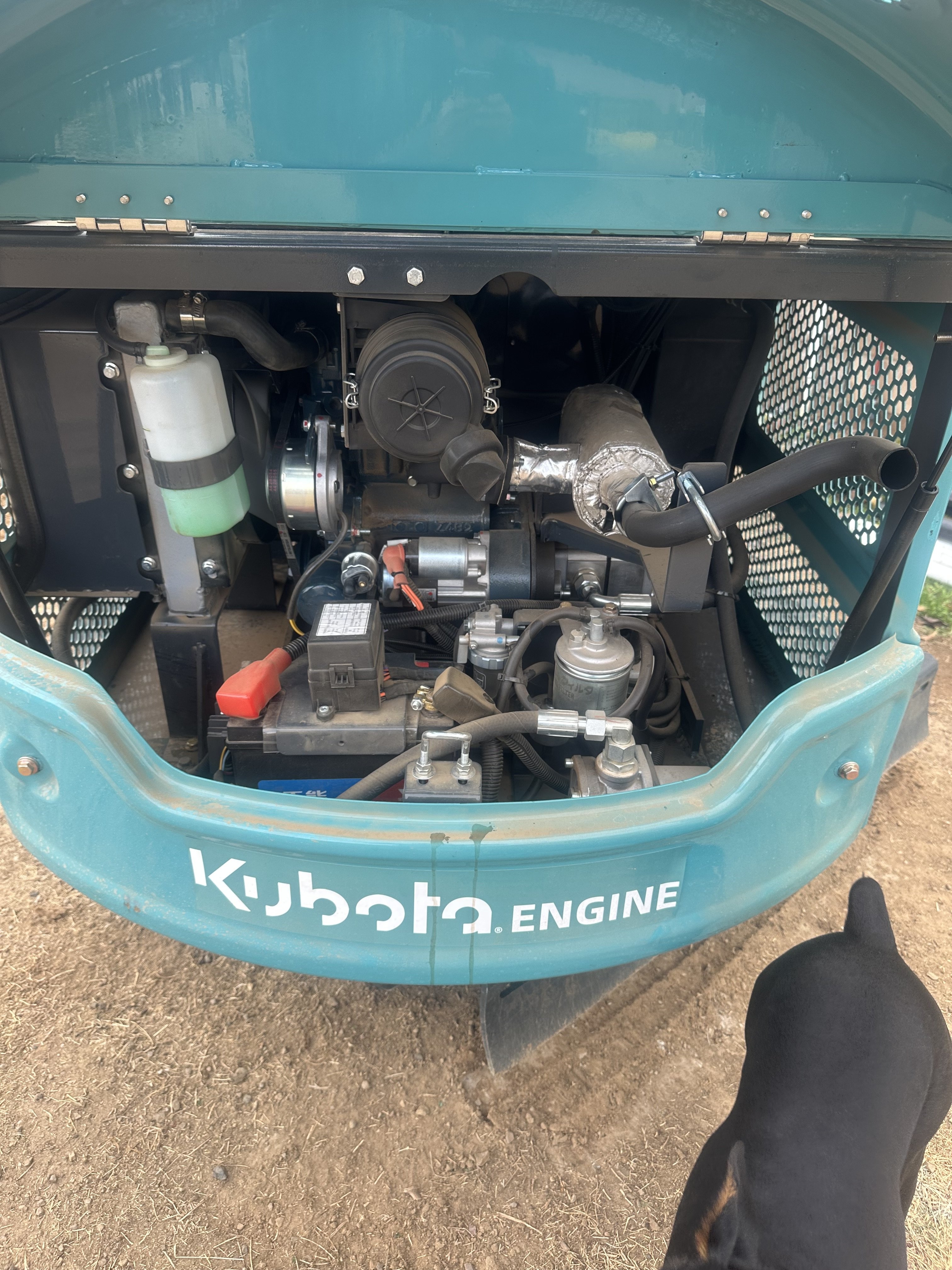

I just picked up my DM200. I took a quick look in the engine compartment and saw no hydraulic oil filter or cooler. In transporting it home, the big red key must have bounced out of the switch. It appears to be a battery cutoff switch but I am not sure. Does your DM200 have this on the right side of the bulkhead as you are sitting in the machine. Any ideas?
The battery cutoff switch is a legacy of the first Chinese minis, which came with a 1-cyl diesel engine that had to be shut off mechanically. The starter switch did not have an electrical OFF position to kill the engine.
That has all changed with the advent of the 3-cyl Yanmars and Kubotas, plus the properly-designed gasoline engine units. They have a starter switch that enables the fuel solenoid on diesels, or kills the ignition on gas engines.
I tossed the cutoff switches on all of the minis I had, since it was just a battery- and hour meter-killer. Of course, I had to upgrade the starter switch, but you don't need to.

I ended up going to O'Reilly Auto and they had a Doorman battery cutoff key set 2 for 9.99. It fit and works! DM200 started right up. Looks like a pretty well made piece of equipment. I bought a 25mm quick hitch coupler and some 30mm weld-on ears. Also bought a 24" tilting bucket, 8" bucket and 12" auger. Looking at adding a hydraulic oil cooler and filter and a Dual Crossover Hydraulic Relief Cushion Valve for the swing motor.
/ DigMaster DM200 Excv. #39
Oops! I was wrong, there is a hydraulic oil cooler in front of the engine radiator! And maybe a weird in-line filter.
