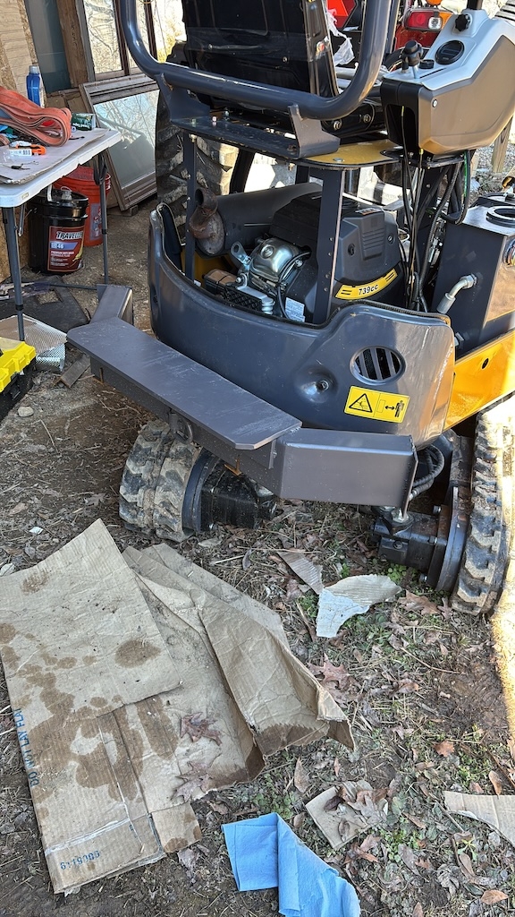

I stripped it down, changed the engine oil, and changed out all the grease fittings. My next modification was to add a counter weight. I'd like to add more, but this is a start at 80 lbs. I bought scrap flat stock (1/2" and 3/8") at my local salvage yard for $32 and cut and welded it up into an 80lb suitcase. This is where I wanted to install it. I didn't want it sticking out the back to hit something.
These are the two pieces of scrap steel I bought.
This is all cut up and welded together.
Here it is installed.
The back is back on and the weight is not visible with the body panels on.

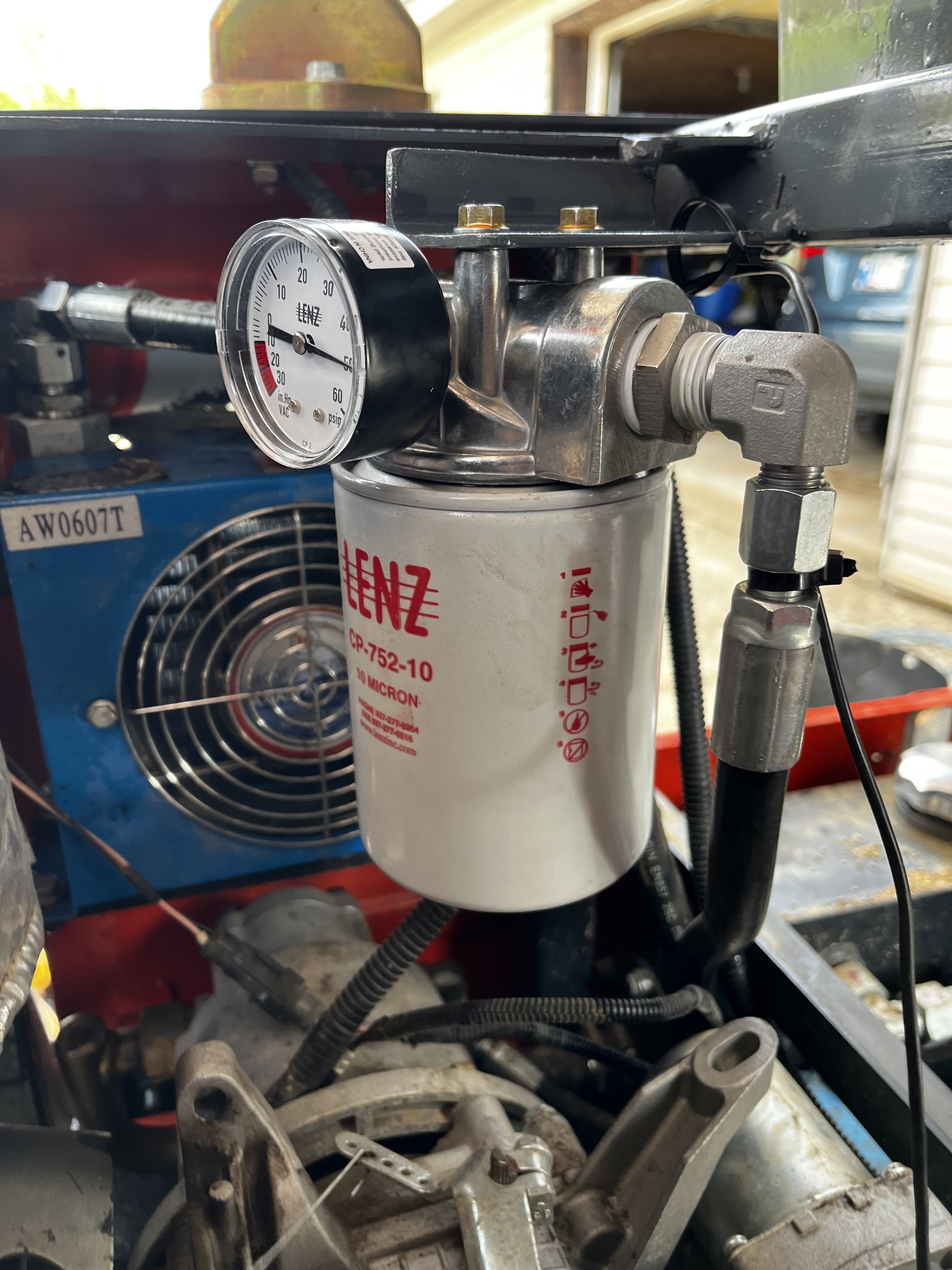

After getting the fuel tank out of the engine compartment I added this 10 micron filter to the hydraulic system. Parker hydraulics in Jeffersonville In. had all the fittings I needed and made up two hoses to my specs but were pricey.

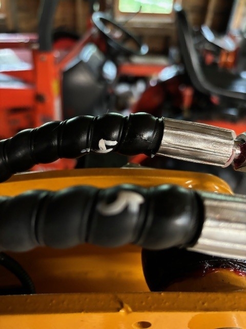

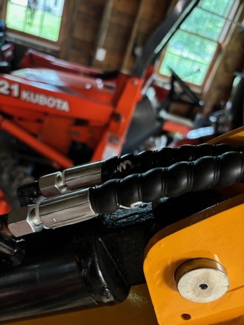

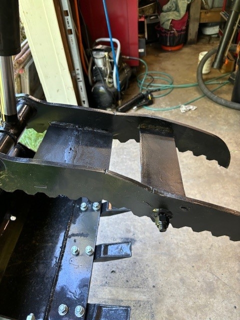

Skramer - I have the similar Hightop Typhon Terror XVIII - 1.5 years now and added the Hyd filter, Tiny Tach, track motor protection, beefed up the thumb - welded two 3/8" plates between the tines. Then 9" turf tracks, and moved the thumb pedal further out with an Aluminum one, and added a bracket for the tool box on the back.

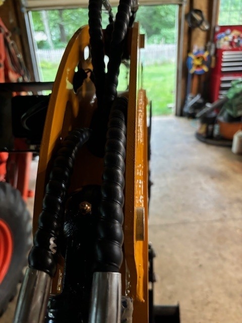

Then wanted BH mode too, and it's as simple as swapping the boom and stick cylinder lines, left boom goes to left stick, left stick to left boom and same on the right side. See the lines in the pics - 4 swap to 3 and 5 swap to 6 - simple as that and I can change in 10 minutes as my neighbor prefers excavator mode.

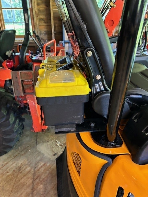

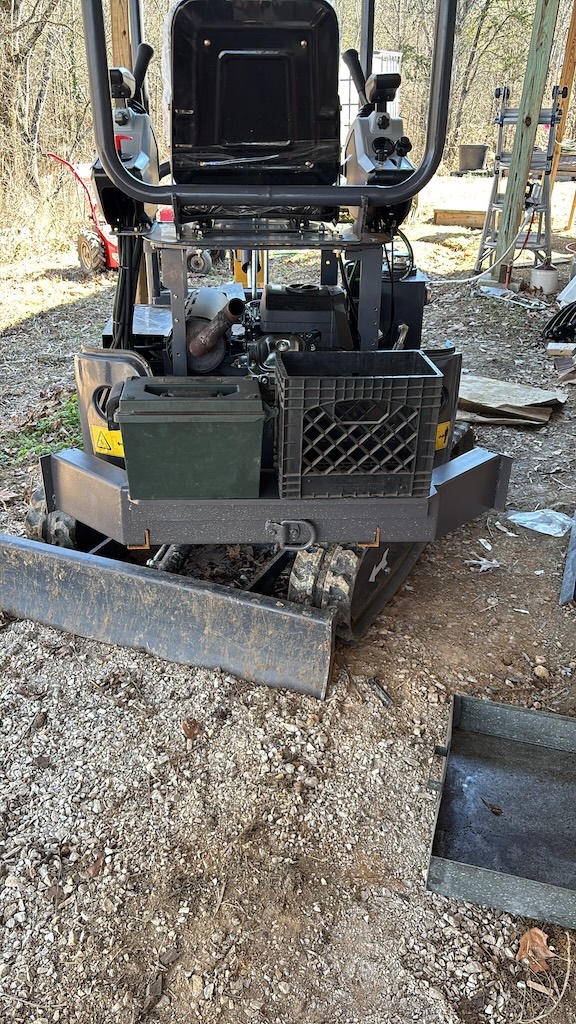

80 lbs is not going really help all that much. Sure it might technically help a bit but it won't be a noticeable change. I added 180 lbs to mine and I still want to add more. Really the only way to add enough is to allow it to stick out the back. I made a bumper for mine. By letting it stick out the back some you are also increasing its effectiveness.
That little self allows me to add a milk crate and a box for tools, lunch, water, extra gas, etc.
I just got my hydraulic filter and cooler installed and about to wire up a 10" fan under the seat blowing down then I will button it back up and start putting it to work.

I added a few more upgrades to my mini this weekend. I added the hydraulic filter kit. I used the Oetiker clamps on insert fittings since it is low pressure. The nice thing about that is that it was super inexpensive, since I didn't have to order any hydraulic hose fittings or have any hoses made. I made the bracket out of flat stock and welded it onto the radiator mount.

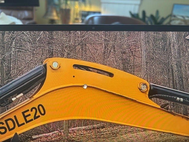

I also wanted to reinforce the thumb, so I welded a piece of angle up closer to the end, but not close enough to interfere with the boom. We'll see if it will hold up, my welding job on this was not great.

I really do want to add more as I know that more is better in this case. I bought another 60 lbs that I hope to add this week. I'm hoping to avoid the out the back type of things so I can maintain the zero tail swing, but I'll see if it works out for me like this. I also want to add some protection for the drive motors which will add some weight, just not on the house.
/ SDLE20 mini ex #11
Yeah, I get it. But as many times as I have used a mini ex I can only think of one or 2 occasion there zero tail swing was an issue. I would rather have the increased safety and usability. I also have the drive motor protection, I think this is another great opportunity to add weight nice and low. I am going to fill the 1.5" square tube with melted lead I got at the scrap yard. I will probably weld 2 of them together to add more weight. Hoping to get another 50 lbs down there. Without the lead the brackets and bar only add like 8 pounds.

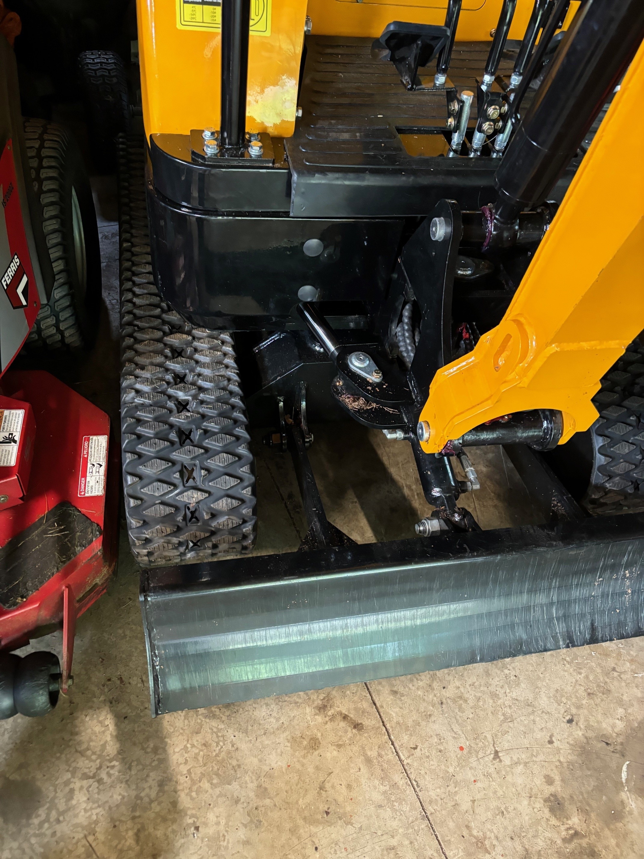

Thanks for that. I've been wondering about swapping the tracks to 9", there seems to be plenty of space, what are your thoughts on that upgrade. Does it give the machine more stability, was it worth the cost, were there any unforeseen issues doing it? I also had wanted to swap to backhoe controls, but my hoses don't seem like they are long enough, but if you can do it in 10 minutes, I must be thinking about it wrong.
I found the pair of 230MM diamond back turf tracks on ebay $435 delivered - they are made in Indiana. The ebay link is dead now tho.
- Easy to install - lift up the mini one side and remove the tension and take the old one off, and loop the new one around the idler pulley then start it on the drive pulley and run the track (best to have 2 people) First one took 45 min, second one 15 minutes.
- Result - smoother ride, doesn't dig up turf, better made than the china ones.
On the hose swap - on the picture below swap the left stick cyl hose with the right boom cyl hose. and do the same on the other side. Should be long enough but I can't tell from the picture.
I checked there to swap the hoses and mine are not long enough to move the boom hoses out to the stick, unfortunately.
/ SDLE20 mini ex #17
Then you will need to swap them on the manifold under the floor - more work less fun!
Also I see you are adding a lot of weight - is your rear bumper just a metal shroud? Mine Terror has a large casting there - probably 250 lbs.
/ SDLE20 mini ex #18
Adds cost but you could just patch in a 1 ft or more hose to extend your lines.

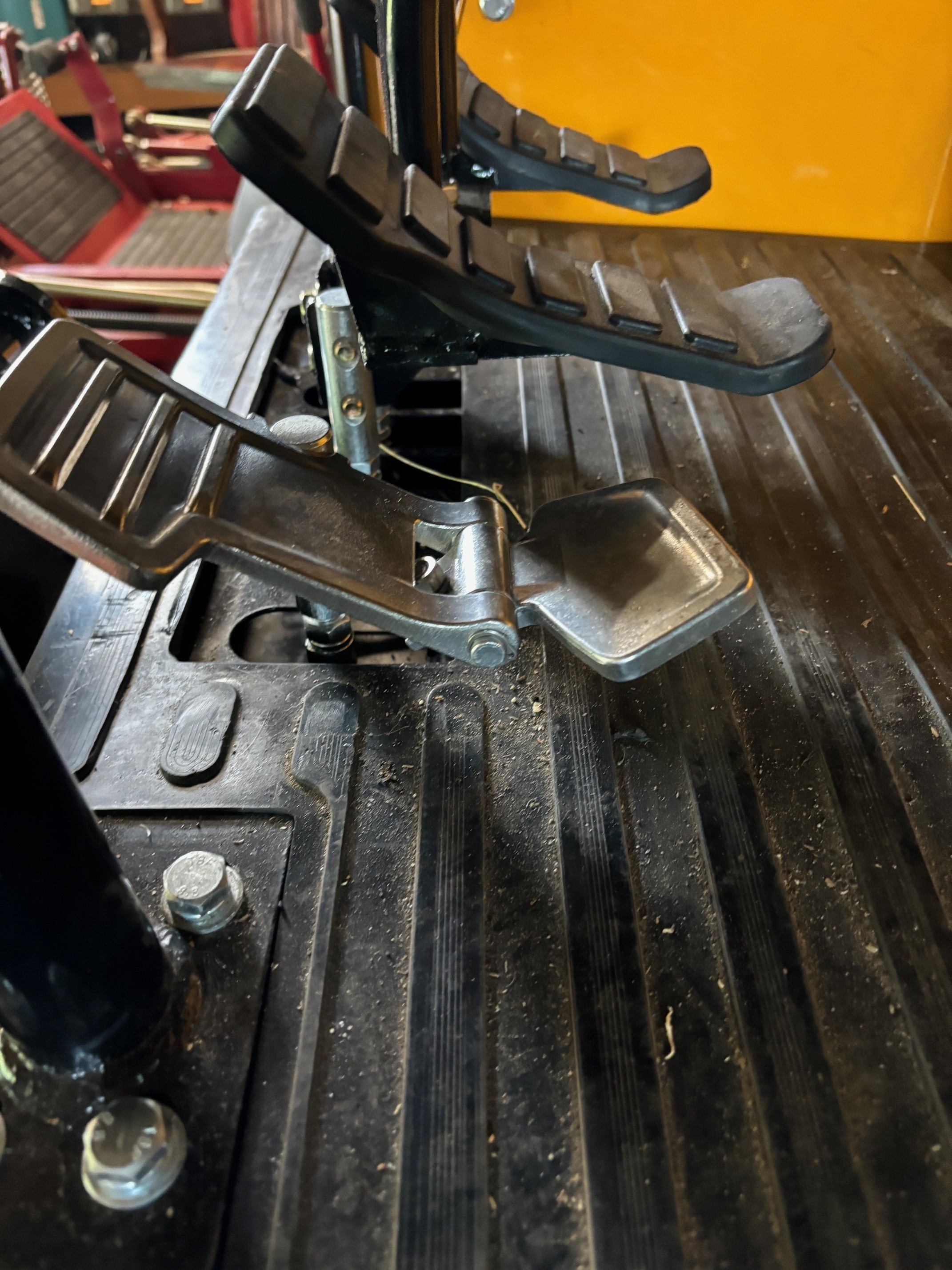

I have done a couple more upgrades to my mini. The floor pan of the machine had something on it akin to a worthless diaper is all I can think of. So I decided to put some of the DIY truck bed liner on it. I have had good luck with it on my trucks over the years. So I scuff sanded the panel and put two coats on it. It looked pretty good.
Then I figured it might get worn pretty quick getting on and off, so I looked at the local salvage yard for a rubber truck bed mat and found a partial one.
I cut it to fit much tighter around the controls so less dirt can fall through and came up with this. It fits perfect and will be very durable.

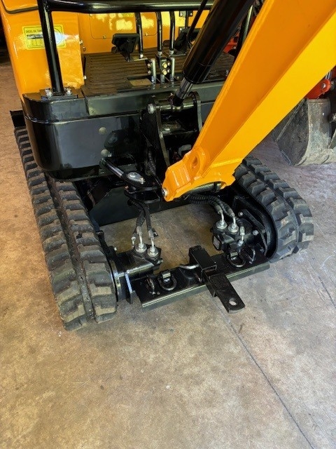

Lastly, I wanted to add a brace/protector to the track motors to stabilize them side to side and protect the fittings on top a bit. I have it made, but I haven't bought the longer bolts I need to bolt it on.
